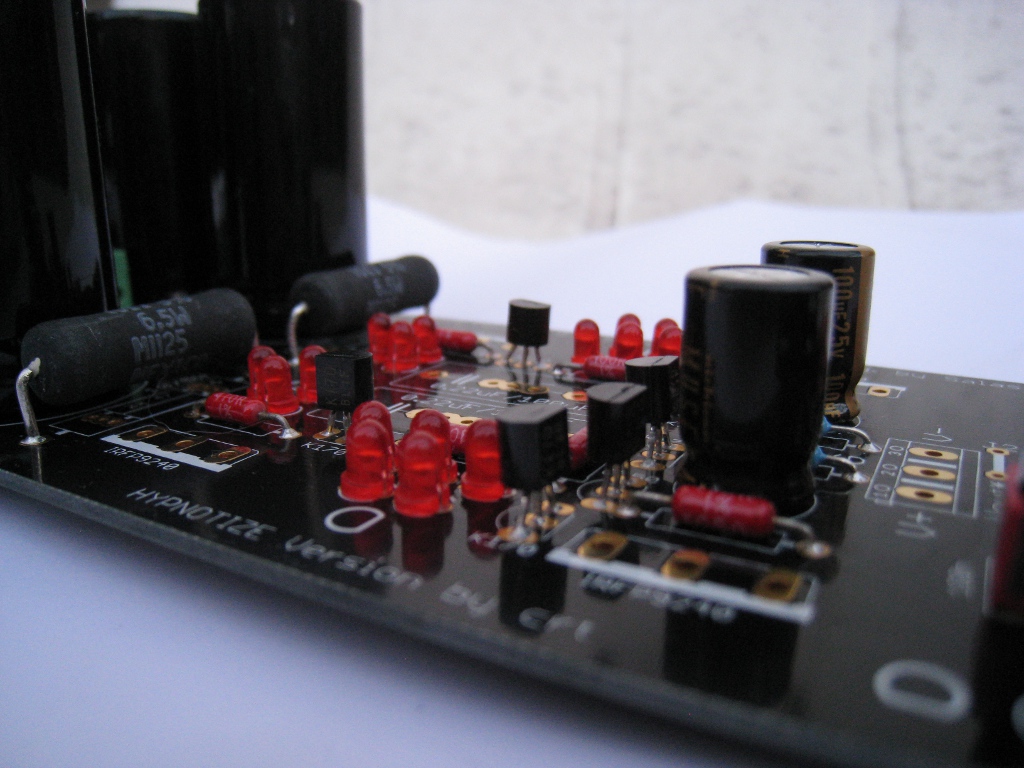

Hi guys, I'm putting together the kit I got from Tea-Bag and I'm little bit confused about the 5 LED group direction on the V- side of board, I know it was somewhere in this thread but can't find now...so which one is correct the imprint on board or the square hole showing the cathode?
all the best
Nicu
LED Orientation from SALAS - Square hole is Led's anode in this pcb Positive Side is the Anode and has long wire
Also,
The LED should have a flat side on the underside... The flat side goes to the flat side imprinted on the board.

mantha3 , thank you for reply,
in any case ,am I correct with this dirrection of LED's?

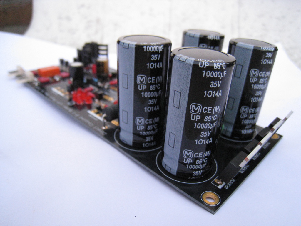

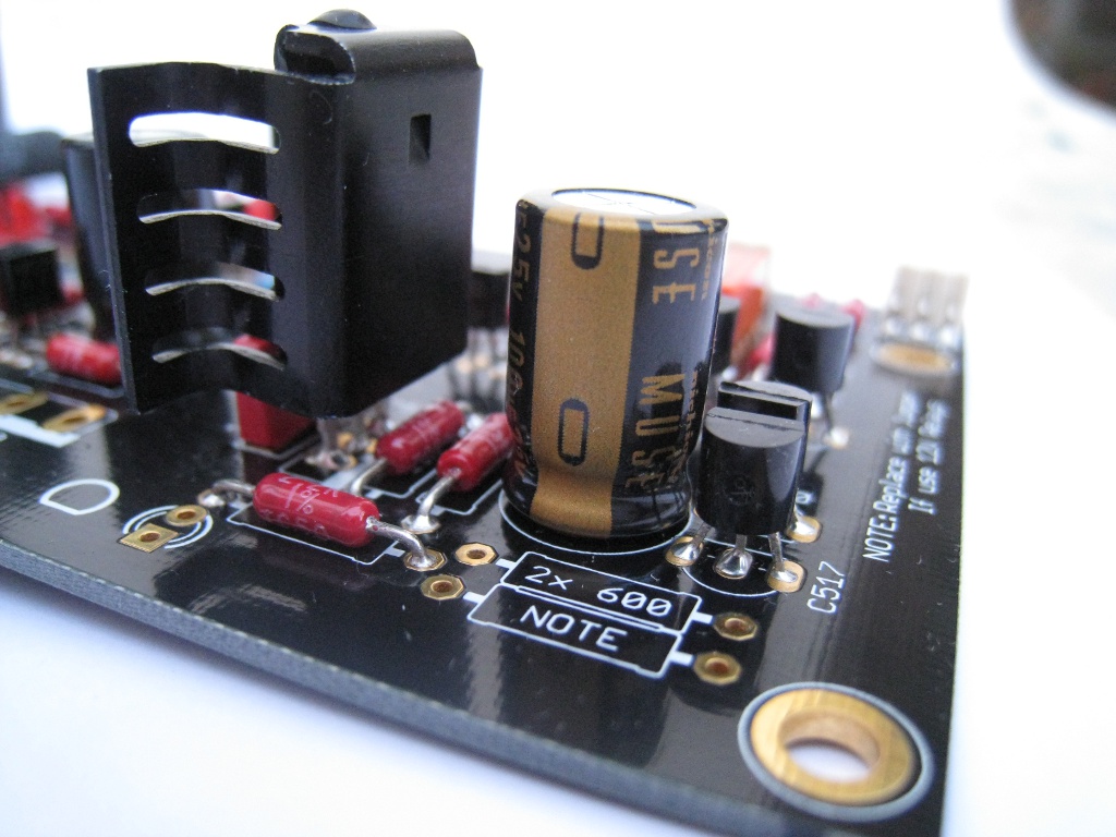

Here you see what I succeeded so far
and buffer side
I expect to complete with some Mundorfs AG 4700/40 capacitors and Takman resistors for buffer...
Nice work with the soldering iron. Looks great
Looks great indeed!

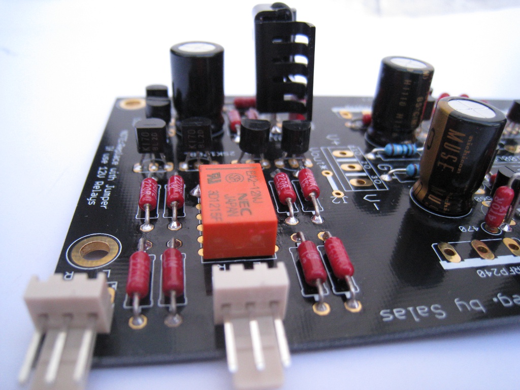

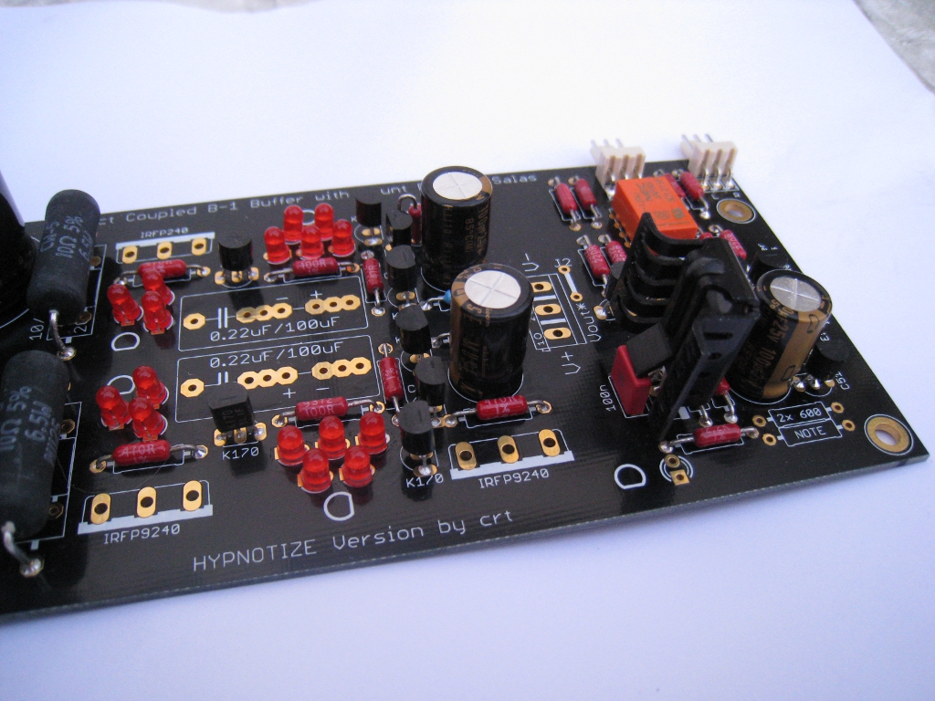

Here are some of my pics too while I'm at it. Please note that the jumpers are not yet installed. Neither are the FET's and the 0.22uF cap
The board is of good quality which make soldering a lot easier. Thanks for making it available!
