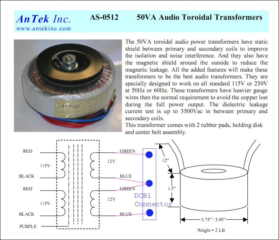

I got my RCore!
Questions on the hookup to 120 VAC
The wires to the fused IEC 120V. I have RED, YEL, GRN, ORG on the hookup side. What two do i wire to HOT(+) and what to Neut?
OUt the other side is the 15V to the DCB1. I have two BLU and two GRN wires on the RCORE output. Do I hook one GRN to the side O1 or O3, One BLU to the other side O1 or O3 and then a BLU and GRN to the center like this:
I then have 1 more YEL/GRN. Does this YEL/GRN run to the IEC Ground?
Thanks for the help!!! I got side tracked with some speaker project build and now I'm back to this!!!
Red+green to live yellow+orange to neutral. Shield YEL/GRN goes to IEC ground. Output side has two blue and two green for 15+15V which is rather stupid because it does not help with identifying the middle wires as the windings go, so attach one green to one blue and make a middle point at random. If it buzzes at all combine another blue to another green. This Tx looks big and made for tube gear. Insulate the 320VAC HV outputs well and keep them properly tacked away. Use your DMM on AC to confirm that the 15-0-15VAC you created is there as expected on the wires to use before applying to DCB1.
I think I follow you. I have a DMM. So I think I can check a green and blue and if I see the 15VAC then I have one of the pairs... Then if I check the other pair of green and blue I should see the other 15VAC
If I have the wrong combo of green and blue I won't get the 15VAC on the DMM
sound right?
sound right?
First insulate the 320-0-320VAC triplet and keep away from those. Then apply the primaries to the wall power as discussed. Then confirm the 15VAC blue pair and the 15VAC green pair with DMM as individual 15VAC lines. Unplug from the wall. Combine one blue to one green 15VAC wire. Plug to the wall again. Confirm that you got 30VAC across the remaining free blue and green wires. Confirm half that voltage from each free blue and green end to common pair end. If any buzz emanates from the Tx change the wires that make up the common to another combo of green and blue.
