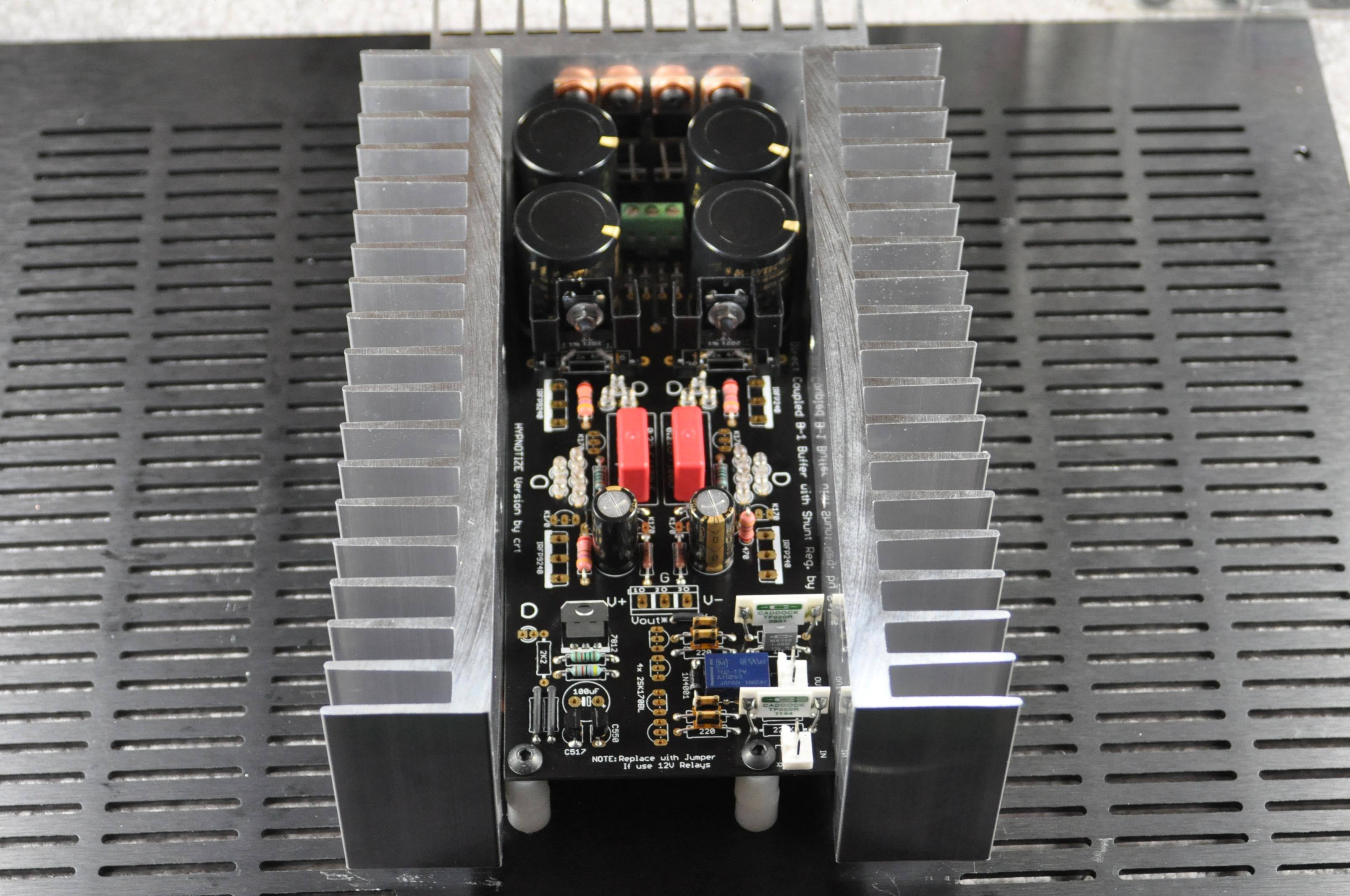

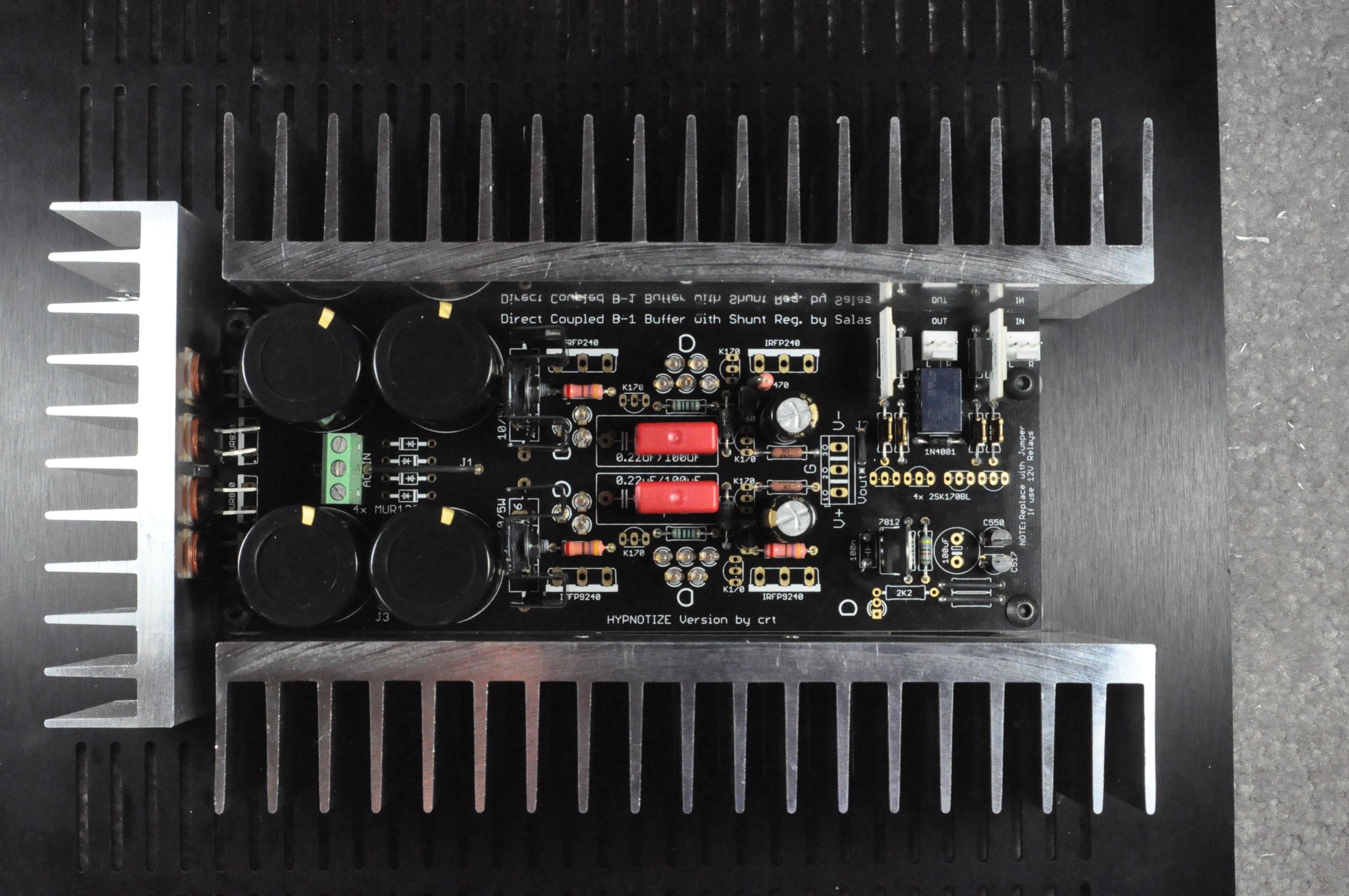

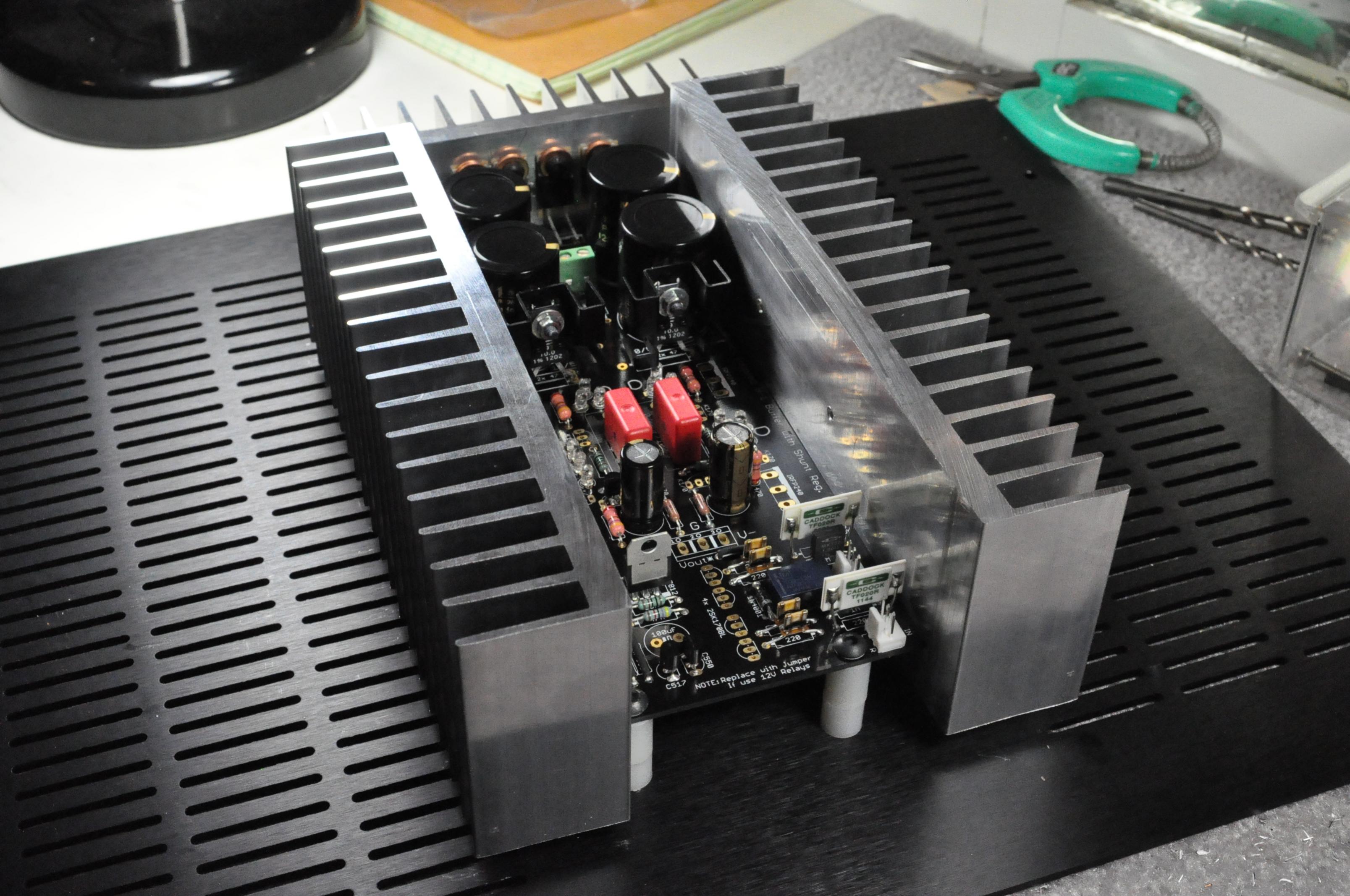

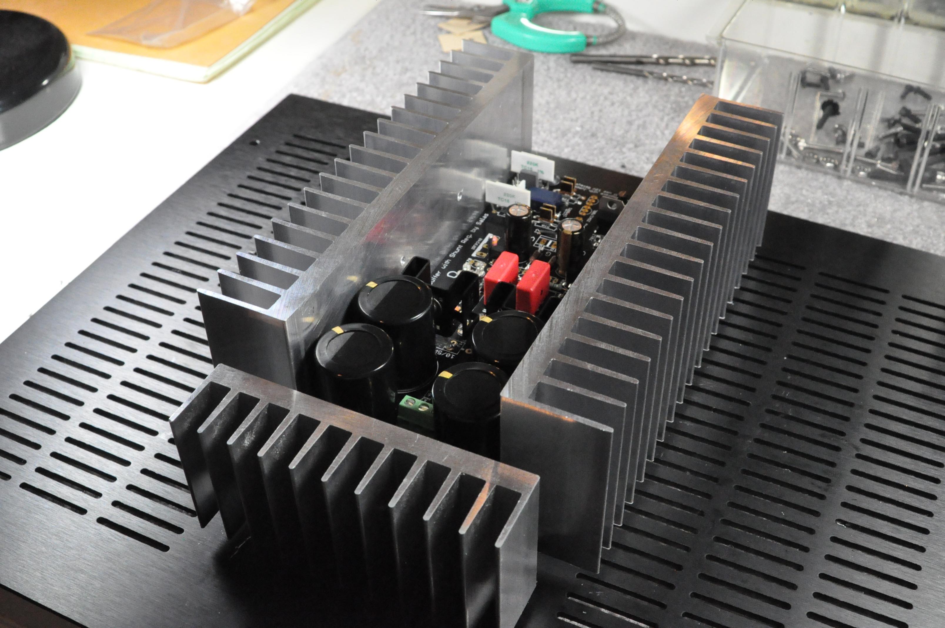

Turn the whole assembly upside down, the transistors won't mind.Hello,
I recently finished an F5 and was so amazed by its quality that I jumped right into building a DCB1. I am planning on "hotrodding" with 10R resistors to start. I have bought large enough heatsinks to withstand more heat (i think) if i decide to take it to the next level. Anyway, I built my F5 with top quality components and I am doing the same with this build. I am still waiting on a couple of parts in the mail. I haven't made up my mind on a chassis yet.. I am also trying to decide on a transformer. I got a quote on a SumR toroid (80VA, 2X15V). I believe I will buy one of these but am still searching for alternatives. Since the fire at Antek I have had to do some research on quality toroids. I have also found an R-Core that is a fraction of the price. Any suggestions on this decision would be nice.
My main question is about my heatsink configuration. Can i mount the heatsinks with the fins facing downward (toward the bottom plate of chassis). It seems (because heat rises) that this might not be beneficial. I posted a photo of what I am considering.
I splurged and bought a 10K Khozmo 48 step attenuator. I have never had a nice volume control in my signal path so i am excited to see what it can offer. I have been inspired by the Lightspeed (or "Lighter Note") LDR volume control and may build a stand-alone unit in the near future.
I am planning on running AC mains through a Schaffner EMI line filter (FN2070-3-06). I originally bought it for the F5 but decided against it.
I just got my 2SK170BL's in the mail (Thanks Spencer). I was very diligent when matching the LEDS. They were already very close but they are spot on now.
Any comments/suggestions would be nice. Especially about my heatsink configuration and any ideas on a transformer. If anyone has any experience with SumR and can relate their toroids to Antek, that would be great. Antek says they will have their full stock back in mid-April but I do not want to wait that long.
Anyway, thanks for the inspiration on both of these builds. I have only been "tinkering" for about a year but it has been an amazing hobby. I knew absolutely ZERO about anything to do with electrical work of any kind. I have a TON more to learn..
Thanks in advance,
Madison (Tennessee, USA)
The PCB will now be under the sink and run cooler.
The sink fins will now be pointing upward and thus dissipate more heat for a lower Ts.
The components on the pcb will now be in the coolest air.
Three gains and no downsides.

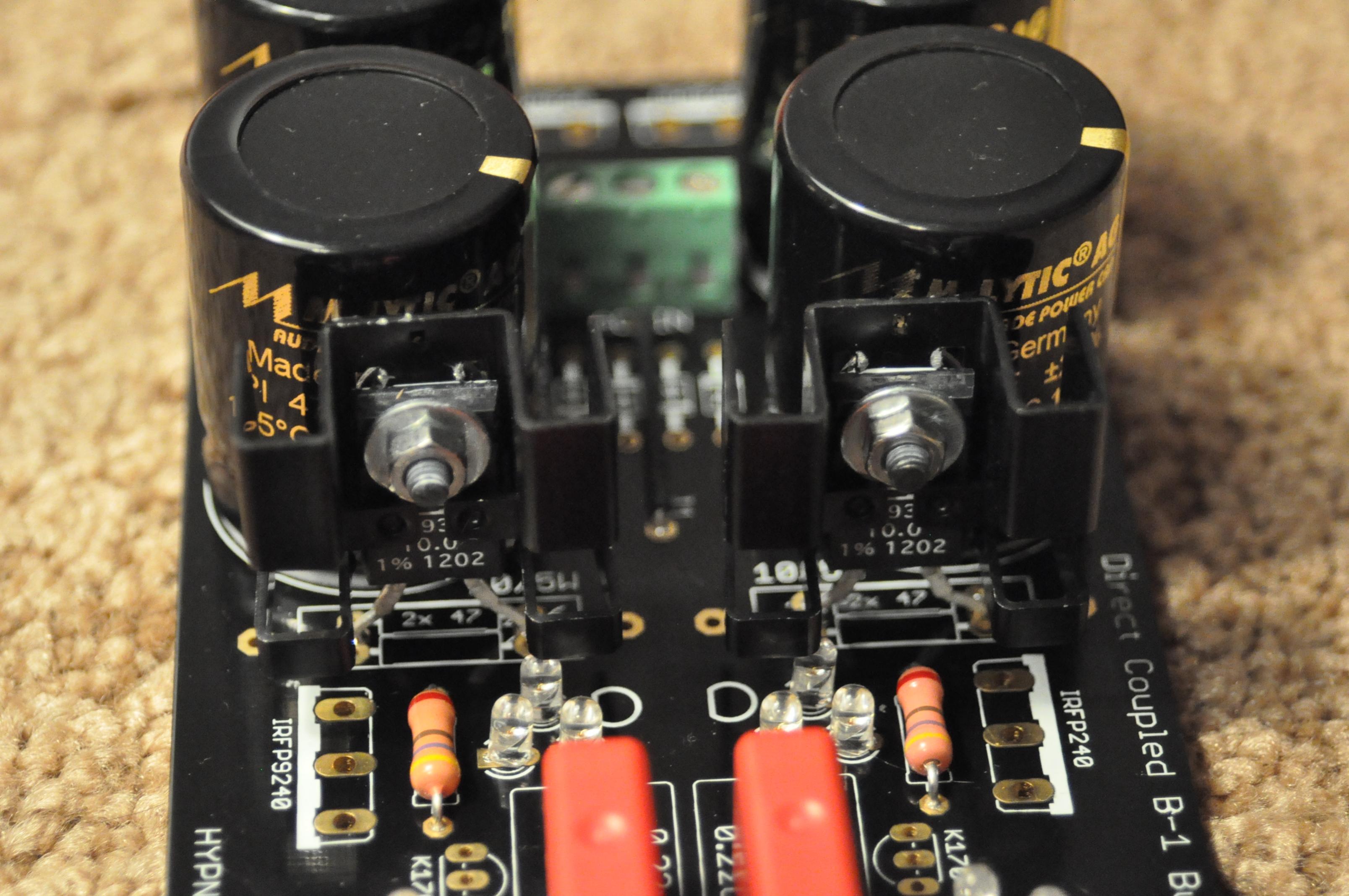

The same thing happened to me. Not sure why it does that. You got it right, don't worry. The "Caddock-62246" is the part number for the 10R MP-930.

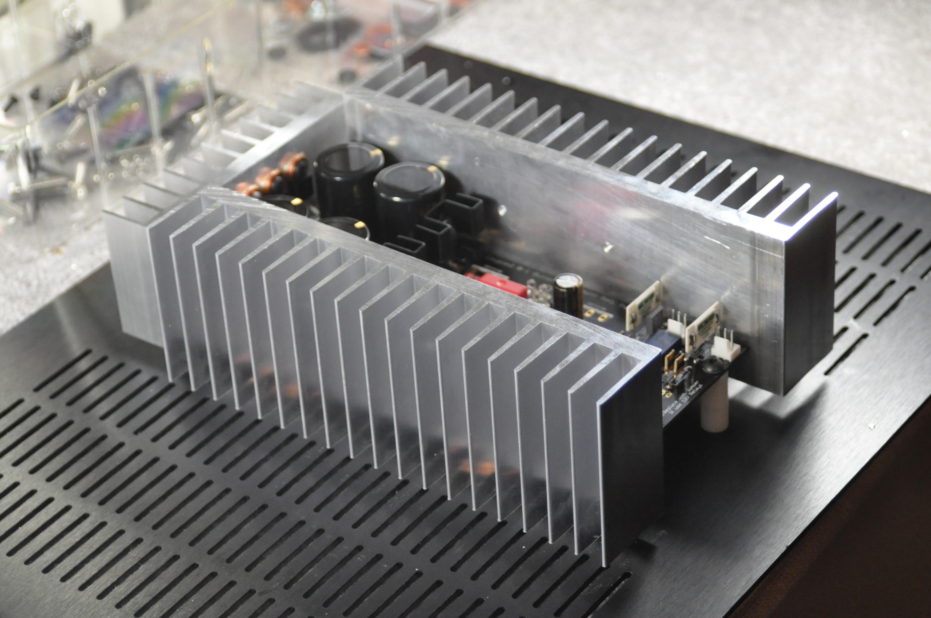

I just finished tapping my sinks and i mounted everything on a spare piece of aluminum i had left over from another build. Just wanted to get all the measurements worked out so i can reproduce it flawlessly when i get a chassis.
I know (now) that the rectifiers do not need to be sinked when running 10R resistors. I had already placed an order with heatsinkusa.. I figured it wouldn't hurt them in any way and I might want to crank up the current in the future. This is the same reason i bought large heatsinks. Haha, this is the first time I have ever drilled and tapped my own heatsinks. I bought 4-40 tap originally.. I broke it.. Went back to the hardware store and bought a 6-32. I made sure to look at an online tutorial this time.. Among other things, I didn't know to use oil while tapping. Anyway, most everything is a learning opportunity. I am quite happy with the looks of things thus far though...
All i need is a transformer and a chassis to complete the build. I will keep ya posted.
