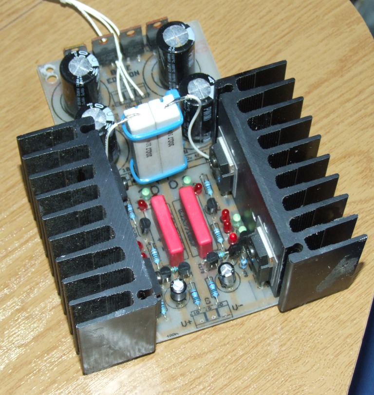

Ah, something else...in my system the DCB1 sounded better with 15V AC transformer and with 3,9 ohms current resistor for around 450mA, I can't go higher unfortunately. Beefier and more colours in my book. And I use an EMI filter, the DCB1 has almost no limit in high frequency and lets it all pass.
Running 10R resistors will be moderate hot rod? I thought this was somewhat of a mid level and that you can push it even further... With the 10R still lots of heat?
In a long ago post, Salas defined the "levels" as:
Stage 0 = circa 75-85mA Ecological and cool. Smart car territory, the twin 47R 1W marked on the Blue and no or mini sinks will do.
Stage 1 = circa 200mA. Boosted enough, all purpose, some logical sinks. Standard Blue HR, Golf GTI territory. 4W dissipation per rail. 10R 5W.
Stage 2 = circa 600mA. Increased grip and pull back, Porsche stuff. 12W dissipation per rail. Sinks like for a 30W class A/B amp. 3R3 5W.
Stage 3 = circa 2A. No holds sense, Enzo feel. 40W dissipation per rail. F5 size sinks & Tx. 1R 12W.
Cool. I was thinking that was the case and the 10R would not be too hot. I do have heat sinks and the Case will be aluminum. I think the Jantzen Copper in Oil won't cook 🙂
I did some measurments today with my temporary external PSU build.
Its an old tranny I found in the closit (5 of them actually), one 10 mF per rail and some 2 A 30 mH chokes intended for filament cleanup.
I hooked the scope up on first C, aka after the chassie bolted rectifiers.
Around 530 mV ripple
Then on the board mounted C, after chokes:
Around 12,6 mV ripple
Then on Vout
Like 2,5 mV ripple.
Vin is around 20.5 V and Vout almost spot on 10 V. If Im gonna hotrod it some more (10R atm) Im gonna need dual trafos.

It looks random like true noise in the final without any harmonic pattern. Not a trace of oscillation either. Nice. What is the scope's bandwidth used and its self noise including the probe when hooked on Vout but with the circuit turned off?
All right, at scope's limit then. Well done. Keep in mind, more bandwidth brings more self noise for same analog front end, same bit ADC and same acquire process.
