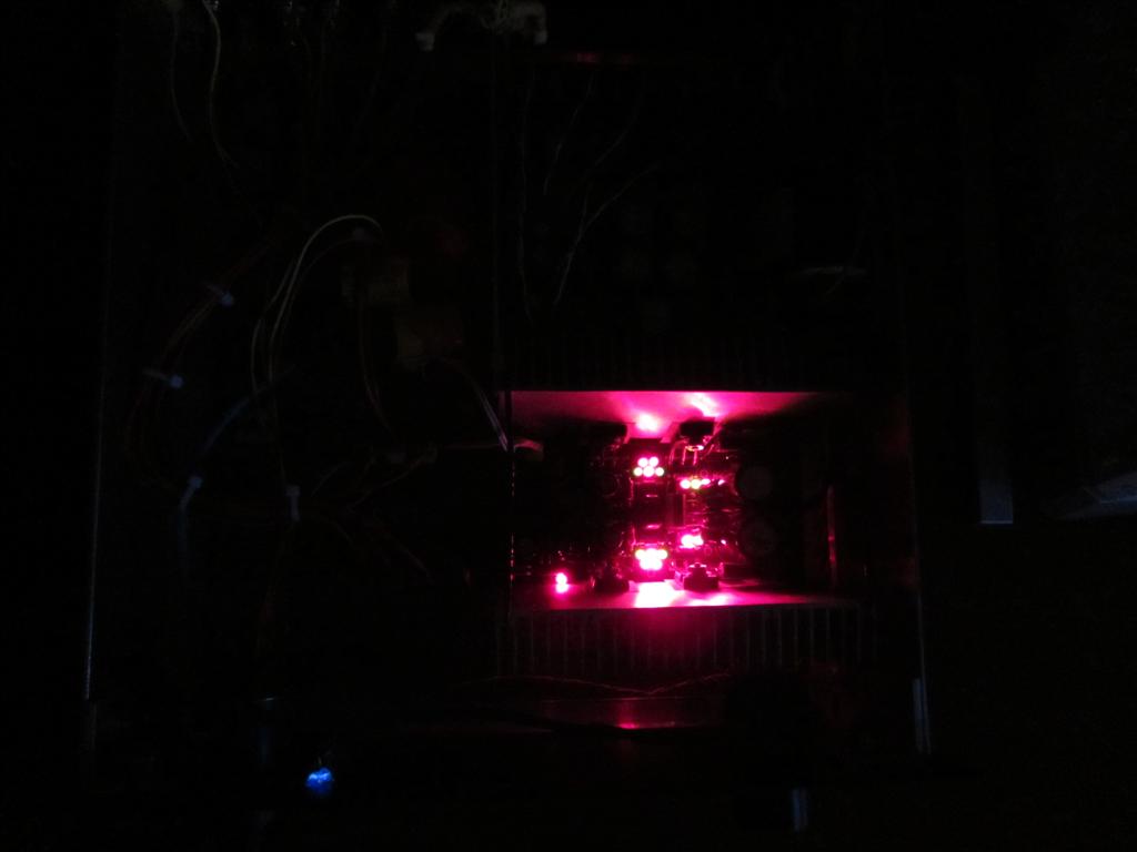

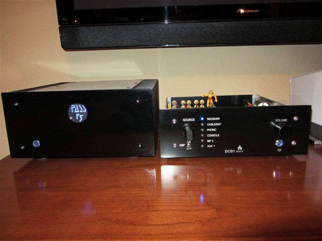

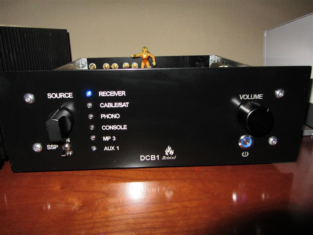

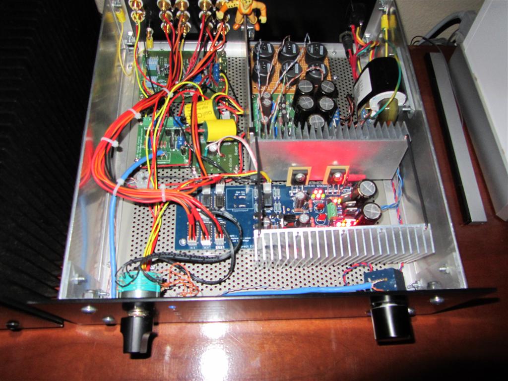

I've got my DCB1 Hotrod singing sweetly and playing nice with the rest of my system. I was using Broskie's 6SN7 as a pre and it was great, makes me sad that it will either only gather dust or be dismantled for parts......🙂 , Not that sad. This is one piece that is staying in my system for a LONG time.
Thank you Salas! It sounds wonderful!
Enjoy the pics.
Ron

Very nice build and interesting front panel design. Enjoy.
