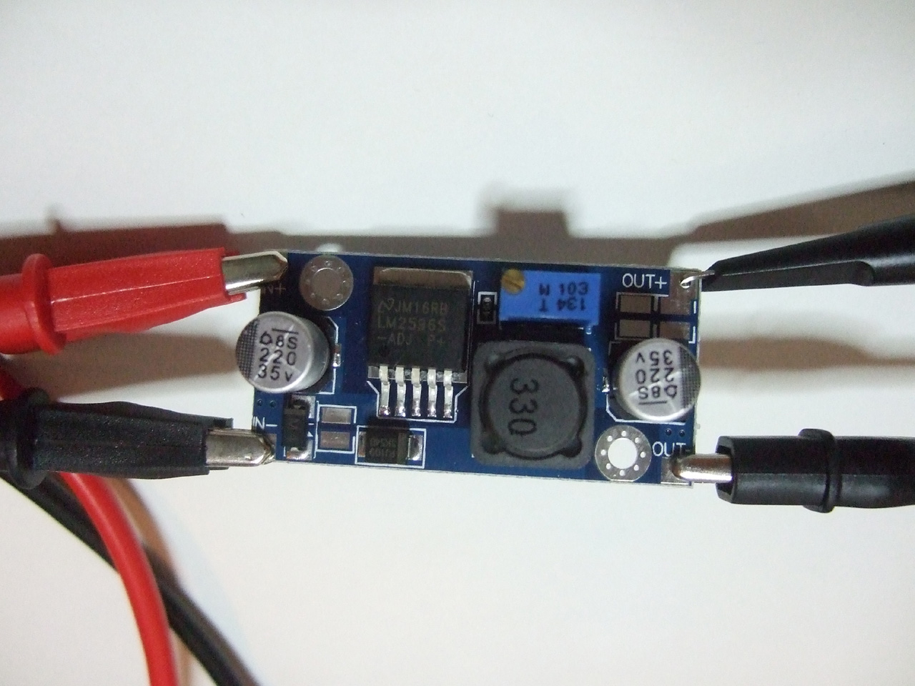

Anyone ever try feeding one of these with laptop power supply bricks? Most are 19v which might be a little low, but perhaps less losses since you could skip the rectifiers. Just a thought since I have a couple lying around.
Capacitors coupled B1 takes monopole, this one takes bipolar PSU. Better avoid switching PSUs anyway unless it is essentially practical to use one. And better filter it further. Even DC to DC converter regs produce traces of their inner works along their DC output.
...And here is an output noise example from some LM2596 buck regulator PCB I had around. Has the datasheet output filtering configuration. 10V input 5V output -no load- in this take. High efficiency step down switcher yes, steady DC output yes, much current capability yes, clean enough for hi-res audio PSU use rather no.
That ripple goes to 60mV peak to peak when it gives 1A. It receives linearly regulated DC input in the test, I don't know if it adds even more stuff if fed from just bridge and capacitor. Typical laptop bricks can be worse or bit better but that's the deal more or less. Silent SMPS are costly and sophisticated. Like those for Hypex Ncore amps.
