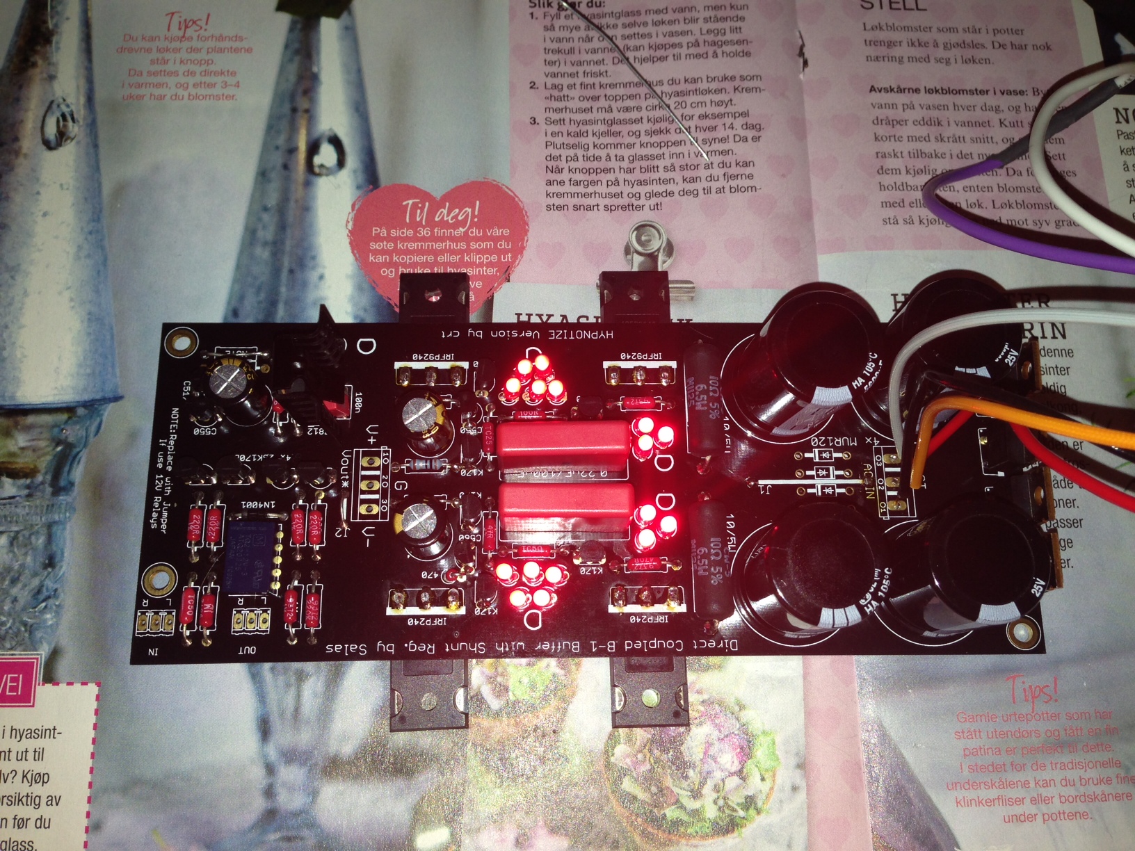

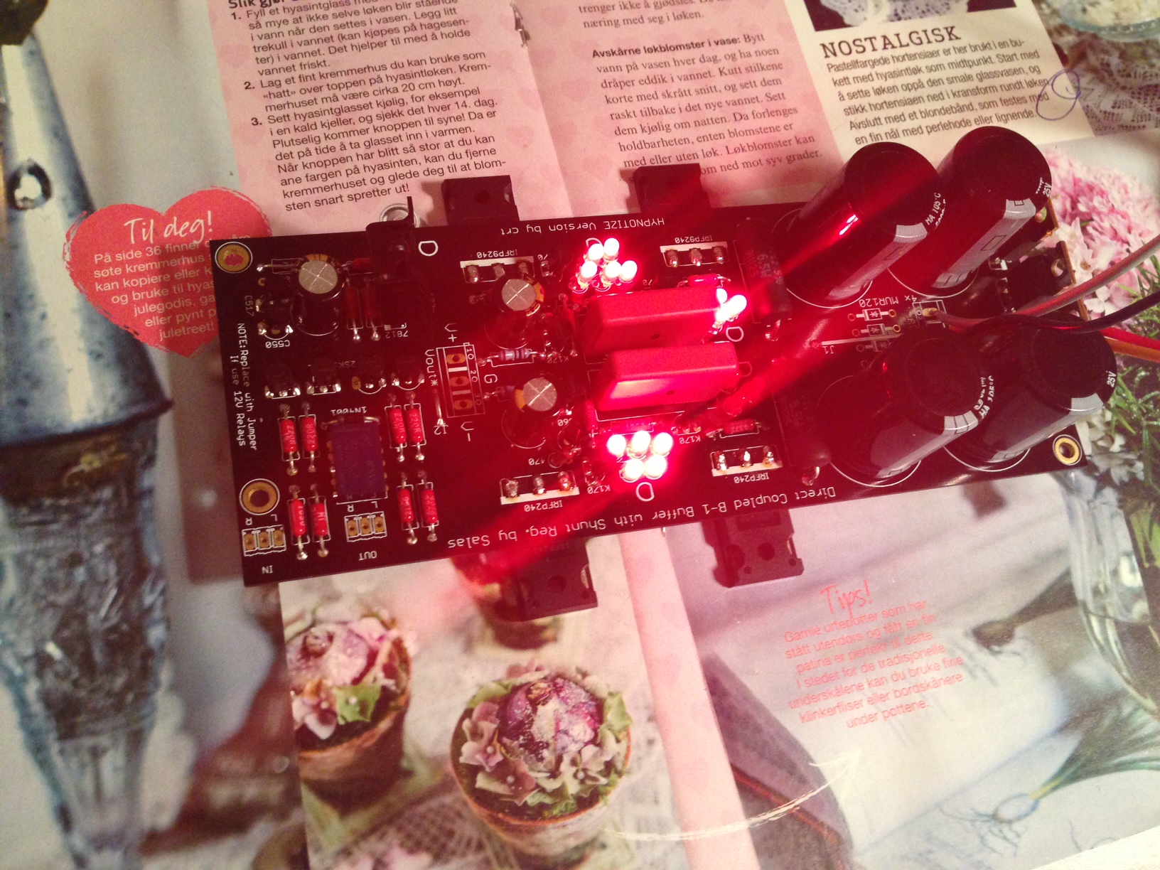

Had to "power up". Just for some seconds without heatsinks attached. One mosfet got very hot really fast btw.
Almost all leds glowed.. But not all. 3 of them did not.. Will look into this tomorrow I guess. Check orientation and so on ... 😉
Did a couple of measurements between V+ , G and V- ... Got +9.95Vdc and -9.96Vdc

Sorry it this is like spam? Had a visual check on those leds and just as I expected. One was in wrong direction..
Unsoldered it and in again.. There is light 🙂 - The relay clicks in after some seconds..
Had it on for a couple of minutes and measured V+,G,V-... Got +9.86 and -9.86 Vdc... Must recap this thread to see what other measurements that has to be done to make sure the buffer is ok.
My transformer for the test is a 15VA 🙄 2*12V transformer. (230Vac mains) - and I have another identical one also..
I measured it and it actually measures aprox 13.8Vac - because of somewhat higher voltage in my house. (approx 235Vac)

If the dc offset on both audio outputs is below 5mV, you are OK. Only sink it first. Secondary check left to do is to measure voltage across the 10 Ohm resistors, then divide by 10 each, so to verify you got 150-200mA running per side.

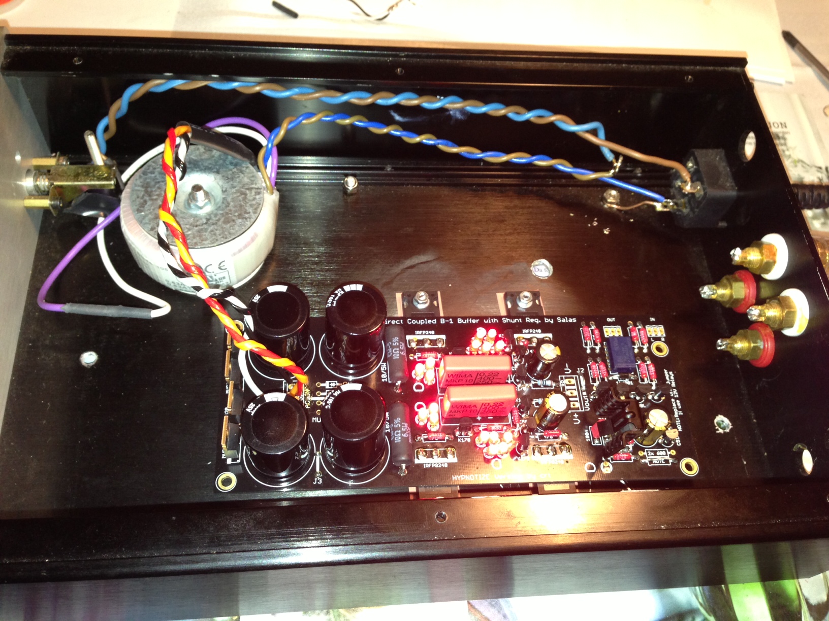

Had an old cabinett. Sinked the dcb1 to the chassis and put it on.
Waited about 10 minutes and did some readings.
Vout: 9.86Vdc and -9.86Vdc
DCoffset : 3.1mV and 3.0mV
Over the power resistors: 1.66V (IRFB9240 side) and 1.55V (IRFB240 side..
These are good readings right?

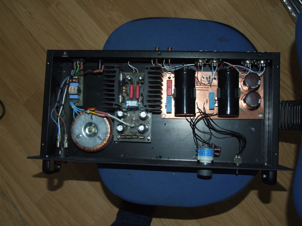

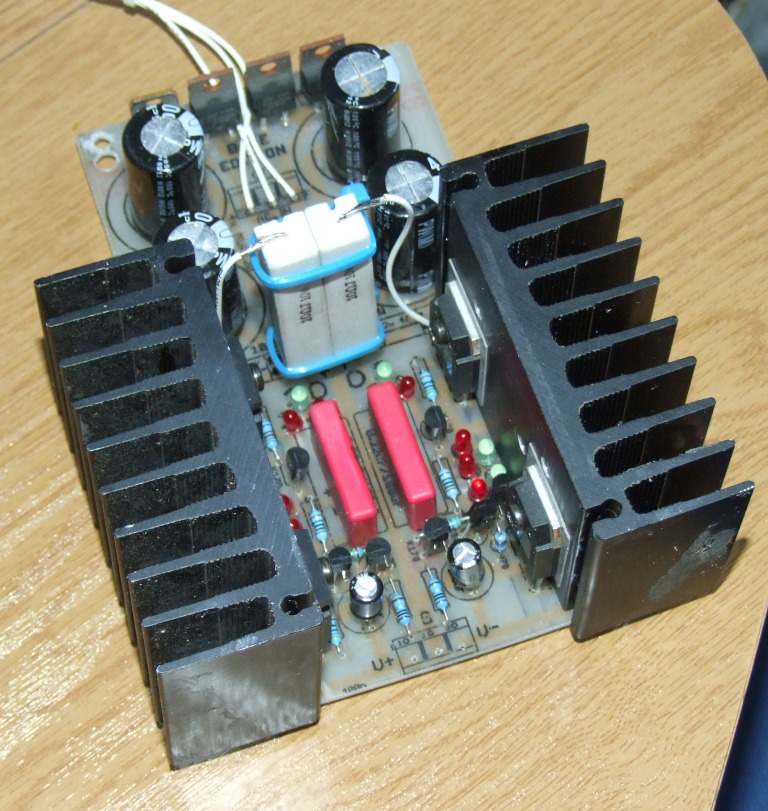

All depends on how HOT ROD you are going.
At 300mA you will start to need heatsinks.
I'm running 10R and everything is nice and cool. At 4R7 even the 2E heatsinks were getting VERY WARM (50 Degrees C)
