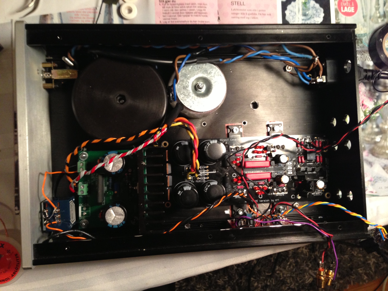

Will be back - but I have sound 🙂 Made it with a lightspeed attenuator. Everything is splendid..
I almost gave up on the lightspeeds some time ago..

I'm almost done with mine. It is a balanced version. I must admit it sounds REALLY good. This one is a keeper!
And to think I had put this project to sleep thinking of maybe never building it... How crazy was I!

Well - been playing for a couple of hours now.. This little thing really is good.. Thanks again for great work and great help..
