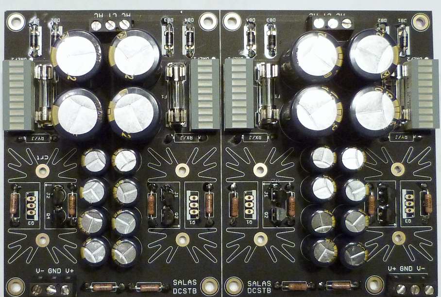

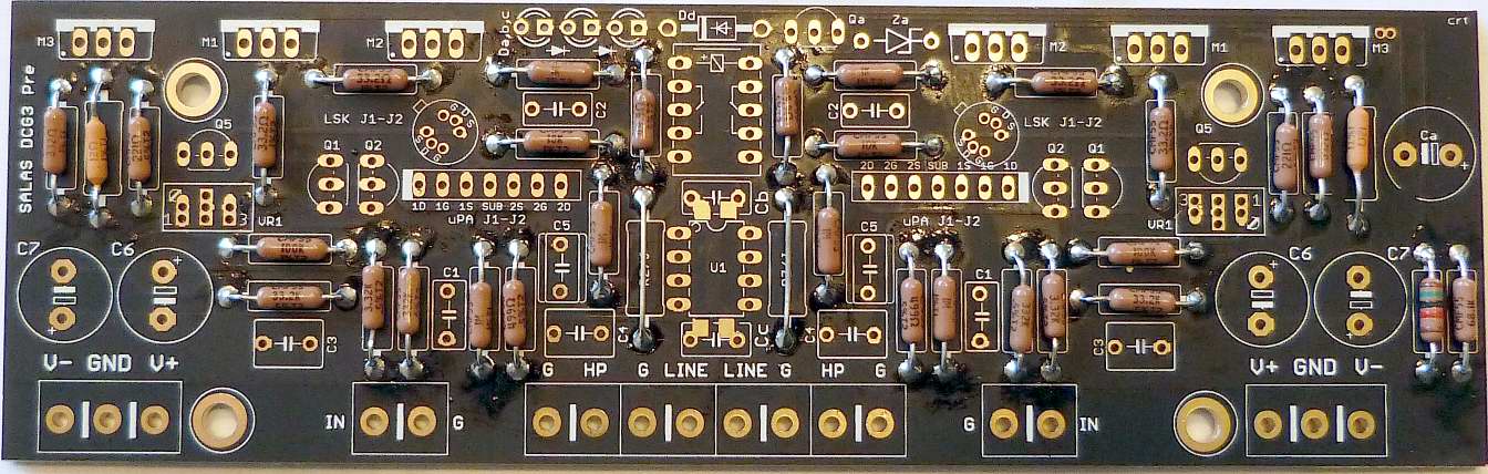

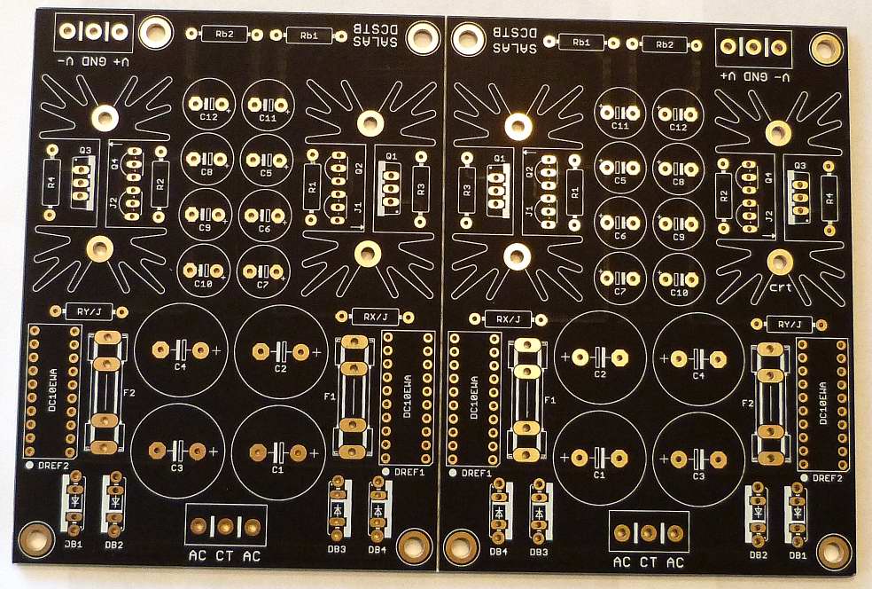

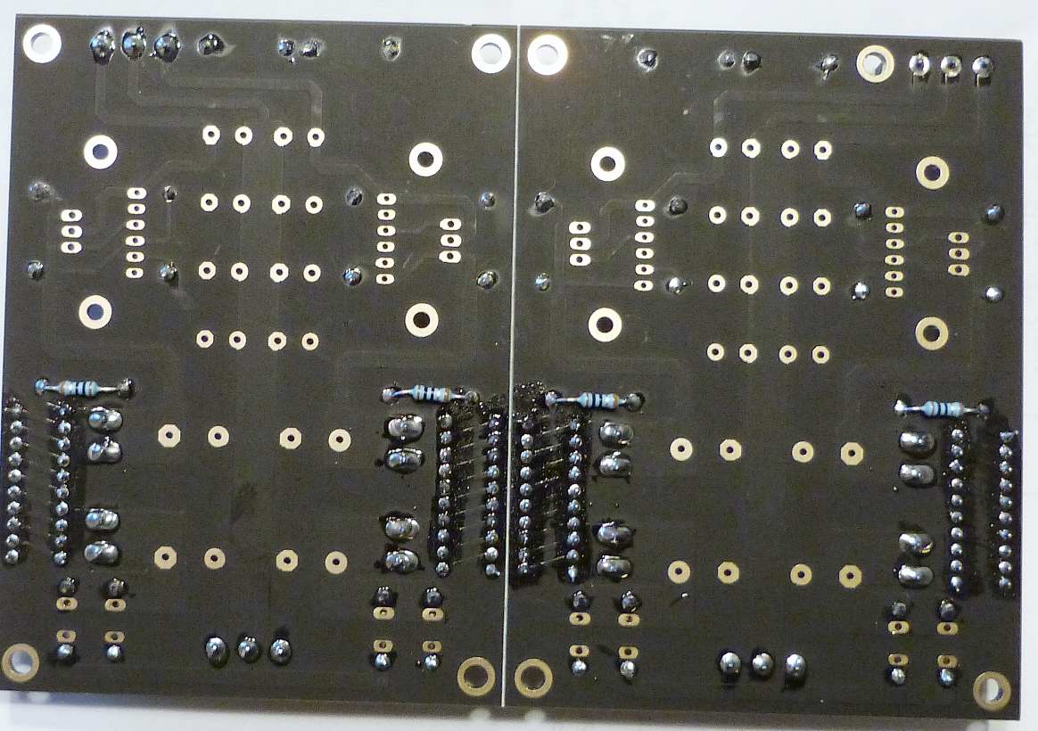

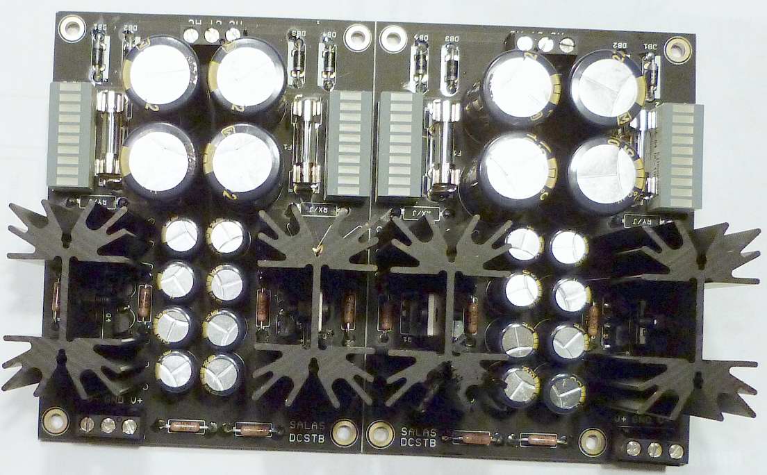

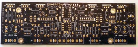

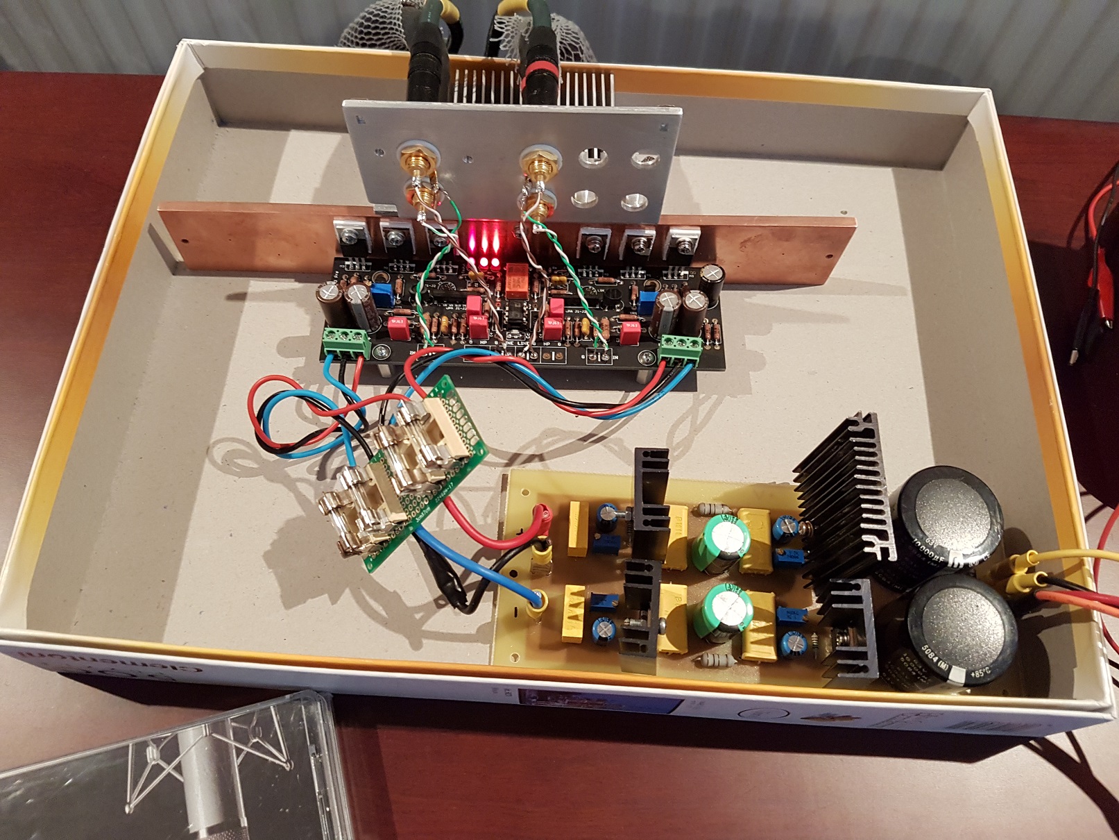

Made some progress today, a few pics.
Paul
Hey guys, Happy New Year! I have a couple of questions as I have zero experience with the headphones. I am not sure I will be using DCG3 as a head amp, but who knows (I should have AT-55x somewhere around). Should I put 7.5R or 12R for higher bias? (These are two values Tea suggests in the kit), or should I put 10R as smh in between (if I put 7.5R for pre use as Tea suggests, will it work as a head amp?)? What RZ I should put for 55x headphones? Thanks!
In general, low impedance headphones (like yours) want current (more bias), where high impedance headphones want voltage. If it was me I'd bias it as high as you are comfortable with and your heatsinking allows. That will theoretically sound best for pre and phones. Although 150ma ish bias is extreme overkill for pre use.
For RZ I'd start with a jumper. It's best on paper although some output impedance on the headphone side sounds better to some people...it sounds looser and less dry. But a jumper is technically the best...I would experiment in 5 ohm increments if you feel the sound is too tight and dry with the jumper. It's kind of headphone dependent.

Another thing, I was planing to use a stepped attenuator with R_out in the range 6Ohm-3.2kOhm (depending on position), will that work with the pre? If so I need around 9-12Vdc(150mA) to power it. Is there any way I can tap on the PSU board maybe to get this voltage without losing anything in performance of the preamp of course 🙂.

I wouldn't recommend so low an impedance in the attenuator because the bandwidth of this preamp will be very wide with such. There is danger of RFI, buzzes, and/or underdamping leading to harsh transients. So if you don't have lab equipment to check its all stable and clean better stick with the 20K-50K recommended range. On the other hand you could just try listen and experience if all seems working smoothly and sounding good if you already got it in hand. It won't be a destructive experiment. You can tap off raw DC from a reservoir capacitor's legs on the DCSTB and regulate with an LM317 or 7809 on some small perfboard and a little sink for it. If its a success I would still recommend to subjectively compare it with some good 20K-50K pot or switcher in this preamp at a point though. Making an easier load on the source equipment. In any circumstance any metal part of any of those attenuators/pots should be referenced at the same potential as the signal's zero return side.
