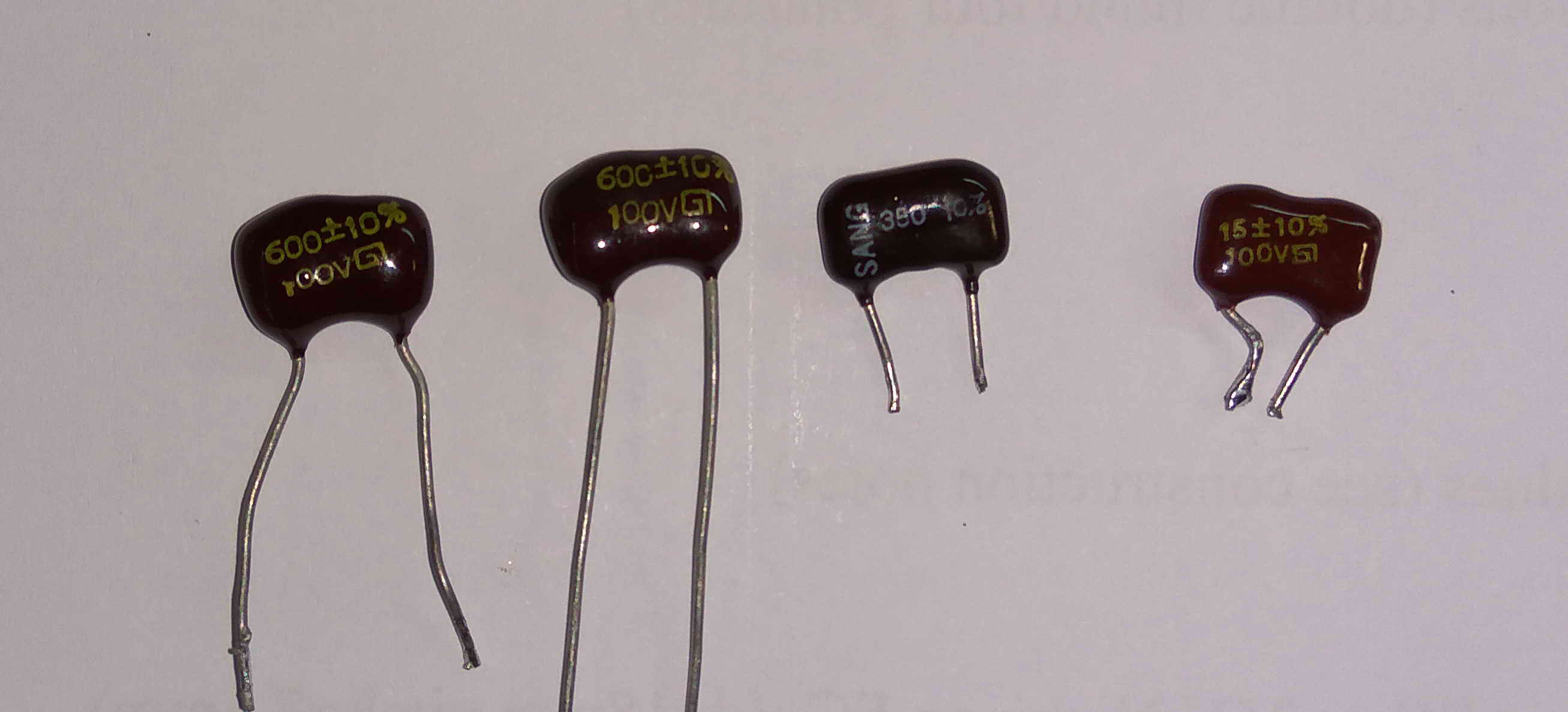

It also takes Shinkoh and Kiwame nicely I see. That is why I wanted roomy resistor places, so to can have options. What country of origin are the SMICAs? The dark green smaller resistors with color strips are German? Those R2s & R12s look like NOS carbon. I hope not compromised by years time carbon because those two values are high and self noise can be a factor.
The micas I have them some time now, I think from the states. I bought an assortment of many values. I do not think I can find them any more.
The R12 are allen bradley ones and I I find something it would be easy to replace. I just used these pars because I had them. The other one I build will be full of dales.
The one with SANG is Sangamo vintage made in U.S.A the ones with the meander like symbol I don't know but I don't think they are that much NOS to have beeen made by ancient Greeks just because its a classical Greek symbol 😀
