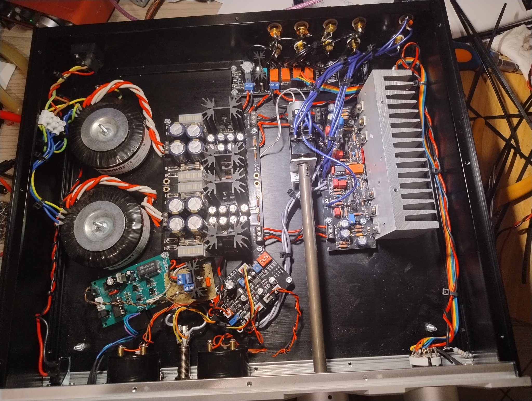

You already found the board that does the pop. Try to alternatively feed the I-Select from the DCSTB's raw DC section not its stabilized output which is shared directly with a channel. From a reservoir capacitor's pins. C1 or C2 on DCSTB. The sink should be well mechanically connected to where it will sit. With thermal paste between mating metal surfaces. So to be both sturdy and to transfer heat to chassis easier.
Feeding I-Select from C1 and then the boards from the i-select out was the initial implementation, but it created a ground loop when connecting the VU-meter control board. Feeding the remote control before the stabilizer is not an option, since it can handle up to 15VDC and the raw DC is higher than that. That's why I was thinking of the alternate plan: TF secondary---->additional stabilizer--->remote control board.

I finally found the time to implement the change, and now the pop is gone! I followed the last plan, i.e. feed the remote control board from C1 of DCSTB. VU meter board still gets power from the DCSTB out. Perfect clean, a slightest hiss with the ear in front of the speaker on the turntable input on max volume.
Now the small board gives a more DIY flavour to the implementation. I have cleaned up the cabling a bit too. When back from vacation, I will see how to improve the cooling. I think I will just fit and secure an aluminium or copper bar between the heatsink and bottom plate.
