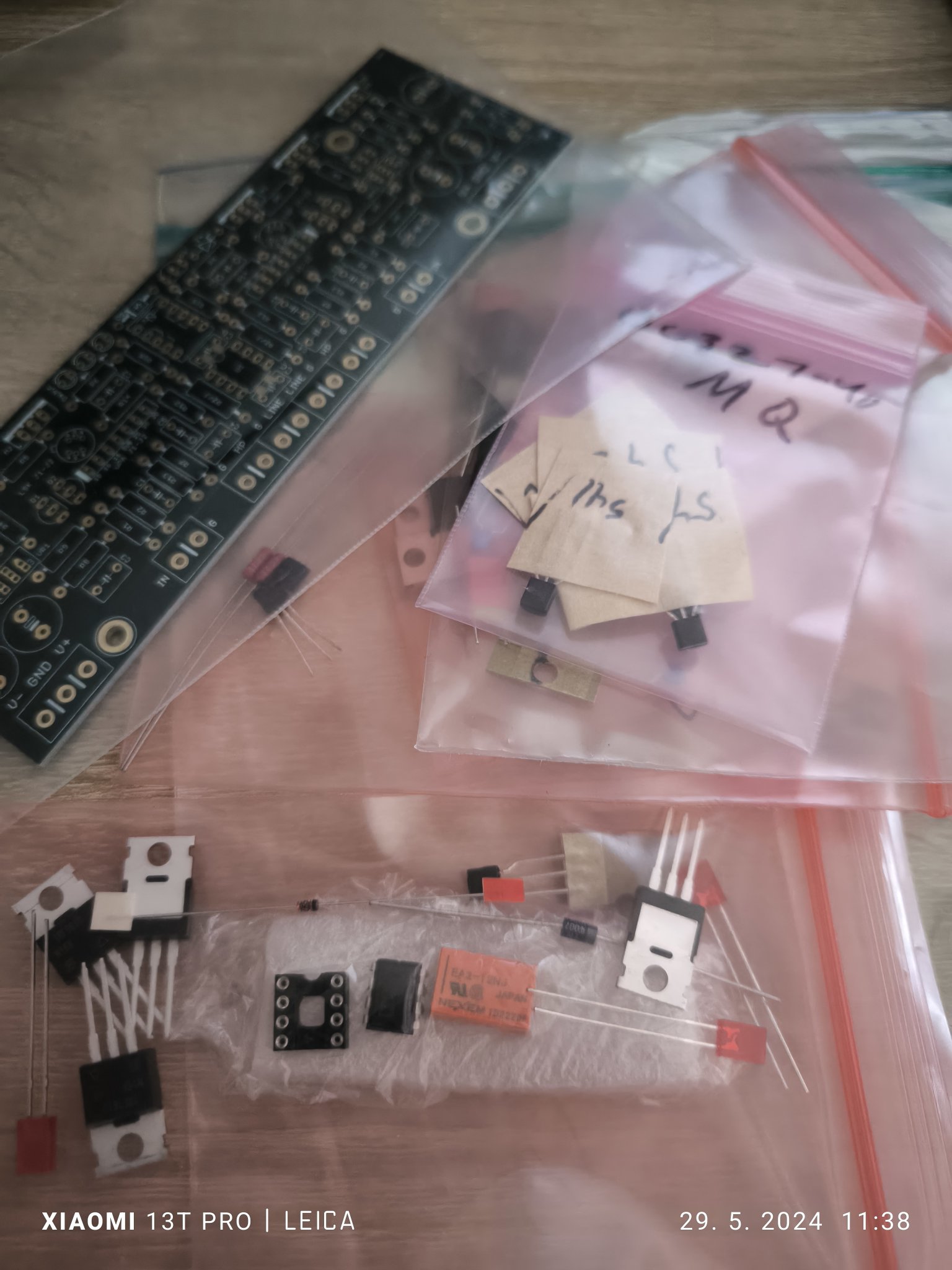

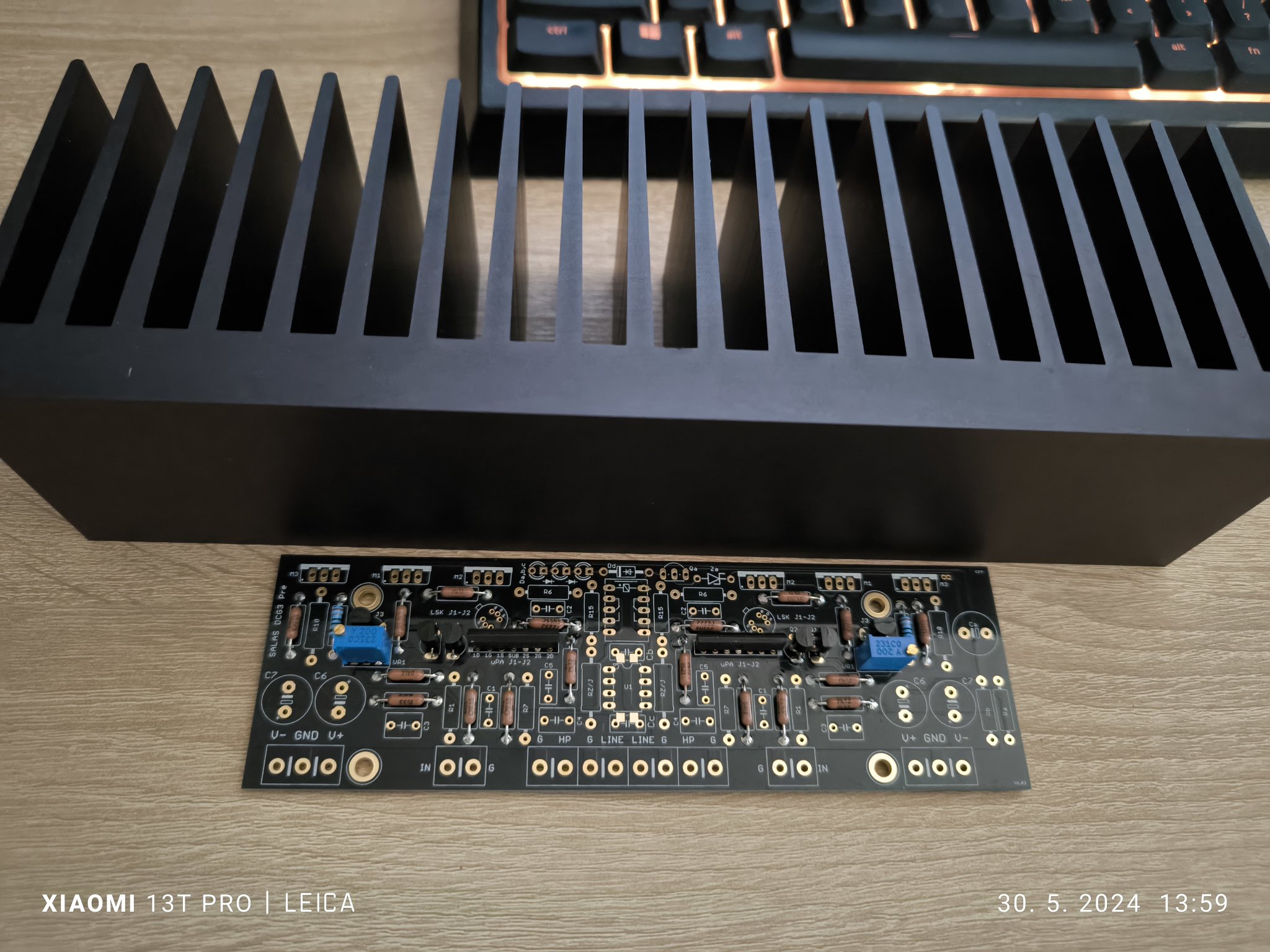

Just a short test. DCG3 worked on the first power-up. I set the DC offset below 1 mV.
The current through resistor R3 is 4.4 mA and through resistor R10 is 171 mA 😛
I'm just waiting for the DCSTB boards to fit it to the modushop box. And lest I forget, that huge heatsink is absolutely cold...

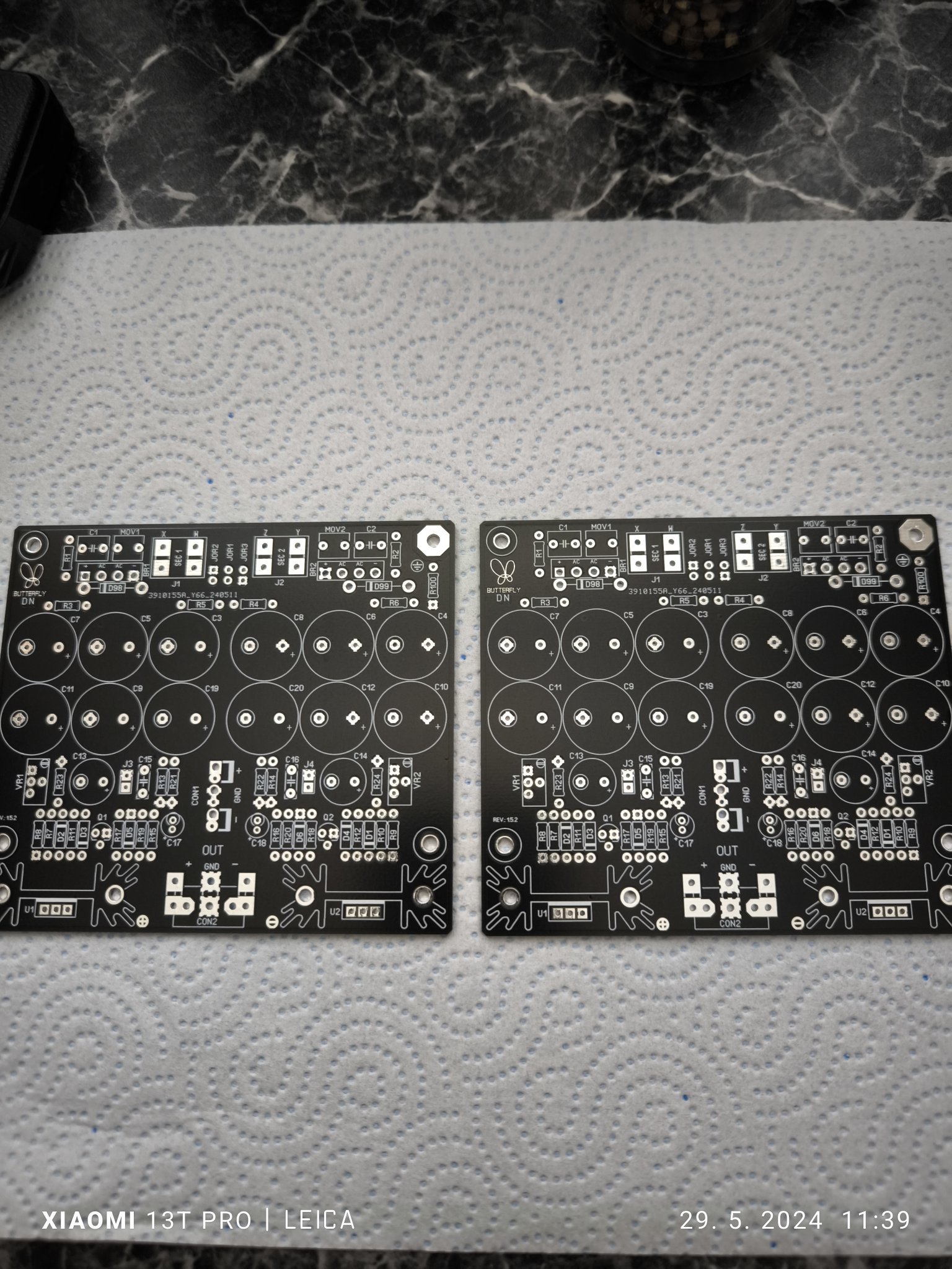

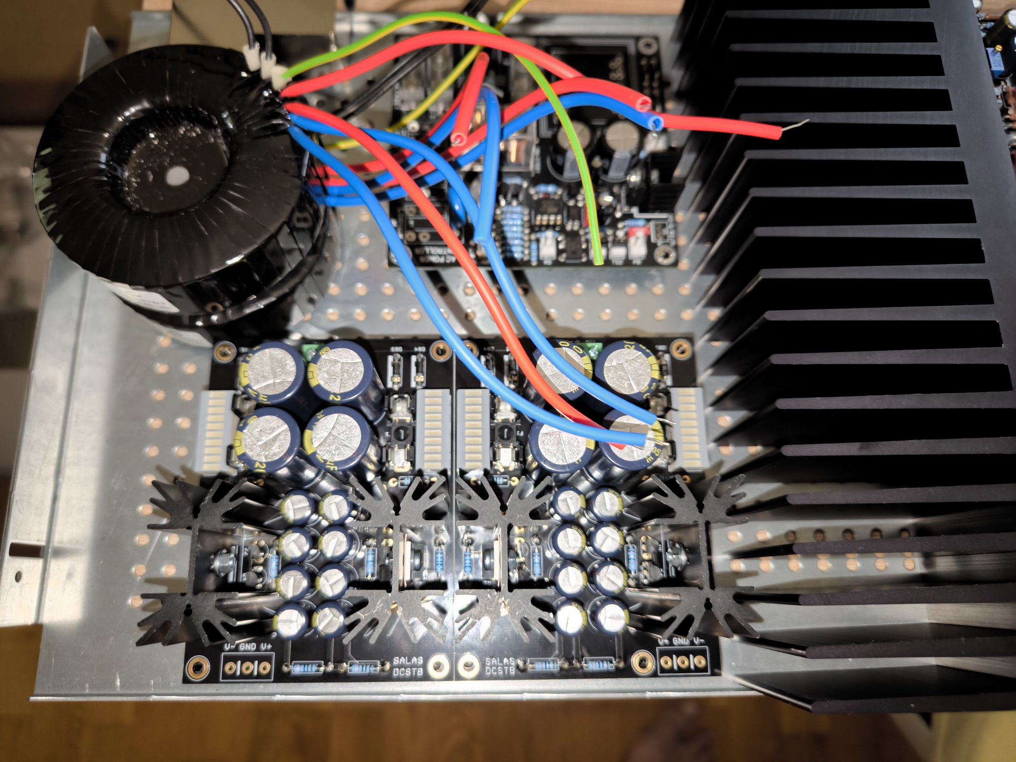

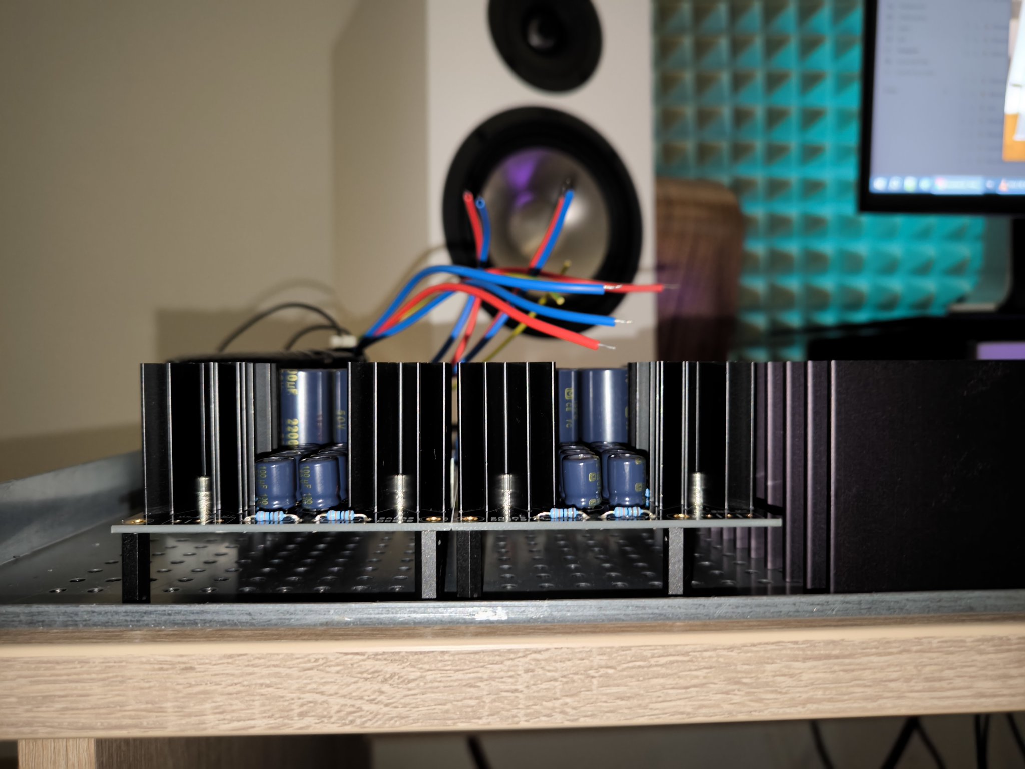

I'm playing a bit with storing DCG3 in the modushop box, ...but it's going to be a bit cramped in there. Only room left for DCSTB. The heatsinks on the power supplies will be 38 mm high + 20 mm spacer and will be nicely flush with the large heatsink. If the power supplies were too hot, I would buy a fully vented aluminium cover. Still design the front and back panels and send them to production, ...

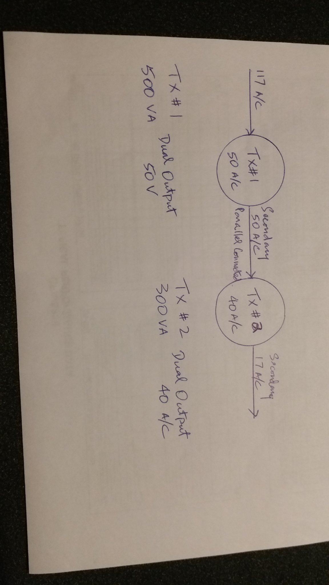

I have a question on the subject of transformers. I have 2 surplus transformers which are doing nothing. I am thinking of connecting them to generate the 17V output for the DCSTB. I want to connect the 50V secondary of transformer #1 to the primary of transformer #2 which has a rated 40V output. I have done the connection and the end result is about 18V unload. Is this acceptable practice? Thanks.

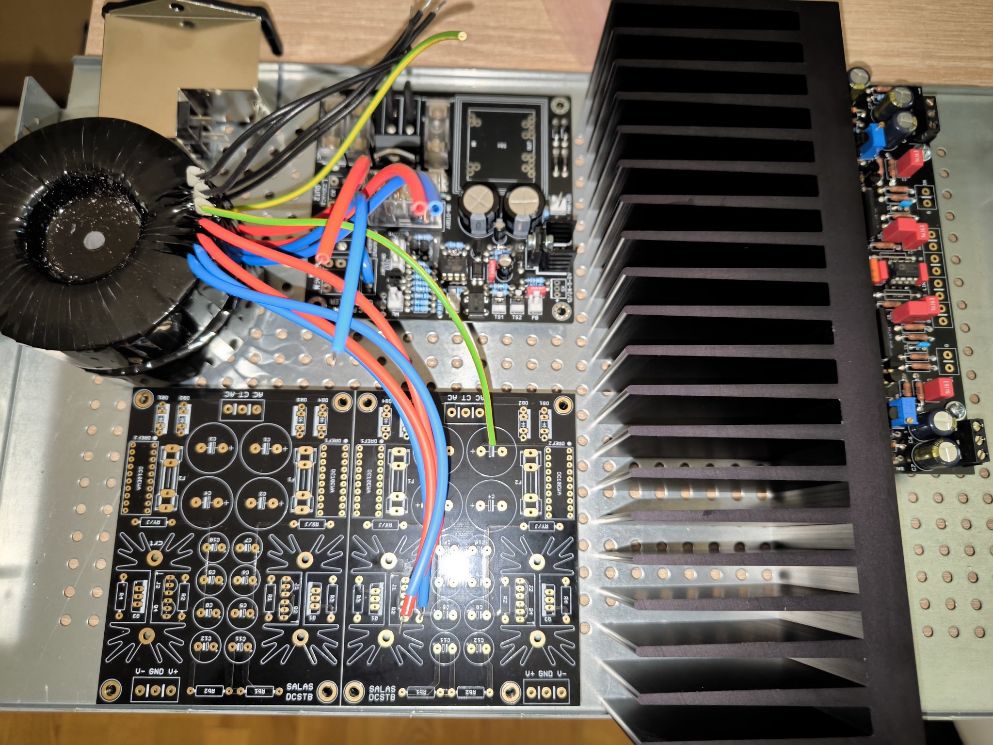

Friends, so the final layout in the box. It's probably the best layout since I have limited space, the transformers have to be placed on top of each other.

Nice!I had a similar situation (space) and put the transformers under the Psu/rectifier board.

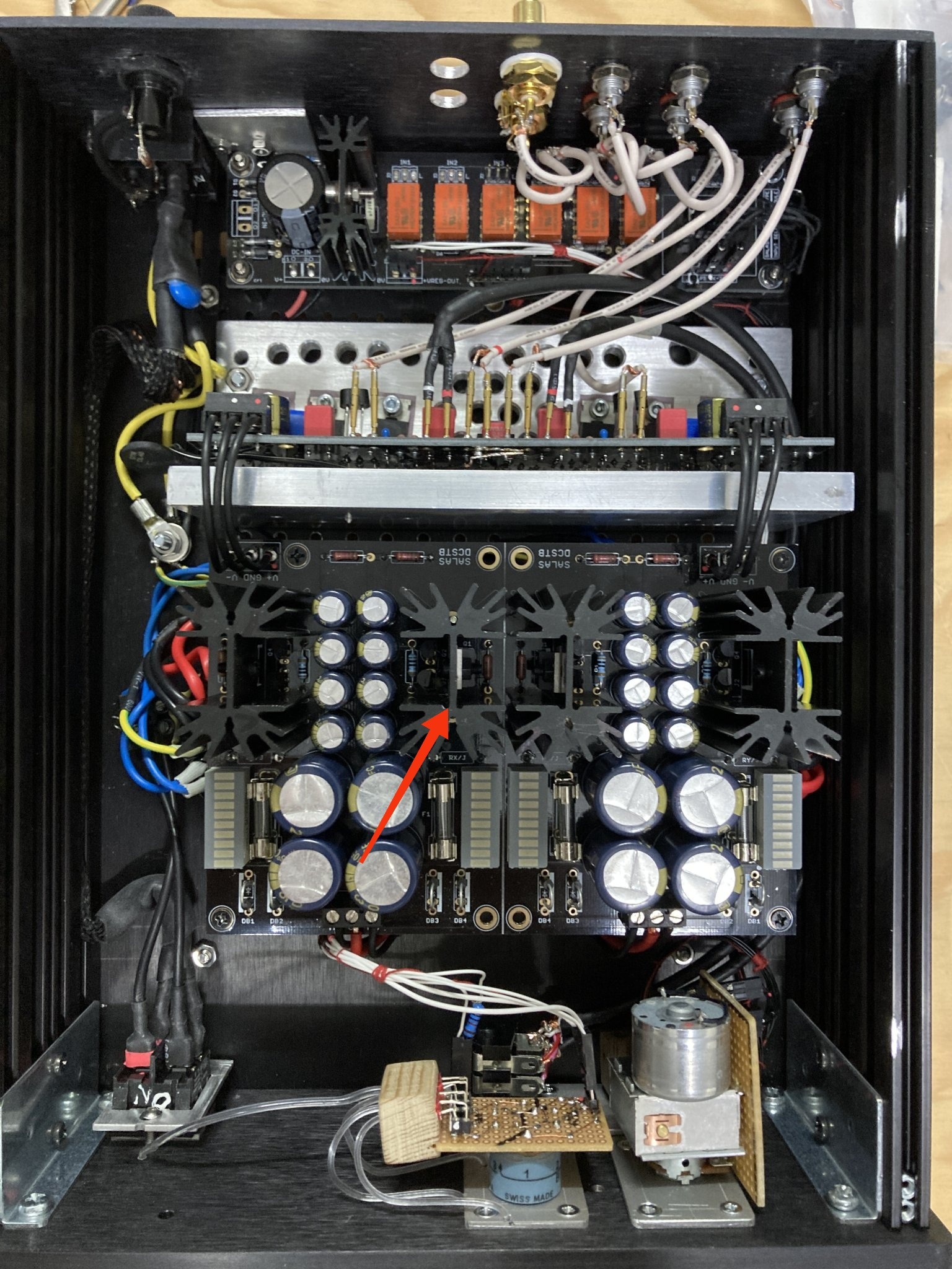

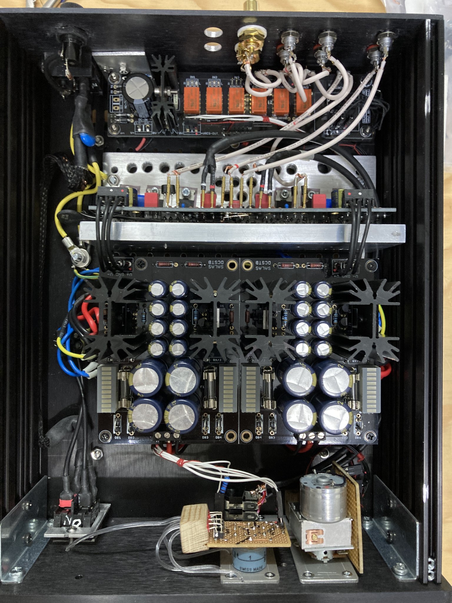

It's been a while that I am enjoying DCG3 a lot. I have just one issue to fix. When I turn DCG3 off, there is a pop on one channel only, probably the one feeding with power the VU meter board and the remote control board. I see one VU meter hitting peak at powere off. Any ideas of possible solutions here?
Regarding heat dissipation, I took some measurements with the air condition turned off and DCG3 preamp positioned in the furniture shelf (about 10cm clean space on top). Room temperature 31C, heatsink on top 56C, heatsink inside 62 (there is a hole on the top of the heatsink that allows the probe to dive inside it). I measure a couple degrees lower when running in real life conditions (ambient temperature about 27C). Should I worry and opt for a larger heatsink?
First inspect those extra boards with the scope when powering off to try locate where the pop occurs. Also rearrange their wiring to see if influential.
Fix the sink to the chassis floor so to spread the heat. Directly or put an aluminum block in-between floor and sink not to drill it again for the Mosfets.
Did not have much time to probe with oscilloscope, but when I find some time, what should I try to find with the oscilloscope?
But I did some tests, isolating the two suspect boards and the problem originates from the remote control board.
The remote control board only controls the motor, no signal on it (no mute function etc.), but it is powered by the I-select 12V out, which is fed by the DCSTB output. I had tried to feed the I-Select from the capacitor bank but that created a ground loop with the vu-meters board. Since my transformers are 18-0-18, I think I could build a reference design 12V stabilizer circuit in a small board, taking power from 18-0 of one transformer to power the remote control board and check if this eliminates the issue. Will report back if this is a success.
Regarding the heatsink, It was already drilled many times, so drilling again is not an option. Either a bigger one or a bottom plate as suggested will be the solution, but both options require full disassembly of the preamp I guess. Is it enough for the heatsink to just sit on the bottom plate to avoid disassembly or should it be tightly screwed there?
