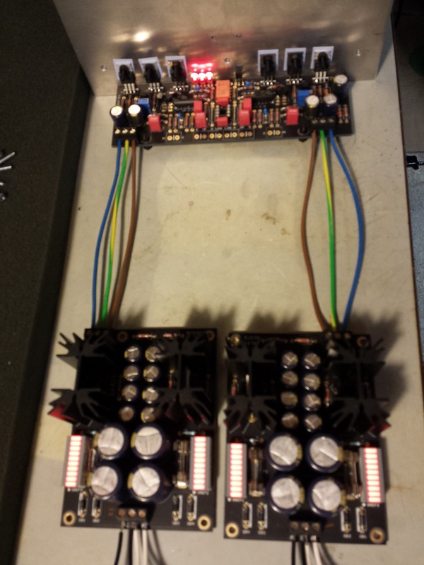

Populated and tested DCSTB+DCG3.
After about 15mn heatsinks become a bit warm for both DCSTB and DCG3. The voltages across R10s (7.5R) are 1.056 and 1.060V, indicating around 140mA.
Don't ask why the wires are so long. Just to test.
