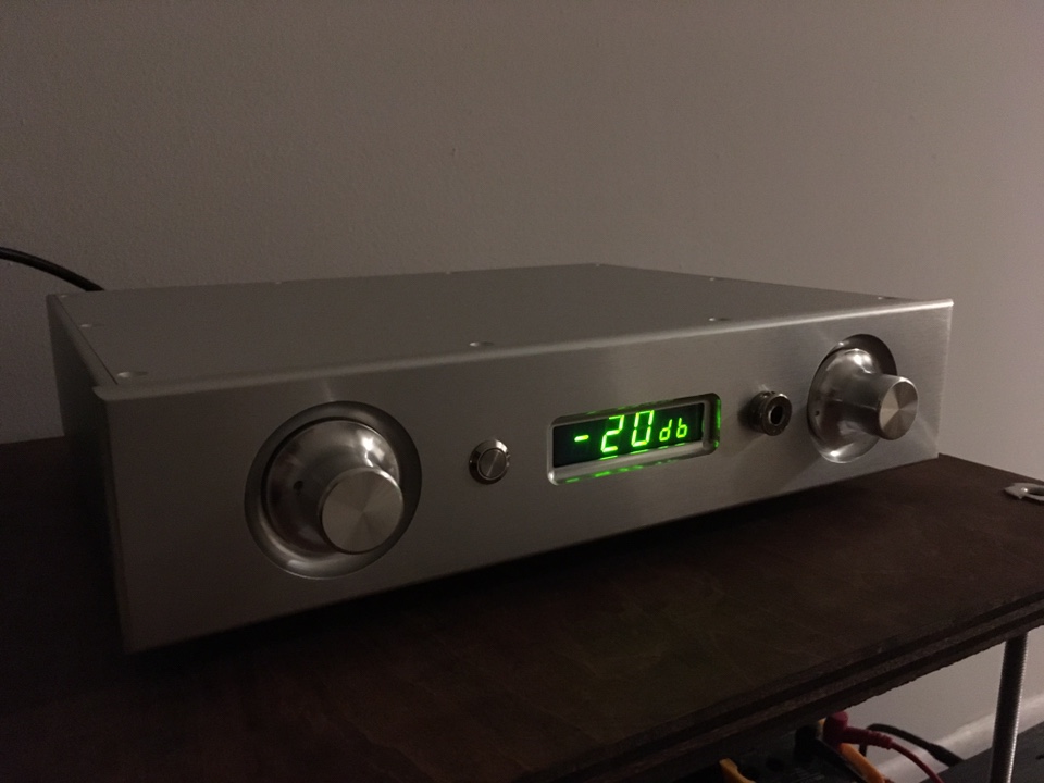

Nice build, congrads ! Do you have a photo of how you fit everything inside? 🙂

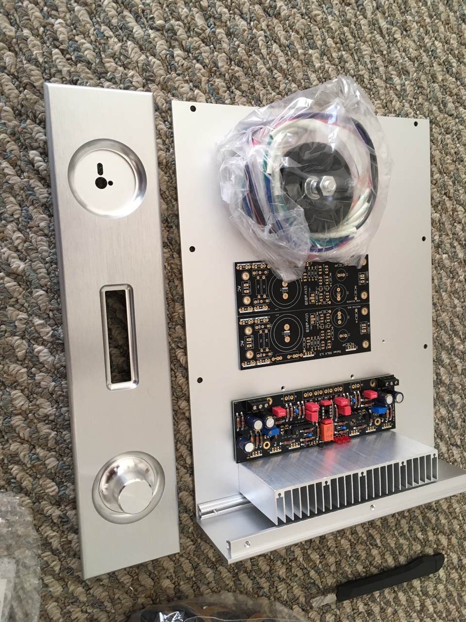

Will not be able to take a photo of the final look,but here for the reference:
In addition:
Small eBay regulator board for the controller goes to the front left between faceplate and the trafo.
Attenuator and selector switch goes to the rear right behind the pre board.

Where did you get your volume control and display?
Fab

Thanks much Salas! Got the test run going. The music sounds amazing! No artifacts so guess all is good. Using line out to amp and to FR speakers.
Still ways to go to get everything finished though.

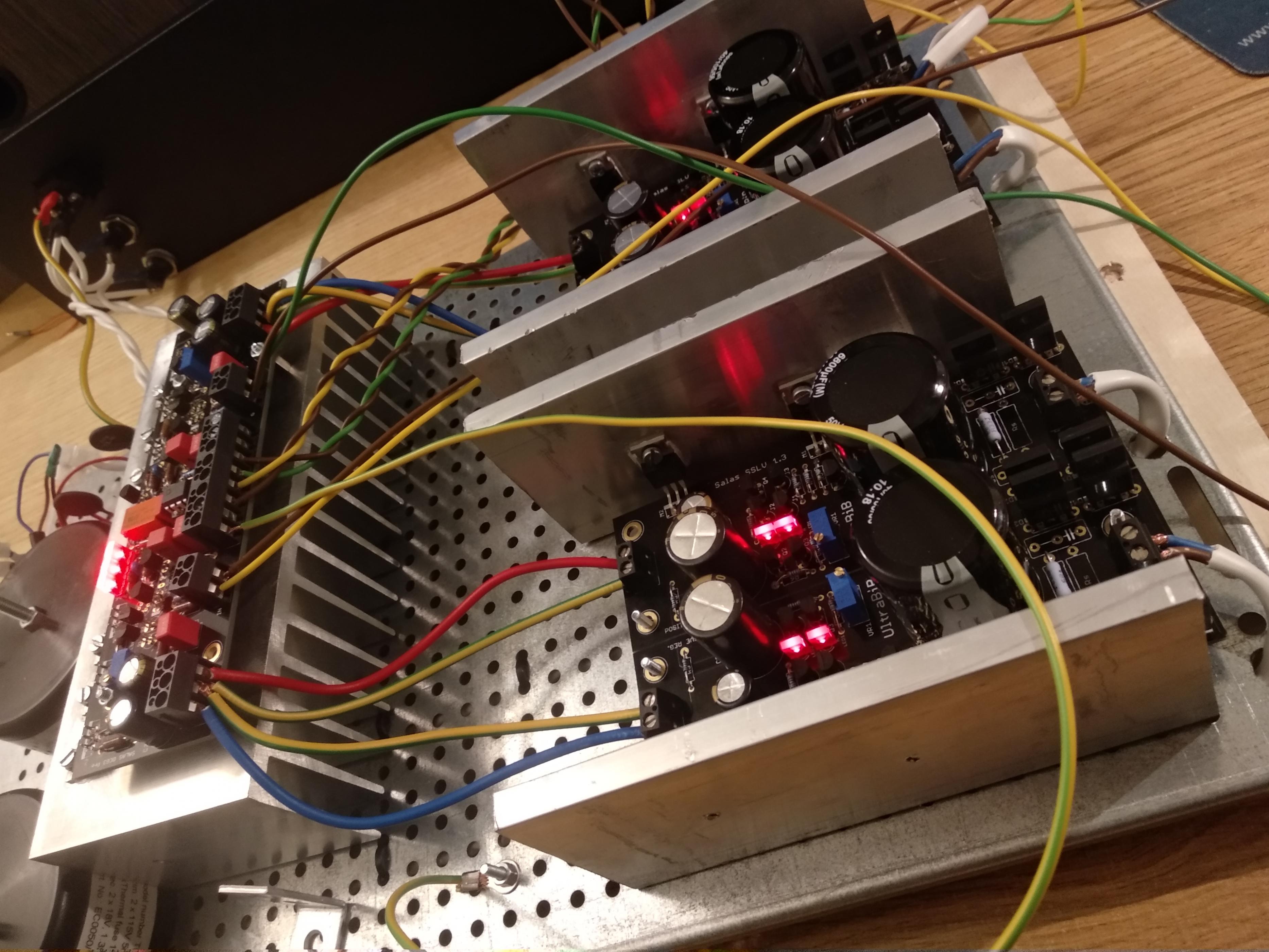

Need some help troubleshooting.. I have re-arranged some stuff in the build and fired up again. One of the negative UBibs show no voltage across (the lights are off) when connected to the DCG3. Otherwise disconnected all is fine. Any idea what could've damaged in between and what to check first?
@trancendent
Sounds like after the rearrangements you somehow short that PSU's output and its current limiter kicks in. See if it's about you had burned the DN Mosfet on that negative rail or an insulation has been compromised or you simply miswired something.

Thanks Salas. Here's short update after quick test. Didn't have much time to investigate in detail yet.
Connected PSU to DCG3. Shorted the inputs on DCG3 and connected the output wires - the PSU lights go on when fired on. I did remove the HP G wire to chassis though.
Could this indicate wiring issue on inputs? I have tested Mosfet insulation - no errors.

First determine if its a channel issue or a PSU issue. Exchange channels to PSUs.
False alarm. It was insulation issue on failed PSU. I should really tripple check that all the time. Thanks anyways🙂

Anyways, testing new heatsinks.. playing for an hour now. Both positive regs gets quite hot, but easily touchable. Negative ones barely warm. Kitchen thermometer goes up to 44C, but knowing the quality I'd add up couple more🙂 Doesn't sound too bad in any case..
I also noticed that at working temperature the voltage from PSU ranges ~16.3-16.5V. Worth adjusting to 17V exactly?
