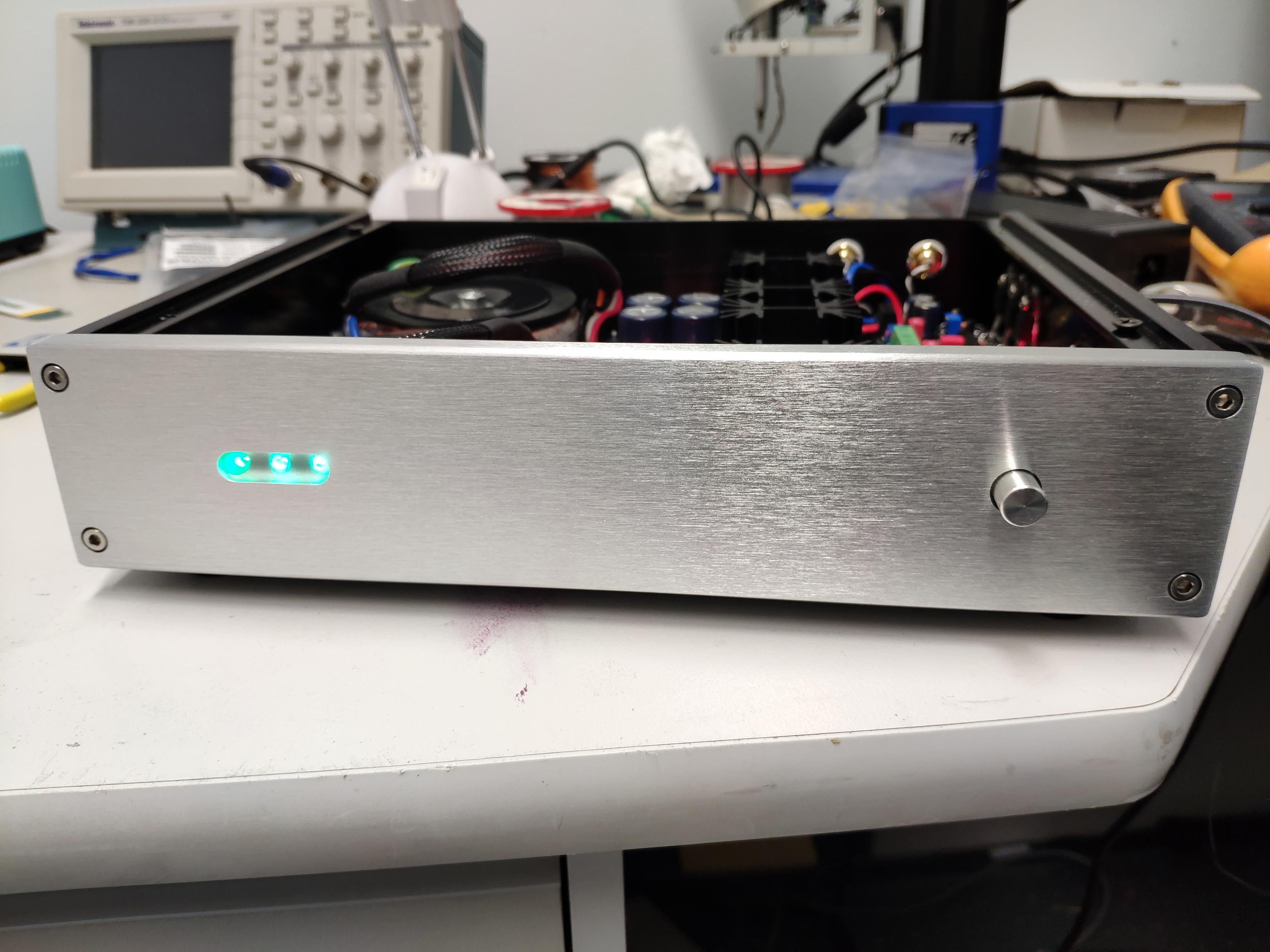

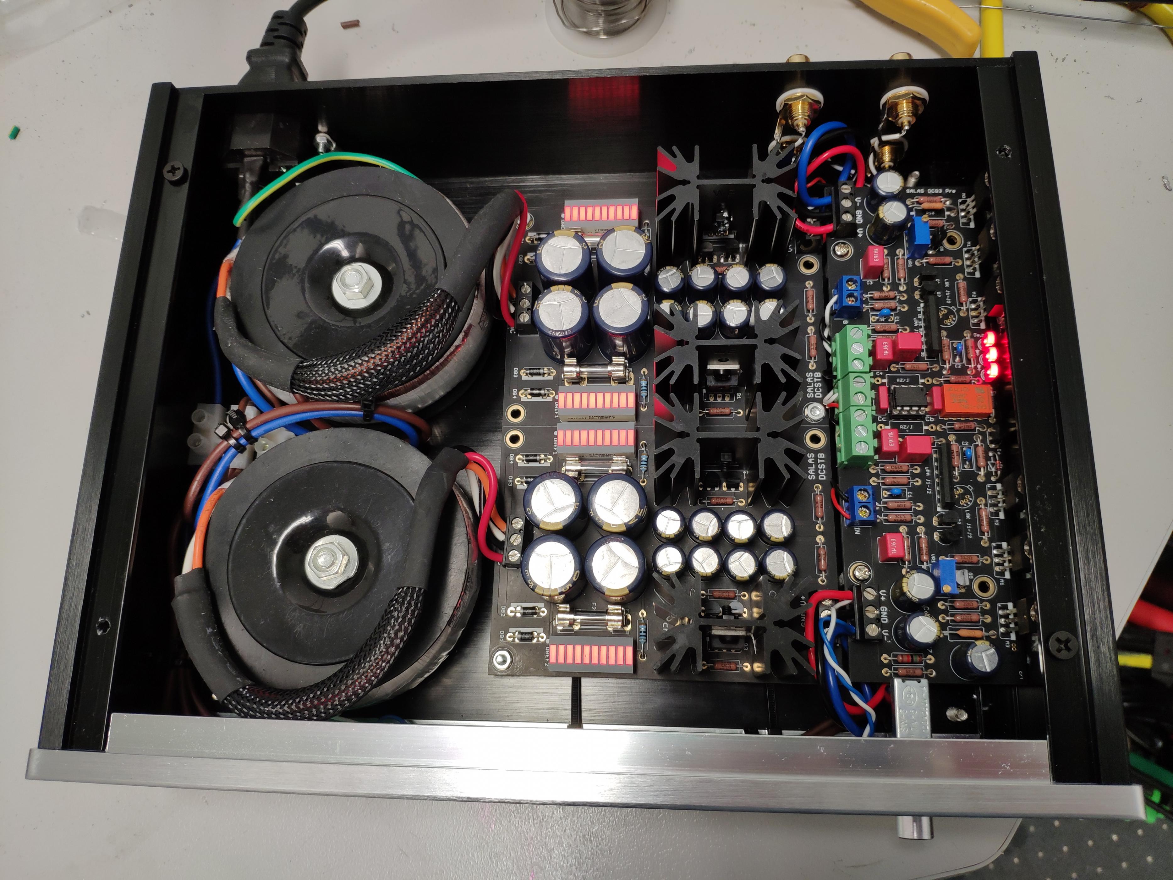

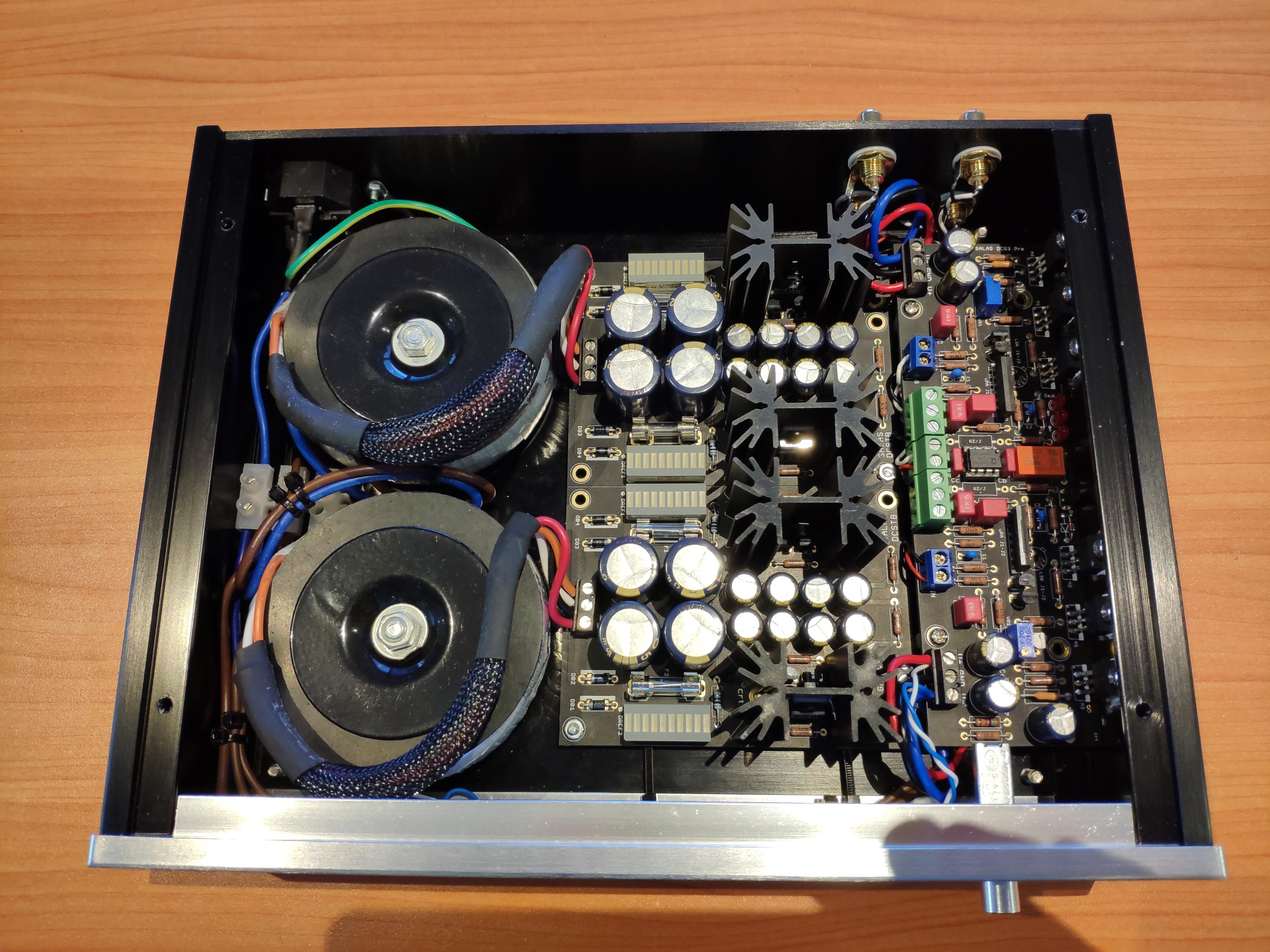

WoW Nice and tidy build!
I like it better with the lights on 🙂
What are the green thingies on the left of your front plate?
Very nice build, exactly planned for floor space use. With what attenuator and other gear it plays with, and how do you like it?
Thanks Salas! Its a great design by you. 😀 I am using this for attenuation and source selection :
