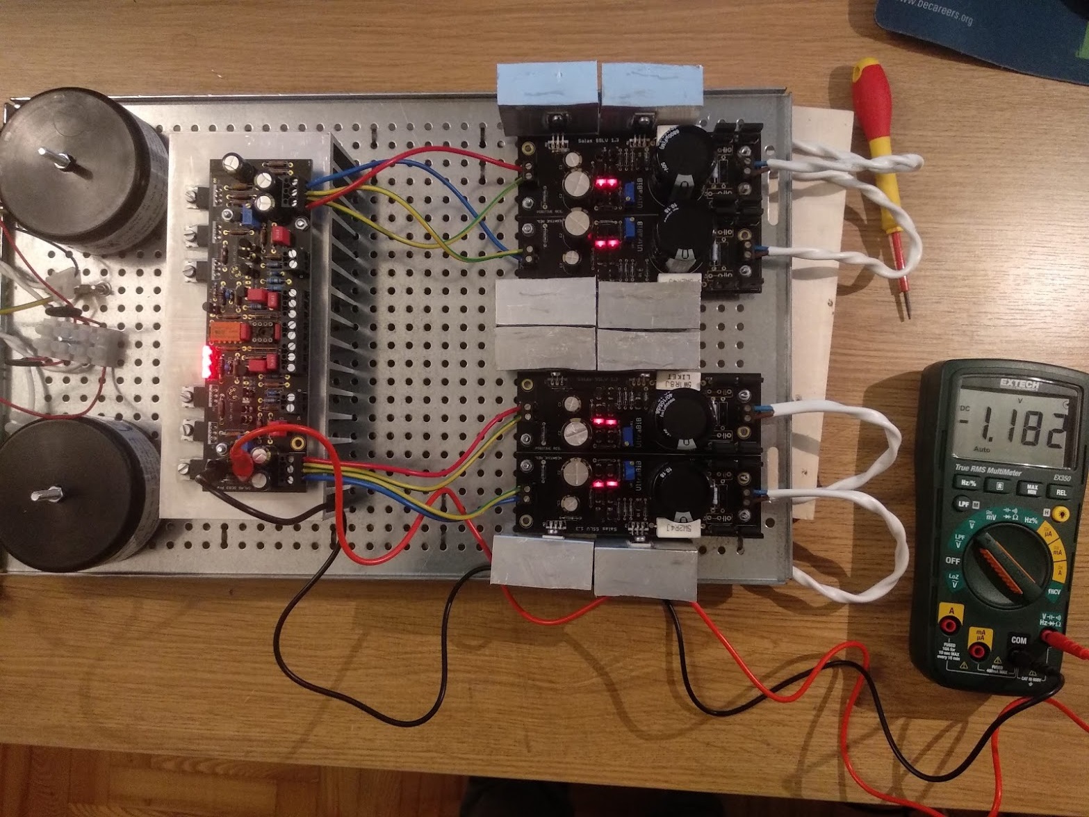

Struggling still....so it plays music so that is something.
Still have a hiss issue and then some horrible noises further up the volume range.
I hope some of you could maybe find the time to have a quick watch of this video I made to help diagnose?
YouTube
Just had a look at your video - the way those woofers are moving when you're changing the volume looks like you've got significant DC offset. I'd suggest disconecting the DCG3 from the rest of your system and re-doing the DC offset procedure - remember to let it warm up before tweaking the trim pots. If the offset is too high could the squealing be oscilation in the servo circuit? Once you've got the figures down to low mV at worst try listening to it before putting the servo chip back in - won't hurt for a short time and could tell you where the high frequency noise is coming from - good luck
Thanks for that. When doing the DC offset test ...with the OP amp removed.....I can get down to 2mv or so....but without shorting the inputs. If I do short them then it jumps up to several hundred mV.
Whilst this was playing last night I measured for DC at the speaker output terminals on the power amp and only saw a max of 30mv one channel and about 10mv the other.
Shall try the test you mention also thankyou. Could it prove a fried opamp ....maybe static blasted?

Another question, is the noise on both channels? It would be odd to damage a transistor on both channels at the same time.

OK, got 4 out of 8 mosfet insulation failures on ultra-bibs. Worse on DCG3, only 2 out of 6 were fine. How useless are these shoulder washers.. Gonna have to go for nylon screws.
If you're drilling/tapping the heatsink, be sure to carefully countersink/debur the hole afterwards. The soft aluminum can form a raised ridge that can pierce the flexible insulator, if that's what your're using. Also never hurts to gently run the mosfet over some flat sandpaper to ensure there are no sharp parts.

I did tap the holes, but was sure that the surface was quite clean afterwards. The insulator is regular mica pad. The main issue I think is that screws end up slightly tilted because of my "great" drilling skills 🙂 Anyways, the plastic screws should do the trick.

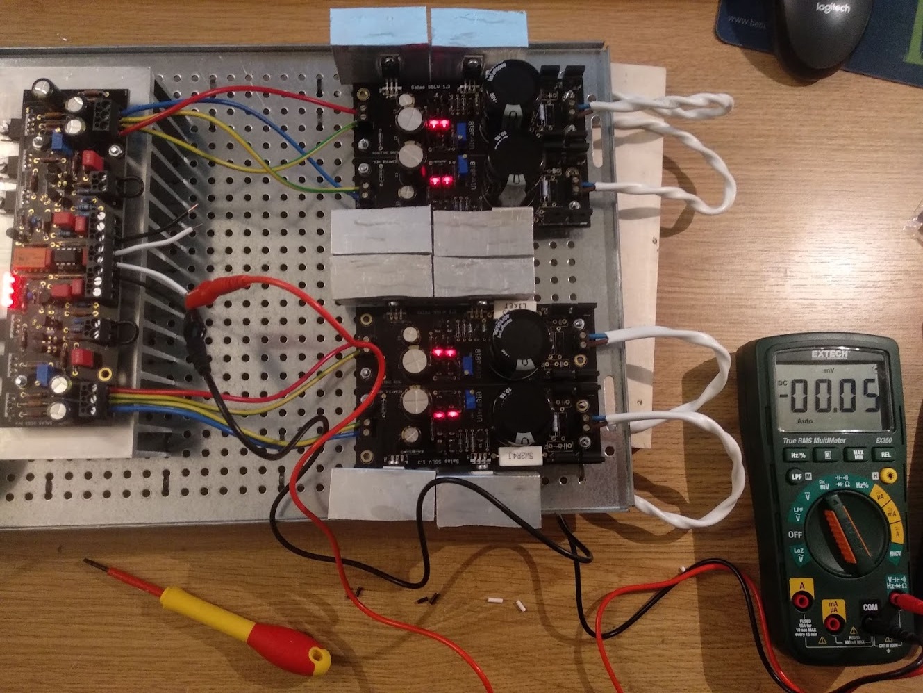

Apparently bk856er was right - I left some uneven surface after drilling that's how I got the sink touching the mosfets. After re-attaching all of the mosfets I finally got the DCG3 connected!
With R10 12R I am getting 98mA bias that is I guess close enough to 100.
UltraBiB sinks are warm after the test while DCG3 big sink has barely heated. Guess this is OK as well.
Will continue to check the DC offset with shorted inputs and later finishing up the build. So far - so good.
Thanks Salas.
Quick update on DC offset. Without op-amp I managed easily to contain within 1mV range. Got same results with op-amp - maybe slightly more stable. One channel -0.25-0mV, other -0.50-0mV. Should be OK.
