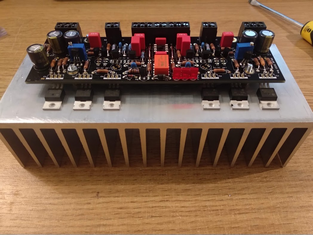

Main board ready to be mounted with mosfets to the sink. This one is much heavier than for ultra-bibs, though the mosfets are off center I think it should be fine. Gonna place it vertically to shield from AC wiring/transformers.
That's a big sink for 100mA bias, it will stay rather cool.
