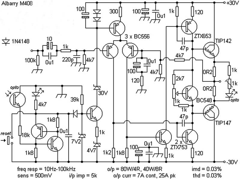

However, it is always better to always have an offset voltage detector at the input of the final, better if set to 200 mv maximum and with optocoupler

Does not sound like an ordinary preamp. Sounds like a big class A power amp.
this stage line com and in scheme, how much decibel do you earn?
