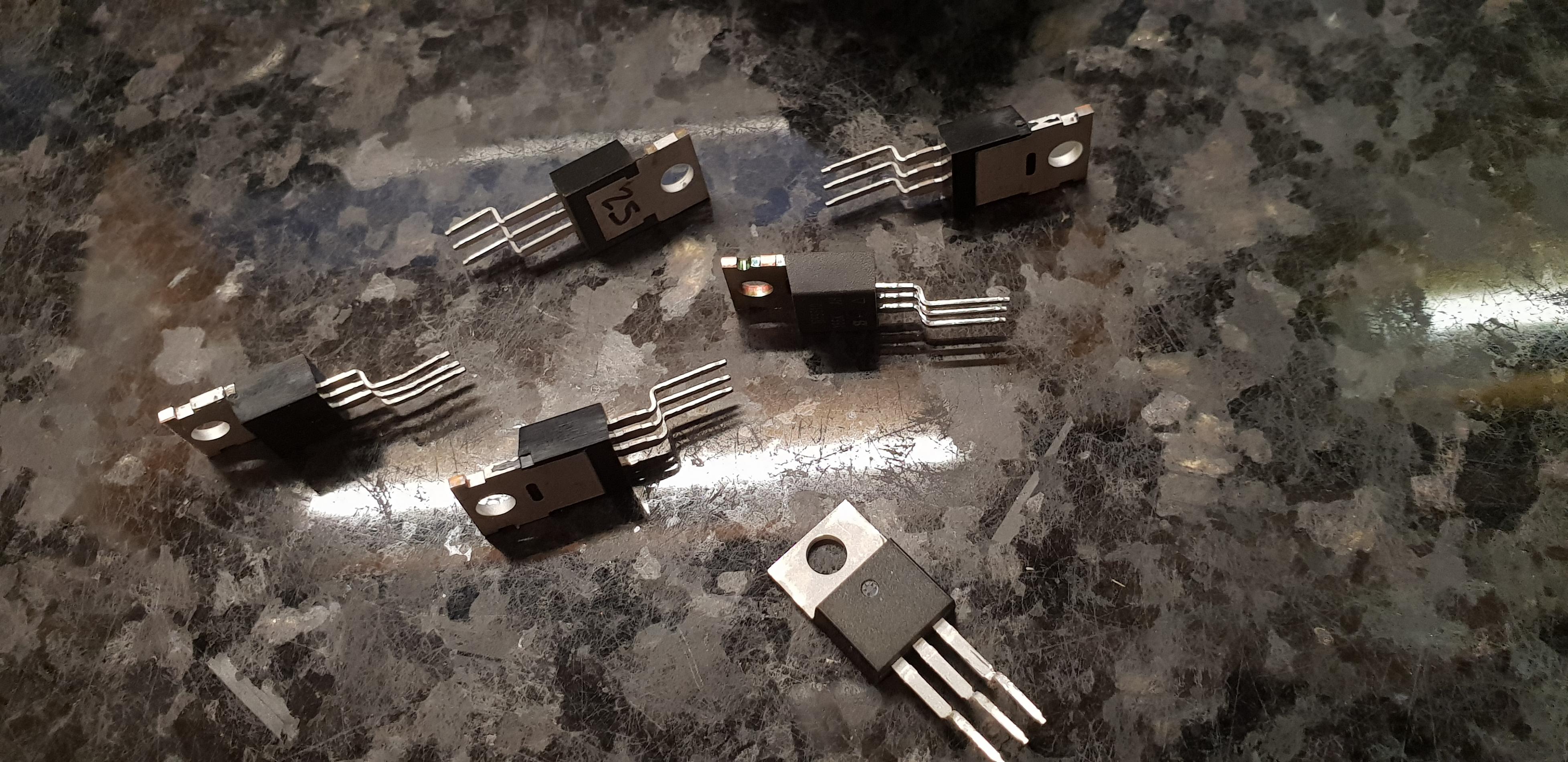

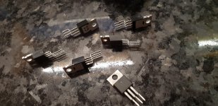

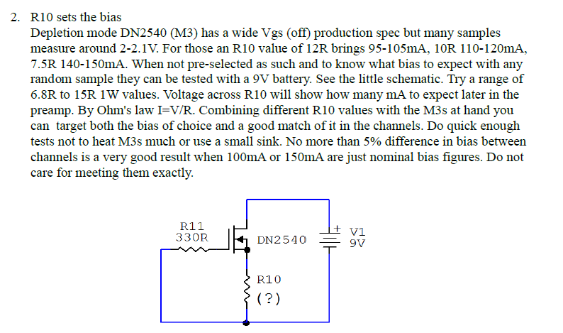

So this is probably an obvious thing to most here 🙂 I'll need to match DN2540 mosfet, what is the procedure/schematics to measure Vgs? Ordering from mouser, how many do you think I'll need to get matched pair? According to Hikari in post 839 it came very well matched, so planning to get only 5.

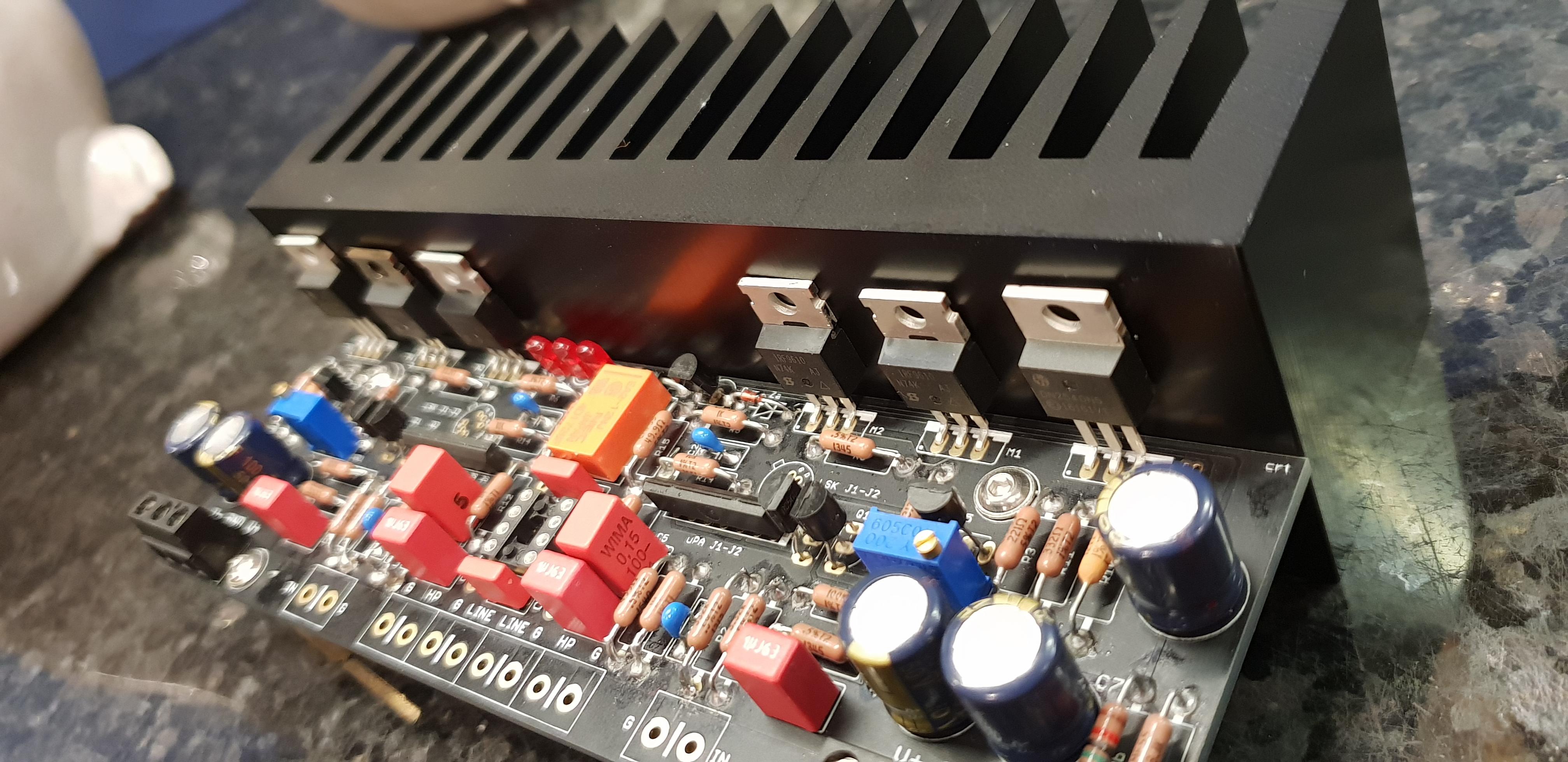

Heat sink came today so hopefully will be able to solder the Mosfets on and test.
Spent a while tonight cranking the fets so they will align flush with the heatsink
Mosfets not soldered here so they aren't straight yet....then I have to drill and tap the thing nicely!
Nevermind, I should probably read the *** manual before asking 😀
