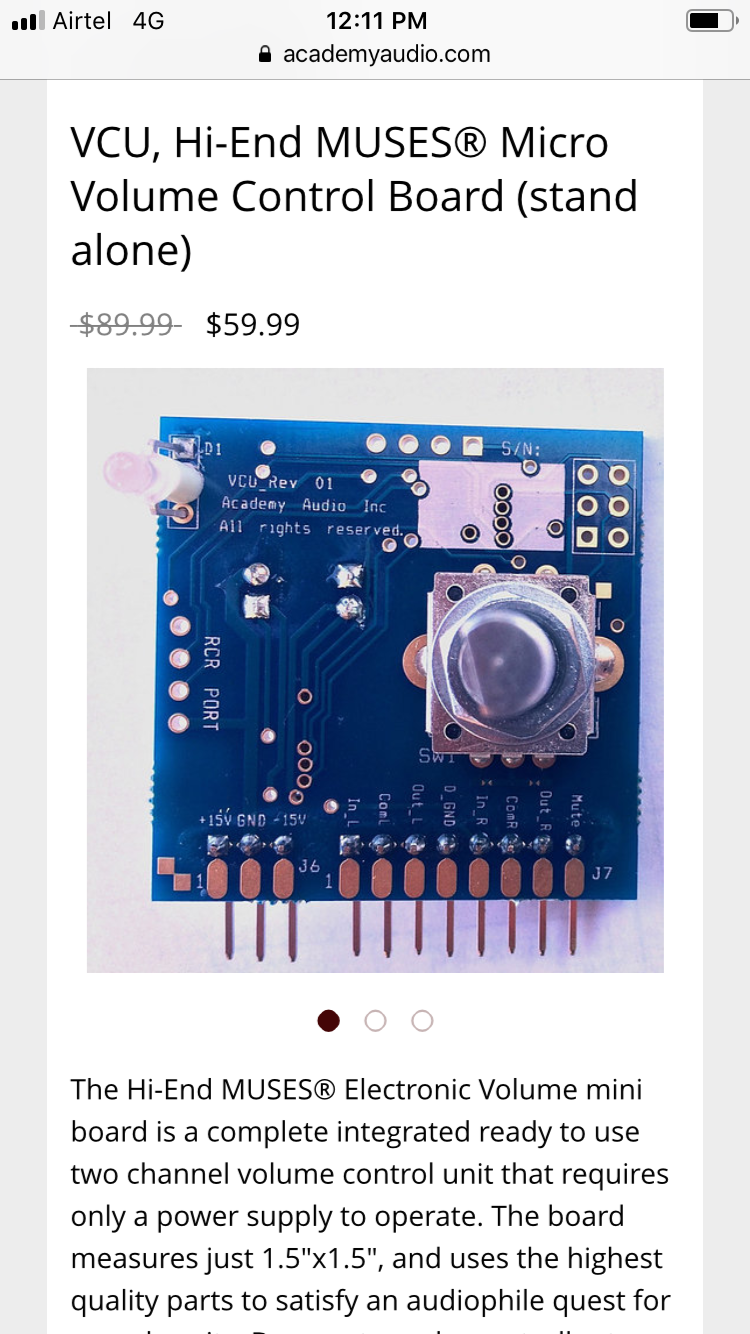

One of my friends got the muses volume Control board from academy Audio and wanted to pair with his salas I-select input control and dcg3 preamp. Below is the image of the board for your reference. Now coming to the connections little confused especially with the ComL and ComR and below is the quote from Mr.Lenny of academy Audio inc.
The VCU board works exactly as a dual gang pot. ComL and ComR are the separate common terminals for the Left and Right channels respectively. D-GND is a digital ground ( a reference point for the muting relay control ). After each channel is wired using their own common terminal as a reference, all three common terminals shall be connected together and to the ground point of the power supply.
The Mute output is needed to control the muting relay, which eliminates unwanted noises associated with the power-up and power-down processes.
How to wire up from the output L/Gnd/R of the I select input board and the input and outputs of the dcg3 preamps? I could get the input and outputs L/R but the common input and output grounds is where the confusions starts. Can someone point me to the right wiring as well as how to use the mute feature.
Member seanwu had used a mini board with Muses, not this same one though. He had shown pictures of his buid in post #1929.
LGND or RGND run on the same ground strip at the DCG3 anyway. Maybe just connect ComL ComR there and connect the D-GND at its PSU GND.
It is two different implementations of Muse chip, so wiring of one doesn't apply to the other.
The Com grounds you are referring are signal grounds which should be connected according to the instructions to the input of the preamp / ouput of the I-select and also with each other at one point and then (from that point) to the power ground of the muse psu.
My recommendation is to connect all power grounds together (Muse, I-Select, DCG3) and then via a loop breaker to the earth ground. You can add a small value resistor between each ground (each channel separately) and LB.
The mute control might just well be power switch for an external muting relay which automatically mutes output when you power up or down the muse control. If that's the case it doesn't act like a volume mute.
To clarify these things a simple manual should be provided by the manufacturer.

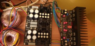

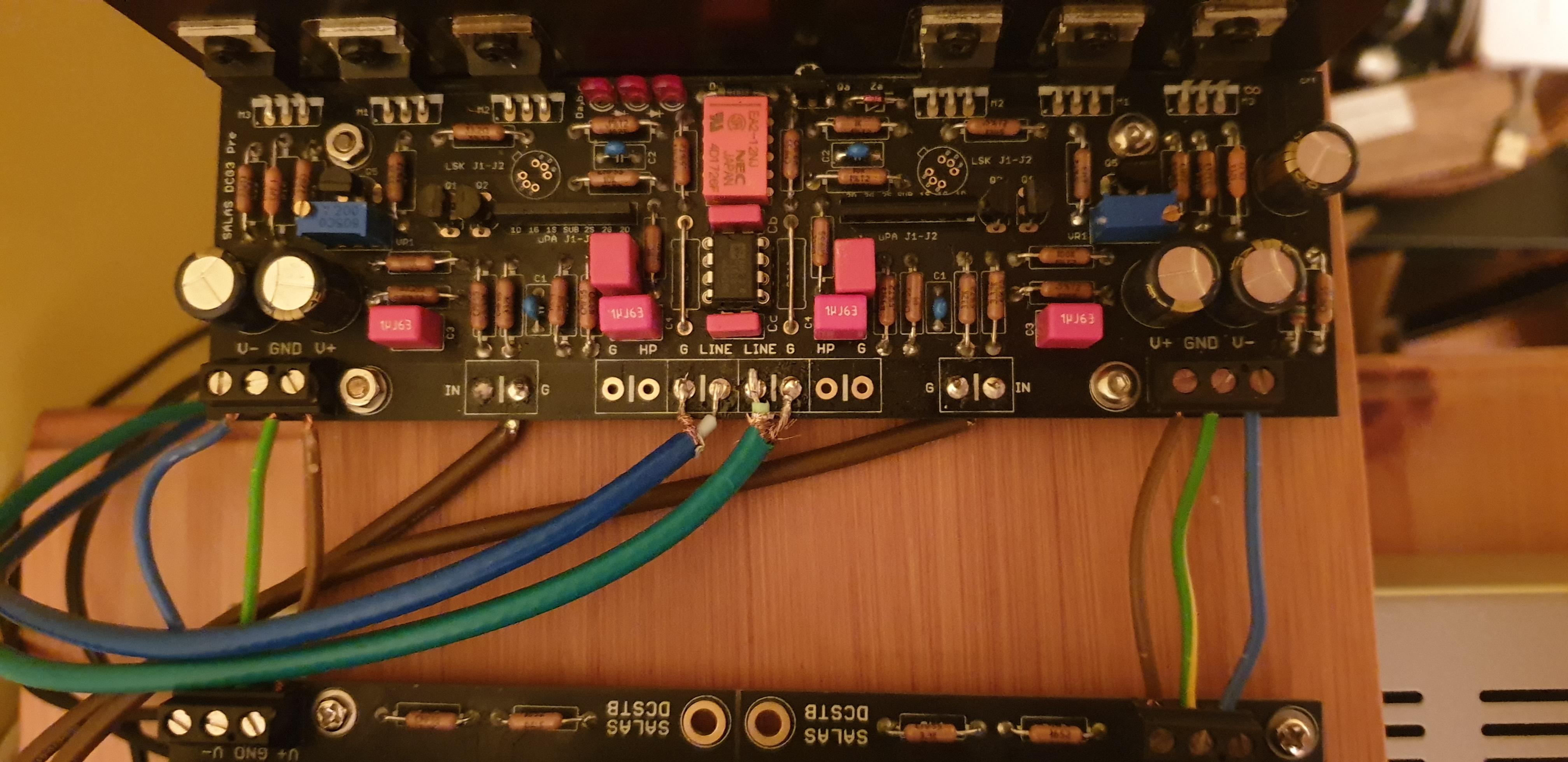

finally mocked up my DCG3 tonight for initial test.
Lots of hiss and then high pitch squeal. (from the speakers)
Any ideas?
Any ideas?
Upload a picture of the mock-up. What power amp you use? Could be oscillating there, although we didn't have such a thing before for any type of tryout in the thread.
Thanks I'll get a picture.
Just roughly rigged into a Teac tripath power amp. Was using my Samsung S9 as source and volume control control. Also tried from a PC....same noise .
