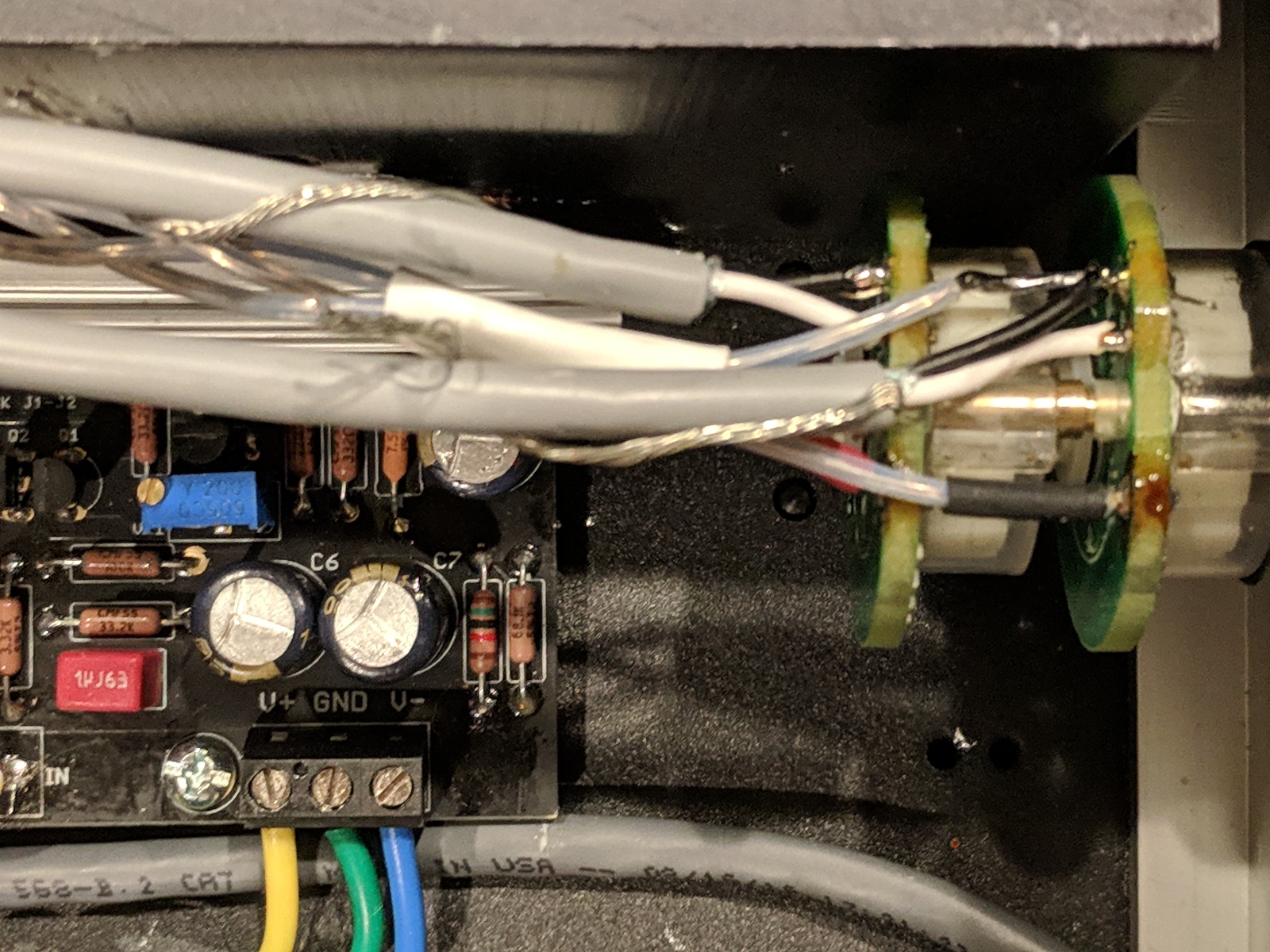

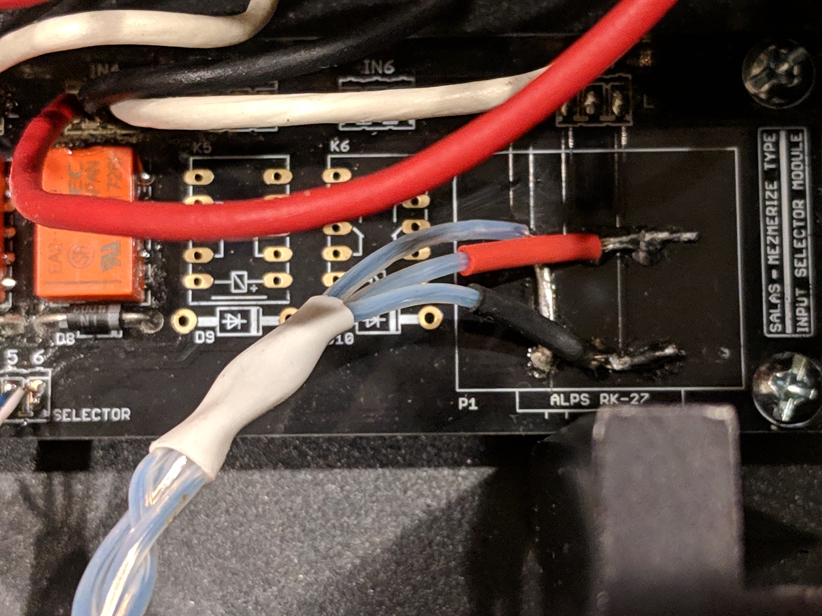

Input selector and volume control connections at I select board.
Hello Russell. Here are some pics. I hope they help you.

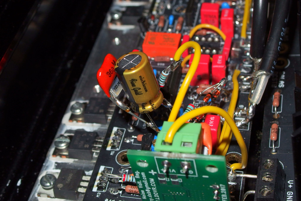

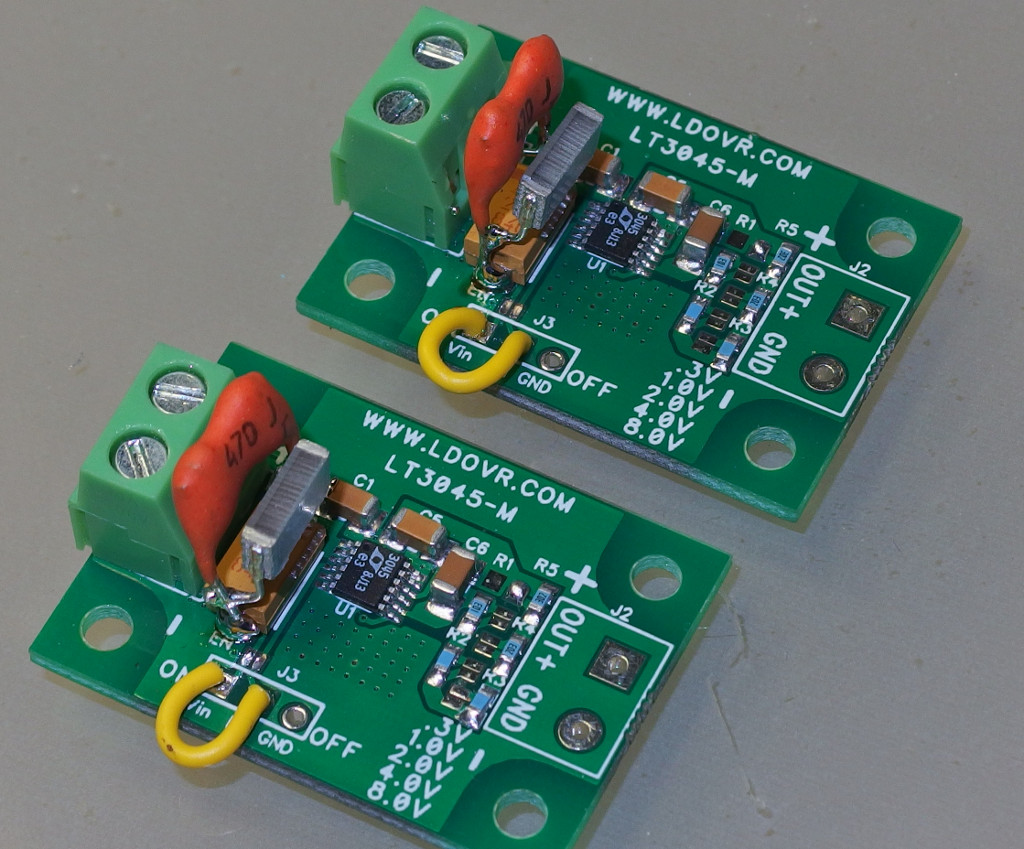

Finally the LT3045 regulator boards have arrived.
LT3045-M Ultra Low Noise LDO Voltage</br>Regulator
I can recommend them as they are of a nice built, using good parts, and surely the designer has studied the AnalogDevice data sheet to get the best out of it.

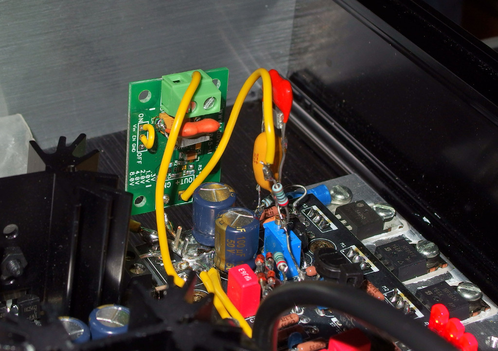

This precision 15V low noise regulators now feed the first stage of Salas' HP board with a RC Filter of 150ohm / 100uF (Tant + MKT + silver MICA) in between.
The first stage draws basically a constant current and thus a series regulator followed by a hefty RC filter does not have any disadvantages or trade offs.
If one likes to give it a try:
- connect GND OUT of LT3045 board as close as possible to the Salas HP board GND IN
- do not connect GND IN of LT3045 board
- connect 100uF (Tant + MKT + silver MICA) of the RC filter with a separate wire directly to Salas HP board GND IN
- re-trim the DC offset
My findings are, that the lower registers gain in heft and stability, overall clarity improves and as a nice bonus "3D" space slightly opens up in width and depth.
I did not detect any extra weight or lag in the bass, so I'm very happy with the outcome.
Possibly will try to roll the tantals of the RC filter with an Nichicon FC, just to check back.

Whoa, what a sensitive point this actually is!
Rolling the tantal of the RC filter to a Nichicon fine gold (no FC at hand), this one wins by far regarding musicality but at the same time it looses by far in stringent resolution at the lowest department.
Though the comparison is a little bit unfair given the fine gold has had very short break in time, I'm pretty confident the imposed signature will not not change any dramatically.
This first stage positive rail will for sure cause me some further head scratching.
Possibly will first try to up the frequency where the RC comes in and see what the LT3045's signature will impose below.

Try to keep anything as equal as possible, auditioning through the very revealing symmetric / 4-wire modded K712 only.
The overall SQ gain with the LT3045 reg board applies for both capacitor variants, it just comes in very different flavours.
If nothing else, above again proves that the rails are part of the signal path. Something usually not considered as such.
Its not only about load and line regulation of the rails, which is always good to improve on in order to easy the amp stage's job and to decouple stages from each other, but its also about the sonic signature of that rail regulation that gets imposed over the one of the amp stage itself.
Current experiments are very enlightening and enjoyable for me, waiting for the UltraBiB to come. Might be, it also triggers some others interest.

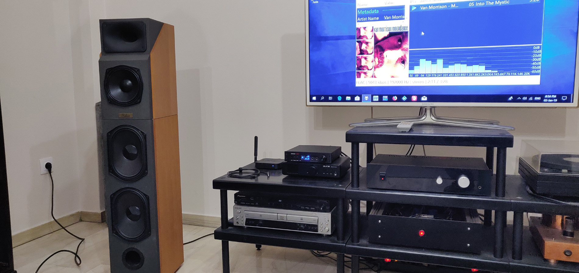

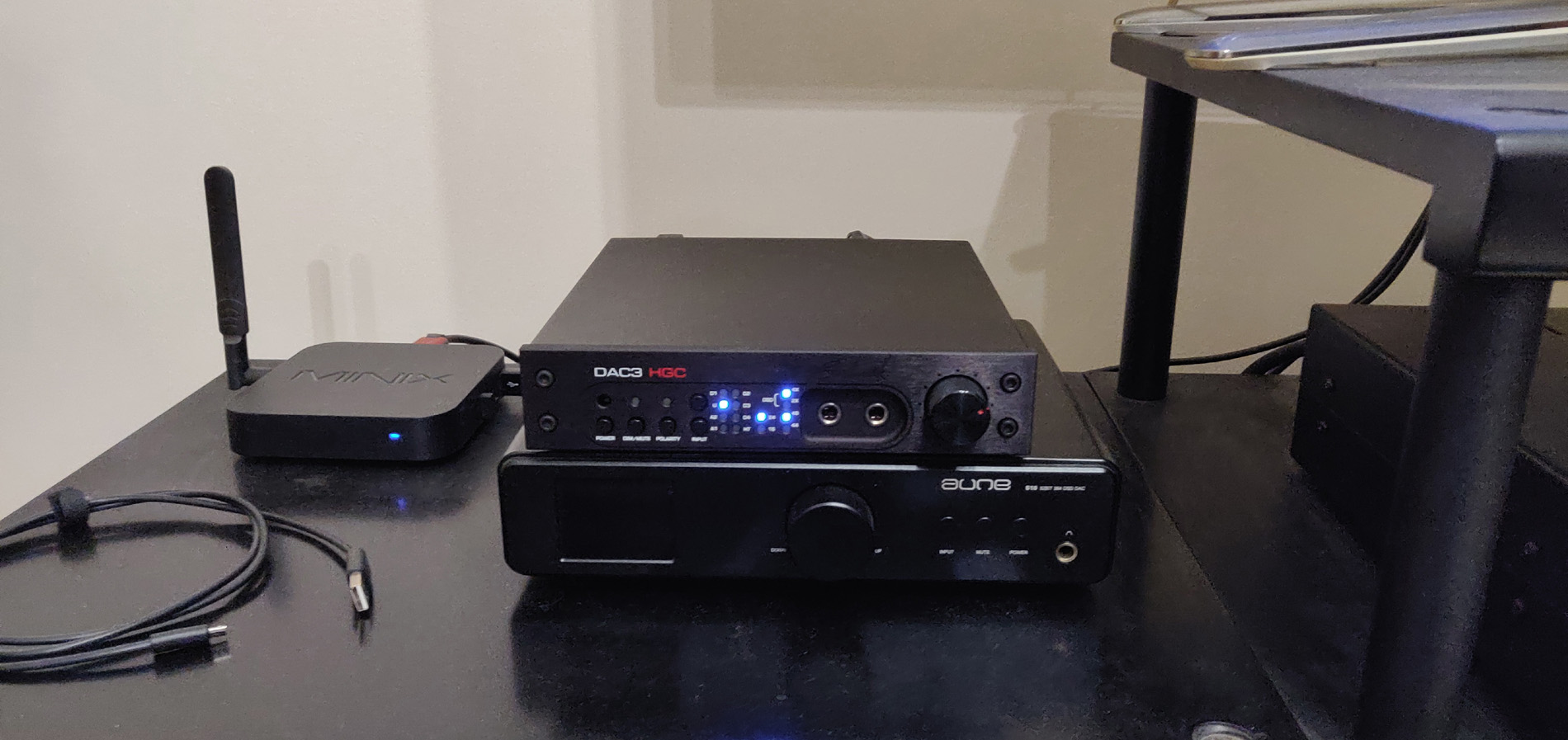

Your question has fortunate timing because a friend brought over his Benchmark DAC3 HGC to listen over my system this evening. We used the DCG3 for listening on speakers for pleasure as well as for a comparison with Aune S16 DAC. The differences in naturalness between a very good DAC and an excellent DAC shone through it right away. Such clues are not quantitative but qualitative. Both DACs are very accomplished in spec and abilities. But the more expensive Benchmark model wins for effortless detail and musical correctness. So yes it's an absolutely capable preamp to use with speakers. It will do justice to your various source equipment detailed characteristics.
As DAC with DCG3 as preampDid you test Benchmark as dac with Dcg3 as preamp and Benchmark as dac and preamp?
