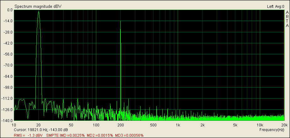

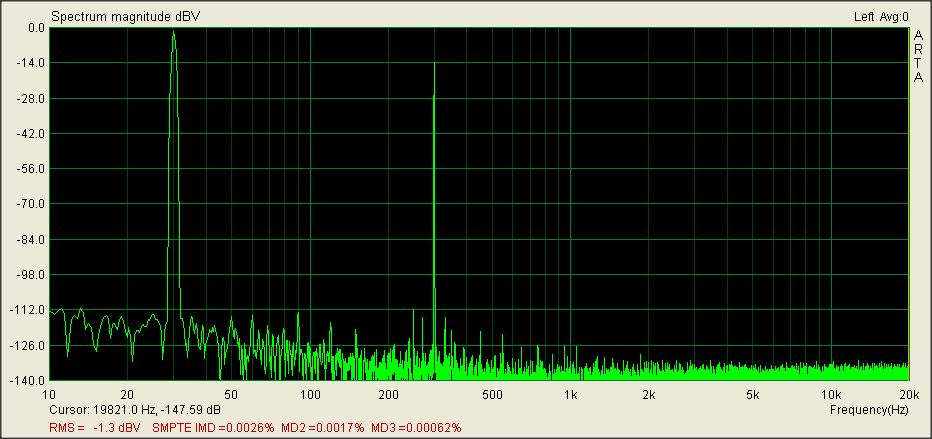

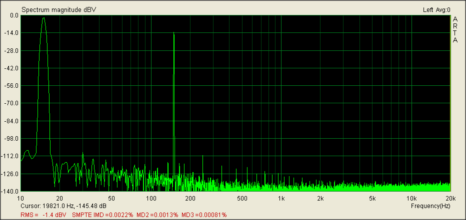

I fetched the notebook and the audio interface at the rack and I measured IMD SMPTE (4:1 bands ratio, RMS level near 1V) for 15Hz/150Hz 20Hz/200Hz 30Hz/300Hz. I don't see any worrying intermodulation % in all cases for stock DCSTB+DCG3 (100mA bias).
The interface's line input as it is a measurement loop. Because buttoned up and on the rack I couldn't handily hang a resistor, and I wouldn't risk the AKG or the Sen open back diaphragms travel at 15Hz 1V RMS, but If you look in post#1 the swept THD figures don't worsen vs 1.5k line input when with 120 Ohm headphones as load for 100mA bias. To the contrary. Also in post #17 the 250Hz/8kHz standard SMPTE was 0.0027% with the AKG K612 PRO as load. In other words in the same low region % of very good results as with the above charts.
BTW the preamp's own feedback resistors at 750R apparent load to the line output are much harder a load than most line inputs found in gear.
