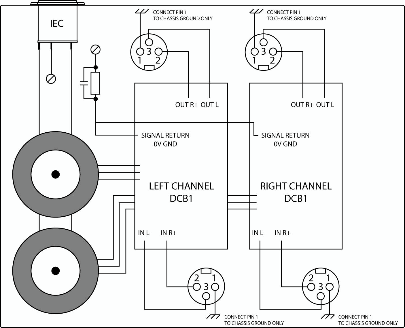

I believe it all depends on the next stage input impedance for this to work properly. It has to be either absolutelly matched - less than 1% - or, more realistic, very high impedance. Thus an input transformer or a tube stage with grid chokes.When using a precision quad pot (possible with stepped attenuators) two sides can stay balanced impedance to a good degree. People had built balanced DCB1 enough times by using two stereo boards for example.
This is what I had in mind. You can use a dual series/shunt stepped attenuator with each shunt inserted between the + and - phases of a channel and .1% or better series resistors.

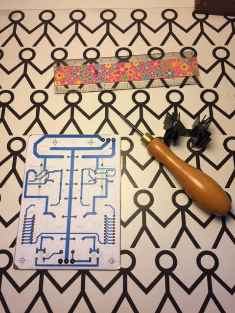

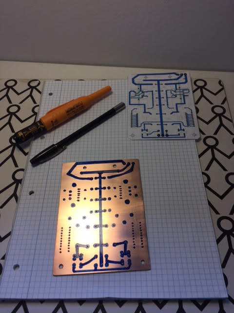

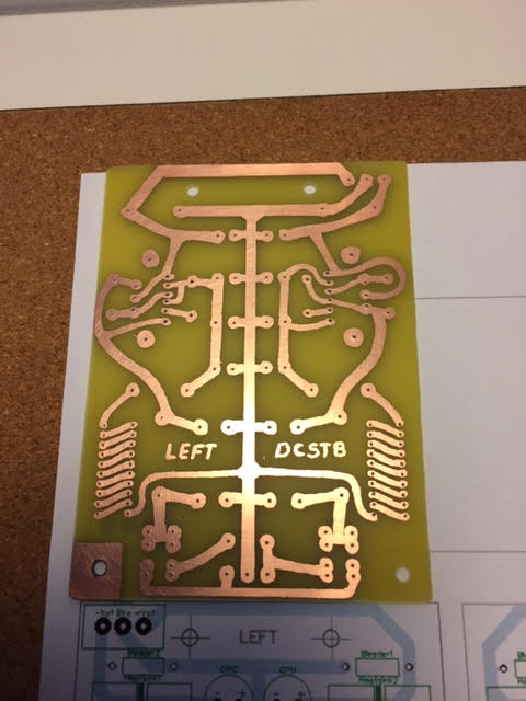

Evening all 🙂
I draw and etched one of my DCSTB(Psu) board's today... Long time since i tried that last... but it went well 😱
-I must say, i really like this part of diy, creating one's own pcb's... Allthrough i am not sure i can make the pre. pcb, i will give it a try. Thing is, that the layout and trace clearance etc.. is close to what i can archive by hand.
I ordred all the part's for both dual-psu's, and the Pre. today; so now i have to wait for the snailmail to arrive her in DK.
I hope you all enjoying the sunday too?
Jesper.
