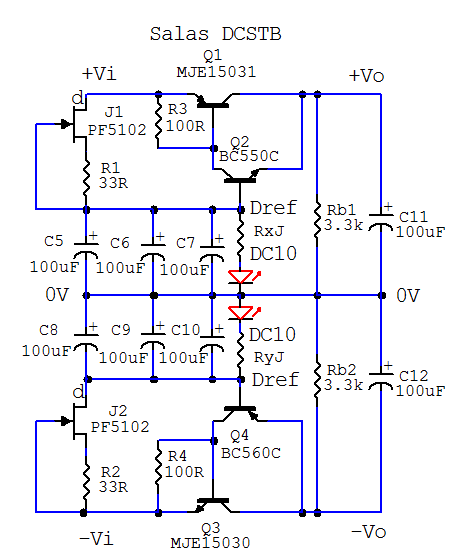

I know it could be a stupid quistion... but will it matter if i replace the capacitors C5 - C12 (100uF) with 220uF, and maybe use 4pcs 220uf instead of 8pcs. 100uF...
Quistion is, as i donno if something spectakular is about the design, giving the best performance etc...

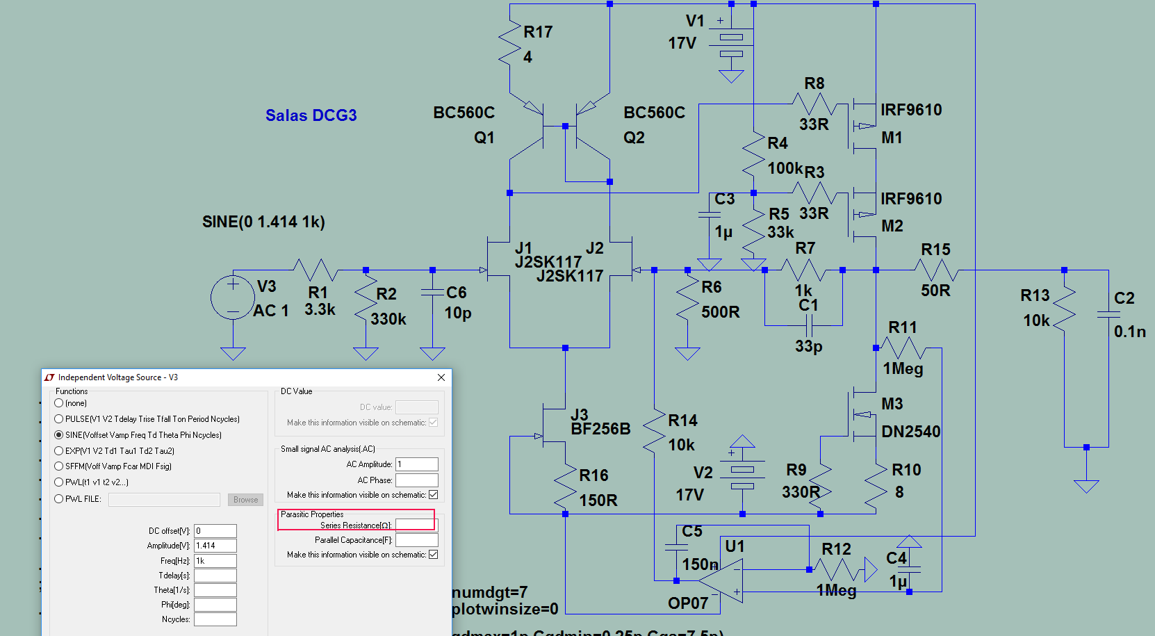

Salas, have you measured distortion for worst-case source impedance? I very much suspect it won't be quite as pretty as shown in the first post. Nothing that a cascode in the input stage couldn't fix, of course - preferably the bootstrapped variety, as we're talking reasonably high CM levels.

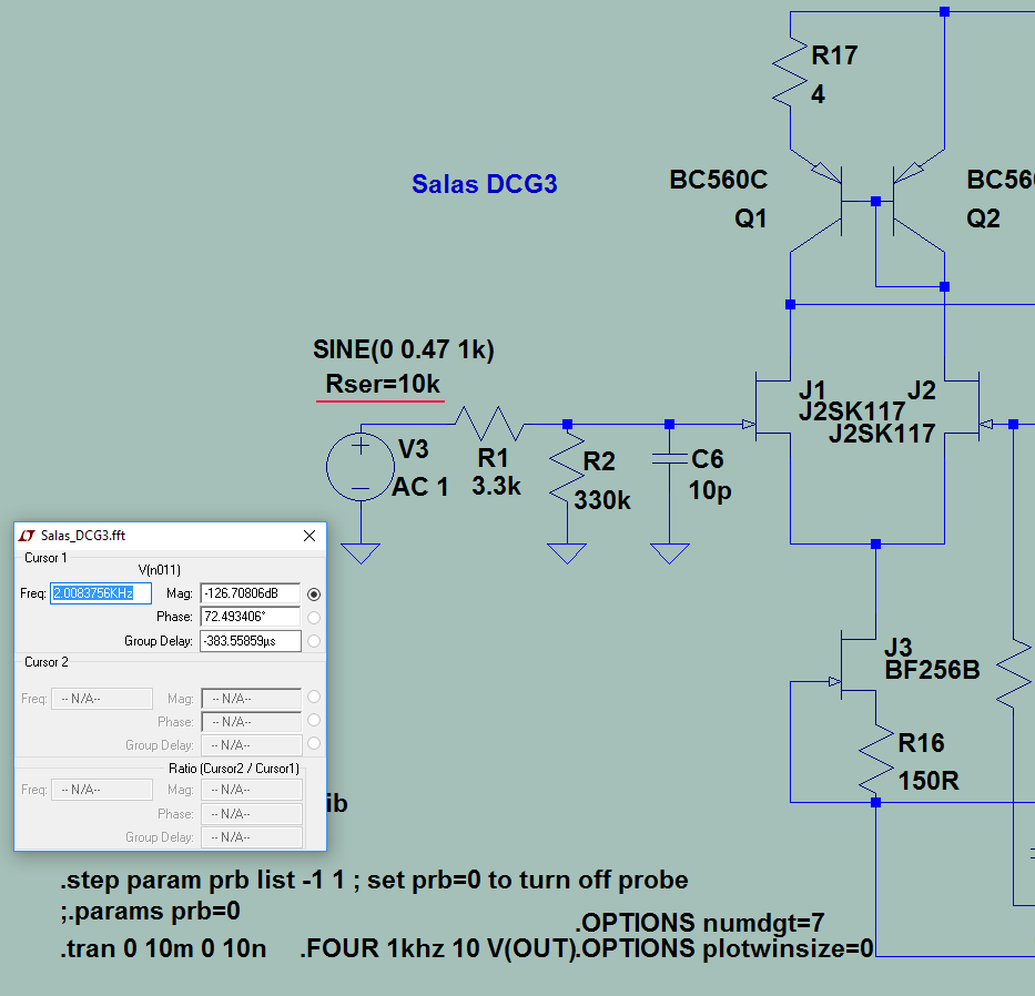

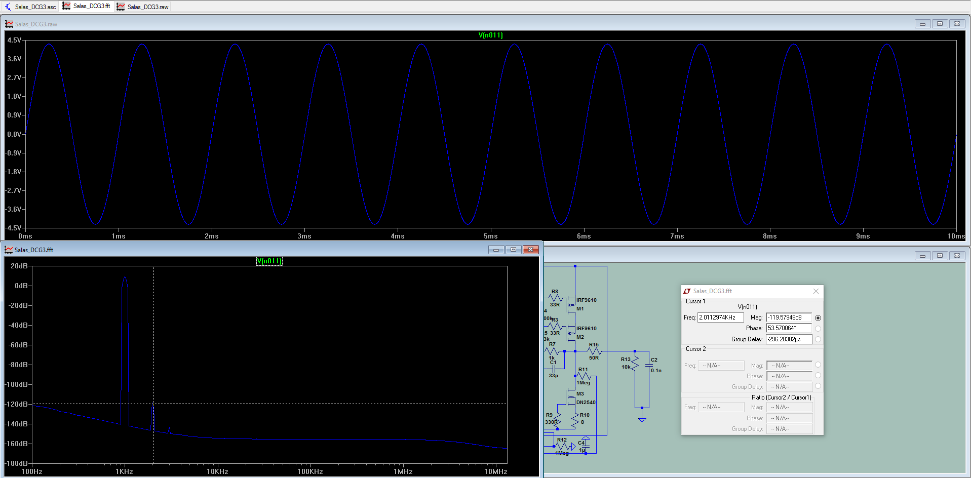

Hi, those plots were with the 20K pot at half (that's the worst case bandwidth point). I did also measure with no pot or the pot at max while controlling input level from the Arta generator's digital level only with no odd indications. I will have to measure my audio card box's analogue outputs source impedance when able to also inform you what it adds because its Zo is not stated in its manual.
The R1 3.3K input filter series element will be always there adding to any original source impedance though.
With that same equipment and methods I had also tried input stage cascoding when breadboarding various ideas and it made no real THD difference. Second stage cascoding and higher rails did.
At the moment I can also show you simulation FFTs with ideal zero source impedance signal generator or with hiZo value added in LTspice. Seems nicer than with real life active parts and layouts to me for 8.63V pk-pk output across 10k/100pF but can't check such dbV with a pc card. The simulator should have at least shown something wrong with zero signal source impedance if instability was there waiting to happen. The real oscilloscope didn't too. Sims are also good with much Z (extra series with the signal) at comparable signal level region to the measured plots. Although I found it 7-10dB worse in real life with such Yfs class input JFETs at such levels.

Those capacitors were chosen to be slim enough for placement between the sinks for the given boards width restriction. And to achieve better spec than using a single equivalent value unit also. So three in parallel are still dividing their ESR & ESL better than two. But its not a big deal using less if keeping with good unit specs anyway.

Ahhh 😛 I think i still learn everyday 😎 three in parallel are still dividing their ESR & ESL better than two
Did not have this in mind...

No, its still noisier vs using LEDS. Also the rails have nominal value here. Since the DCG3 is not changing offset with non precisely symmetric supplies, there goes the adjustable benefit of that chip as well. If LM329s were adding to my target voltage I would have used those instead which are much better spec than the TL. But they don't.
