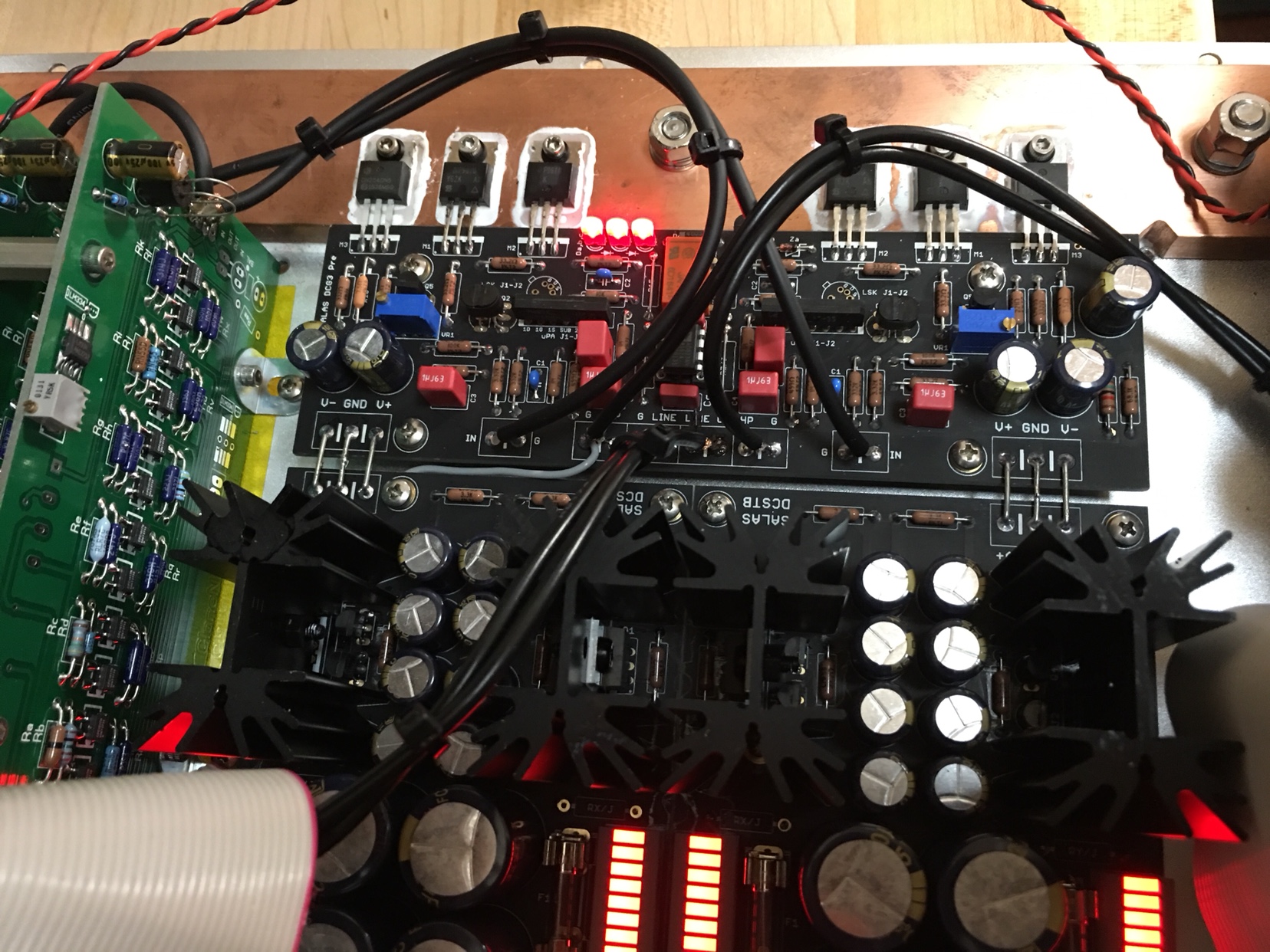

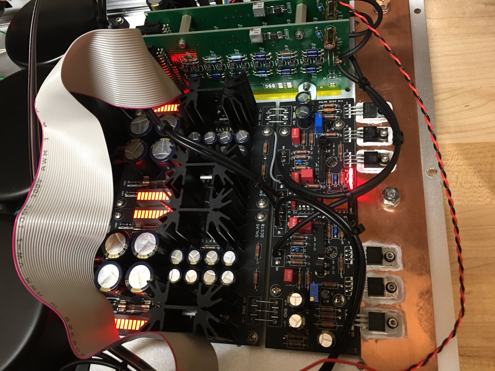

Yes, I've done that a few days ago that way and measured the voltages of both sides. Voltages should be around 17.3 Volts.
Yes it can. It also has integrated 5mA bleeder resistors so not to remain charged up for too long.
Thanks. I appreciate the info, I figured it was ok, but don't want to fry anything this soon!

Only watch not to accidentally short an output while its running or before its discharged by its bleeders for a couple of minutes when turned off. This is not like my shunt regs with a CCS current limit. Its limitless. It blows the fuses and the BC transistors when on and it only blows the BC transistors when off but charged in case of a short, which are dirt cheap parts, but its a narrow space to rework in the sinks gaps.

Thanks for the tip...I have not yet affixed the heatsinks to the board. Somewhere in the reading, it suggested that. so I power up, measure the outputs for correct voltages, power down, and leave alone to bleed down a couple hours. Sound good?

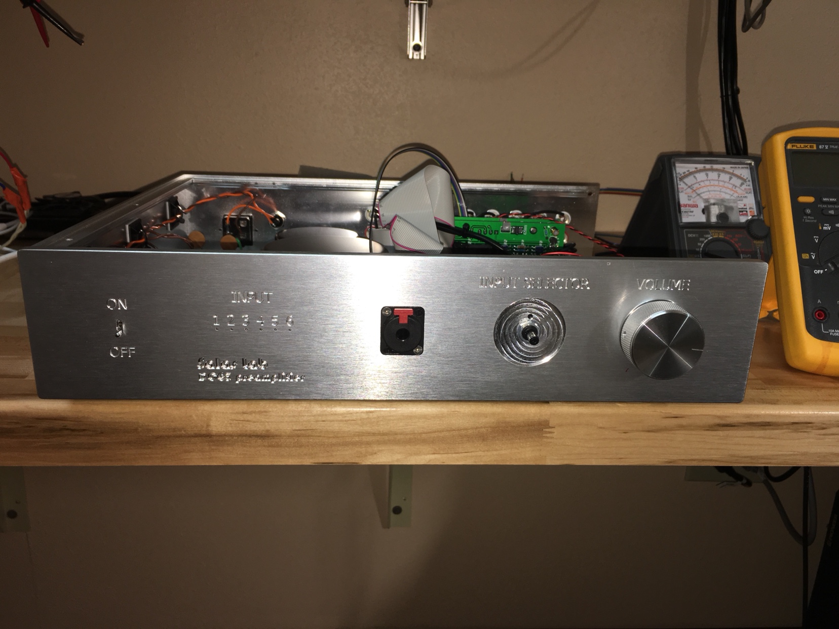

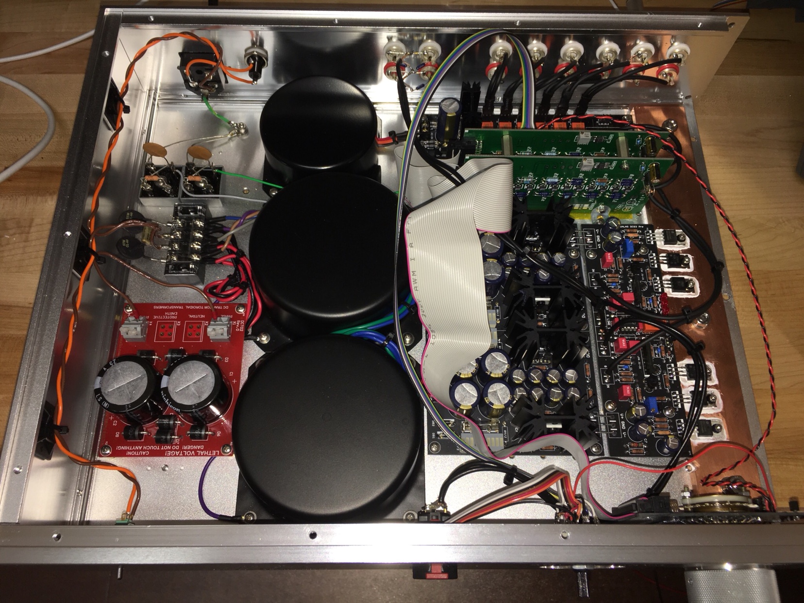

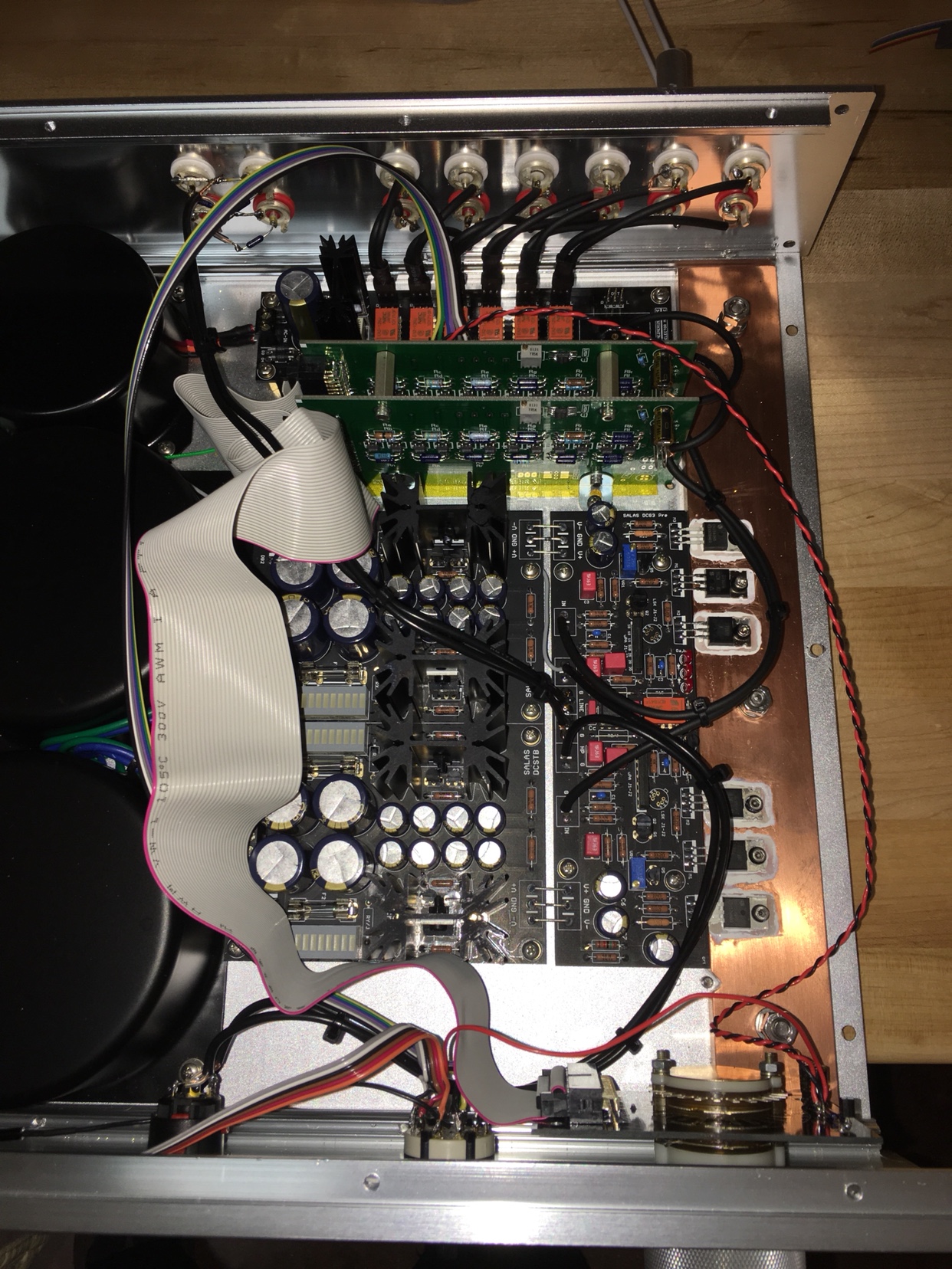

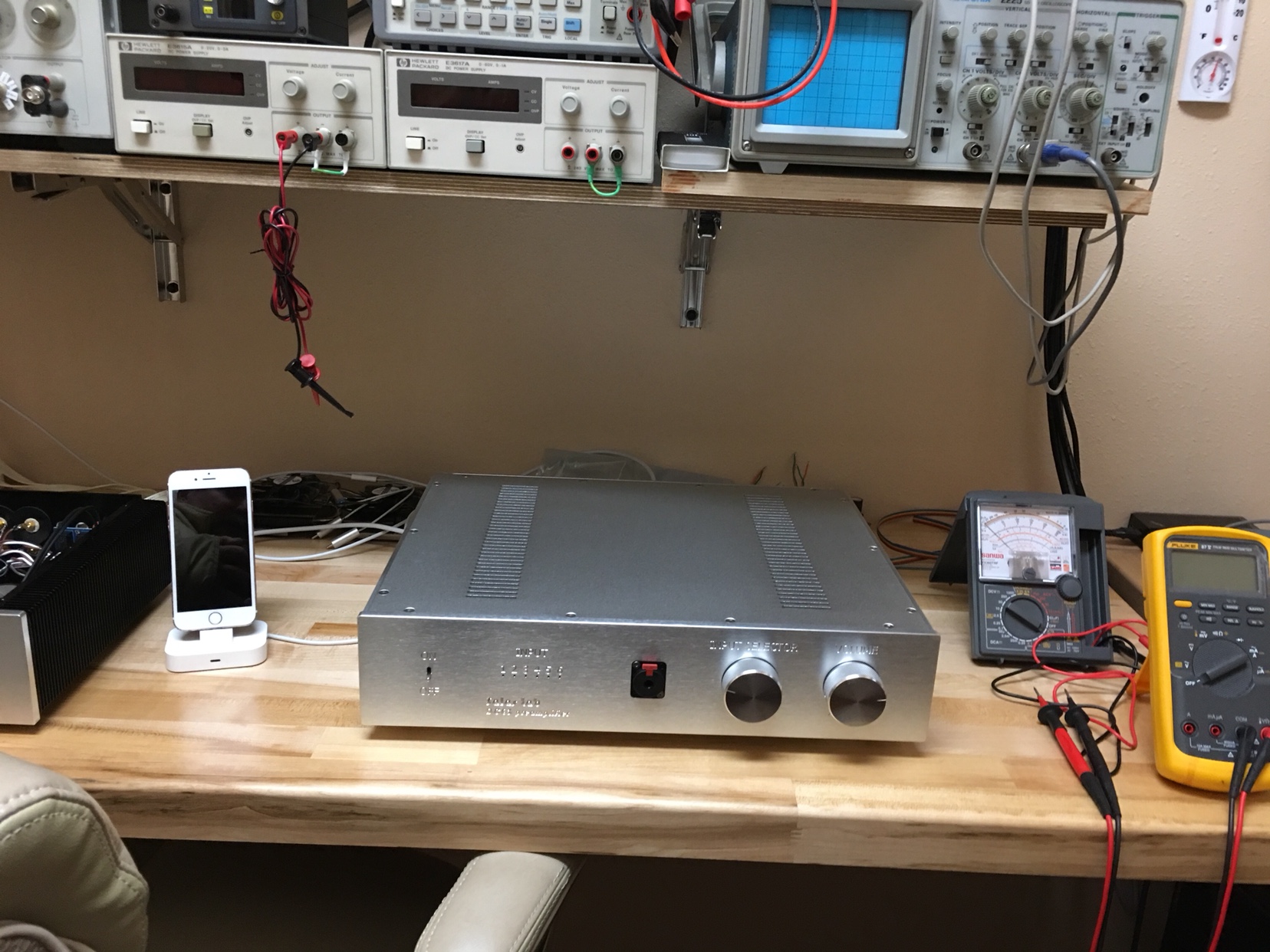

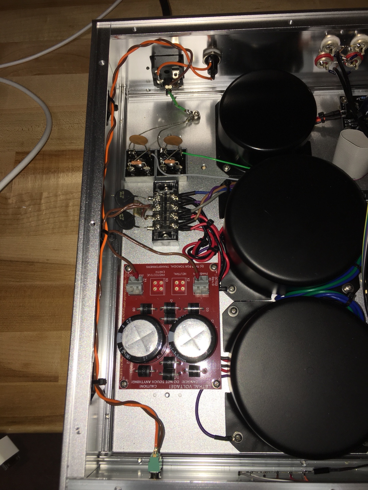

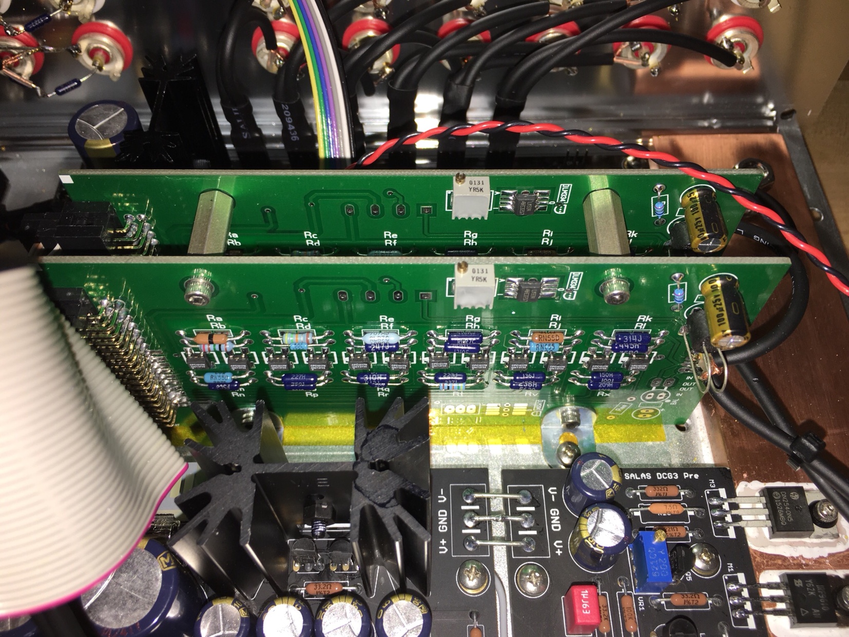

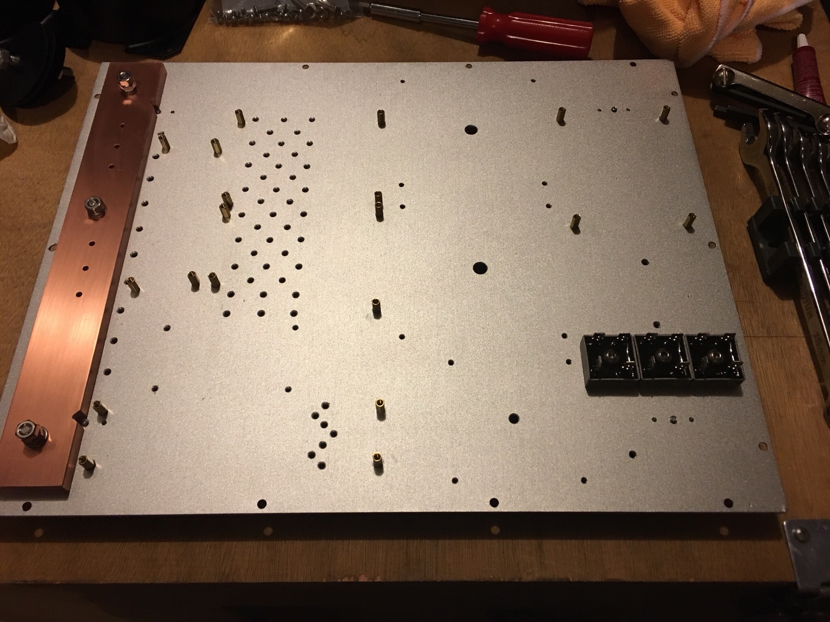

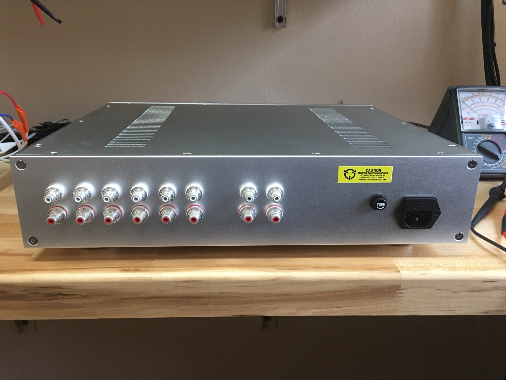

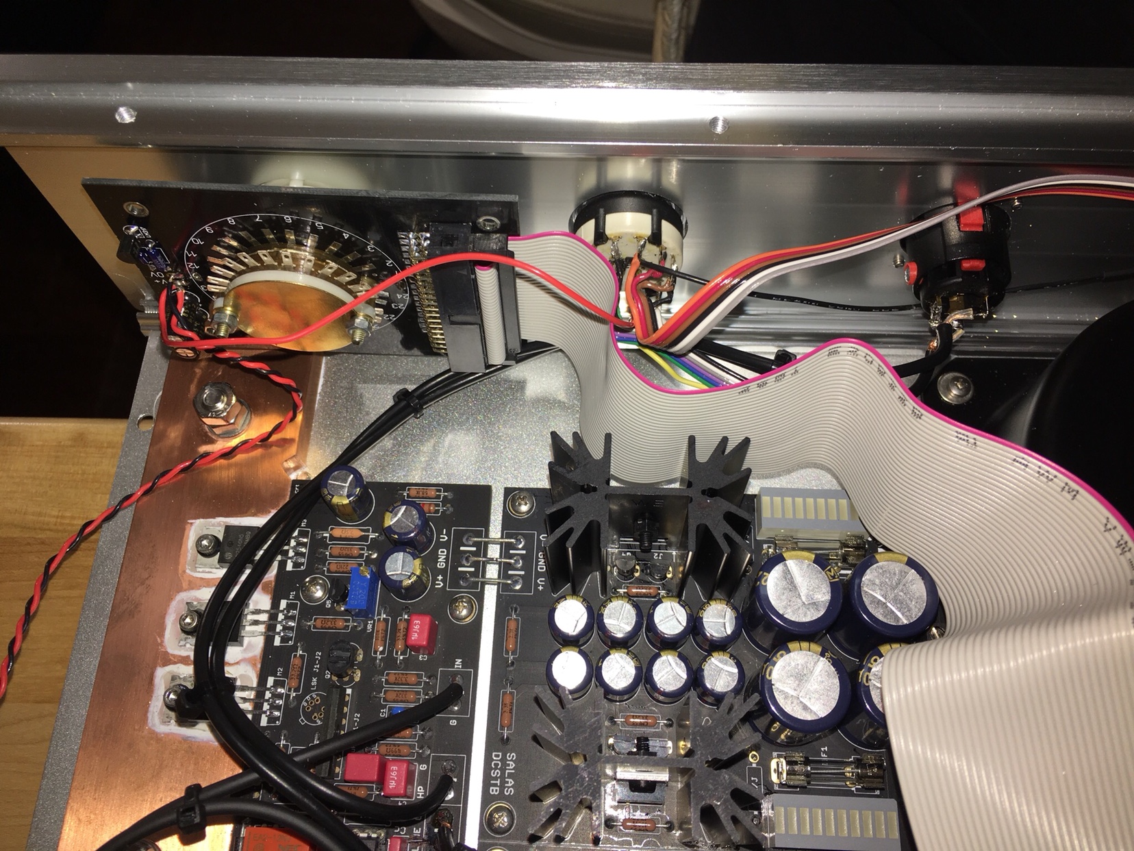

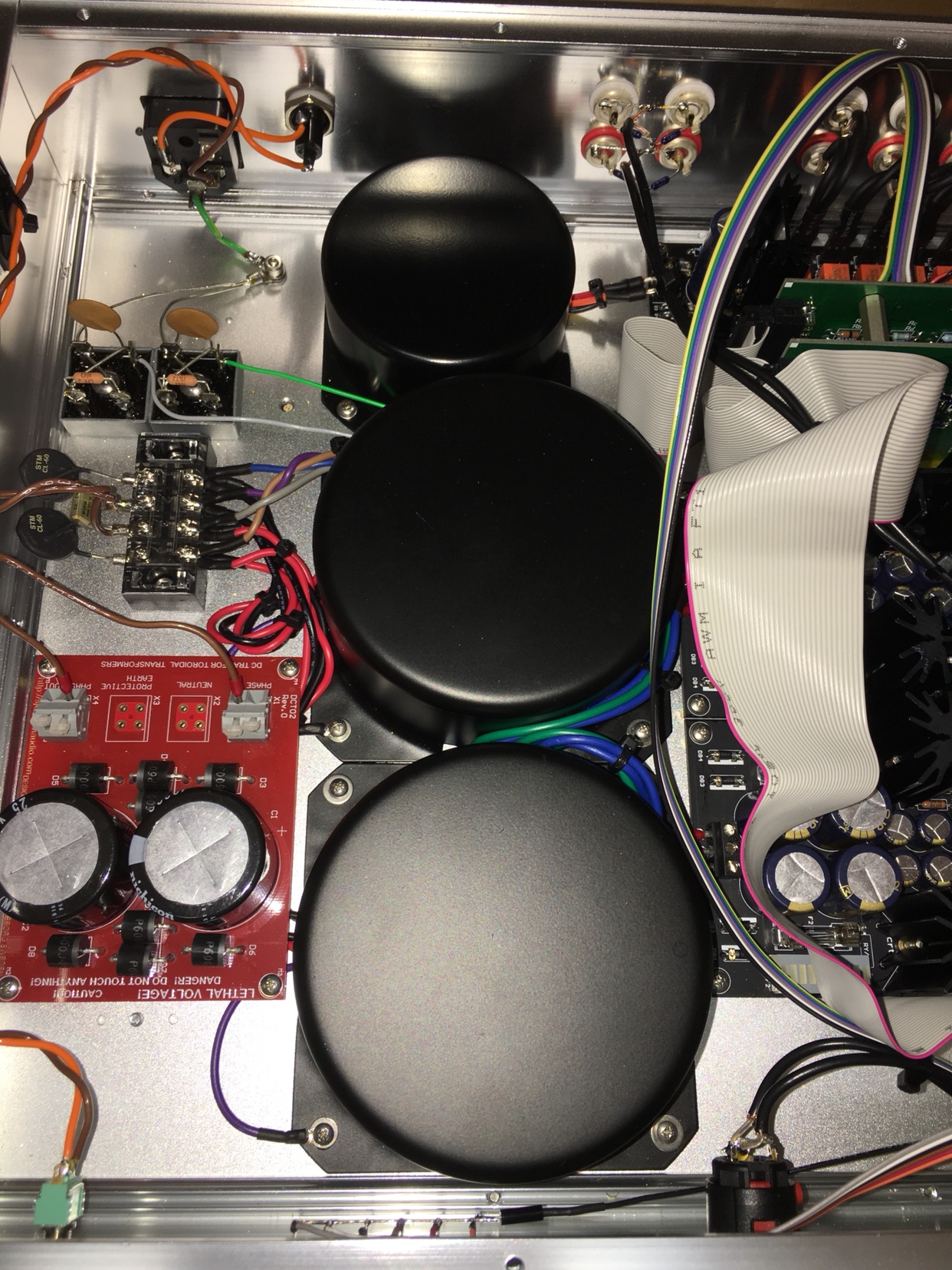

Thank you. The purpose of these images is to give you guy a close look and some ideas of assembly. I will be glad to answer if you have questions and please let me know if you need info about parts that I used. That unit is my second one (for my office use) and that time I desired to go with LDRs volume control. Fist one is running with Goldpoint 48 steps attenuator. It is amazing unit. This one is just finished and have very brief audition. I’ll report about my subjective opinion about its SQ in 2-3 weeks. Personal thanks to Salas for an exceptional support.

Yes, good plan. But only a few minutes will do. Just measure that their output voltage has fallen waaaay down before declaring the units empty of charge.

Excellent work there Alex. Congratulations. Making a second one means that you really liked the first one over time, happy to know that those preamp builds stand the test of time with many of you guys.

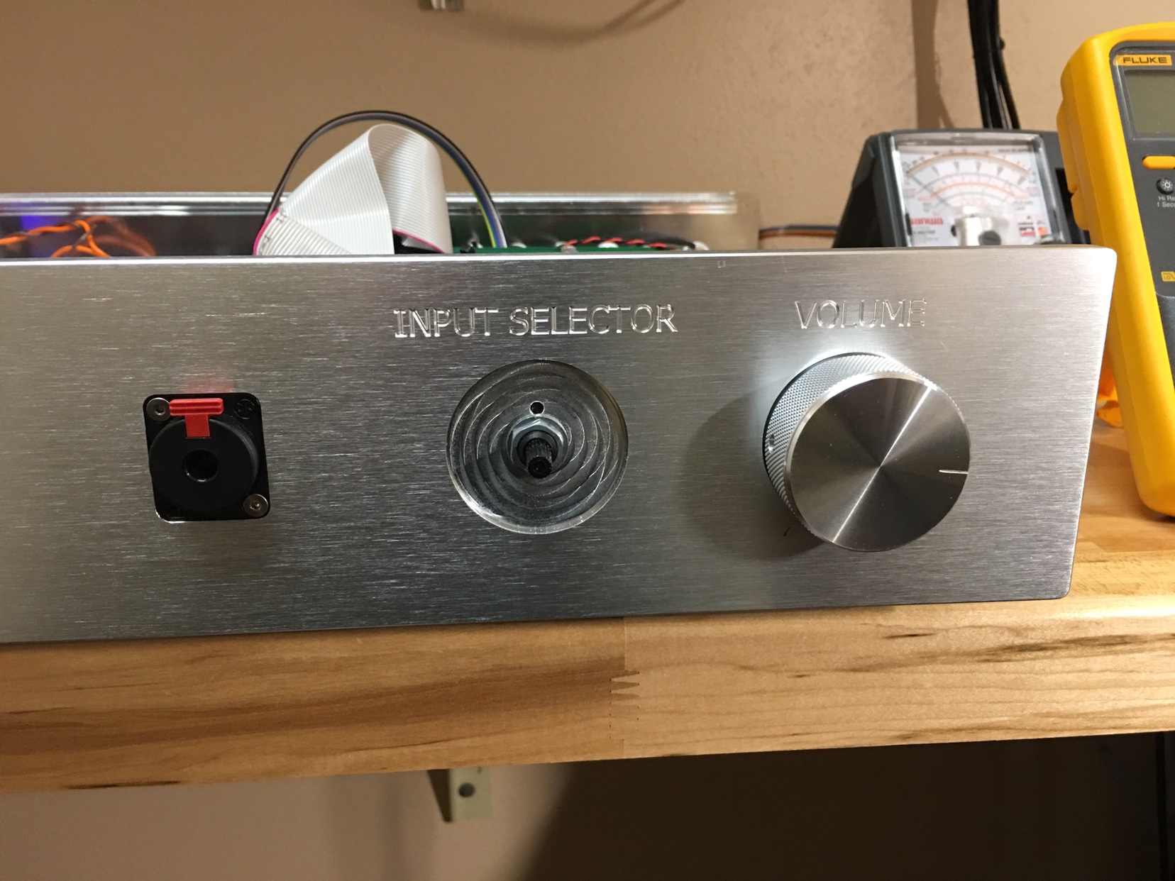

I do have a 4-way XLR connected HD650 headphone.
But I will use the DCG3 as a single ended connected Preamp.
What is the best way todo so?
The HD650 uses removable cable with Y split and connection points at the bases of its cups so remove the bridged drive connecting four pin XLR terminated cable from it and use the original cable with the jack connector that came in the manufacturer's box. If you want to keep the special cable for some reason like custom length or its mechanical quality you have to remove the XLR and rewire to a jack. Tip is left channel, ring is right channel, sleeve is the grounds.

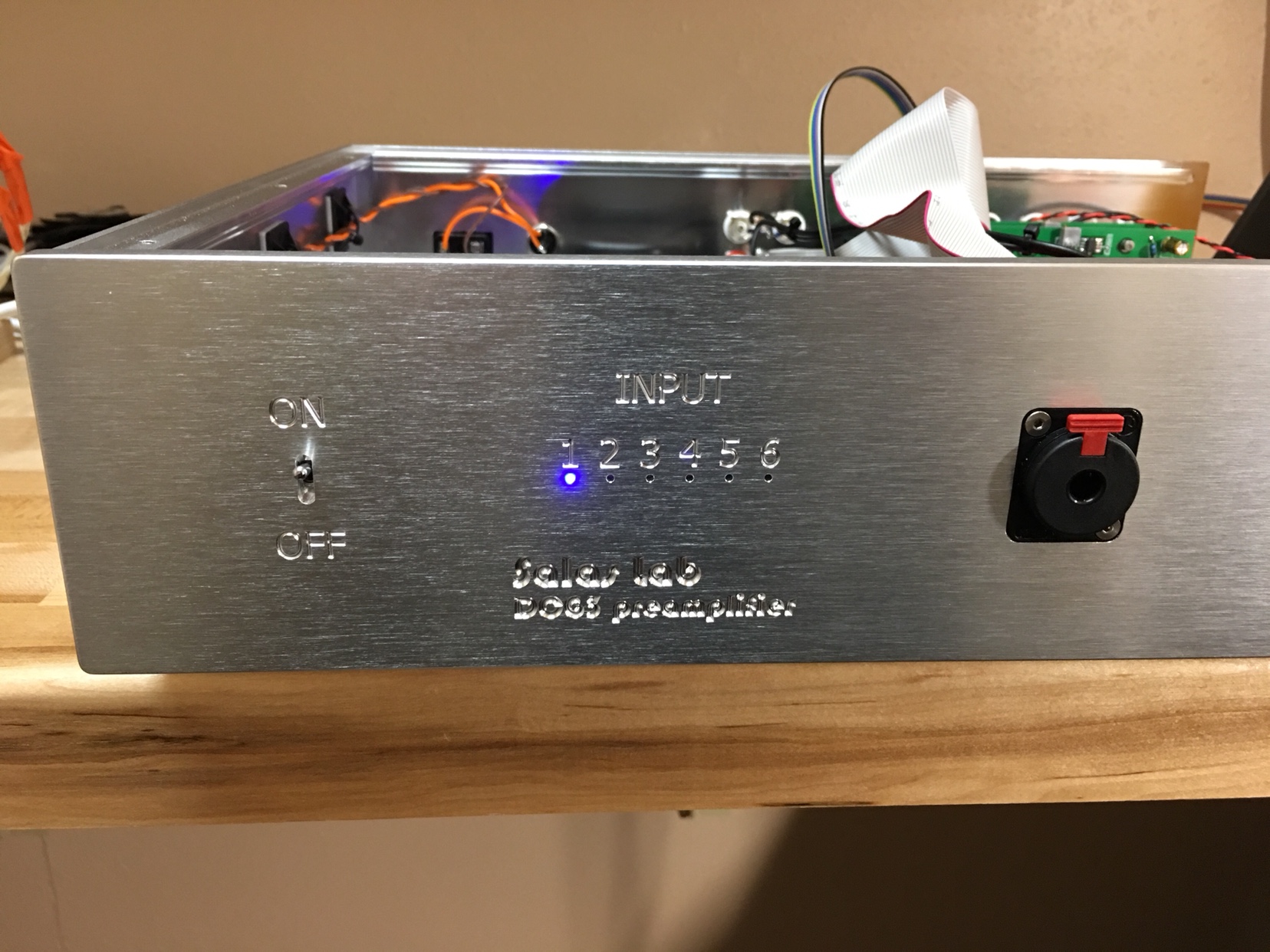

Is there a reason not to use
a) a conversion cable (from 4-pin xlr to standard stereo jack), or
b) mount a 4-pin female socket in the DCG3 chassis but wire it SE (so pins 1 and 3 to the SE outputs L+R and pins 2 and 4 to signal ground)?

No electrical reason not to do conversion things or extra socket than to have a straightforward cable and a less busy featured front panel.
Thanks,

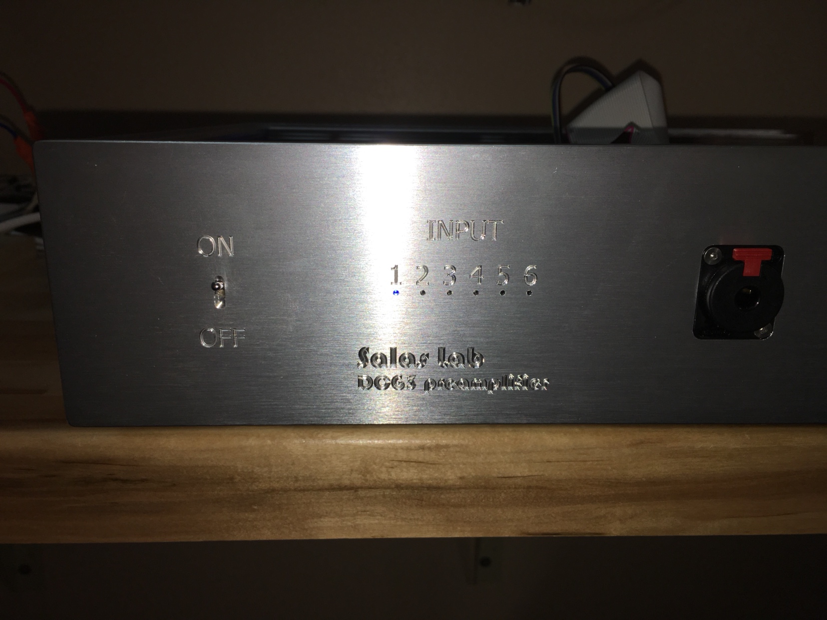

I myself was planning to use *only* a 4-pin XLR on my chassis and wire it SE
Now I am pondering how on earth to back-mount a 4-pin Neutrik female panel connector to a 10mm thick front panel (considering these things have lock-tabs)...

I think I will do so....
Steef
... and using NC4FD-L-B-1front mount connectors ;-)Thanks,
