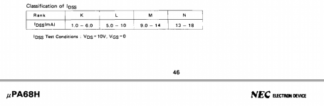

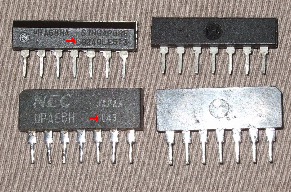

Also the uPA NEC monolithic JFET flat packs must be measured genuine for IDSS and curves if their sourcing is doubtful. Main clue: There is a number printed on them starting with a letter. That's their IDSS classification letter. If they fall out of their intended range they are suspicious. Don't use them.
