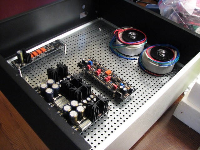

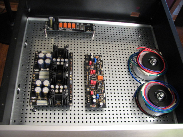

Layout copied off of bambadoo's project as seen here:
http://www.diyaudio.com/forums/anal...g3-preamp-line-headphone-172.html#post5037088
Here's mine so far, still need extender sets and heat sink.

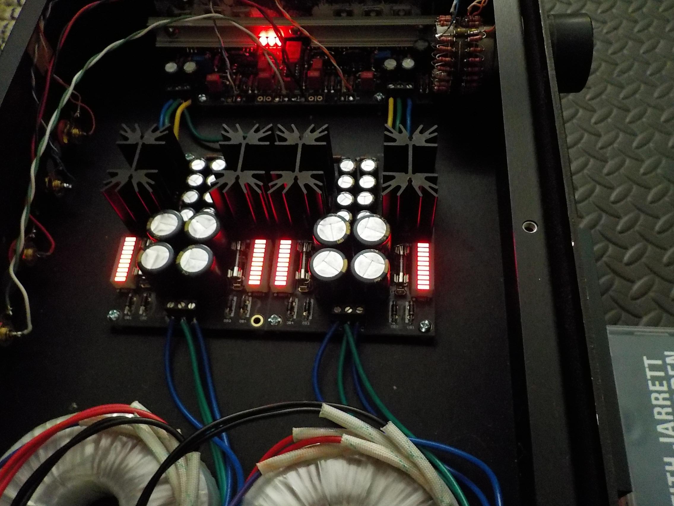

Hello, after successfully building a mesmerized B1 buffer and enjoying great sound through my F5 turbo amp I decided to build a DCG3. I got a full kit with dual mono power supplies from Tea Bag. I set it up as a single input preamp in an old velodyne chassis. I am using a ladder type 20 KOhms pot as volume control.
Lately I noticed a lack of bass, there is bass but my full range NHT 2.9's with 10" woofers sound like a mini monitor, you can hear some bass clean and well defined but lacking strength. I wired the input to the pot and from the pot to the amp board using CAT 6 wires, a pair of twisted conductors from the RCA's to the pot and then to the preamp board. I've check polarity of inputs, outputs all seem good. Any ideas where the culprit could be? Thanks

Thank you Alexkosha. This set up in very musical. The DCG3 has better resolution than the DCB1 but b the weak bass makes the sound a bit bright. I'm using 7.5 ohms resistors to set the bias of the output devices.

I would start with basic tests. Can you check your current setting by measuring voltage drop on that bias set 7.5R resistor? I’m running bit high - 165mA, but I have very good heat dissipation since I use 20mm x 50mm x 400mm copper bar attached to the enclosure bottom with thermal compound. What is you PSU voltage +/0/- on both channels?
The only difference I see is the value of R3 is 221 ohms instead of 150 ohms shown in the schematic. I am getting a high quality attenuator at 25K ohms. I will post the results.
Power supply voltages are fine. -17.2/+17.22, -17.31/+17.27.
Voltage across 7.5 ohm resistors are 1.051 and 1.027 volts. Seems to be ok.
Your PSU voltage seem fine and you’re running with 137/140mA also seems fine.
