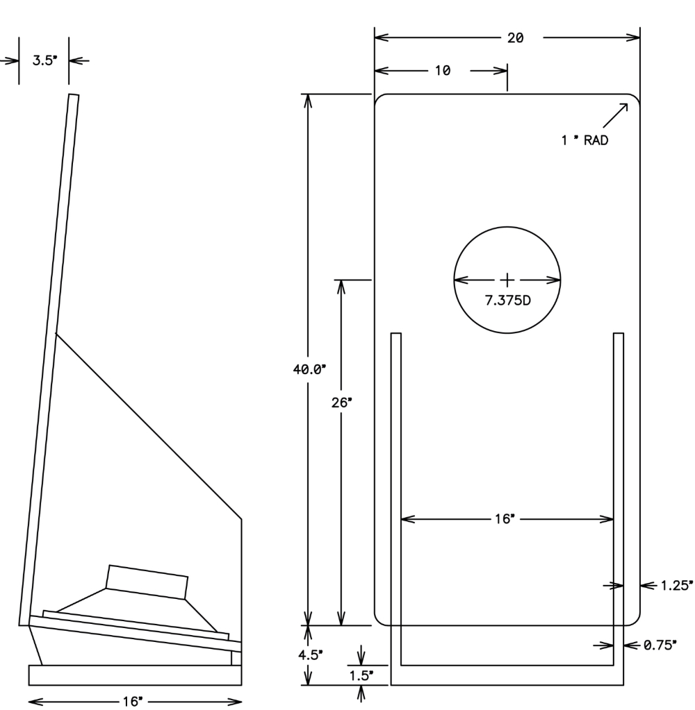

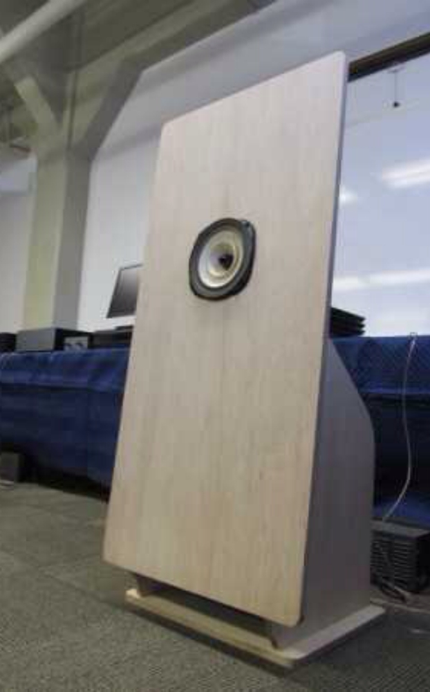

Dick Olsher reviews a pair and has a simple open baffle design using them:

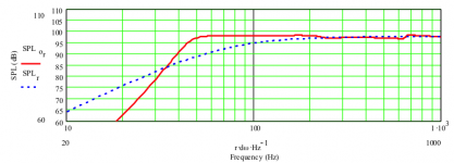

Interesting! If you can, please show us the quarter wave box you come up with along with your results.Hi
Afters some evenings with Martin´s software I came up with a very promising result, which I will explore further.

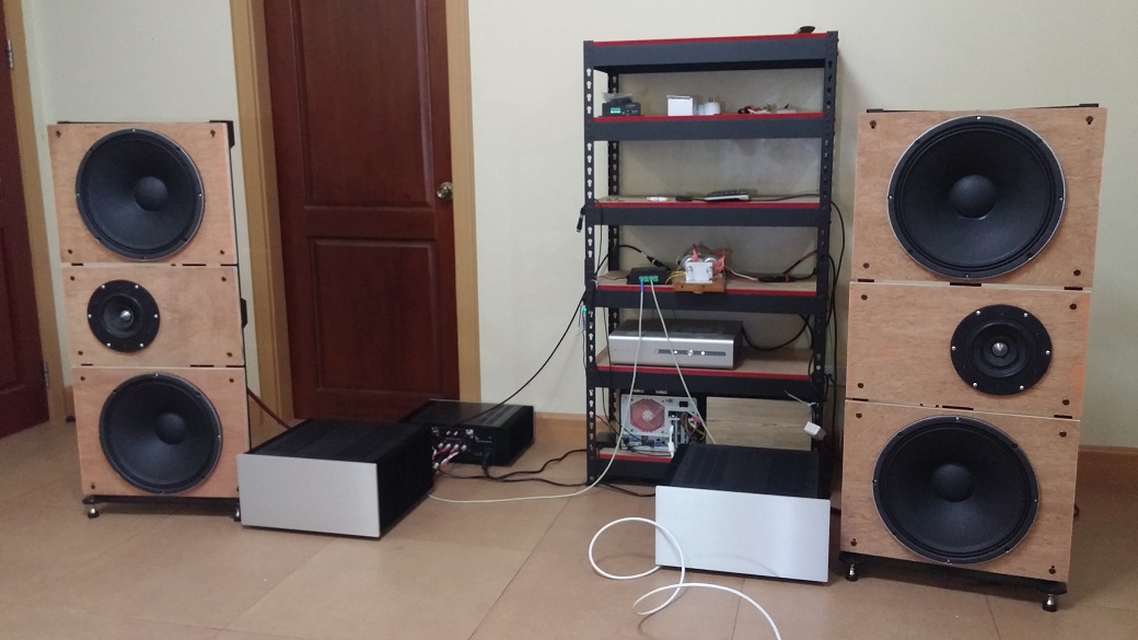

And here is what I am listening to at the moment
Frank lives in a walking distance from the Company I work for.
So I asked him if I could visit him and listen to his speakers when I was back in Denmark in early May
The result of the visit is that i have been playing with a set of SAL speakers for the last two months
This is fourth version i have tried
Source is a Schiit Yggdrasil with a JRiver 22 player
Volumen are S&B TV102Mk3 TVC's
The SAL is driven by the Sony VFET Diy Amps with a passive 160Hz first order cross over
The woofers are Eminence Deltalite II 2515 are driven by two stereo Aleph30 clones and the crossover is a Minidsp Balanced 2*4
The frames is PureAudioSound Trio15 Aluminium frames
And the sound is great.
Unfortunately I have to make everything ready for storage next saturday so i am enjoying the sound until then.

HI Flemming,
Thanks for the nice visit in Maj, I am so glad that you are happy with the drivers. I like your set up😉.

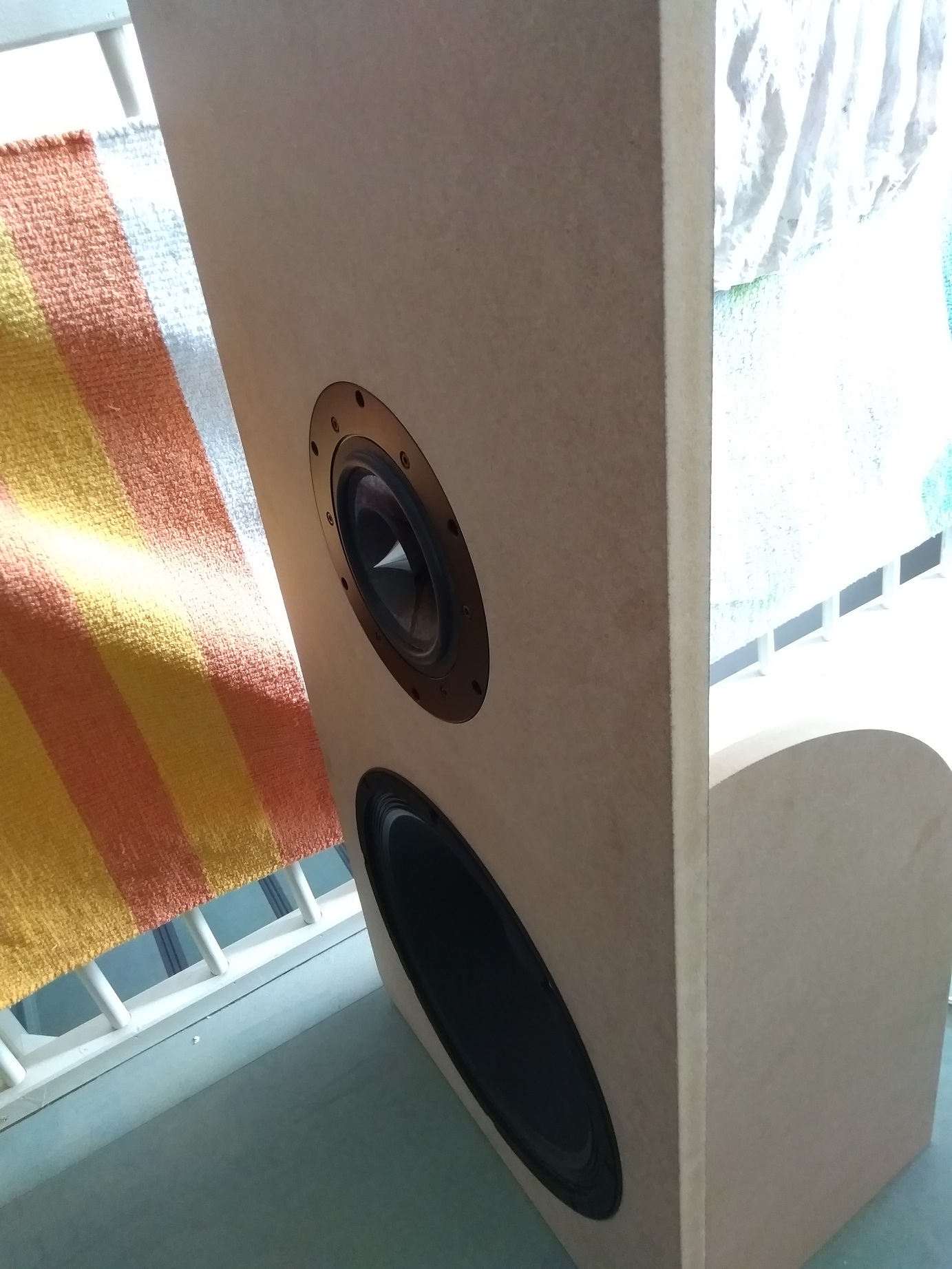

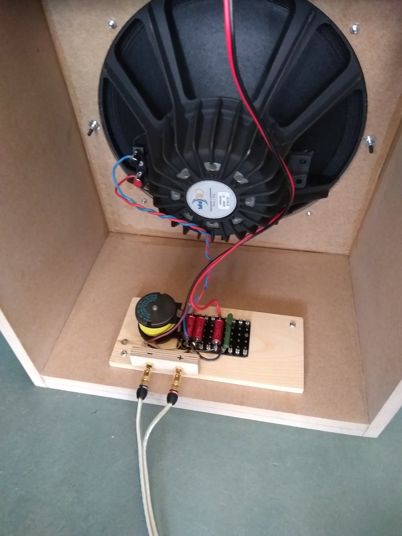

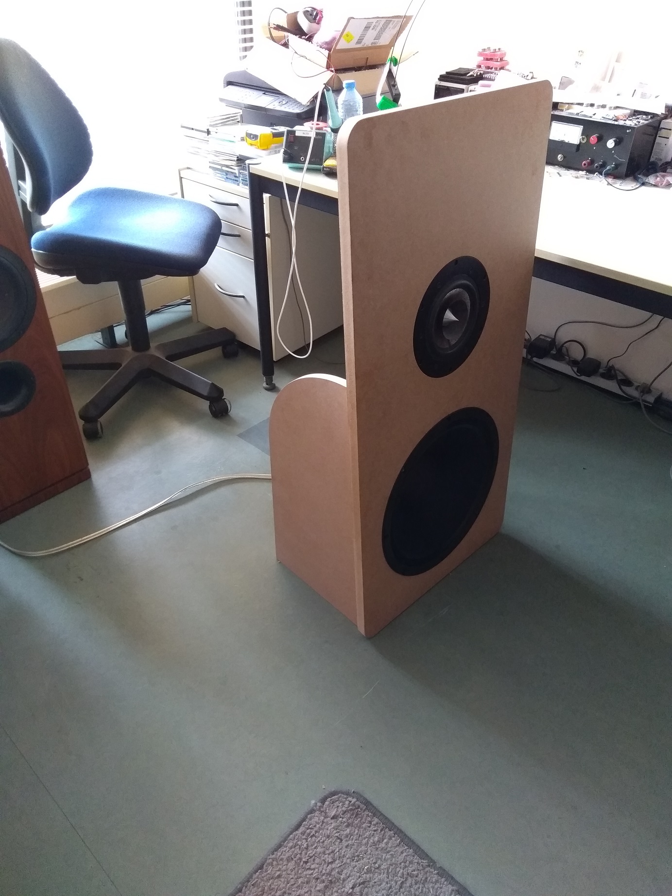

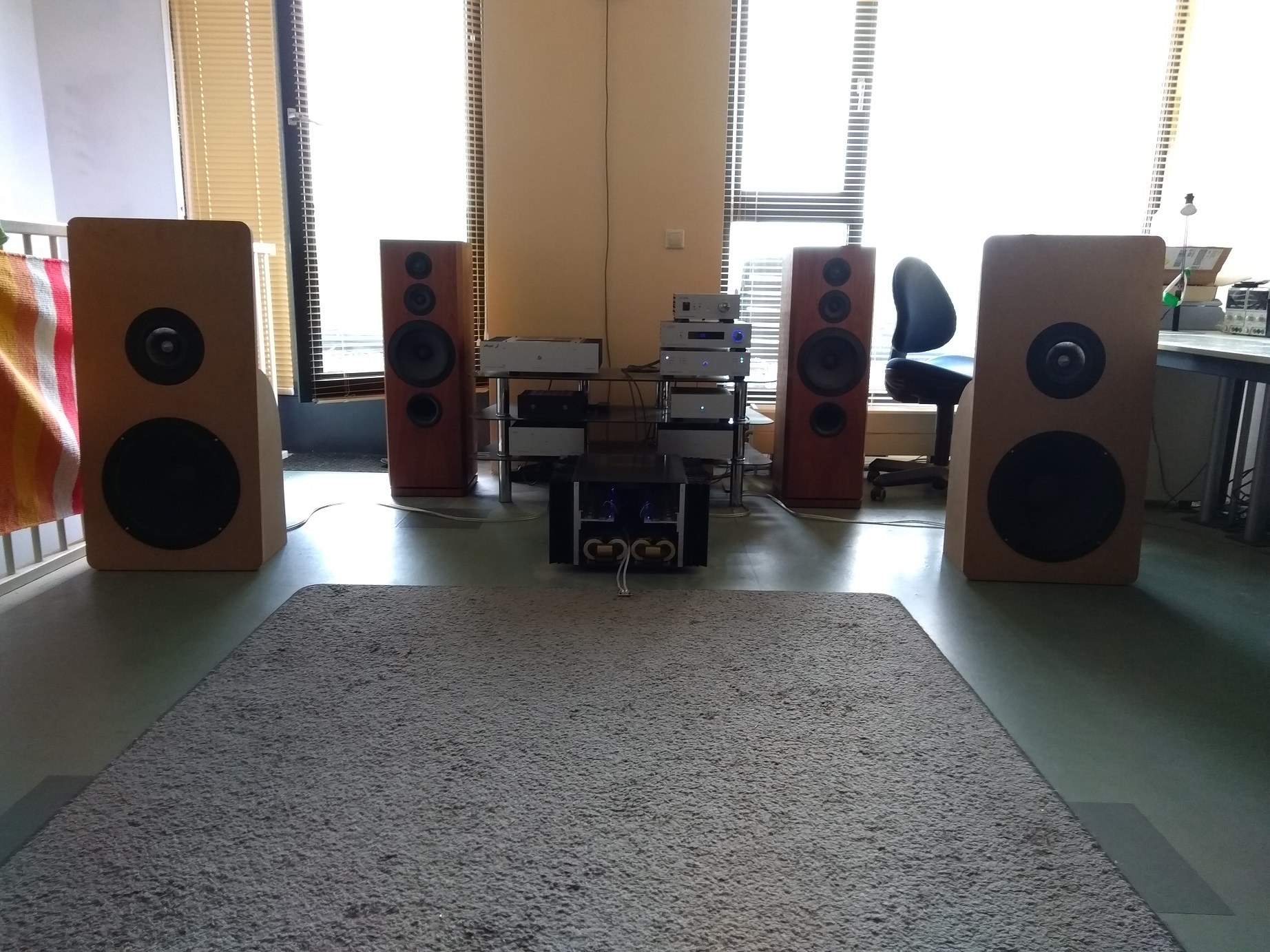

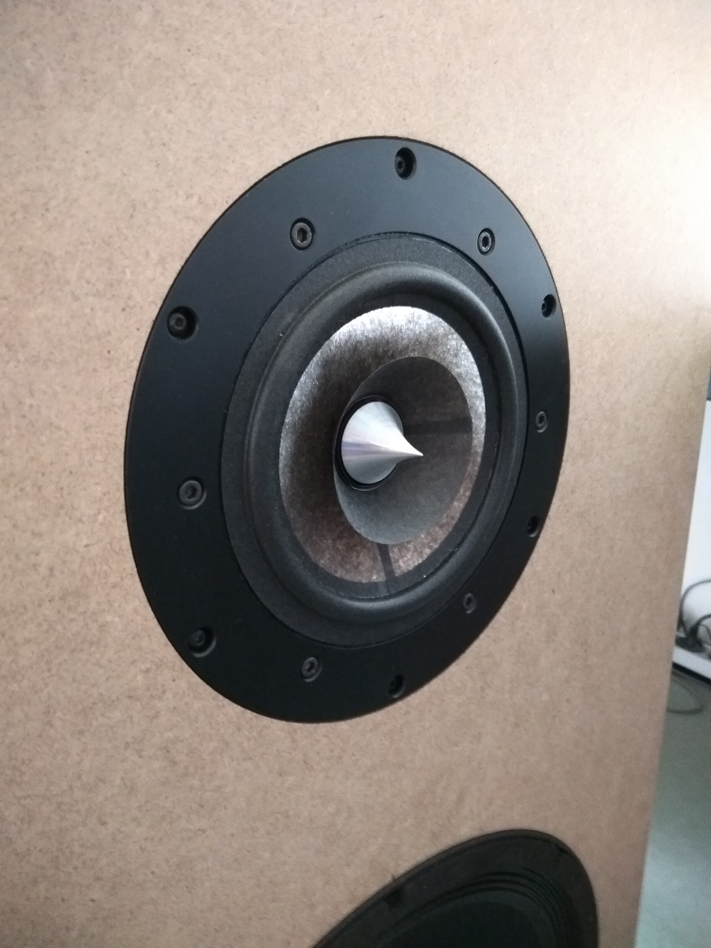

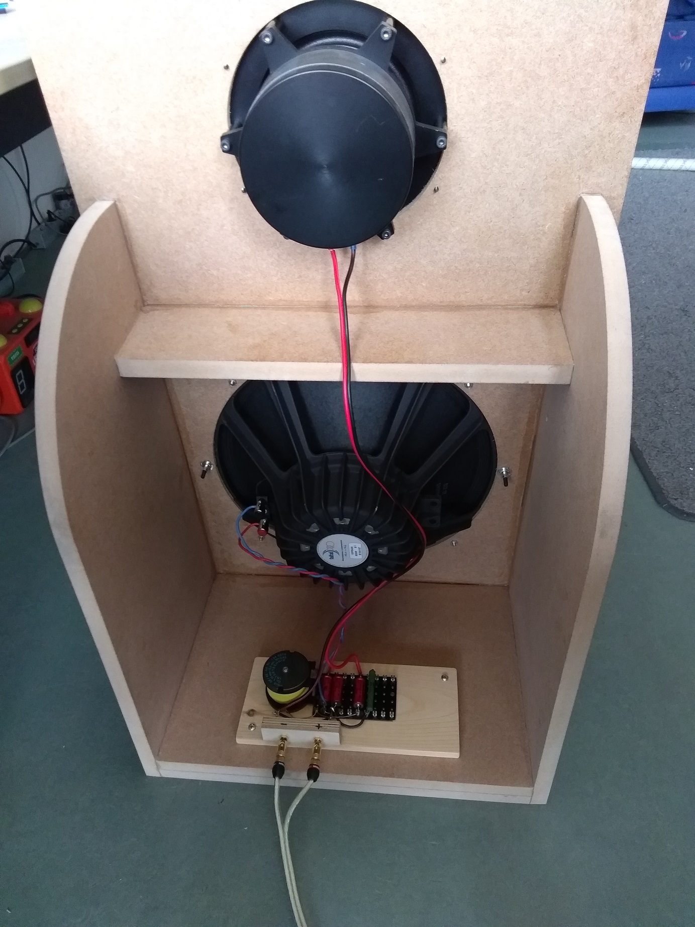

Here some pictures of my SAL implementation 😀
I have built the baffles myself, had to buy a router (is this the correct name?) to make holes for the drivers. First time I ever worked with such a device, but it was fun🙂
Lots of test pieces of wood used, to get the feeling.
The 15" drivers are Faitalpro 15PR400 woofers, which are not that expensive here in Europe.
Before this, I have listened to the FR's without the woofers, but I quickly decided that I needed more bass.
Now the speakers go low and loud enough, still working on the crossover, trial and error.
But, compared to my conventional 3way loudspeakers I'm still missing something in the higher regions, above 8-10Khz I guess.
Strange nobody has mentioned this before here... or is it that obvious with FR?
I think of adding a Super Tweeter crossed above 8KHz.
There are few threads here on DIYAudio which I'm reading now.
Probably a Fostex FT96H or T90A.
Any experiences with that? Tips and tricks?
Walter
That's a bit worrying, I was going to order the SAL in a few weeks when funds become available. Not sure now...Are you sure its not your xover?...I'm not knocking your efforts (which look very good by the way) but many say this driver is very good even as a stand alone unit?
BTW what size is the mounting whole for the SAL as I'm having some baffles machined/cut. TIA
Your SAL drivers is shine new 😉
Play nice acoustic music every day on your OB give them little more time
and wait novembre BAF 2017
Greetings 🙂
Greetings 🙂
Walter

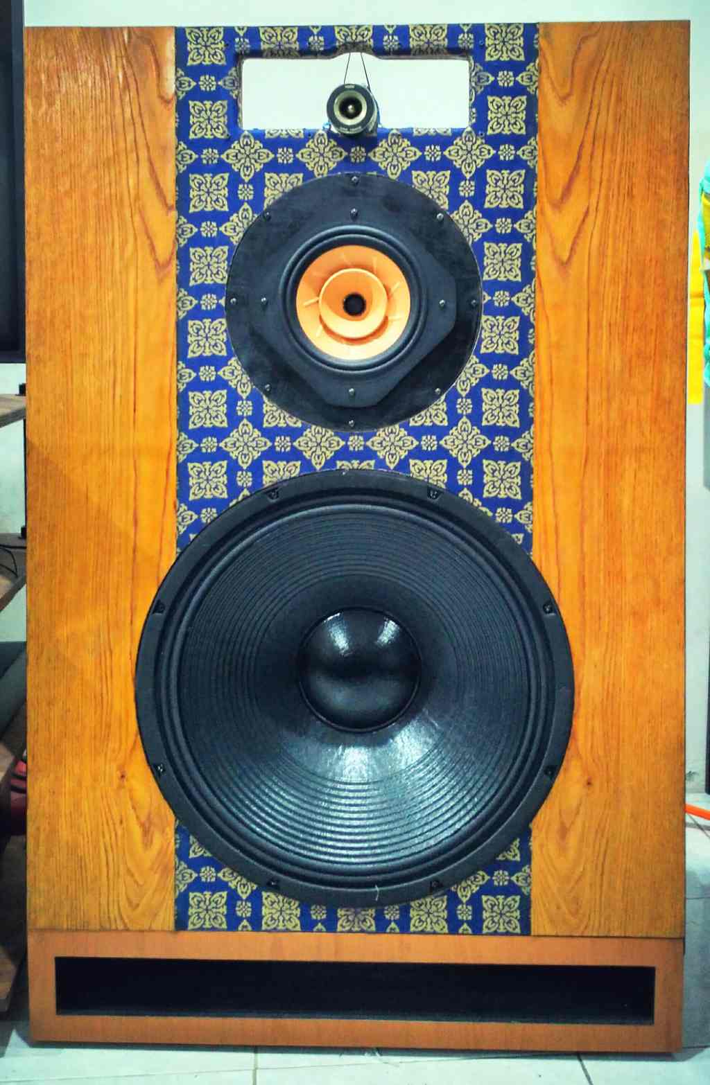

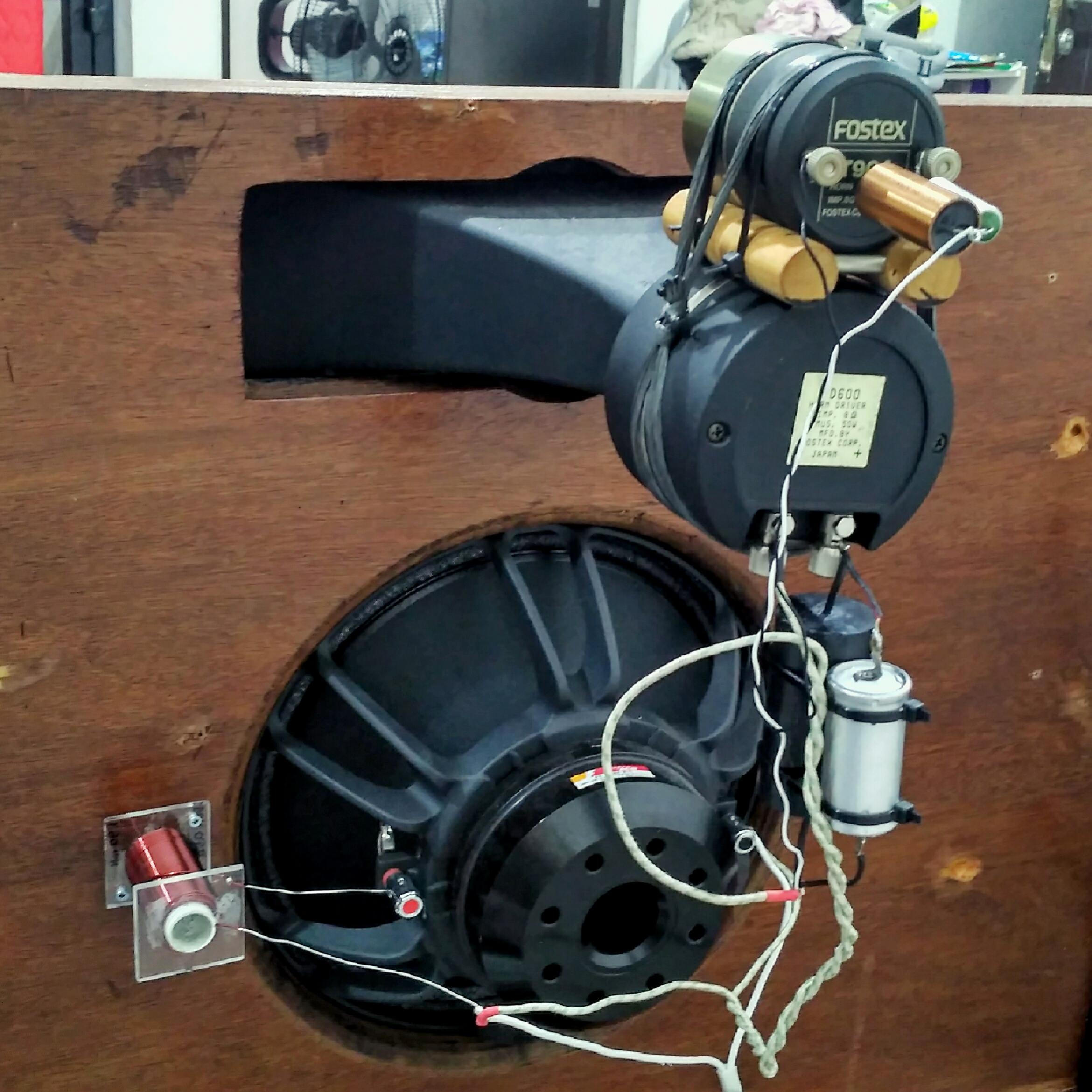

Same here, I have used Alpair 10p, Fostex FD600 horn tweeter, local made Fullrange 8" and they all need additional tweeter / super tweeter.
for low efficiency driver like A10p, using car tweeter is the best option which I cross @10kHz.
For high efficiency driver then you have no choice other than super tweeter, I set T90a filter with 0.33uF. Using lower cut off (with 1 or 1.5uf ) might possible but you'll need additional Lpad.
Maybe you can add Raal in your option list, I have not tried it yet.

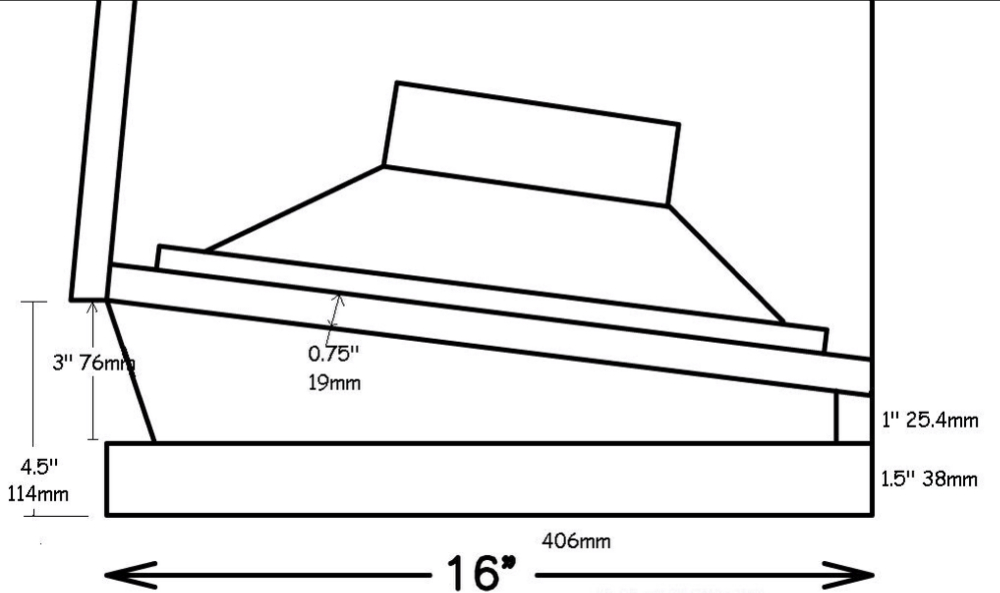

heres a diagram of the driver, with dimensions, from Frank
