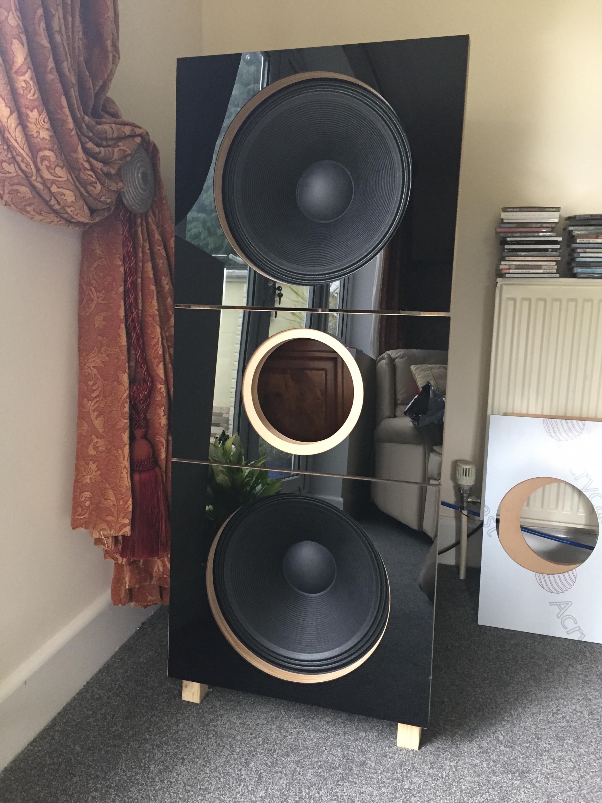

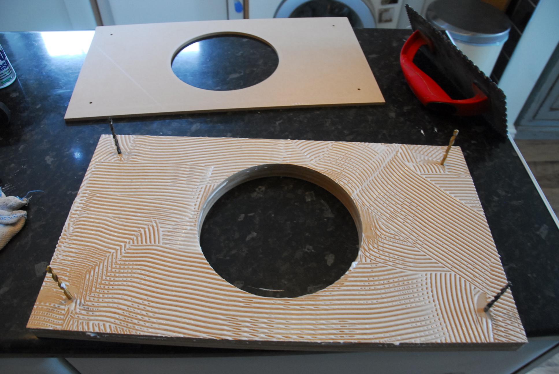

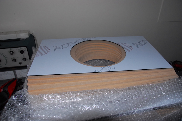

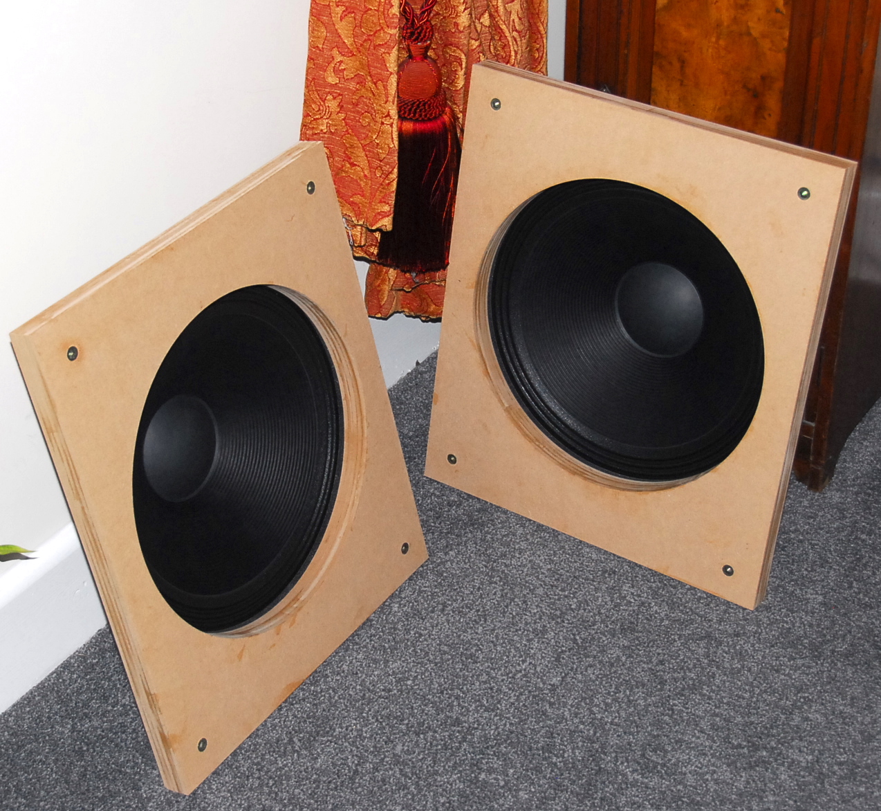

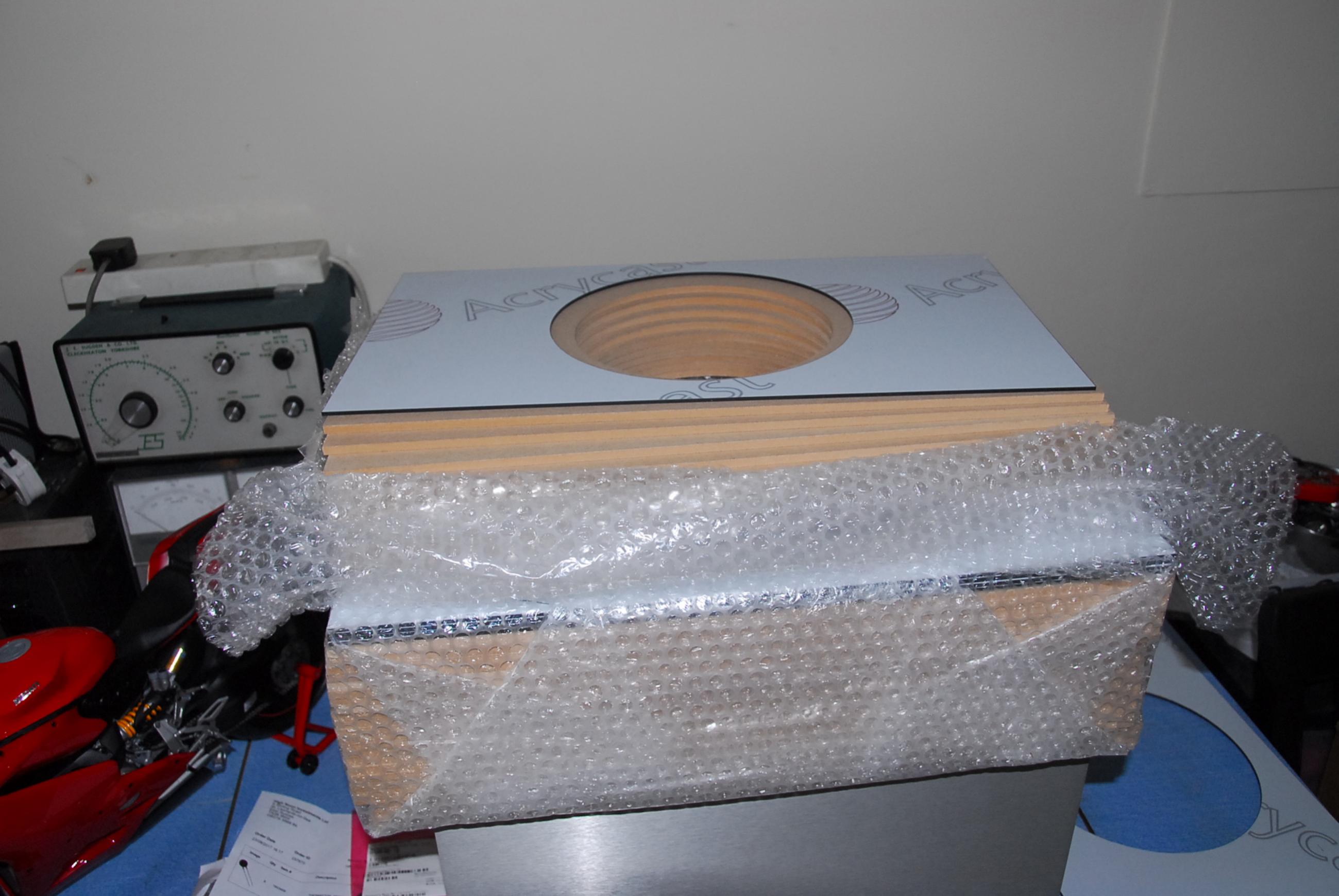

SAL with Emenence Betas 15"

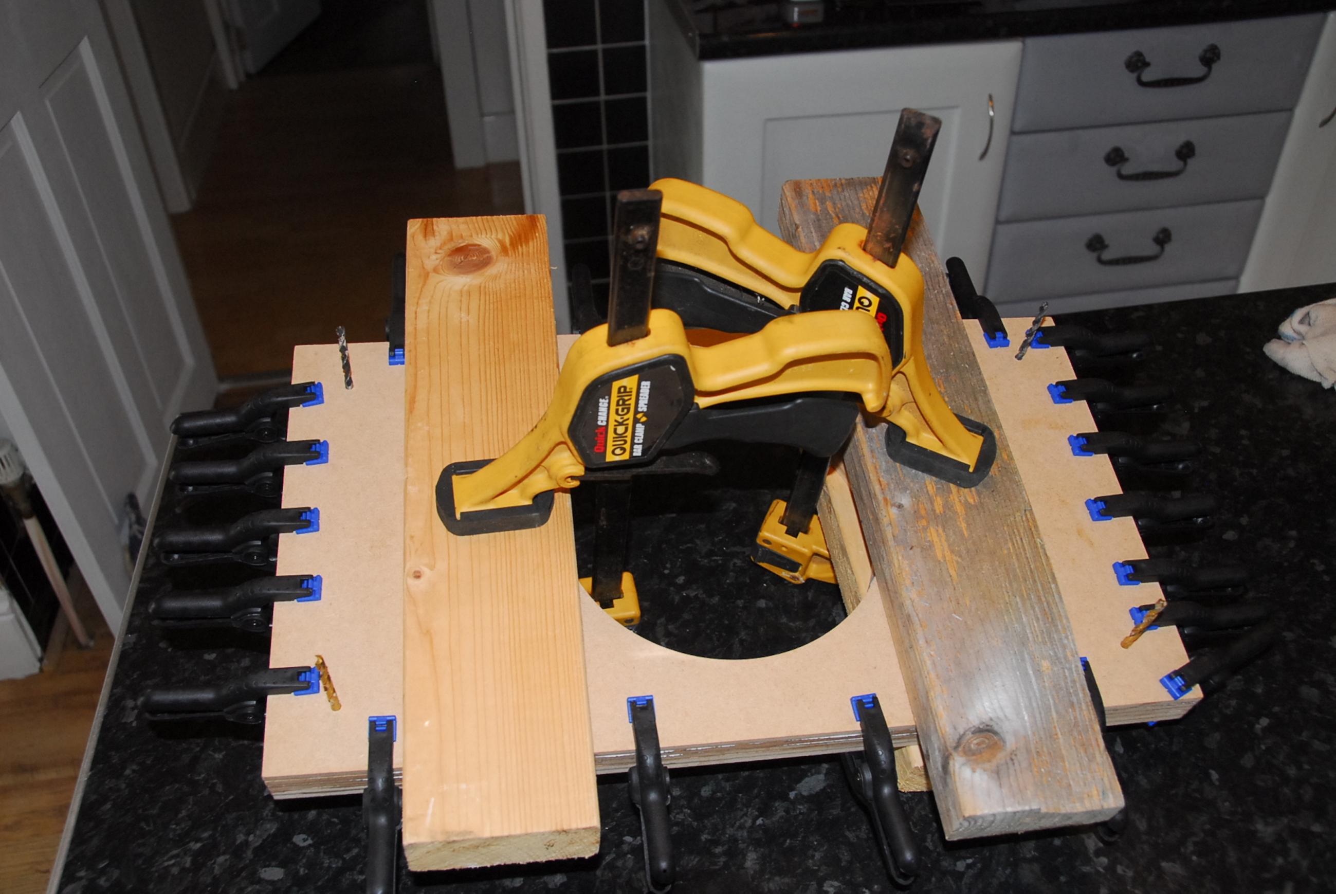

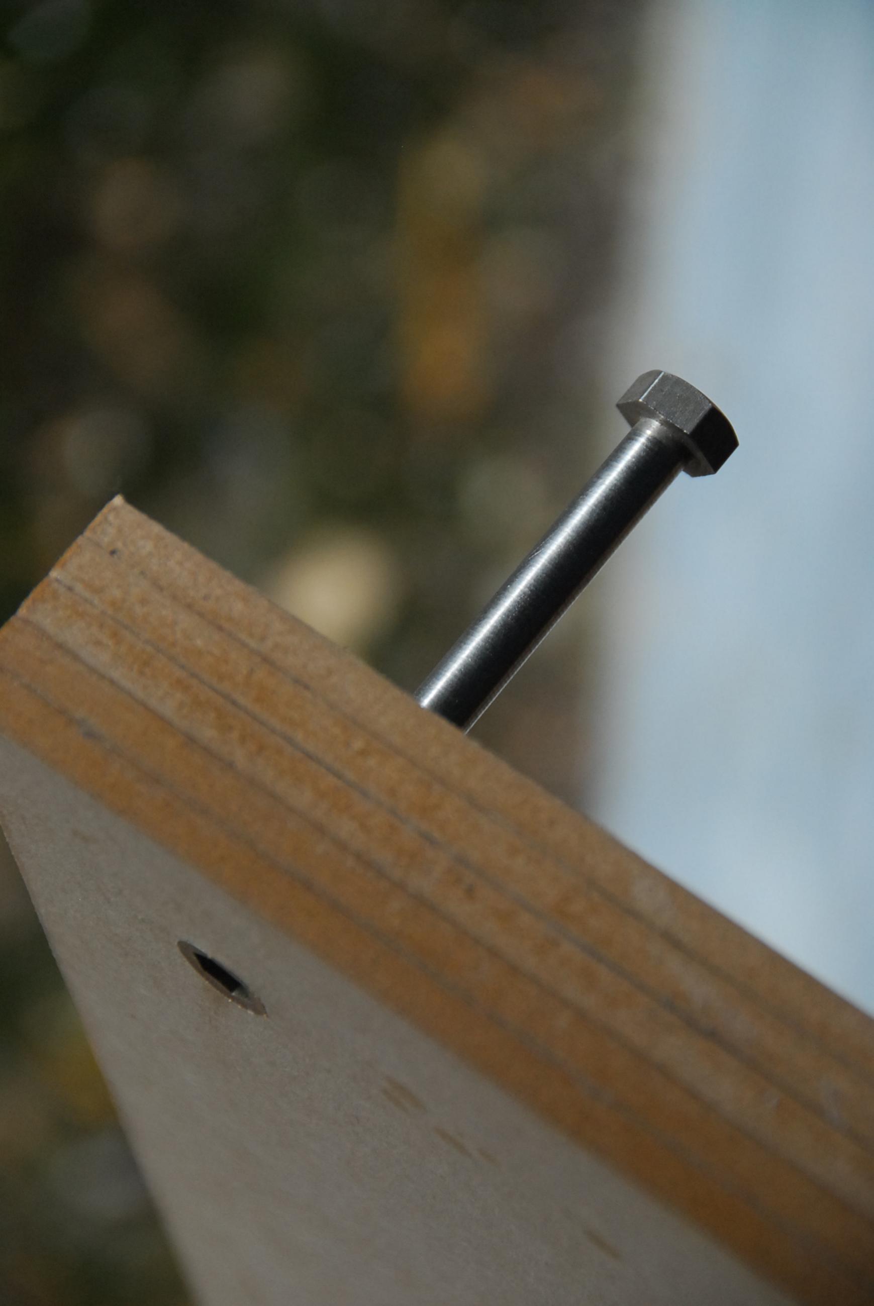

SAL baffle board/s are made up of 5 x 6mm MDF 'laminated' which where CNC machined to provide exact alignment as will the Beta 15" divers. This was achieved via 4 x 5mm holes and drills. I went down this route because 25mm mdf is 'soft in the middle' but by laminating 5 layers this results in a much stiffer (inert) baffle which is for more resistant to 'squeese'. The front face of the baffles will be covered with black acrylic. Fixings with be hidden 'nut serts'
I'm awaiting funds to be become available to purchase the SALs units but the rest of project can move ahead as most of it are favours owed. (Apart from the outlay for the 4 x Emenence bass units.)
More to follow...

That looks great, very nice job... Looking forward to se more.:) I did a laminate with 4 psc 19mm MDF, it was heavy as :shutup: but very stiff.

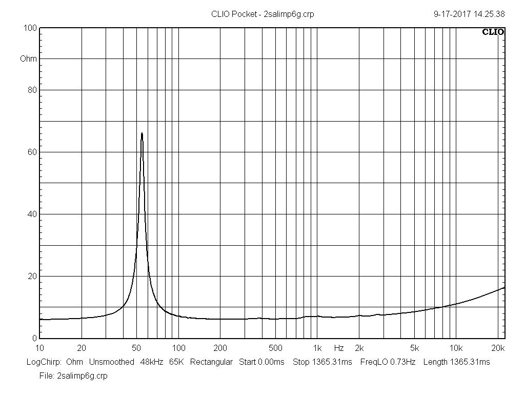

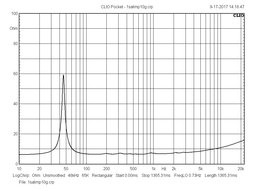

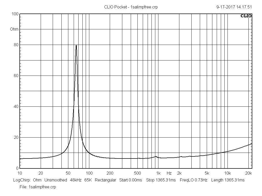

Frank,
I was getting ready to cut plywood and decided to measure my own T/S parameters first.
Attached are my impedance plots with different masses added to the cone. Looking at the 6g figures, I'm getting Vas arounf 11 litres. What are you using for piston area?

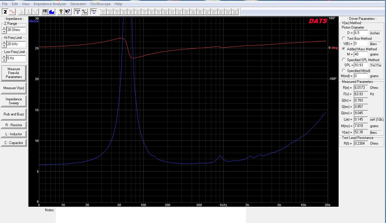

Hi Mike,
I use the Dayton measure device, I don’t know Clio Pocket.
But here is the result from my Dayton, se picture below.

Hi Frank,
A couple of things. The piston diameter is noted as 6.5 inches on your screenshot. That will throw-off the calculation. Also, 40g would be way to much added mass for your light cone. I measured both speakers using 6,10, and 15g weights, then calculated Vas by hand to be sure. I'm seeing Vas = 11-13 litres.
The good news is: that would explain why the speaker sounds decent is a smaller box. :)

Hi Frank,

Hi Mike,
I am looking forward to reading your article, will you be posting it on this forum?

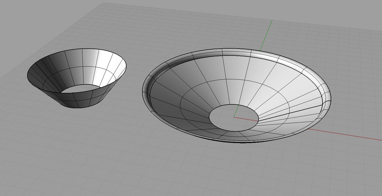

Here is why I used 6.5”. The cone diameter is to determent the area of the cone, but the since the cone is not flat but has a conical shape, I calculated the area. And since the air-load affects both the cones, I used the combined area of both the main cone and the wizzer.
If you look at the picture you can see, the area that I used for my calculation.
I agree 40g is a lot, but the Dayton is measure at a higher level of delta fo, so it need a larger weight.

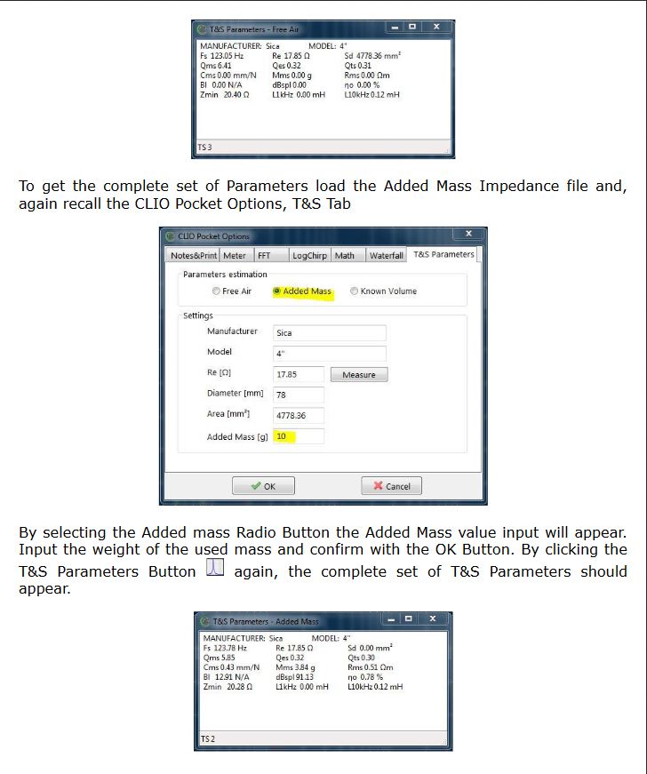

Hi Mike,
I just looked in the manual of Clio pocket, that you use. Shown in the manual as picture below, they are adding 10g to a small unit with a Mms of only 3.84g. Just for experimenting, you can try to measure again with a larger weight and se what will happen.

Hi Mike,
No. The relevant effective area (Sd) for the emitted sound is the plane projection of the cone (at least at low frequencies, remember we're talking Thielle Small here!). Sd does not depend on the 3D shape of the membrane. Otherwise one could simply make a very deep cone to obtain a large Sd in a driver with a small diameter.
Or, in other words: the volume of air that is "moved" by the driver is V = X * Sd, where X is the membrane excursion and Sd = pi * r² is the effective membrane area (r is the membrane diameter plus half of the surround). The volume of air that is "moved" by the driver does not depend on the 3D shape of the membrane.
Yep, I stand corrected. What I was thinking of was the air load on the cone, and this somehow, I got it mixed up with the measurement of Vas. Sorry about that.:eek:
I did some new measurements with the new diameter and got Vas to be around 17 L.
Frank
