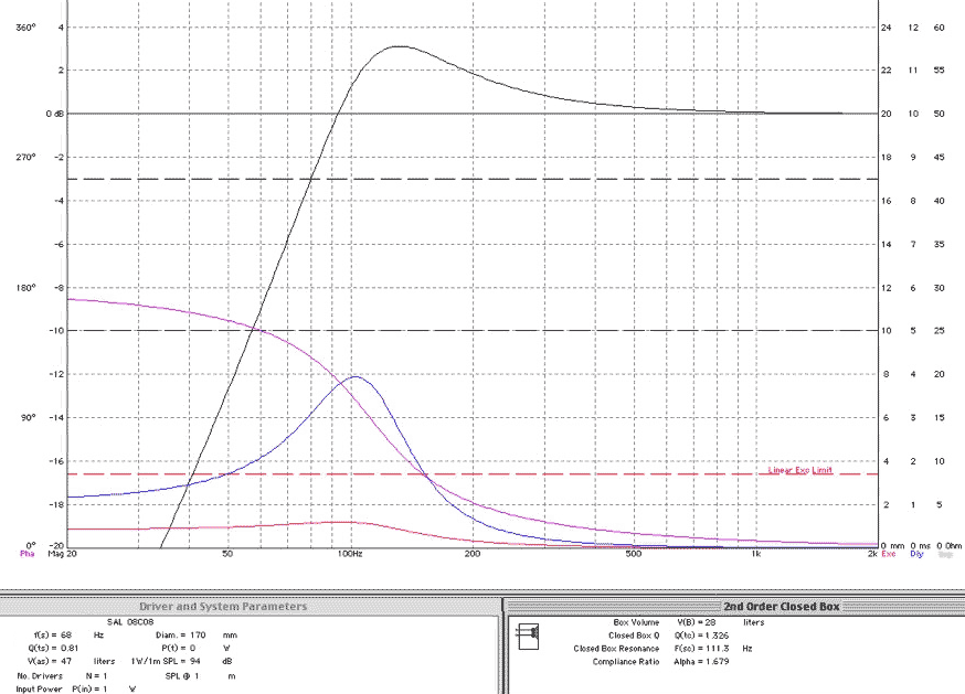

PS: 1 ft^3 ~ 28 litres which is much smaller than you really want.

Probably best plan to make a rough set of bigger boxes about twice the size to test, About the size of a Large Advent, if you go back that far..
Maybe that bump gives the illusion of bass!

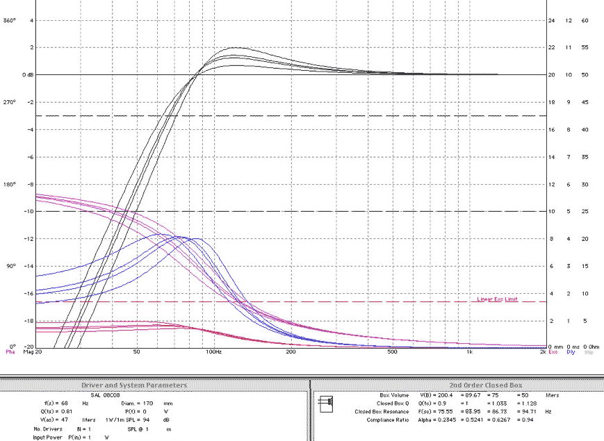

Dave's sims indicate a 200L sealed box F 75hz., something like a 14"W x 42"H" x 22"D behemoth!
Sims suggest as large a box as you can live with sealed or aperiodic OR open baffle.
I can't stop but think that aperiodic is a very cool idea for this driver. I have never actually messed around with an aperiodic, so I don't really know where to look and how to do it. Are there any reports related to the SAL driver in an aperiodic box out there? Anything specific to watch out for? Box size, design of the vent?
...sims indicate a 200L sealed box F 75hz...
F3 is not a very useful bass indicator, the 50ish Hz F6 or 40ish F10 are much more meaningful.

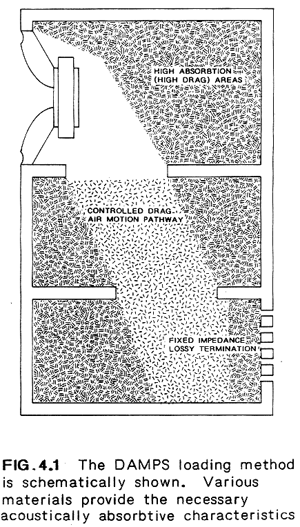

I am faced with similar design issues with some Visaton B200s i want to put in a box. Fortunately one of my gurus as i was learning speaker design did a huge amount of real research on Aperiodic enclosures so i have a good grounding in their design. Modelling them is tricky (if MJK’s modeler was calibrated for hign desities of damping it could probably do it, and AKABAK might) so cut & try is the way forward. With these i’d consider a 75-100 litre box, then you start drilling holes in the back of the box as far away as you can from the driver and heavily damp the holes from the inside using compressed fibreglass, ultra touch, or high density open cel foam. The rest of the box should also be heavily damoed but with a lower density path from the back of the driver to the vent. You iterate until GMs clik test sounds right or the measured impedance has maximized the supression of the impedance peak.
This cross-section of the PR200 (an advanced aperiodic box) gives some ideas on this approach.
dave

decidedly old school, but there is a broad sweet spot so not as tedious as it sounds. I have built more than a few aperiodics using this receipe.

I guess all it takes is to measure the impedance curve of the aperiodic system and tweak the impedance peak shape until it matches the desired Q of the speaker system by varying the stuffing of the box and the "leak". The SAL (and the Visaton B200) both have a Qts of around 0.75, so very close to but slightly higher than the "optimum damping" of Q = 0.707. If I understand things correctly, this means that it would be best to get as much damping as possible from the aperiodic box in order to not raise the system Q much higher than the Qtc of the driver. I'd like to stay at Q < 0.8 or so to avoid peaking in the bass response.
This sounds like I should give it a go. It's easy to make and tweak, and even newbies would be able to build this. Just give me a pair of SAL drivers and a week of holidays and I will be all over it!
