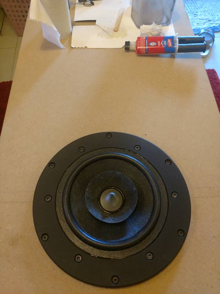

Frank,Hi aoc,
Sorry to hear that is has come loss. But is an easy fix, you should use 5 min. epoxy to attach is again. I know a lot of other manufactures use screws to mount their phase plugs, but the magnetic linearity suffers, when you need to make a M 5-M6mm threat and maybe 10-15mm beep to mount the phase plug. This is the reason I use glue.

Do not use doubled sided tape it tends to be flexible and over time. and I am afraid that the contestant pull from gravity will eventually make the phase plug rub the voice coil.
It is an easy fix using 5 min. epoxy, use 4 toothpicks for spacers and let it set for an hour and they are ready to go.

If you use the slower setting epoxy you should have better adhesion, according to the specs on the product I use...same epoxy different hardener. Also, I must say that your experience would have made me sick. Were they looking for plutonium?

Frank and all who responded,
Thanks for the guidance... Deed is done... Now the waiting for it to harden. Voice coil still moves freely... Was worried the epoxy overflow, only use a thin layer in the middle as well as fill up the gap in the speaker "pole”

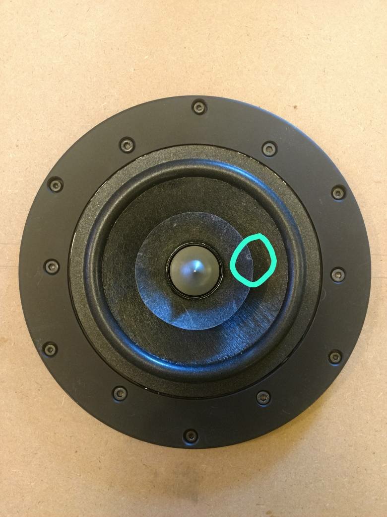

Dave & Frank
I circled the small tear... anything that I should do about it?
Alex
Alex
Not a SAL, but i had the phase plug in a rare TB driver get knocked out and i used epoxy to glue it back and they are fine. My wooden phase plugs are light enuff that they magnetically attach with just a couple steel screws on the bottom of the plug.
Probably more of an issue is the mangled whizzer cone… there are ways to minimize the effects, but that is the whole other subject of treating drivers.

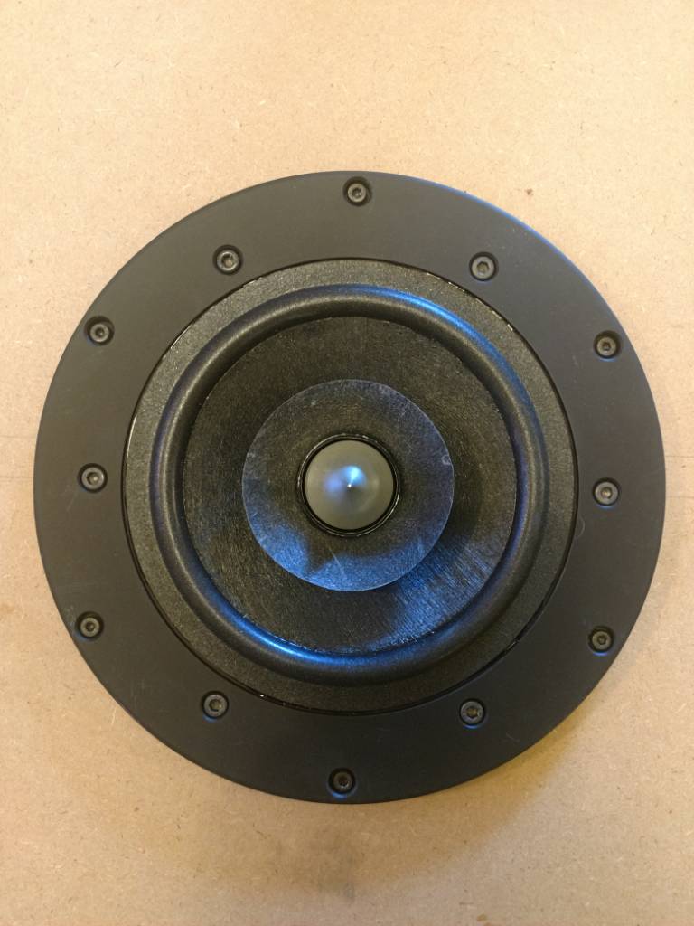

It's alive .... Definitely sounds different with phase plug than without. I have been listening for 4 days without Phase plug on one side, the difference is highly noticable
Alex
AlexView attachment 663694
I'm sure a 'spot' of good superglue is all that is needed.
Noooooo! Dont use superglue! (Cyanoacrylate) It dries very hard and will eventually rip the edge around the glue spot through movement. Use a soft, rubber type glue.
This is experience speaking.
Hi Alex,
I needed to do an experiment before I could answer the question regarding wizzer. Since the coating of the wizzer is very similar to epoxy, I tried to tear one cone and repaired it with epoxy, and it works very well.
I would recommend that you put just a little bit of epoxy, on the rear side of the wizzer and massage into the material. Remember to remove any leftovers. When the epoxy is dry it will not be visible. You don’t need to worry about the extra weight since the amount you need is close to nothing.
Hope this helps
Frank
