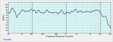

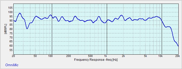

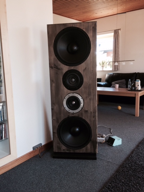

Variac, what is your suggestion to remove the dip ? I move the speaker around the room, far and closer to the wall, still not improved the higher frequency. Of course, I have not made the measurement each time I moved the speaker around to see if the dip goes away or move to different frequency. I will make a few more measurement to see if the dip is still there at different angles of the mic to the speakers (which I think it still is since the frequency is still not "open and airy")

Not that I think this is related to the 5.5kHz dip, but looking at the sum of the SAL + woofers it does not look like the woofers are cut off at 300 Hz. Did you measure the response of the woofers alone?
yes, I did. If you looked back at the overlay plots. The BLUE curve is the Sub alone. I sweep it from 10hz to 500 hz

To fix the dip you need to understand what causes the dip. That's why I suggested to take measurements at different angles and at different distances; and a time-domain measurement (impulse or step response) showing the direct sound from the driver and the later echoes etc.

That curve does not seem to show any effect of your claimed 300 Hz low pass. The output is at full level even at 500 Hz, where the measurement stopped. Please check again and take the measurement to a higher frequency. I suspect the woofer output is overlapping with the SAL quite a bit, which may affect the overall sound quality of your system.

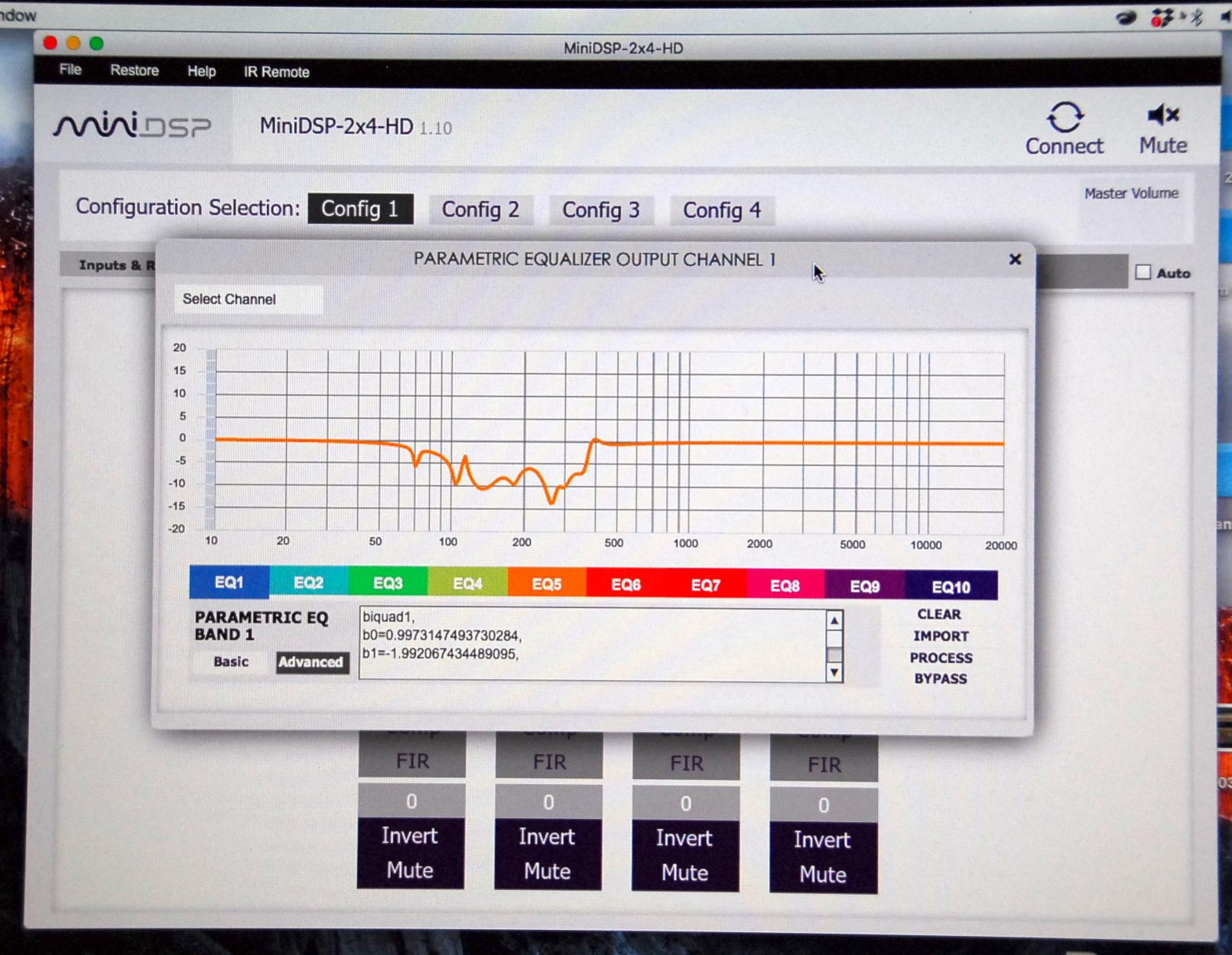

This is what the EQ 'text' file turns into when imported into DSP PEQ
Channel 1 (SUB)
This is from a 400Hz xover point

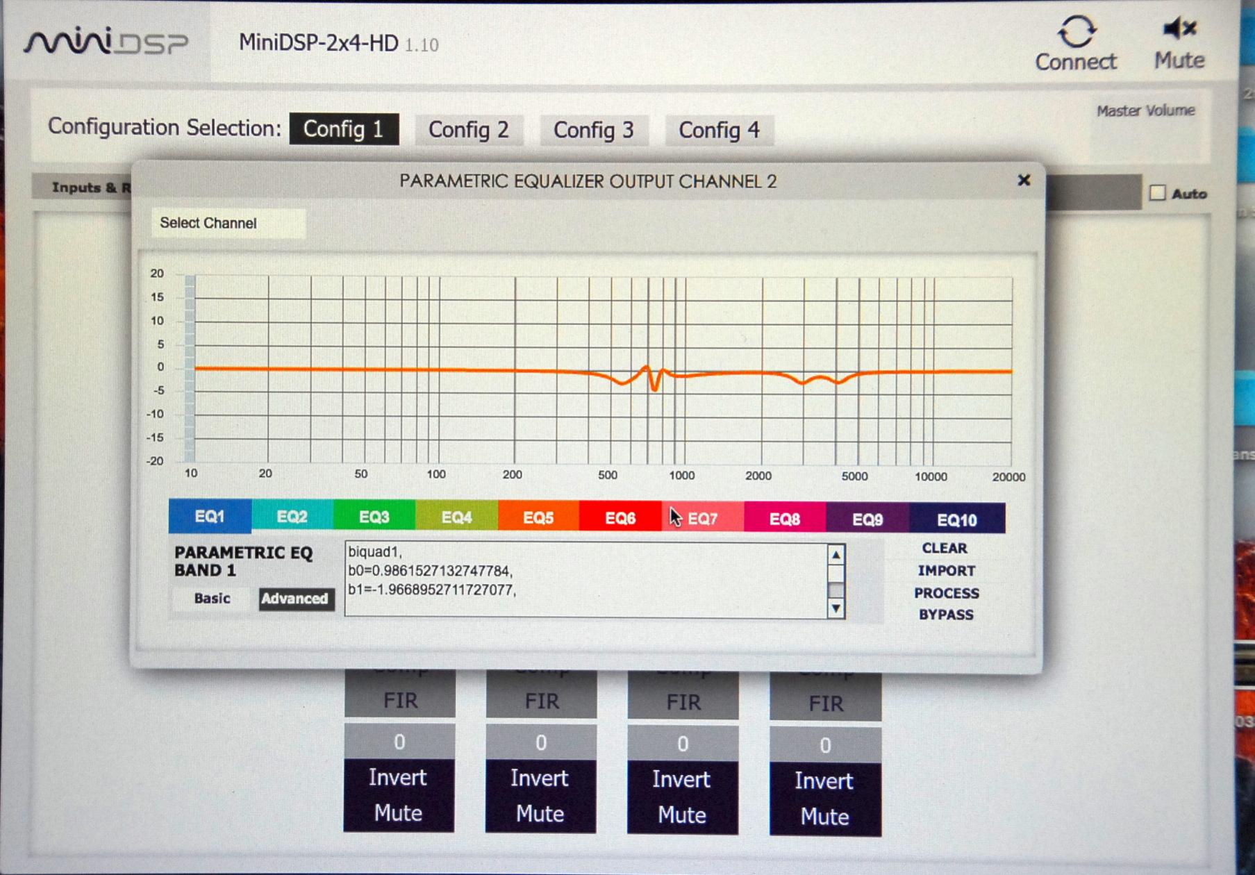

Channel 2 SAL PEQ
All gobbledegook to me really but it sounds great...

How would you compensate for those dips especially at 5k ?
I don't do EQ except broadband. High Q equalization for narrow band
dips and peaks tends to defy correction. If you do want to try anyway, I
recommend going in half steps - if the peak/dip is 10 dB, then apply
5 dB correction and see how it goes.
In the end, your ear will be the most reliable judge.

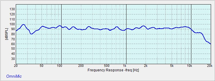

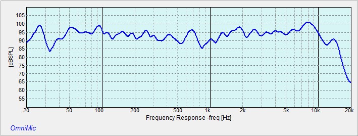

I just took some quick measurements to see if I could replicate your results, but no matter what I did I couldn’t. I did manage to get a did at 800-900Hz at about 60cm from the full range unit. I use a singled ended triode amp. Hence the cutoff at high frequency.
Picture 1: 60cm resolution 5dB, Picture 2: 1M resolution 5dB, picture 3: 1M resolution 10 dB
What is the acoustic environment with this (baffle width and driver position on baffle, box type, etc.)?
Frank, I believe you had the impulse and frequency response of the SAL driver measured by some external company. If so, can you provide these data?
