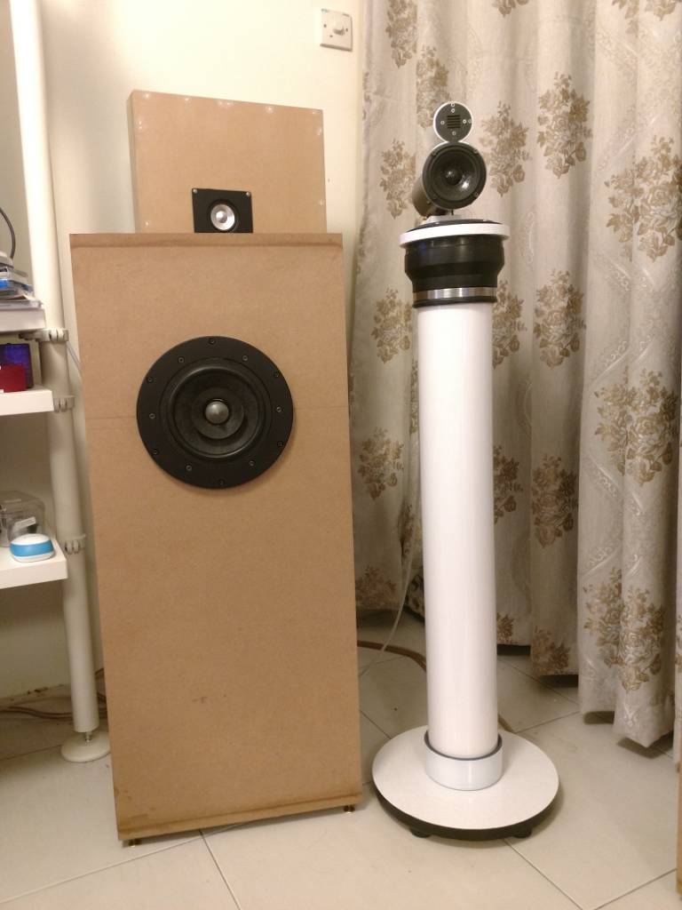

Thank you scottjoblin, bk856er, and Variac.
I will start from scratch this time. Will buy the Jasper jig and router. I was using the jigsaw but it does not cut the perfect circle!
The design I was using is straight from PureAudioProject – Open Baffle Speakers, Drivers and more... They were using the same sub, obviously different FR driver. Not sure what Xover they are using.
I was thinking of DIY Pass B4 active Xover to tune in different slope and XO frequency. I'm also patiently waiting for the Active Xover kits from Nelson. He told me he will release it some time this year not sure when
I build my first unit yesterday, will continue with second this week. I'm using a seal box for now will drill holes at the back as suggested by Dave after both units are up so I can judge the addition it brings (Not that I don't trust you Dave, just wanted to experience it)
Initial first sound wasn't appealing at all, but I did see Frank remark about long break in, so after about 2 hrs at low volume I did notice improvement in vocals and treble, however bass was still weak but integrate well with sub to give nice bottom end and punchiness. The lack of bass might be also from fact that it's single channel in stereo setup.
I'm using it with MinIDSP haven't tried to EQ or measure it yet.

I think my faith has been restored. I bought 4ft x 4ft heavy plywood and install a single SAL in the middle and directly connected to my F4/BA3 amp with no filter.
The initial result is very POSITIVE. Right out of the box, with no break in time, the driver is able to deliver solid good sonic quality with very relaxed, soft inviting, and non-fatigue midrange, a tad shy on the very high note and a good bit of bottom end. To my surprise, the music is so so much better with this configuration of single SAL on 4ftx4ft than my previous model (2 15'' sub + SAL in the middle in 3 separate pieces). I'm pretty sure after break-in time, the sonic quality of the driver will be alot better
This initial results gives me courage to continue on this journey. I just made the order of MiniDSP 2x4HD and UMK-1 microphone for freq response measurement. I will start Active Xover and biamping from here. If I receive good result, I will look into DIY B4 or B5 for active Xover.
Just a wild thought, I'm thinking of mouting 2 SAL drivers in the vertical line in the middle of 4x4 plywood sheet for the FR. For the bass, I probably LR's model Dipole protos and put the 2 15'' Emiennence Beta on each side closed to the wall

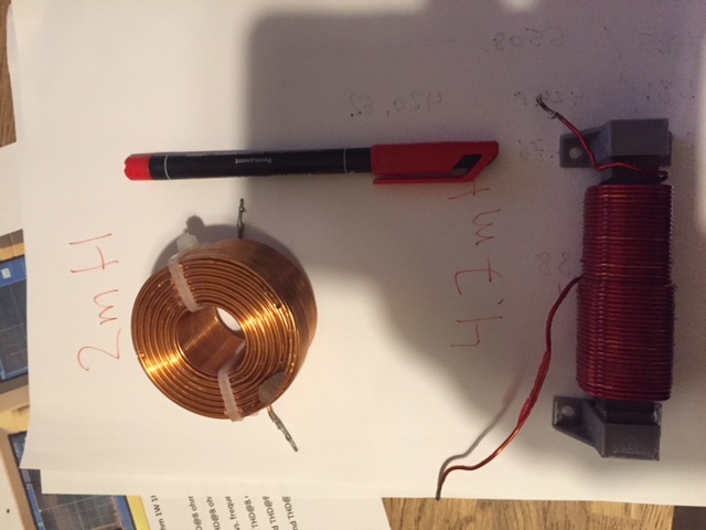

Hi Tom,
I have been looking at your crossover, and to me the inductors look very small for the value. Are you sure that they have the right value? I have a suspicion that your woofers are crossover at a to high frequency, this could explain the sound you mentioned.
Hope this helps.

hi Frank,
Thank you for the reply. I followed your Passive xover:
- For Sub, I used Dayton Audio 5.0mH 18 AWG air core in series with 150uF
- For FR, I used 100uf in series with Dayton Audio 10mH 18 AWG I Core
Does it sound right to you ?

Hi Tom,
Hope this helps.
Frank
Glad you like them and believe me they will get better over time.
Here is a quick pic. of some inductors for comparison, so you can see what I mean. Just need you to be sure😱

Thank you Frank! The driver is indeed very good! I can see what others are saying now!
If 5mH and 10mH are correct values, I will measure them in the LCR meter to make sure the values are correct. I will go with Active xover next to be on the safe side and quick experiment with different XO freq range and octave slope.
