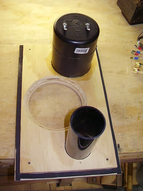

I have that same Maxell poster, and am currently using the same amp.
From the picture of the back of the baffle it looks like you need to relieve the back of the driver cutout.
An example attached.
dave
I think he means you need to chamfer the driver cutout of SAL to let it breathe.
Just to further clarify, a roundover bit with a router is the usual method.
But can this really make such a remarkable difference?
BK
We use a 45° bit to get an even greater relief. It can make a considerable difference, removing an oil can resonance and reducing early reflections back thru the cone.

hi Dave,
Besides SAL back baffle 45 degree cutout relief, is there anything else that you know or think of that can further improve the sound ?
As you can see in the picture, I do not have alot of room to further cut out since the screw to attach the SAL driver to the 3/4 in thick plywood is already too closed to the edge of the cutout circle.
Thanks,
Tom
Looks like a fair bit of room to me, but if you are concerned only ream out the space between the bolts.
Other things to watch for are cranked the bolts/screws down too much, there should only be sufficient torque to stop a real or imaginary washer from turning.
