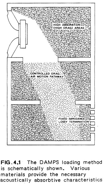

Hi Dave,Sims suggest as large a box as you can live with sealed or aperiodic OR open baffle.
dave
I happened to have a sealed box with about 75l of volume and hole cut for 8in driver. Would it be a good candidate for this driver?
I’d suggest you damp it heavily and drill some holes in the back, damp those heavily and push the box towards aperiodic.
If vut for an 8” driver, you will no doubt need to make a filler ring or ream that hole out and add a suprebaffle.

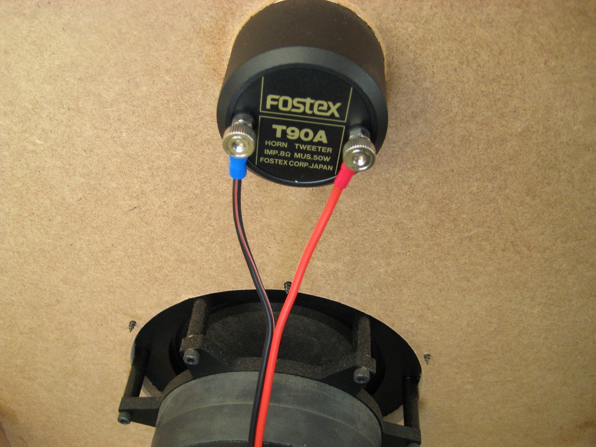

This is what I'm listening at right now.
I bought a Fostex T90A Super Tweeter to fill in the last octave.
The Fostex is crossed over very high with a 0.47uF Mundorf capacitor to have the highs I want. Tried different E12 capacitor values from 1.5uf down to 0.47uF.
Now it sounds really great!

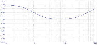

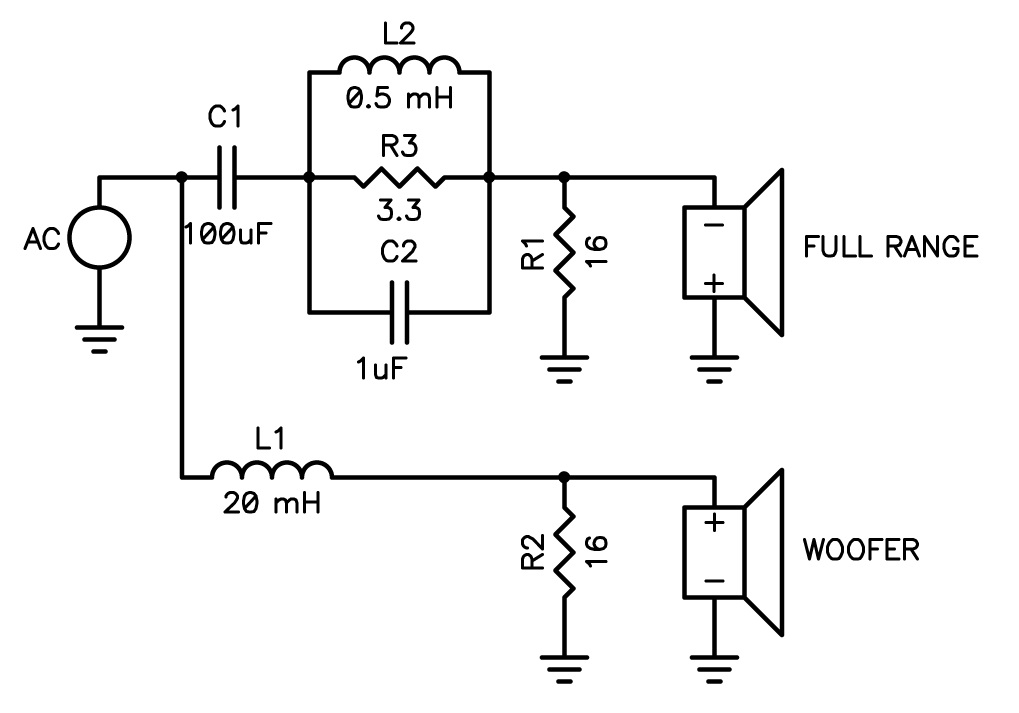

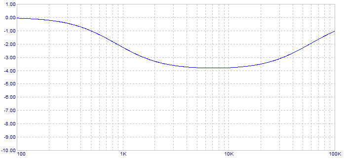

I have a question about the cross-over from Nelson. What does the L2,R3,C2 filter do? Is it a baffle step correction? Or just to dampen/filter a peak in the frequency response?
If I calculate the resonance frequency of 1uf parallel with 0.5mH I would say it's a bandpass filter at 7.1KHz with a very low Q because of the 3.3 Ohm resistor.
In my crossover I can switch it in and out, see picture, but I like the sound better without that filter.
Remember, I'm a newbie in this area😱 so I hope someone can help.

Hi, if you are using a "super tweeter" move it as close to the wideband as possible to minimise comb filtering
Thanks, I had the same idea, but was in a doubt because the Super tweeter is often used with the supplied wooden holder to be put on top of an existing speaker...???

Walter, that network you mentioned is talked about in post 13 .
Woody, yes I have read that many times, but it doesn't answer my question.
Like I said the 4KHz doesn't match with my 7.1 KHz calculation??? or maybe I am totally wrong???

It is as you describe, and of course can be adjusted to taste.
Ah, thank you Mr. Pass.
