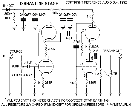

Bleeder
A 100k/2W resistor across (each) cap in the power supply.
Look at the attached schematic (coming from Frank de Grove). The bleeder is the 100k resistor in the upper left corner...

Basically, you want all the caps to have a discharge path, whether through the bleeder alone or the bleeder in series with dropping resistors. Aim for a time constant of 10 seconds or so- that way, after a minute or two, your amp will be safe to work in.
