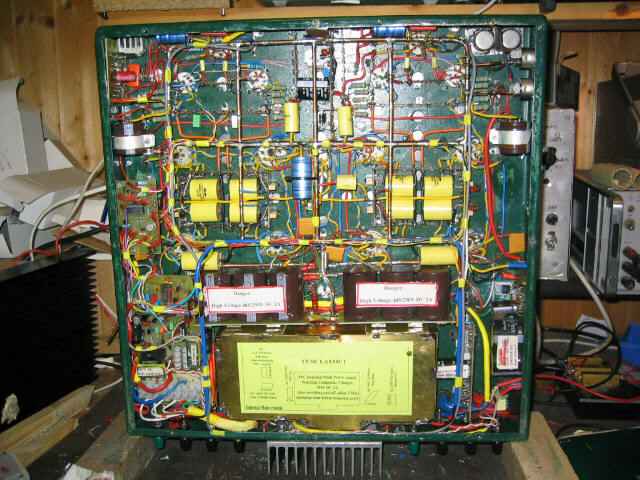

I use SMPS technology in my amps....it may be more component pricy and require more technology but... the punch it can give out with circuits using fixed bias.......brilliant bass and mid range transient handling & B+ holdup on full load far exceeds the floppy conventional PSU capabilities, but I also needed to create a design file, just in case something goes wrong with mine.
..I don‘t want to put off anyone’s confidence venturing into H.V power switchmode technology, it’s a brilliant and challenging multi-facetted technology; but those unfamiliar.... start with smallV project, and get the hang of the topologies and magnetics.
Enclosed photo of 130+130W amp innards using SMPS.
ViVa the SMPS Rat....
