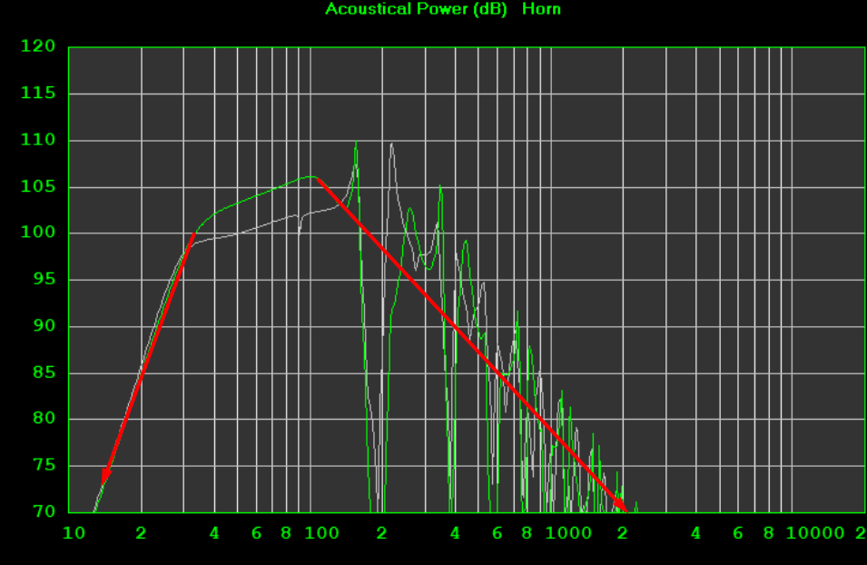

Sorry about that , maybe try
1 + sqrt(5)) / 2
rounded to 1.6180339887499
keeping things around 8.9E-5
might be civilized but still a little over kill at 6 decimal places
1 + sqrt(5)) / 2

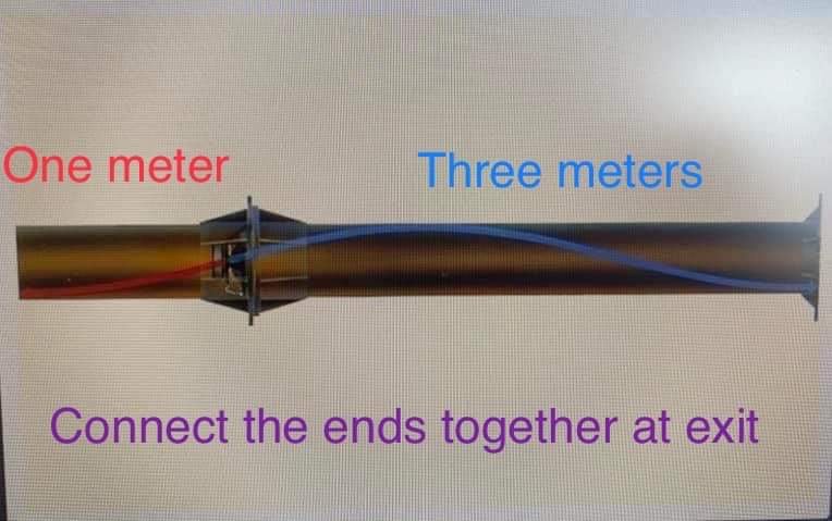

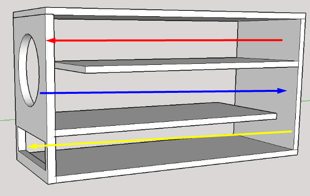

I get caught up in offset driver(1/3) TL designs and parallel qw resonator designs (3:1) and the intersting ways to piggy back or cancel out a resonance…. Both of them are exciting to mess around with And share the same interesting area of resonance /cancelation to address
Is that a cavity/helmholtz resonance canceling out the 3/4 mode or is the 3/4 mode simply not excited because the driver is @ Vmax (1/3 from the start) For the 3 x 1/4 wave length ..?
