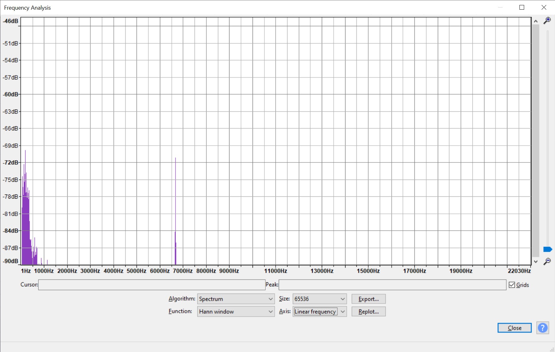

Just received my A20a & unfortunately it looks like it's going straight back 🙁
There is a constant high-pitch whine around 6.68KHz. It is already loud enough at -60dB that I can clearly hear it from my normal listening position. It makes no difference whether I use XLR (impedance balanced source), RCA, or even disconnect both inputs entirely. The whine gets noticeably worse when I activate EQ, which I need to use for my speakers.
I have tried different power cables, different power sockets, moving the amp & cables completely away from any other electronics, nothing makes any difference.
This is the second amp I have bought this week that is immediately being returned, I am starting to think that I am cursed ;_;
Yes, you might be for 6.68KHz might actually be 6.66Khz due to little measurement abbreviations and you know what those numbers stand for do you?I am starting to think that I am cursed ;_;
No, seriously. I suppose it is a defective PSU or the speaker cables have not been soldered correctly inside the amp. There is one thing you could do. That is opening it up and setting the V-adst. knob to max voltage and see if that changes the tone. But I'd probably return it too in your case and get a new one. If the new one (third amp) has the same noise you can at least be sure you have a problem with some device of yours radiating lots(!) of noise. Trying different ferrits might help. I'd start with N30 ferrite in your case for they go low down to 10khz or something, but there might be others going even lower.
I'm sure there is a shop that will sell me cables blessed by priests to combat this
But yes, my assumption is a power supply issue. None of my other amps (LM3886, TPA3116) have the same problem when connected to the same source, speakers, power, etc.
I am communicating with Sabaj now for a replacement. I hope it is just the power supply, because this amp sounds really nice... until the music stops & the devil's whine can be heard!
