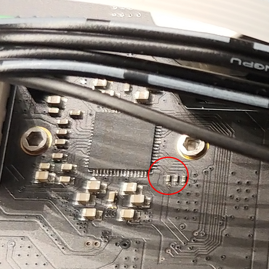

Looked for information about desoldering these SMD Caps. This turn out to be a PITA with the leadfree solder. Best way seems to just push them down and turn, so they just snap off. Of course destroying the cap, but best for the PCB... Through hole is a lot easier...
A first mod to see if 'it's worth the effort', would be to put a larger cap on pin 17 AVVD, as this gave the biggest improvement in the TPA3250 amp (Bass, dynamics etc.).
In that amp I could just solder a 470uF over the 1uF smd cap, but here this cap is ridiculously small (the left one in the circle). I can't imagine this is a 1uF /35V cap... as suggested by Infinion...
"The gate driver power supply voltage is approximately 6V to 9V higher than PVDD. For PVDD voltages of 24V and higher it is recommended to add decoupling capacitors (1uF & 100nF) from CGD0N & CGD1N to GND for improved power supply robustness."
What about this? Did they take care of it?
Would expect these to be the caps under the Chip on the photo in my last post.
The bigger ones, I can imagine these are 1uF.

1uf 50v X5R mlcc with 402 case (1mm x 0.5mm), availible for 0,015$......but here this cap is ridiculously small (the left one in the circle). I can't imagine this is a 1uF /35V cap... as suggested by Infinion...
Thanks, yes X5R probably.
Read just the other week that for audio you should use NPO or COG and avoid other ceramics.
This is well known. Problem is the form factor: a 220nf C0G mesures 3.2*1.6 mm.Thanks, yes X5R probably.
Yes, but saw it again last week in a document about components for audio, found in one of the threads here.
Interesting documents by the way, these of Baterman. Instead of using Elna and such you can better use a (cheap) bipolor as blocking cap... (when you don't have place for a film/foil).
Found a 1uF/35V 0603 size COG: GRT188C8YA105KE13J
Still 1.6mm x 0.8mm instead of 1 mm x 0.5 mm...
Must admit, 0402 and then trying to soldering something on it is beyond my soldering capabilities....
