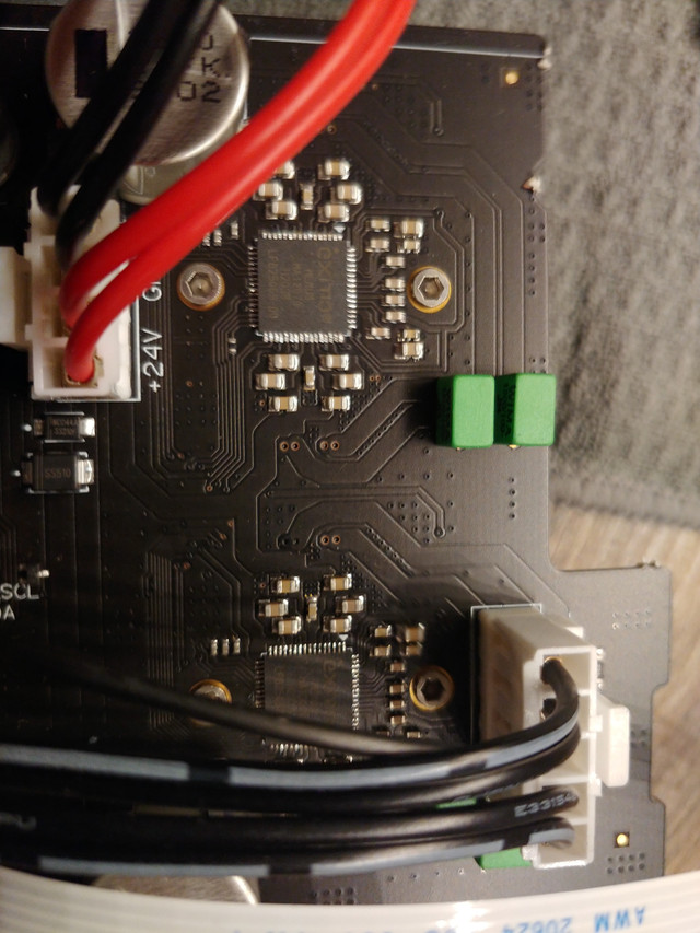

So I took it apart to examine the possibilities to optimize the sound, as I hear the potential, but it not all coming out now I guess. Other opamps as the OPA 1856 were suggested to improve the sound.
One thing already mentioned is to turn the power supply to max (about 25,2 V). But I looked up the power caps and these are rated at 25V. What is already too close for the standard 24V for my taste. I guess these have to be replaced. I don't want problems because these caps fail.

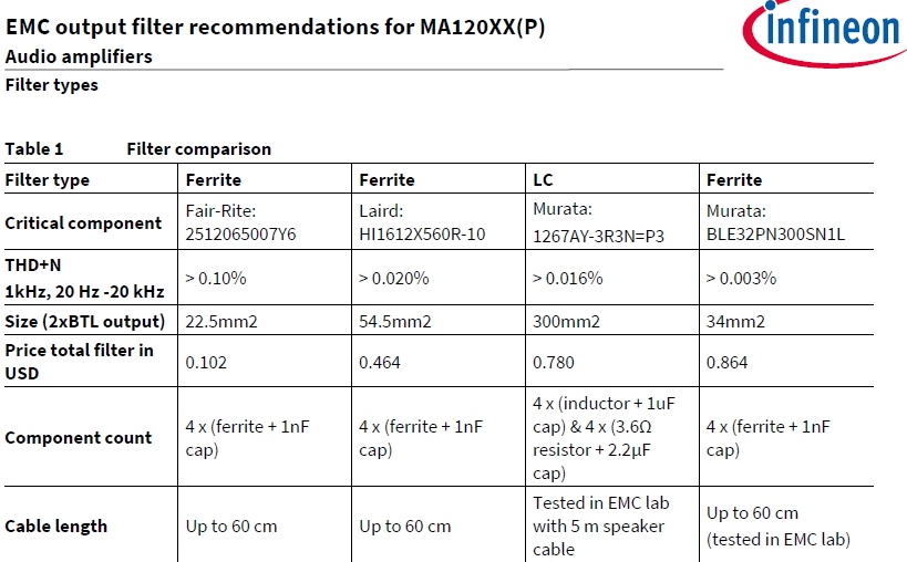

Besides the under rated power caps I have another concern after reading the EMC output filter recommendations of Infinion.
As there are no coils at the output and cables will never be 60cm or shorter. There is a chance the amp is radiating RF too much...
The speaker cable length is a dominant factor when it comes to Radiated Emission as the cable will function as an antenna. Although the MA120xx(P) amplifiers can pass the EMI test with speaker cables up to 60cm it is best to twist the cables and keep them as short as possible. Using an LC filter is generally the best option for applications with speaker cables longer than 60 cm.
For speaker cables longer than 60 cm Merus Audio recommends using an LC filter
YEP , noticed that two weeks ago.Besides the under rated power caps I have another concern after reading the EMC output filter recommendations of Infinion.
Speaks for itself regarding the amp and its manufacturer...

Don't know, but don't mind : "The amplifiers can pass the Radiated Emission test with speaker cables lengths up to 80 cm with just a small ferrite filter. For cables longer than 80 cm it is recommended to use a LC-filter."Are there no beads used at the other side of the PCB?
It may be be an issue, it may be not.
If you would mind if there are SMD beads you could consider replacing them for SMD coils. Thinking in solutions 🙂

Also noticed that the balanced input to the MA12070 (the caps besides the opa1678) are connected 1 side directly to the volume control chip, the other side is just inverted by half of the 1678. This is a budget solution saving an opamp. But this way you would expect slight differences between the positive and negative input.

The RF radiation is said to be very low by Infineon. It seems lower than usual with other class D chips by design and is even advertised as "filterless". The chip would require LC filtering only for very stringent EMI requirements. I haven't noticed anything strange while I had the amplifier.
Anyway, the SMD beads as used on the cheap MA12070 modules can be soldered on the PCB tracks of the Sabaj (cut tracks with a Dremel). It one suspects without measuring it can be reassuring. Surprising that cheap modules do have the beads 😉
