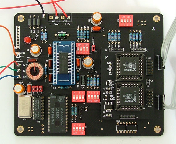

pupsik46 said:With help oxake, I could manage to work my dac.
Unfortunately AN207 type schematics works with SAA7220, but not with PCM2706.![]()
The only difference between the I2S output of the SAA7220 and the PCM2706 or the SAA7210, sample rate aside, is that BCK from the '7220 is a multiple of 32Fs and from the other two BCK is 64Fs. Using AN207 and the Japanese circuit, the difference is a problem easily overcome.
Below is 16bit I2S data.
Delaying WS with two flips will turn the data into fully right justified data and as the data is valid on the rising edge of SCK and the delay is in increments of one data bit period, i.e. falling edge to falling edge, SCK to the flip-flop's is inverted as in AN207
(Two flip flops and one 2-input nand gate wired as an inverter)
If the data is right justified, one need only stop the clock for the left channel and delaying WS by 16 cycles will accomplish this.
(16 flip flops)
As the delay has effectively inverted WS, it has to be uninverted.
(One 2-input nand gate wired as an inverter)
Now the clock to the left channel has to be gated off. That is done by NANDing the inverted SCK with the delayed WS.
(Two 2-input nand gates with one wired as an inverter)

And all this should be done with CPLD.rfbrw
What kind of simulating software did you used for timing diagrams and can you email source files for longer brainwork🙂
PS. You should correct data, on diagrams are more than 16bit.
or a 74HC00 and 3x 74HC164.
Xilinx Foundation 2.1i. Been discontinued a long time ago.
It is correct for 32bit I2S L & R data frames. The SAA7220 has 16bit data frames for each channel.

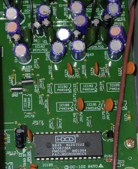

Harman Kardon HD760 with PMD100 and 4 x PCM1702 + 2 x hardware os ??? ( HC164 )

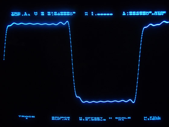

Square from CD:
Filter of this player could be a little bit steeper.
Test signal -60dB shows some hf.

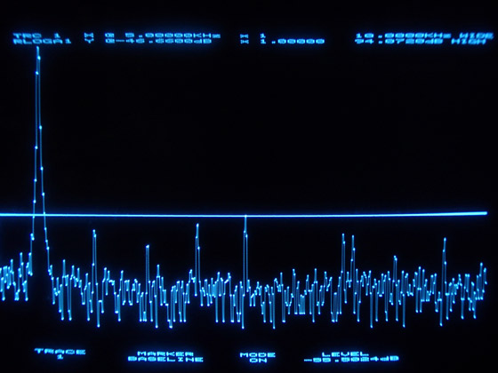

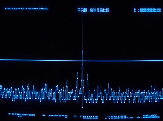

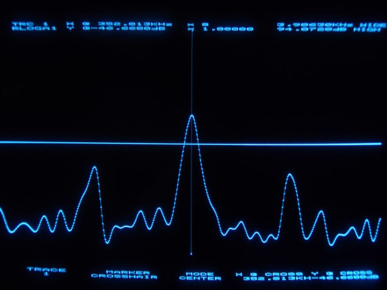

FFT 32000 points center freq. 352,8 kHz @ -46dB:
Zoom in, window 3,9kHz:
HD760 low level distortion 1 kHz -60db, worst harmonic -55dB, other channel not better.

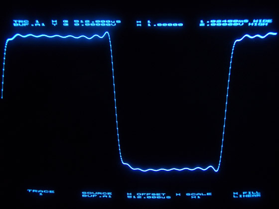

Philips CD960 , Saa7220B, square from CD:
Non os with steep lpf:
Square from CD:
Ringing
Hi Bernard, I don't want to explain this again but I do:
All those digital filters have ringing on the squarewave as your pictures amply demonstrate.
If you want no ringing go NON-OS and build a Bessel filter or a passive low-pass filter comprised of a resistor in series with the signal and a cap to ground. Of course then HF attenuation of noise is worse as a Bessel does not have a steep initial response ("soft knee") and the passive is even worse in this respect.
You cannot have your cake and eat it all in other words you cannot build a brickwall filter or any steep filter and have no ringing.😎
Bernhard said:Harman Kardon HD760 with PMD100 and 4 x PCM1702 + 2 x hardware os ??? ( HC164 )

Re: Ringing
I did not say that I want "no ringing"
All I want to show is that with os filters the ringing occurs before the transient while with an analog filter it cames after the transient and perhaps that sounds better even if the ringing is a little stronger.
Which does not mean that I would not prefer a "no ringing" bessel or transformer filter if it sounds better.
And the PMD isn't any better than a SAA or YM.

It would have been a lot easier on the discussion if you said straight away what you had to say.
Personally I don't like ringing at all. I tried third order analog Butterworth filters and Bessel filters after NON-OS DAC.
The former has ringing, the latter not. I preferred the sound of the Bessel.

hi rfbrw & pupsik46,
Use CPLD can slove some problem of dac. In my test I really suggest use two CPLD chips to running DAC in real true balance
condition. USe twoCPLD in running true balance will accurancy & less phase shift. Easy to upgrade.
thx
thomas
