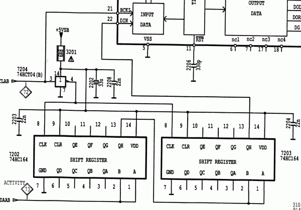

Try taking clock output from pin 3 or pin 5 of IC4 in rfbrw's schematic.

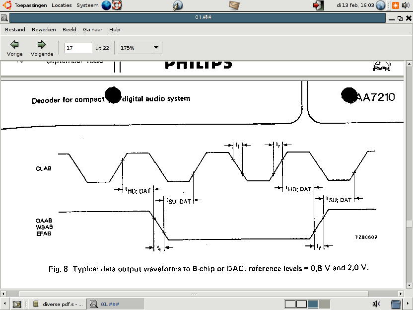

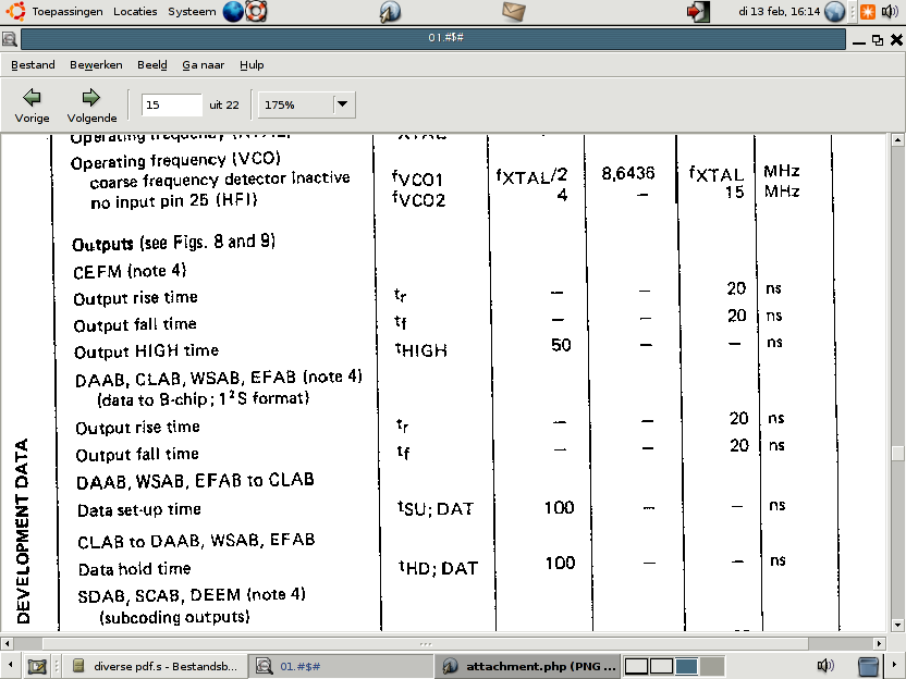

Took clock output from pin 3 and 5, even worse noise. The strange thing is after i put clock back on pin 4 the R channel also has noise. The whole has become unusuable now.
If the right channel is okay, there is nothing you can do to the
circuit as it currently stands that will fix the left channel.

The SM5840A seems to accept data in standard format and in this case I2S format coming from SAA7310 is converted. It's from a Philips CD930. The IC partially shown in the upper right corner is the SM5840A.
Datasheet for SM5840A here:
http://www.datasheetarchive.com/search.php?q=SM5840&sType=part

Yes Quirck, it problably will have to be done with that schematic, or at least something like that.
I discussed this circuit earlier, it's universal and the flipflops are only needed when a differential dac setup is used.

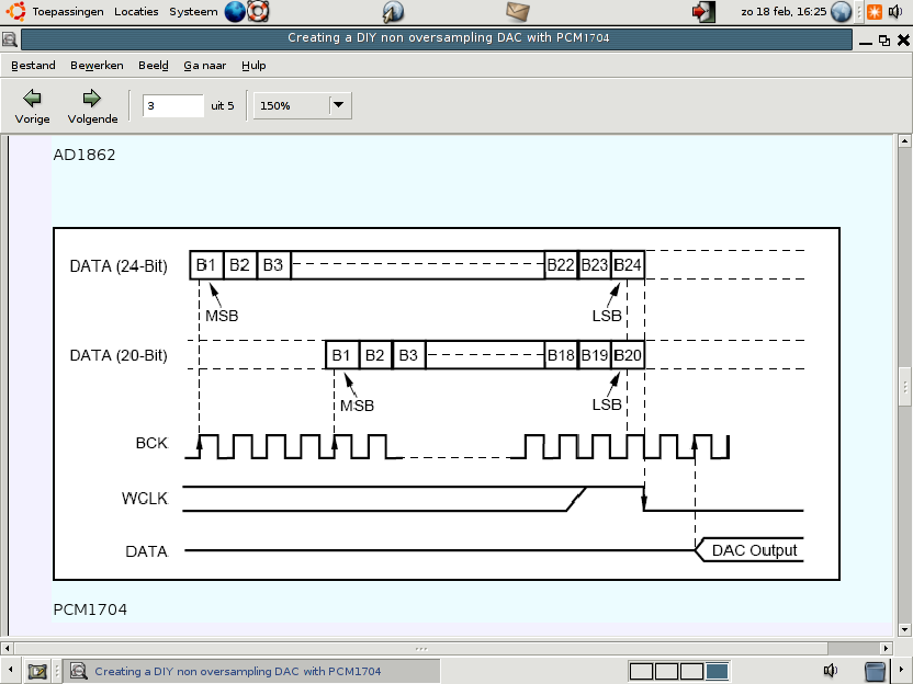

This is currently playing R channel only data. It is set for 20 bits.

Think it over, and will problably go for the universal PCM1704 schematic. and then in 16bit version. More components but that doesn't matter when it works good.
