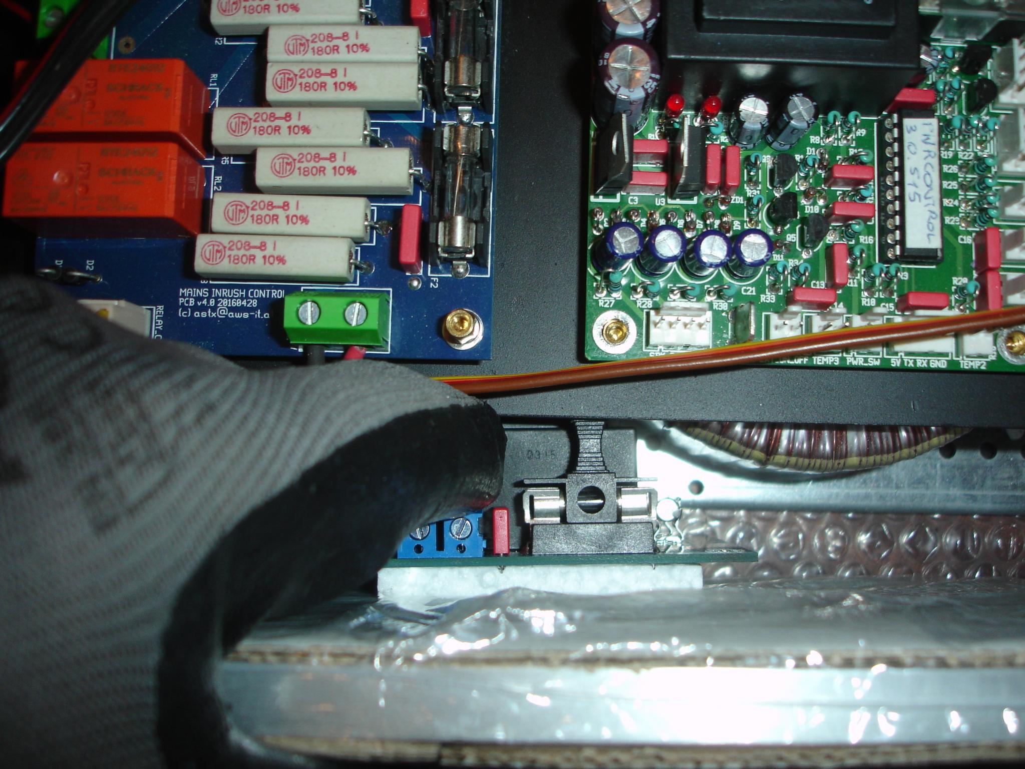

I don't think that is enough room but i will try this.You could rearrange the MCU and inrush unit to get the 6 cm in between the 2 pcb's.

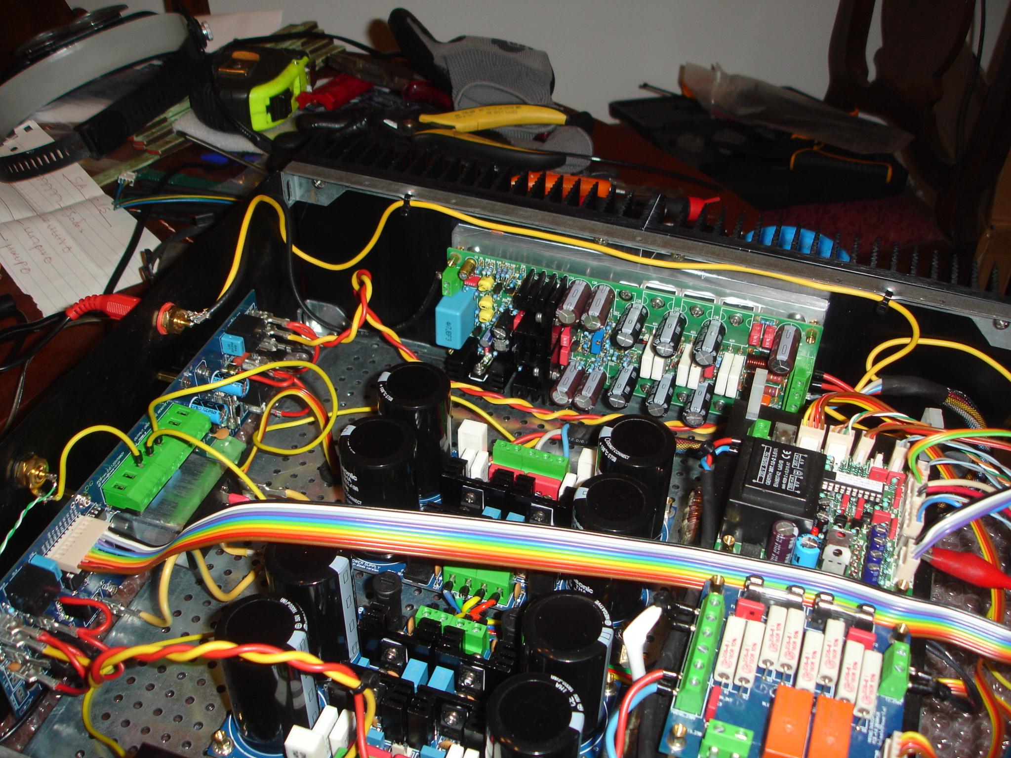

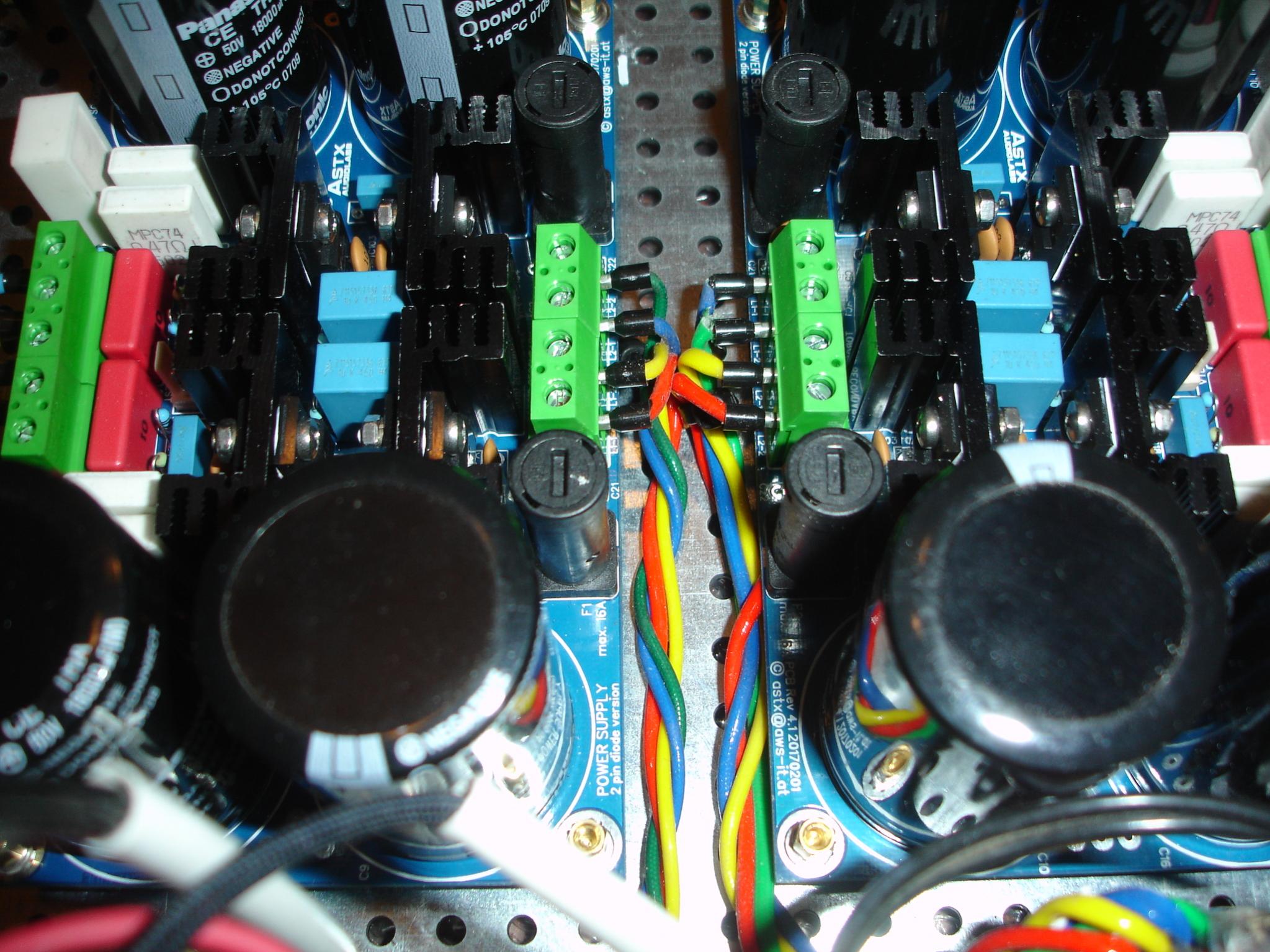

Some photos of the wiring process.

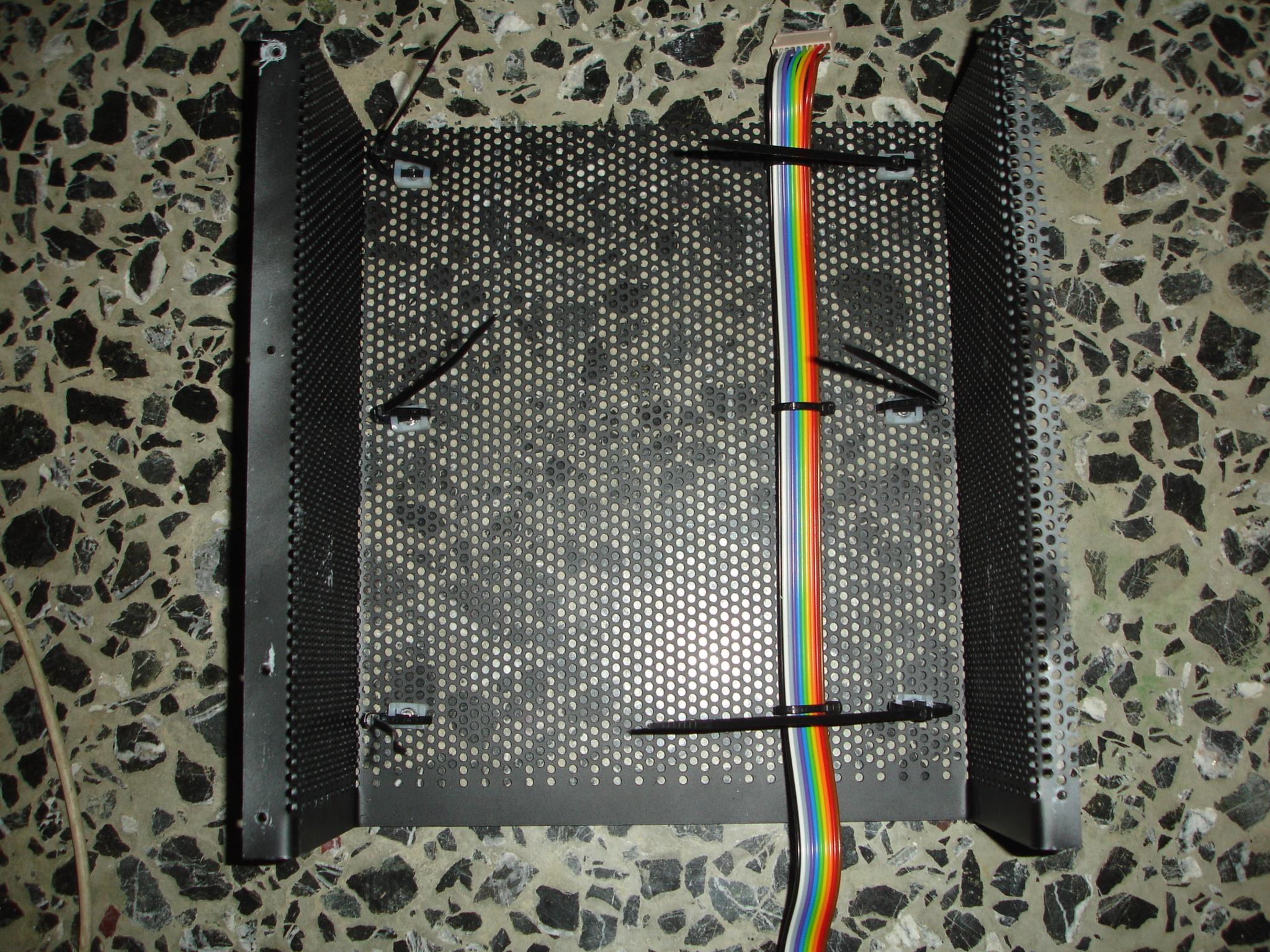

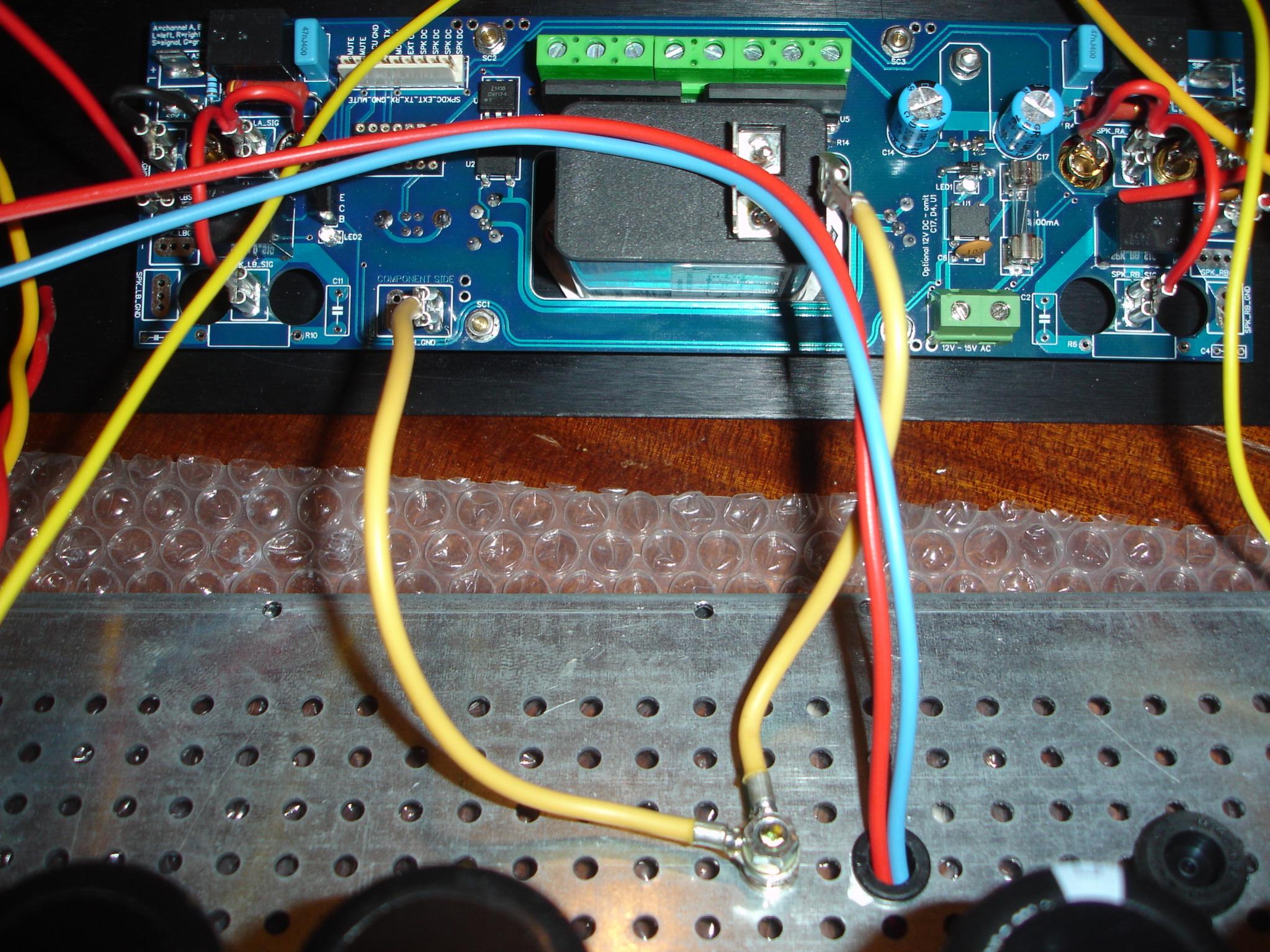

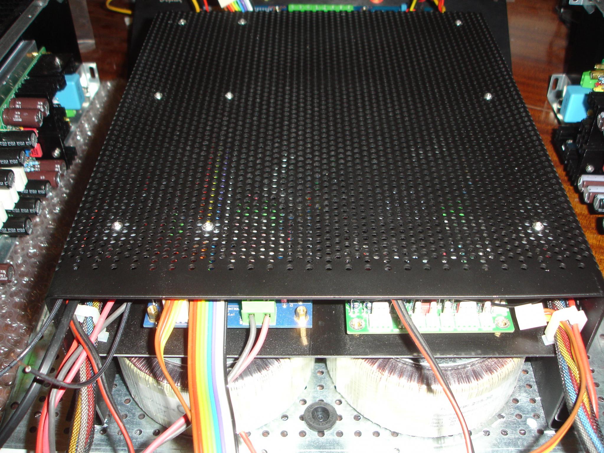

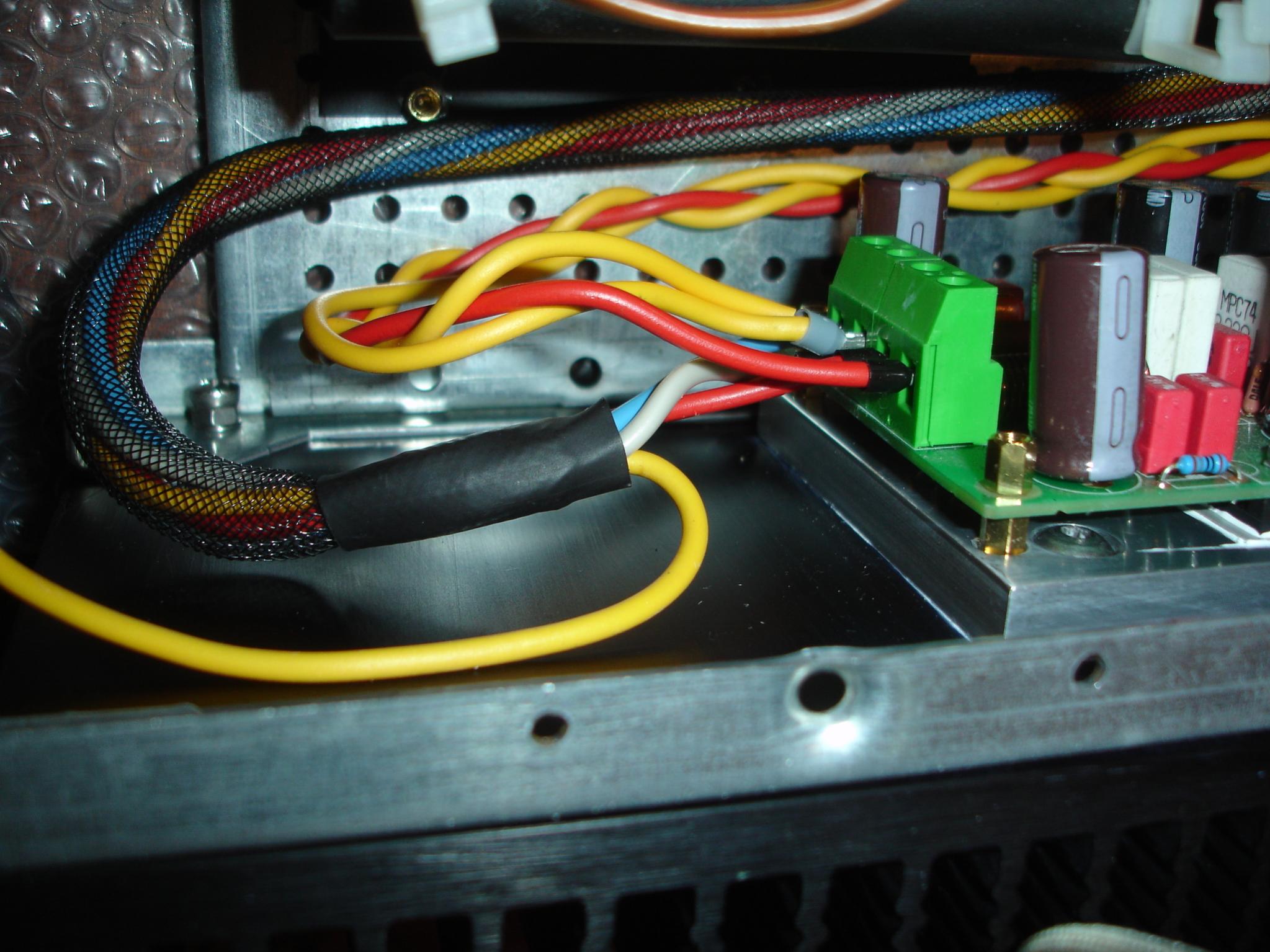

My plan is to wire the 230V A.C underside of the inner base starting as in picture 4(marine and red wire) and ending as in picture 5(marine and red wire),maybe i will add a tube for a better isolation.

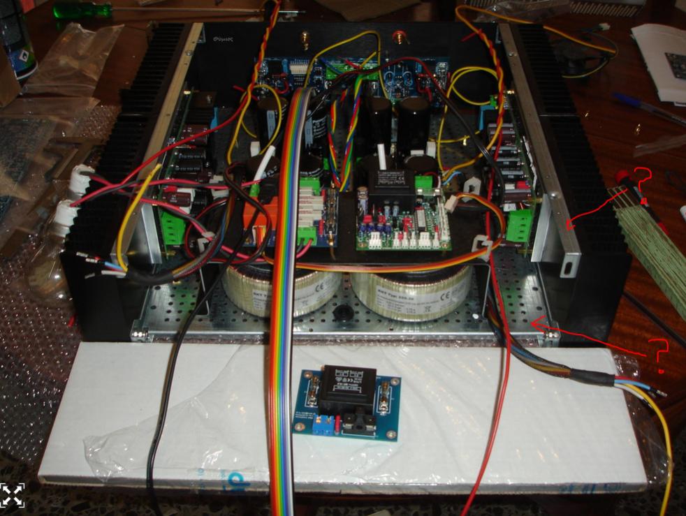

thimios:
where do you get the parts i point to in red?
and what are their part numbers and names?
mlloyd1
mlloyd1

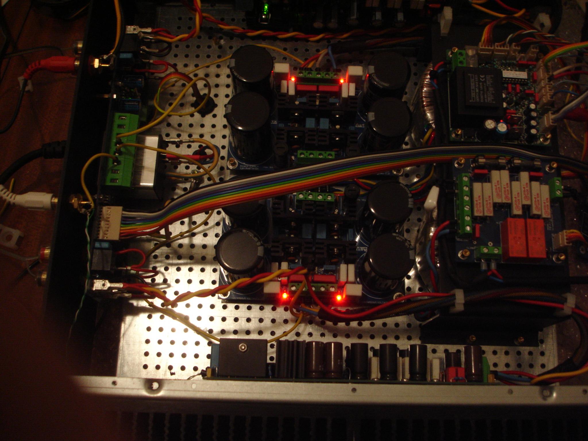

Looks like i have only one remaining position.
This behind the front panel.
... Many cables for arrangement!

My plan is to wire the 230V A.C underside of the inner base ...
Yes you should use an additional isolation level for 230VAC lines. Also keep attention on small signal wires not to be in the near of the inner 230VAC faston sockets.

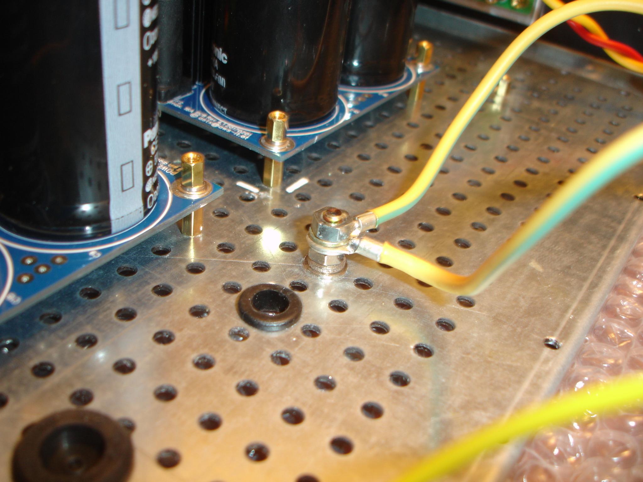

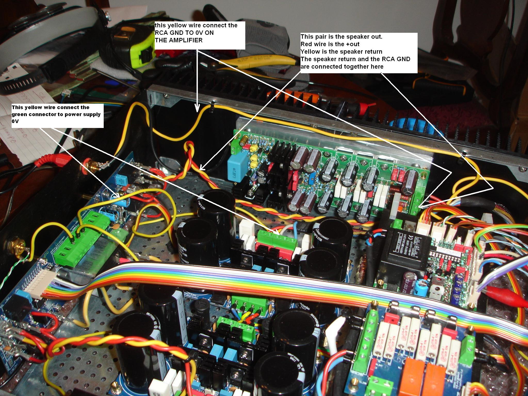

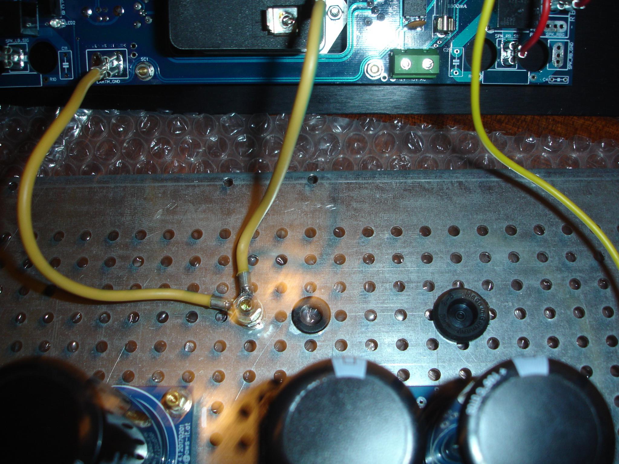

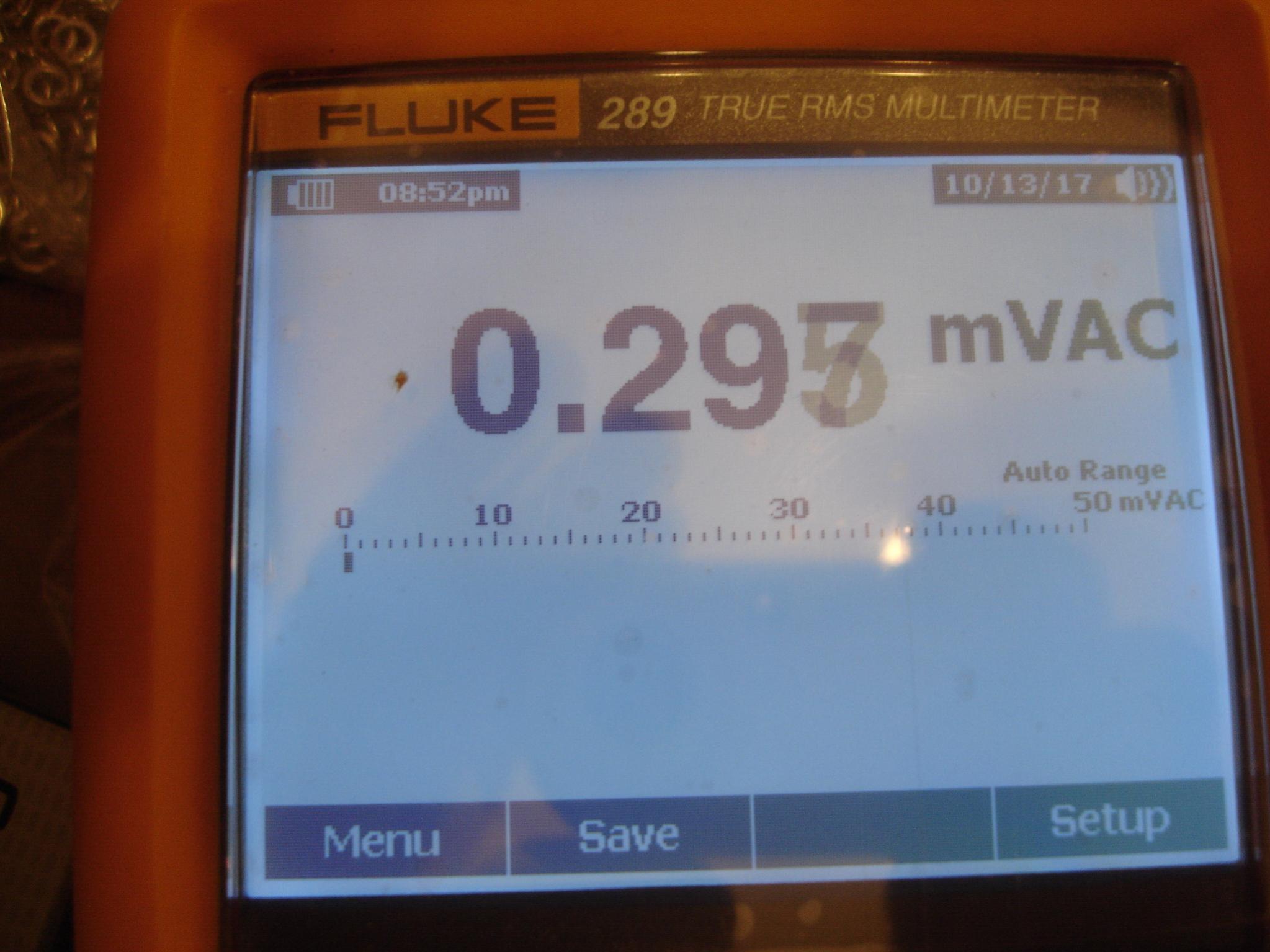

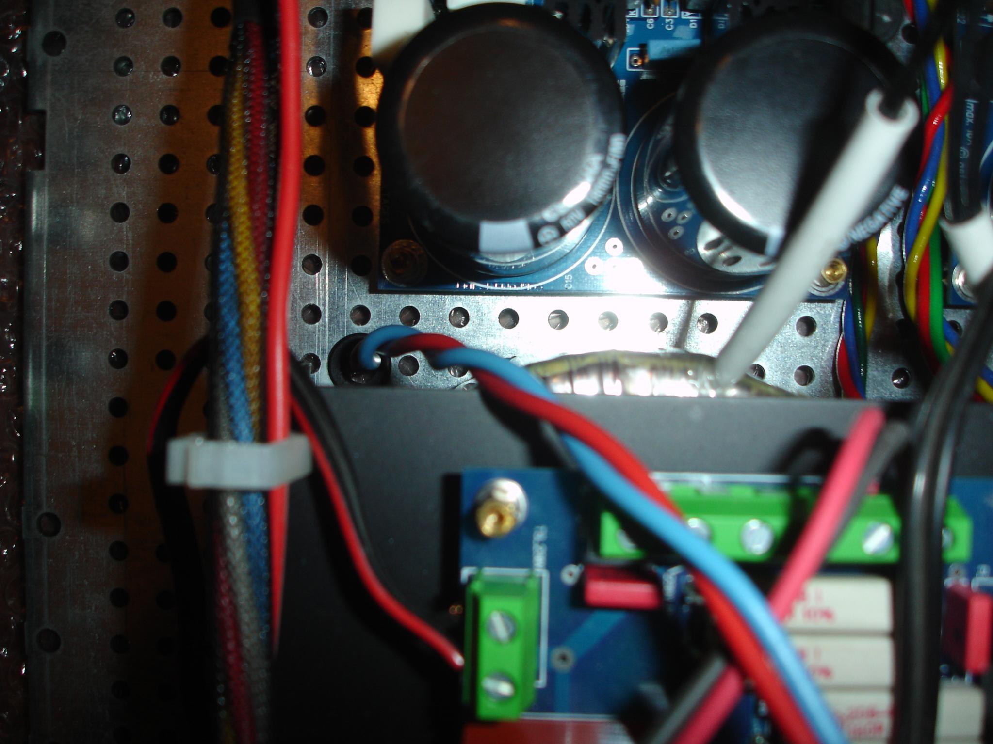

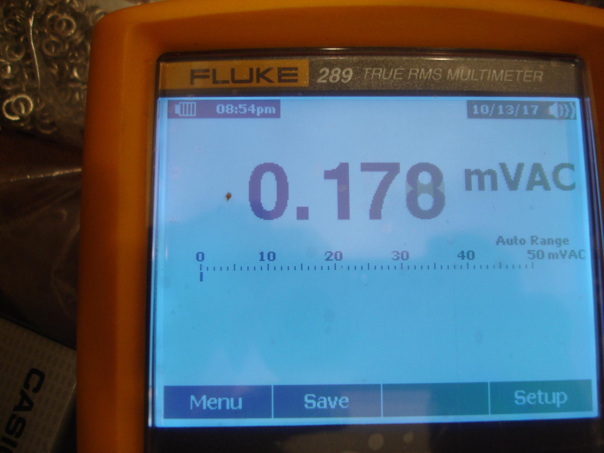

Picture 1, RCA GND on backplane signal GND,noise=297uv(picture 2).
Picture 3, RCA GND+SPEAKER RETURN to amplifier 0V connection,better but still 175uV.(PICTURE 4).

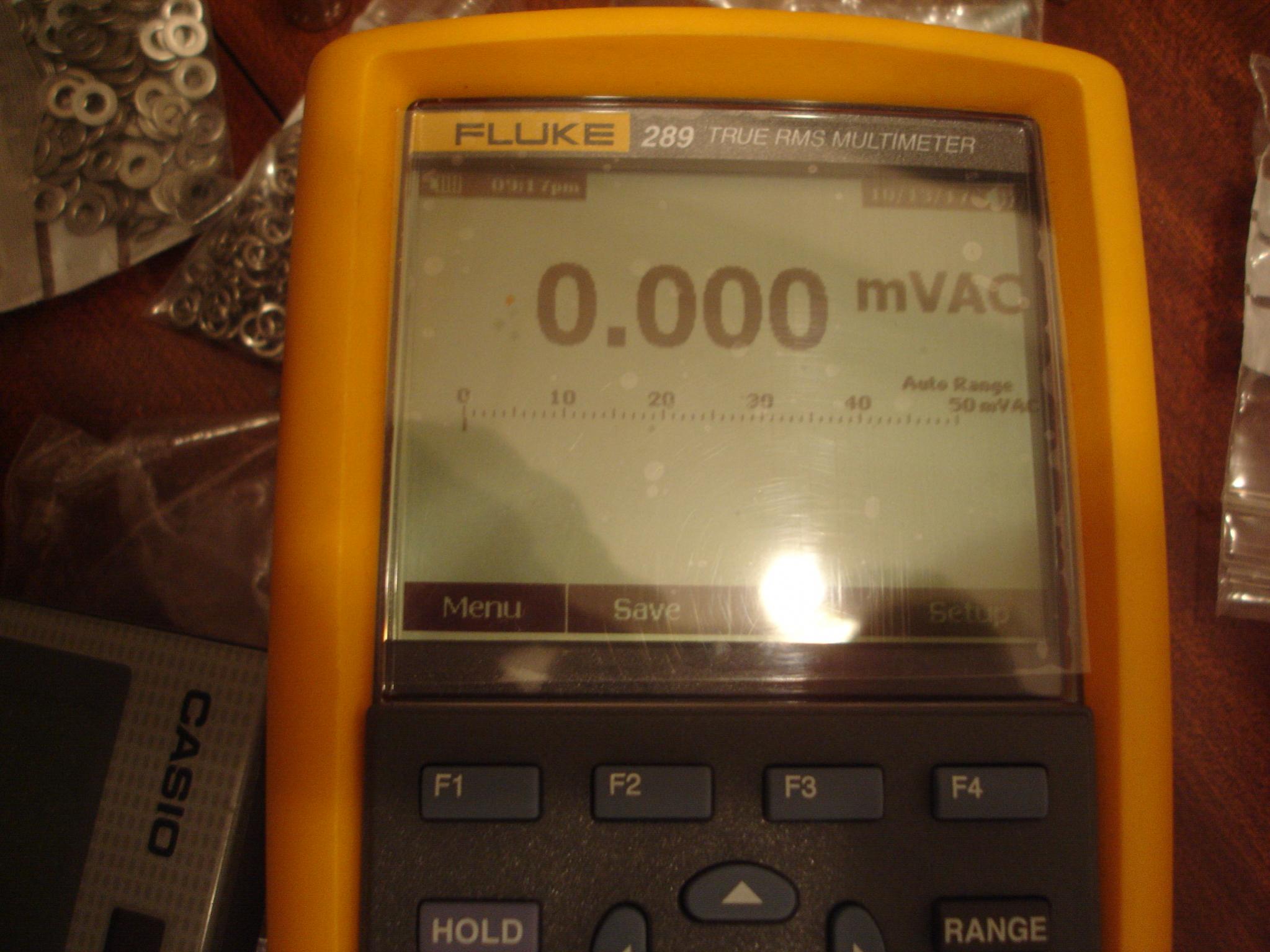

Picture 5, RCA GND+Speaker return to amplifier 0V BUT the wire for RCA GND separated,noise PRACTICALLY.. ZERO.hum FREE!😎

Yes,i hope this will help.
Zero noise looks like a measurement error. (Relay off?) Wideband noise on output with a short circuit input should always be measureable. output 8R load should be connected during measurements.
Wideband noise (0 - 500kHz) in my test setup was something like150 - 170 uV which is hardly reachable in the ready made amplifier.

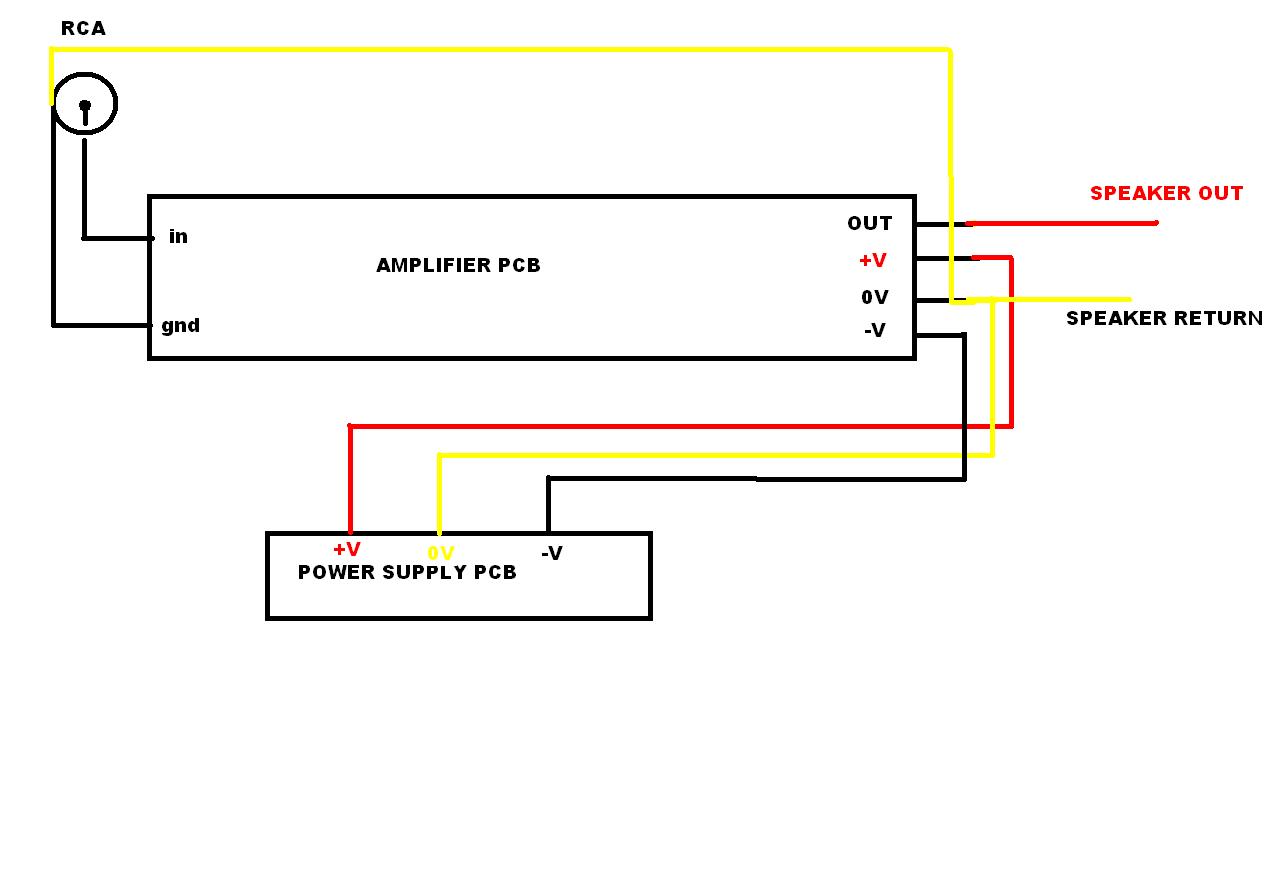

Missing the connection to backplane silent ground?Yes,i hope this will help.
Yes this silent GND (green connector)connected to power supply 0V only for safety earthing via bridge.Missing the connection to backplane silent ground?

All measurements was taken under load many-many times looking at the speaker relay led but for sure i will measure again😉Zero noise looks like a measurement error. (Relay off?) Wideband noise on output with a short circuit input should always be measureable. output 8R load should be connected during measurements.
I have used my ear in close condaction with speaker also.
This 0 mV AC ,SOMETIMES vary between 70uv and 0.

create the Main Audio Ground (MAG) right next to the amplifier where all the voltage references use the SAME voltage as a reference to set their levels.
I can't measure to the levels you are able to use, so I see 0.0mVac when I measure the output noise using that MAG location. A DMM that reads 0.0mVac is telling us that the signal is <50uVac.
I have been recommending this for years.
Although TomChr uses a different description, I think his recent experiments and amplifier developments have arrived at the same arrangement.

Perfect! Looks like you have found the optimum for your amplifier.

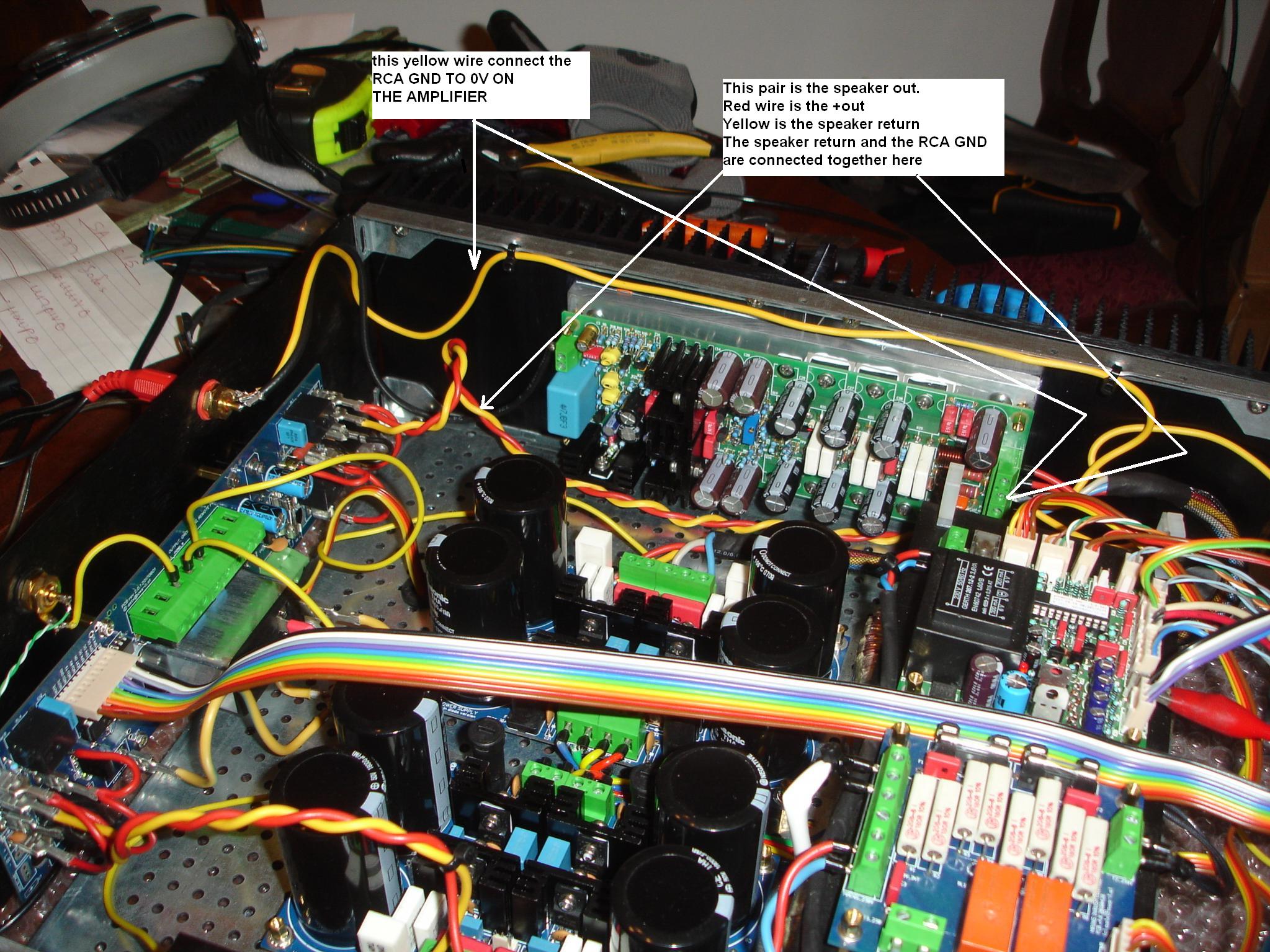

Because the pcb connector can't handle 3 thick wires finaly i have used a piese of pcb.
3 wires(speaker return,RCA GND,0V P.S) solderd on the mini pcb,then one wire connected to 0V amplifier's connector.This placed very closely to amplifier board in a shrink tube.

Noise ,zzzz. and sometimes like a non tuned radio.Gnd loops!
Tried with an earthed (laptop)power supply.
Noise stop(lower) only when backplane EARTH was pulled.
Then tried a non earthed power supply, better but still noisy.
As a next step was the amplifier was transferred to my house hoping for a more clear not noisy area.
With a non earthed power supply for the laptop, 120mV AC was measured on amplifier output when input was connected to the laptop.It is neccesary to put your ear on the tweeter to be able to hear the noise.
