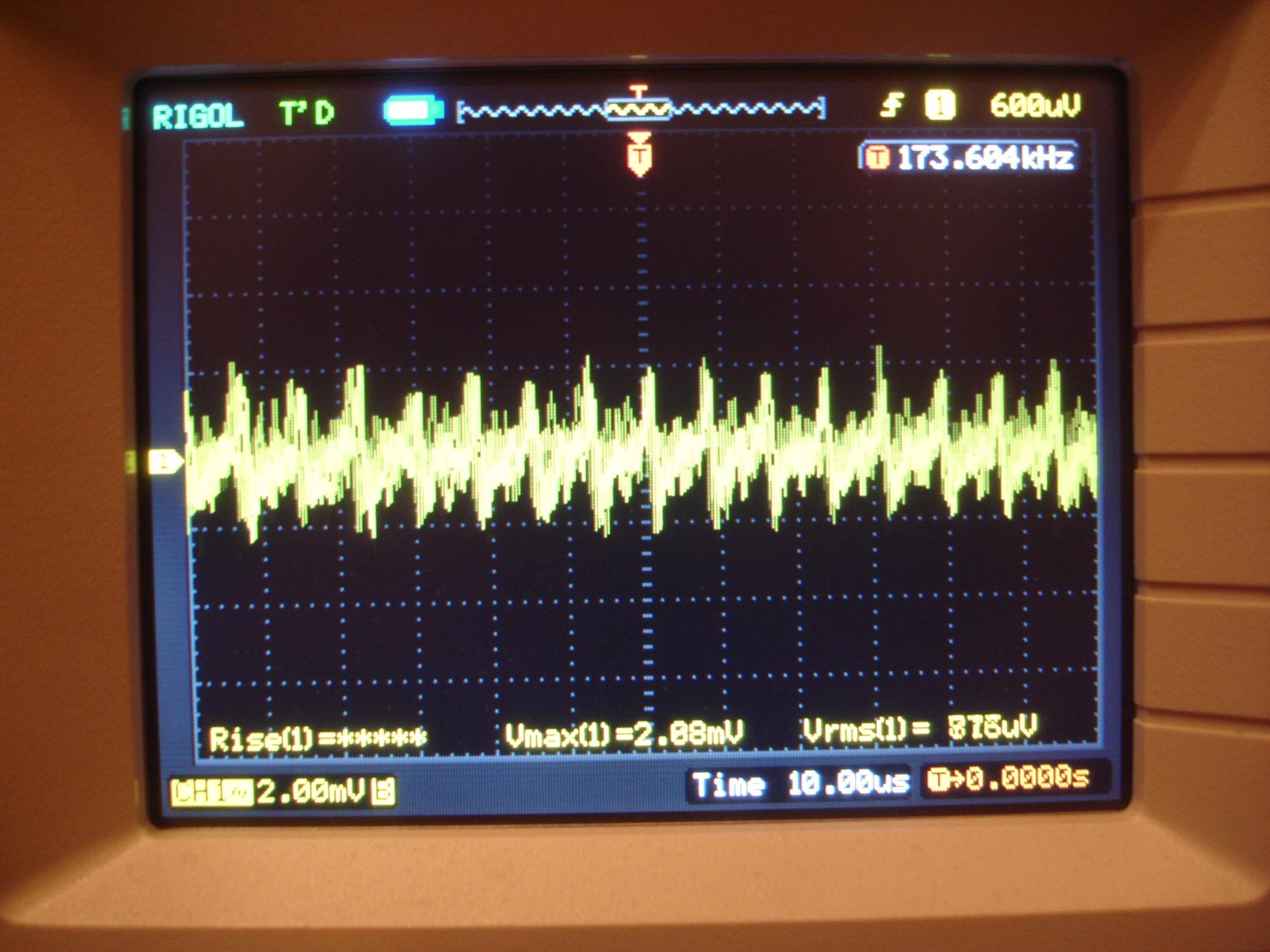

115mV for the CONNECTED channel ,7mV when laptop mute.
70uv for the DISCONNECTED channel.

I tried to pull the jack and short this using an aluminium paper, the measurement is 0 mV.

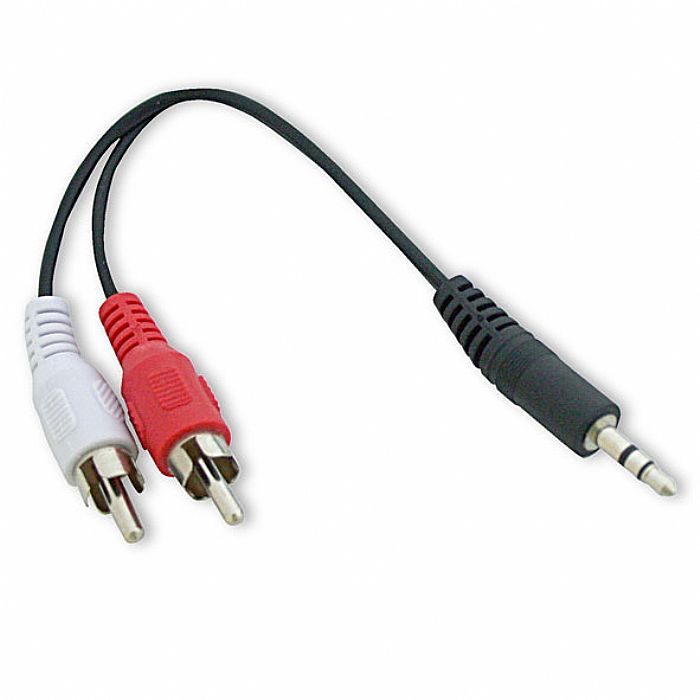

The cable is like this but 1.5m
Which way?A scope will bring light into darkness... 😉
Do you mean a new test using a generator and a scope seeing square waves?
I'm afraid that i can't understand what is this signal.😕No - just looking what kind of signal generates such noise or offset...

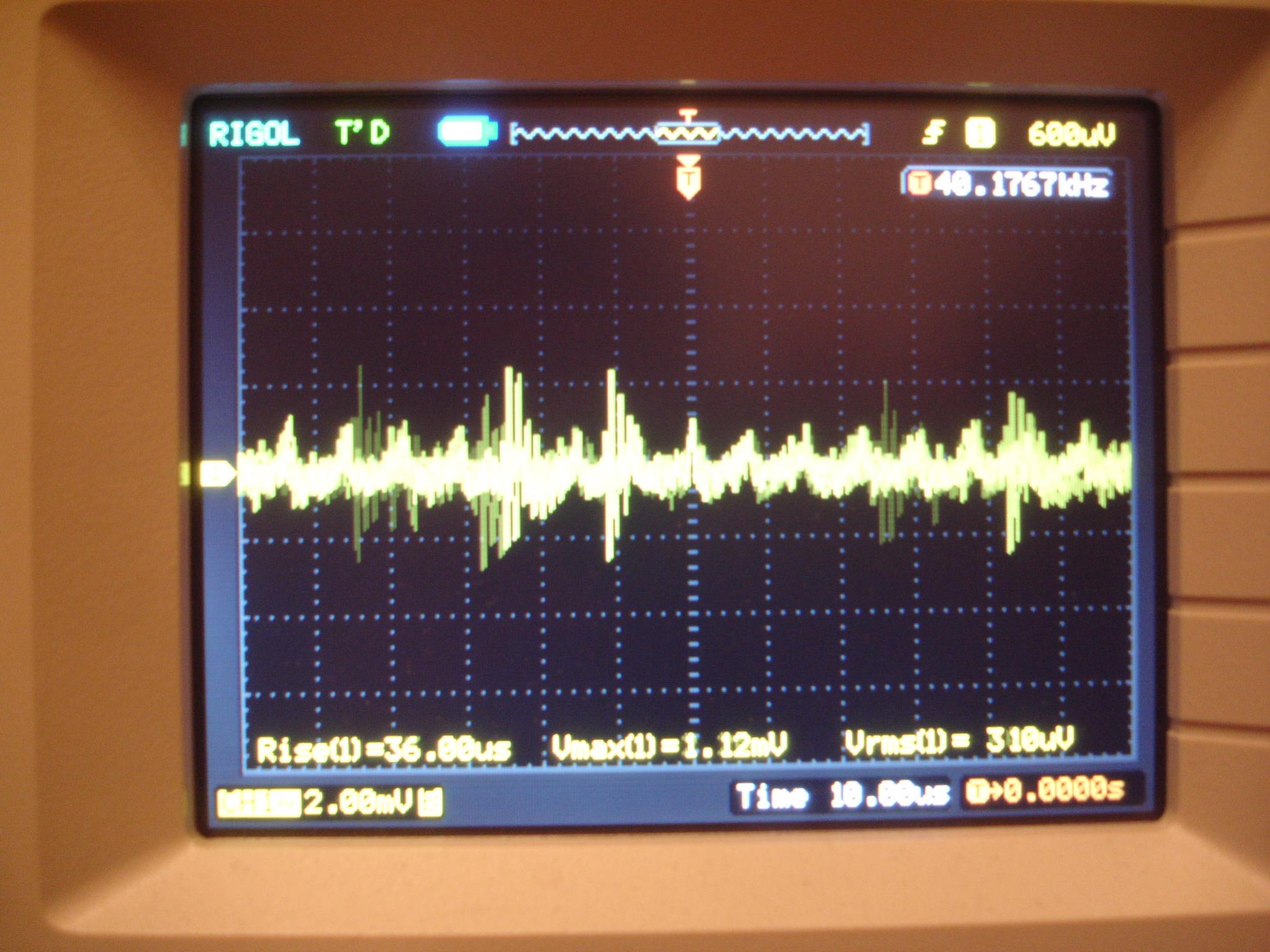

This was measured at the output of the amplifier.
looks like computer noise. a spectrum analyzer could help identify if a cheap switching power supply adds the high frequency noise. build a simple input filter with a -3 db @ 22 khz to verify this.
Aha now i know where is the problem.
GND loops with the earthed probe!
When i connect the scope with safe earth disconnected i measure those. R , L channels.
DAC artefacts maybe mixed with switching power supply artefacts.
gracefully to be ignored.

I can't see problem except when an earthed switch mode power supply used for the laptop.DAC artefacts maybe mixed with switching power supply artefacts.

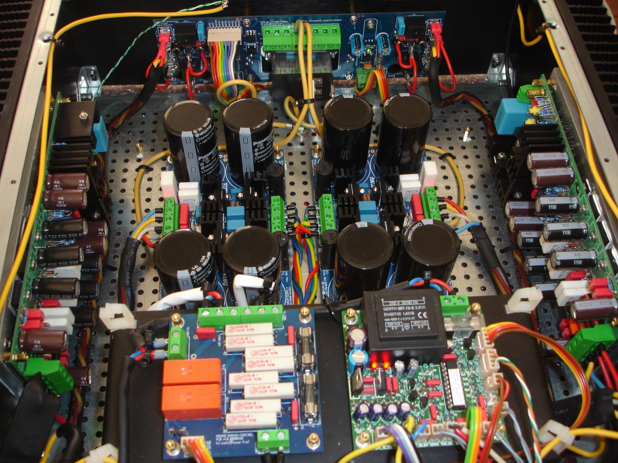

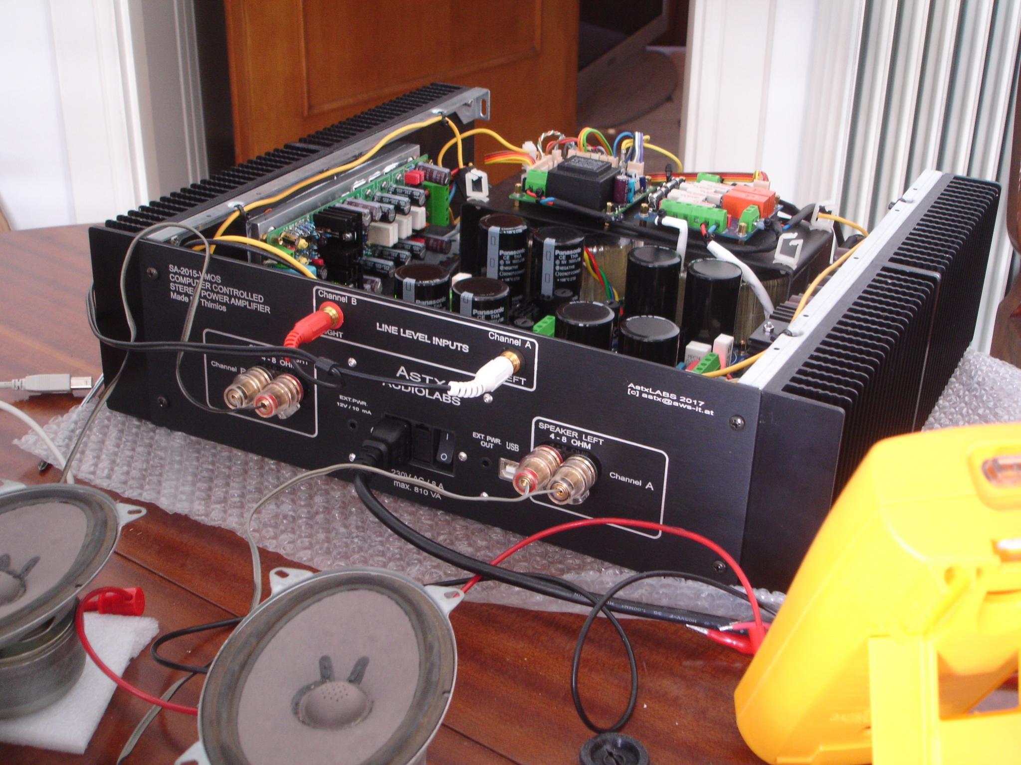

Just before the final step.

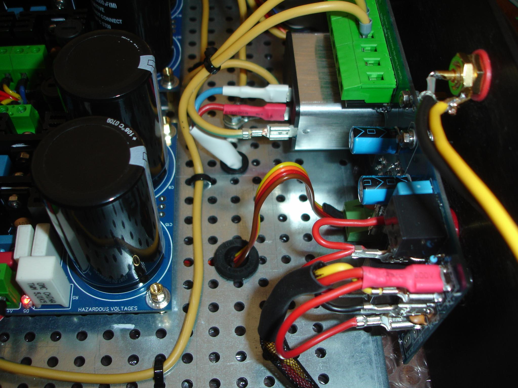

Dear Thimios,
looks pretty good! 🙂
I would do one change: the small signal lines (ribbon cables) route above in the middle of the amplifier. The sharp edges from the steel bottom may destroy the cables.
The signal cables carry only constant DC and speaker output signals decoupled by 4.7k (for DC detection).
BR, Toni
BR, Toni
Dear Toni,don't worry!🙂Dear Thimios,
BR, Toni
I will take care in the finally assembled amplifier.
I will enclose this ribbon cable (at these <<dangerous>> points) in a thermal shrinking tube.😉
Thanks a million!
Thimios

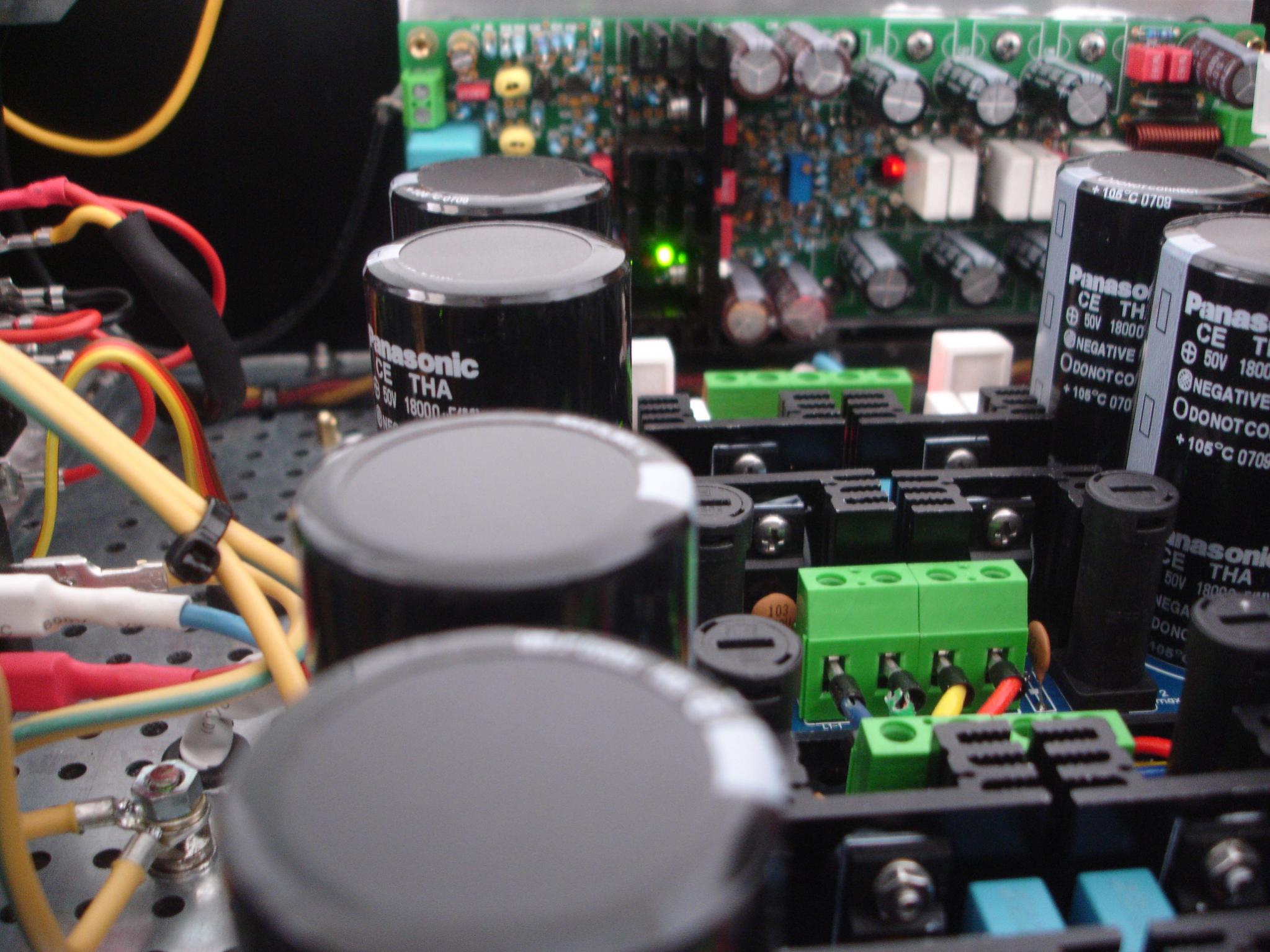

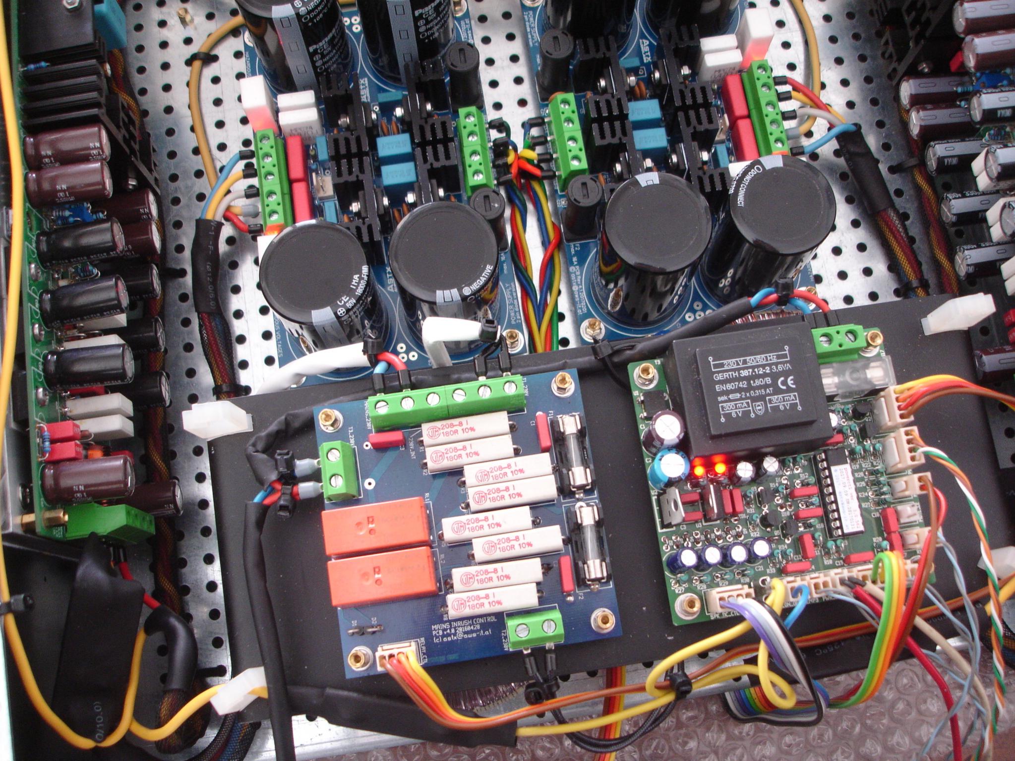

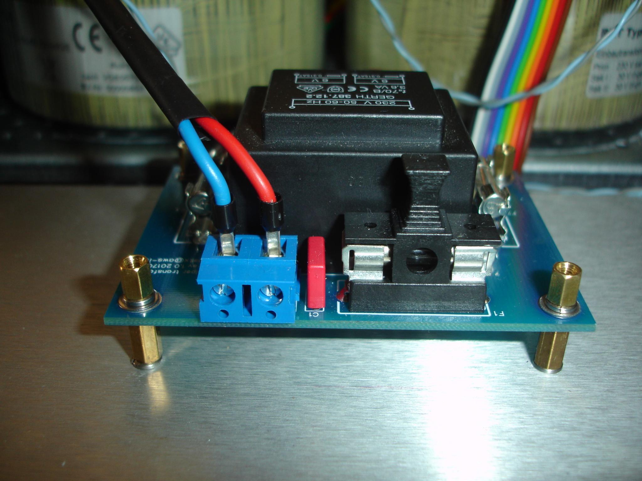

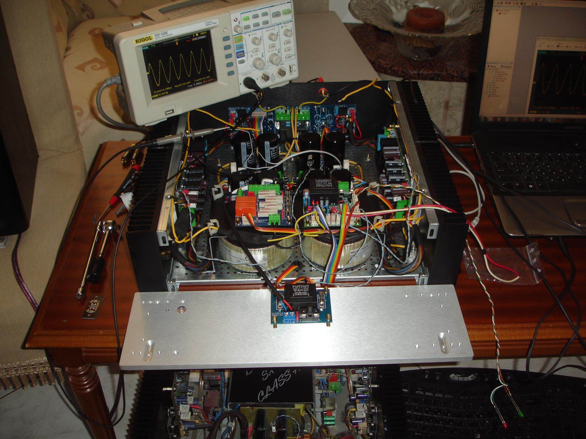

Finally the auxiliary power supply found that position.

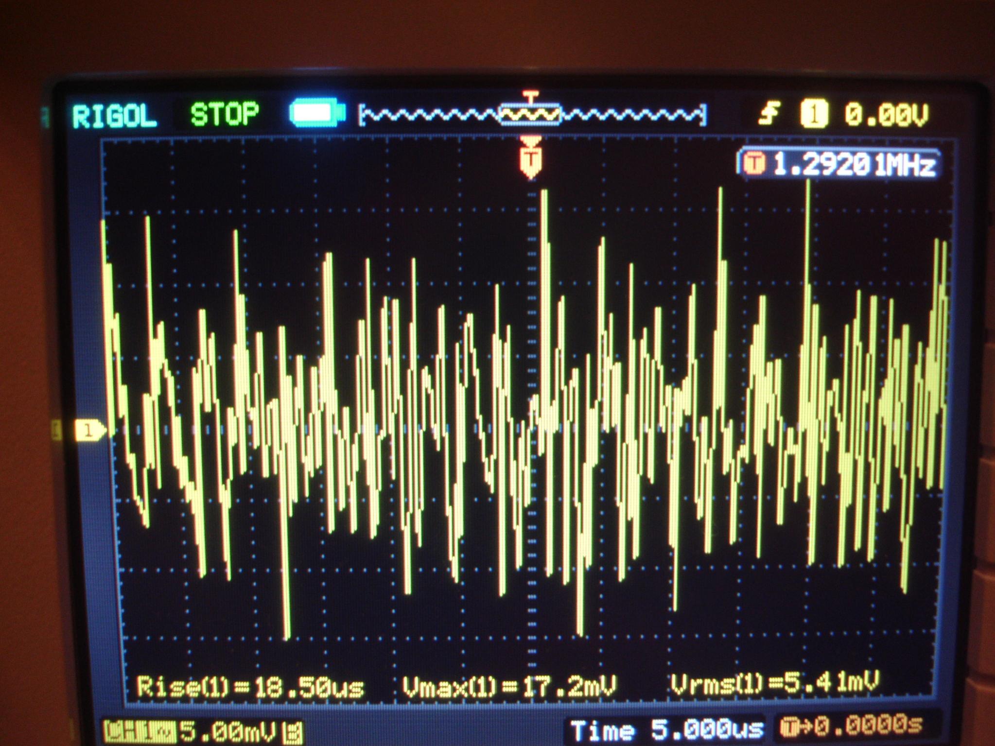

Picture 2:Testing Power supply Ripple current.
The puzzle is close to the finalizing!
🙂 ... indeed very close to project end!
I see you have done some machining for the big power button and standby led too!
