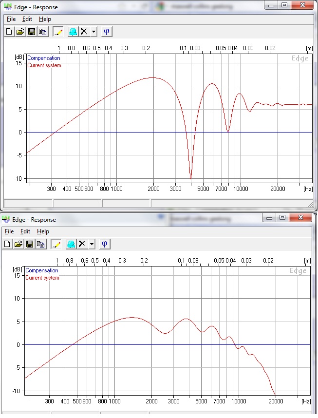

The plots show what appears to be some form of resonant behaviour around 1700 hz, 6000Hz, and 15,000hz?
From BASTA a quick check of a circular baffle with a 25mm source shows diffraction contributions in this range. On axis and 45 degrees off axis plot below. Has the waveguide edge been rounded?
Every waveguide has a frequency where it starts to "guide" the wave. Above that frequency the outer rim of the waveguide becomes meaningless - it is no longer "seen" by the wave. EDGE simulations obviously are no longer applicable in that case.
Forget about EDGE at 45°. It does not work there any more.

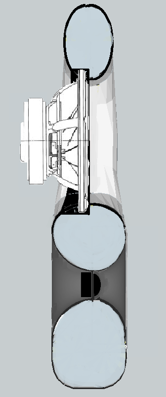

For next step of getting the WG to line up with the mid driver I ended up with a section like in this pic.
The mid baffle has a cross section of an ellipse which twists as it goes around the driver, creating a moebius shape and filling the gap to the tweeter, and paying some homeage to the goal of a non constant dipole D. In this version I settled for driver spacing of 180mm.
The tweeter is to be similar though is a work in progress and I have made about 50 drawings trying to get it to look right, still not there hence why it is all still on paper. Prompted by this discussion I will see how it looks with the WG made oval in front view to close the intra driver distance.
I would have preferred the two drivers to be physically equal distant to the listening position rather than rely on a tweeter delay in the crossover, I was concerned that a signal delay to the tweeter might fix the front waves sum, though double the error at the rear? I might just tilt the whole panel, with all that that carries to the polar pattern.

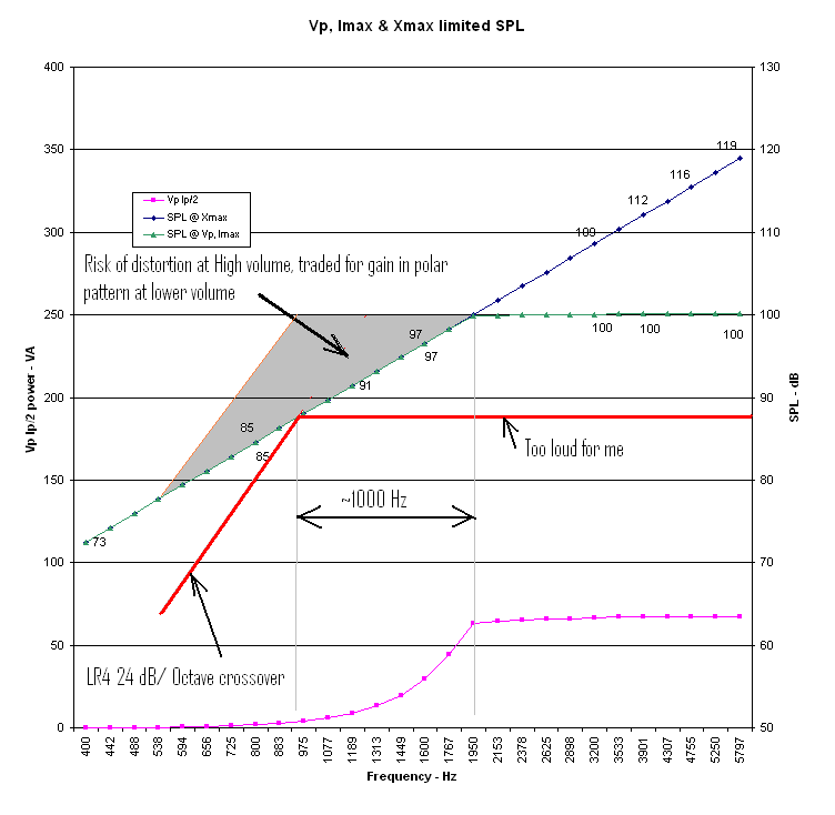

A point on crossover frequency selection and polar pattern trades
Getting the 'right' crossover frequency caused me some angst and led to using the WG300 so it might be worth passing on. Personal opinions on targets of volume Vs roughness will vary widely so this approach may not appeal to all.
The X max sets a distortion limit that can be found subjectively. I haven't tried this yet but it might also be possible to map the roughness more accurately objectively using the SRA (see SRA 2.0 © 2008 - Spectral and Roughness Analysis of Sound Signals ).
There is also a limit to when it is just too loud and I want to turn it down, which for me in a small room this seems to be quite a low volume.
By mapping the distortion 'edge' and volume limit a trade can be made between sound quality at low volume ( polar response ) and sound quality at high volume ( X Max limited distortion).
This can guide to a crossover point hundreds of Hz lower than picking the knee point from a line on the suppliers graphs and lead to a substantial change in the target for inter driver distance for interference.
For me the WG was all about getting the amplification to maximise the driver efficiency and minimise the extent of this X Max distortion trade, hence a WG at both front and rear.
