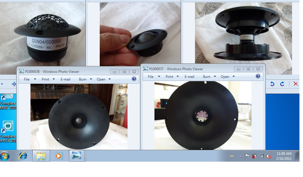

Pics for Gainphile. A dipole dome tweeter. Remove front screen and rear chamber from scan speak D2904 600000. Light trim of a monacor waveguide then fit to the front, and a second waveguide has glove fit at the rear straight out of the box. Front looks normal, rear shows the core structure of the magnet support with its rear vents which in this case provide the rear radiation. Better measurements systems and ears than mine might find the issues but it works for me. Russell.

Second attempt at Pics for gainphile, finger trouble missed the pics.

That is a very interesting approach. What are the WGs and how big are they? It would be interesting if they can hold directivity down to 1.5khz... That would be "solution to a problem" indeed
Edit: .. found it, Monacor waveguide!

The purchased waveguide is 168mm. The outer edges of the guide are 89mm apart, and the gap is (was) filled to smooth the edge and increase the diameter hence cut off frequency. The purchased waveguide was close enough to my analytic prototype derived target: a 240mm OD toroid with 120mm diameter cross section, and oblate speroid transition to the dome. The doe is at the front, and the acoustic cavity at the rear appears trivial - ref below.
I used paper mache to form the torroid for the proto tests, as it has worked (for me) the next step is making the toroid for the tweeter and the mid in a more visually appealing structure. The mid also has a torroid like form, rather than a circular cross section it has an 90 x 54mm elipse, and the ellipse rotates so that it forms a moebius, for aesthetics. I am making it by using thin plywood sections set on a central frame then fill with foam, shaped and covered; like a model airplace wing mated with a surfboard.
The measurements I have are here amongst hundreds of spreadsheets of single points data. Making one plot that would make sense to another person is not on my list of pleasurable activities so I will decline the offer of producing a report. My data analysis discounted higher volumes (I only have a small apartment and rather than an SL like 90 dB I settled for 87) and my hearing is second rate above 13KHz. Others might find something where I wouldnt have looked.

Just trying to understand the photo of the 2904 in the waveguide, specifically what "might" be the back photo with what looks like the motor structure with a series of holes around the edge.
Is this the motor?
How much output can one expect from those tiny holes compared to the front dome?
