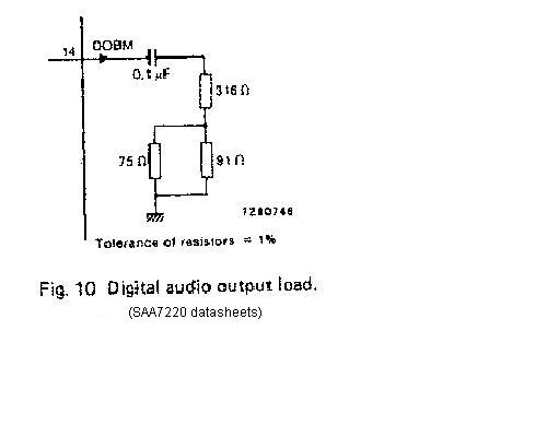

They also assume a 0ohm output impedance from the flipflops. And the Q´ is used to get a balanced signal.

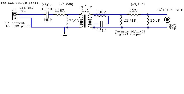

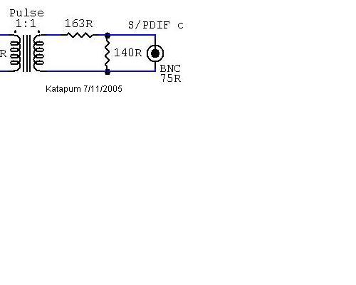

4R7+25R // 4R7 will not give you 75R
326R+25R // 95R3 would give you 75R and roughly the same attenuation as the original circuit.
163R+25R // 125R will still give you around 75R but only about half the attenuation of the first circuit.
Then after the transformer you attenuate with say a H-pad.

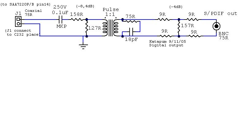

H-pad looks like an "H". You have an "L- pad".
H-pad, or pi-pad would be best.
BUT.............
I would not run the trafo directly from the chip. Insert some R to limit current. And a C to keep DC form the trafo (very important!)
So....you have to add the 25R or so with the series R before you can design the H-pad.
If you go pi-pad, you can either put the shunt leg at the secondary, or at the output side. You have lots of options. A lot will depend on what nice resistor values work out. Yes, it is not as easy as it seems. We could be at this for a while, but you should learn a lot.
Maybe hifi wants to design the pad(s). He seems capable.

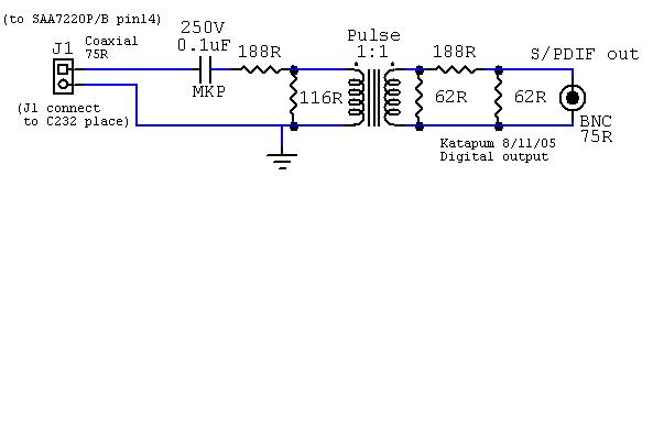

Hi Katapum,
although I haven't calculated the output impedance your 75ohms attenuator is faulty, as the output impedance is always less than 62 ohms.

bocka said:Hi Katapum,
Not bad.............
You may want to try a different version. It does not have to be 75 ohms on either side of the transformer.
You could make it...........say...........100 (just for conversation sake) on either side. The zobel would have to be for 100 ohms. The pad would then have to look like 100 ohms back to the chip, and 75 ohms out to the line.
Making the Z on the drive side makes a nicer looking trace on the TDR. (Don't ask me to explain, just trust me for now.) Also allows you to make the pad a higher value. Which is a good thing.

Should be......but I did not check all the impedances.
Try rotating the pi-filter 90 degrees clockwise.............!
Jocko
