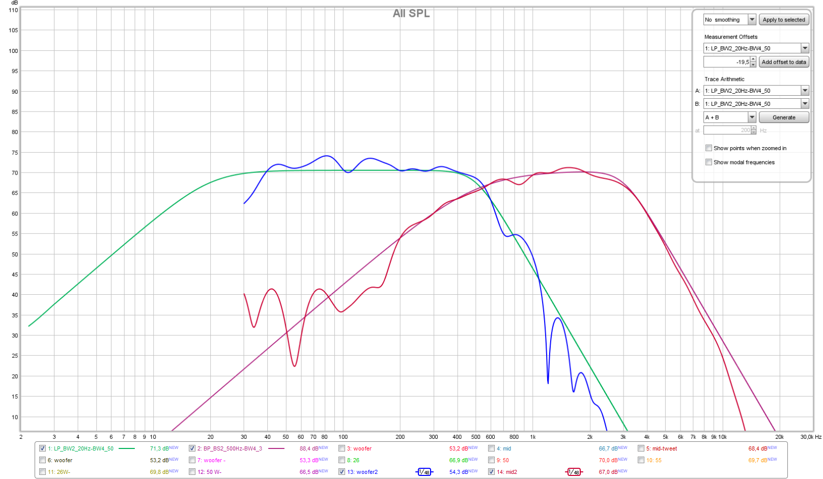

Previous graphs were with 15sample window, going down to 4 doesn't seem to change much:
Measurement setup:
Target curves
26S delay
50S delay woofer positive
50S delay woofer negative
Seems a bit weird since the mid-tweet integration went very well and measurements look very very similar to predicted simulation

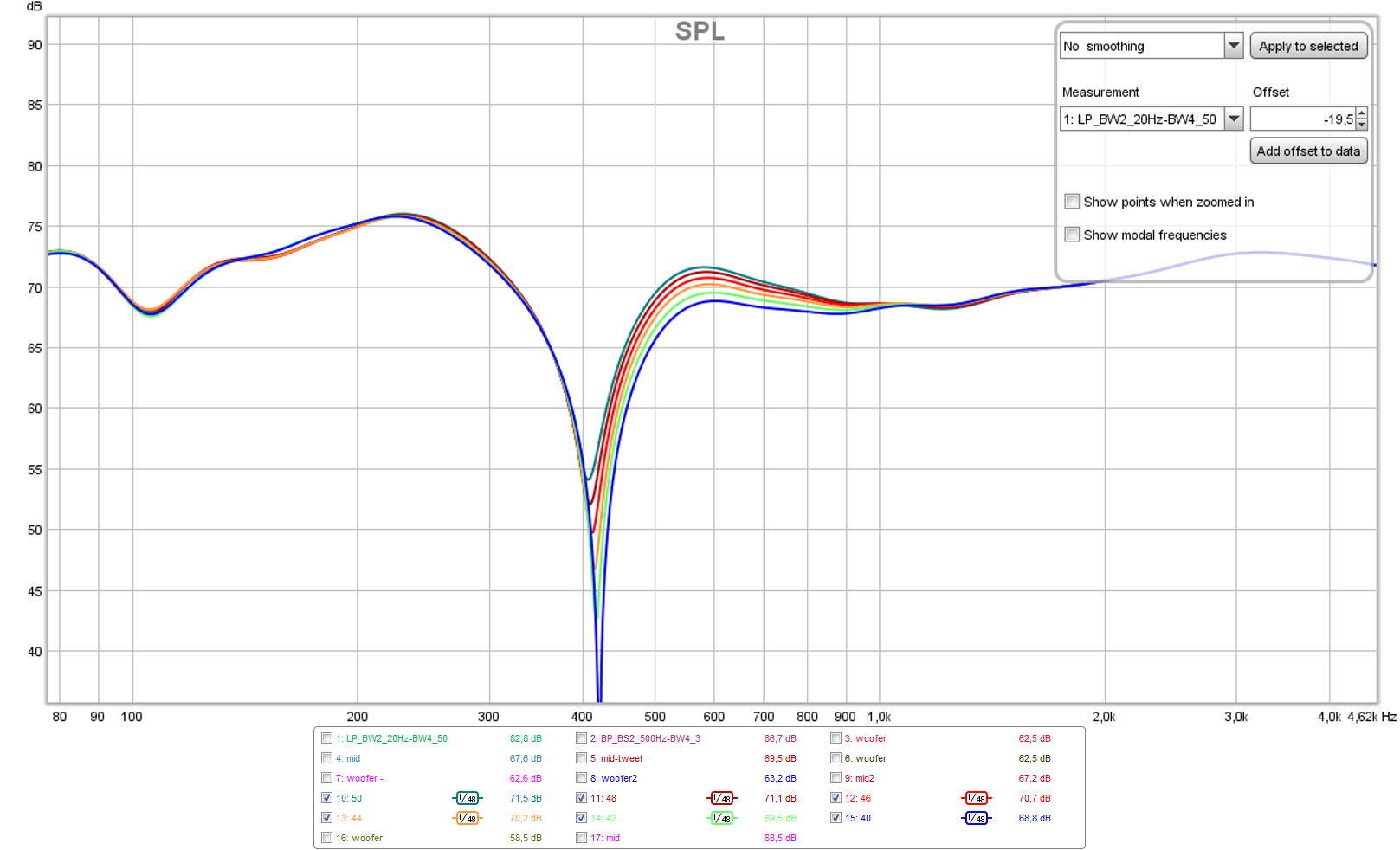

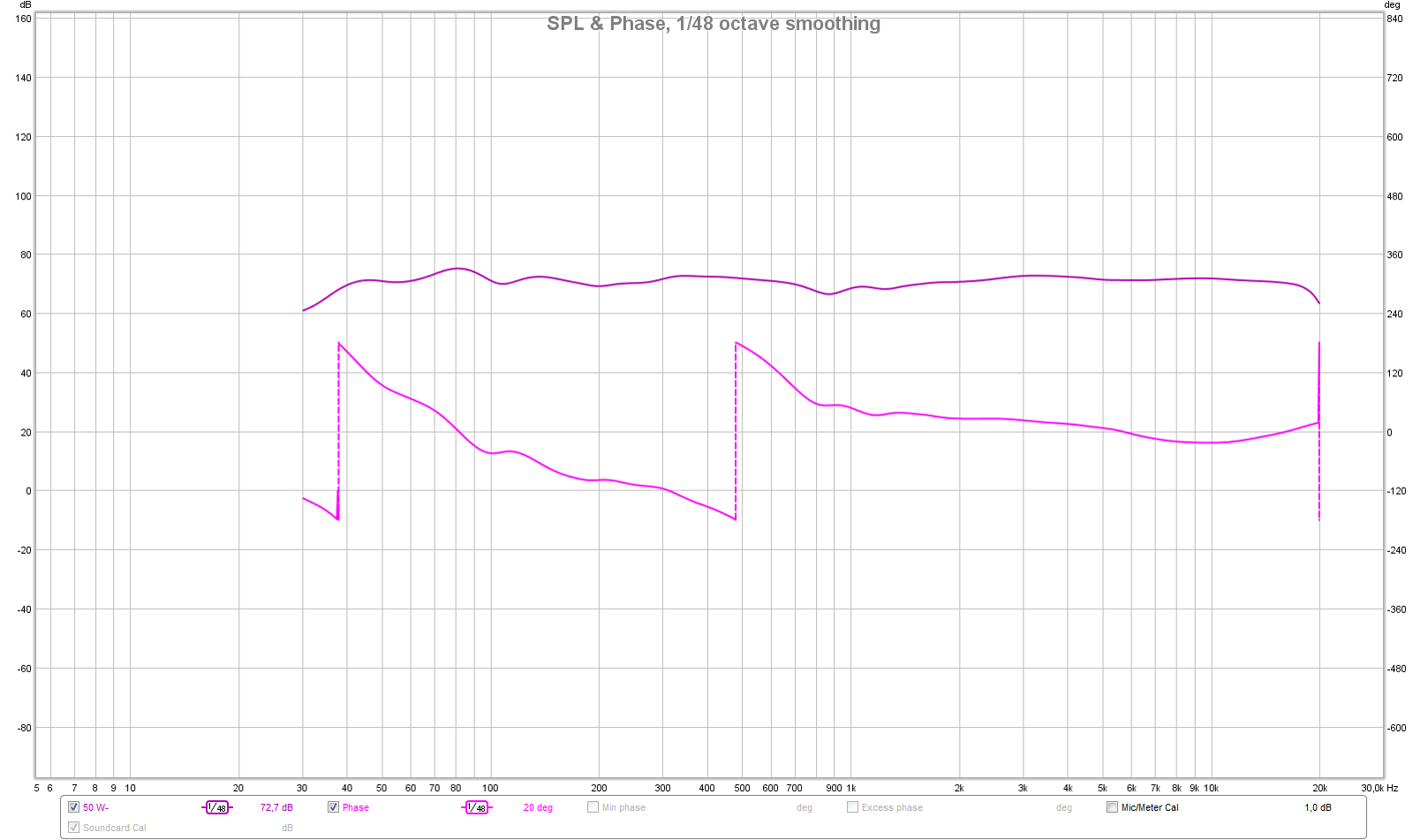

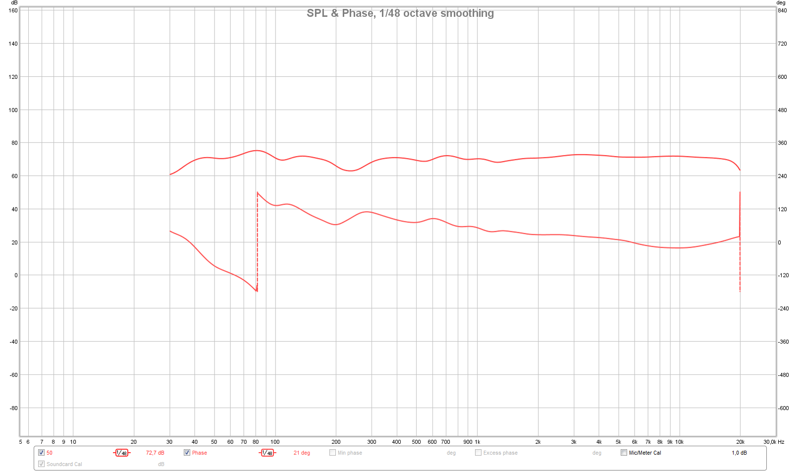

I like the red one, 50S delay. For this to work all drivers should have positive connection.
Phase seems to be quite flat over a large area. How does that one sound?
Do you use auto EQ in REW? or massage it into shape by hand. The better you hit the target at 4 cycles, the better the combined STEP should measure. Can you show the (combined) STEP from that 50S version?

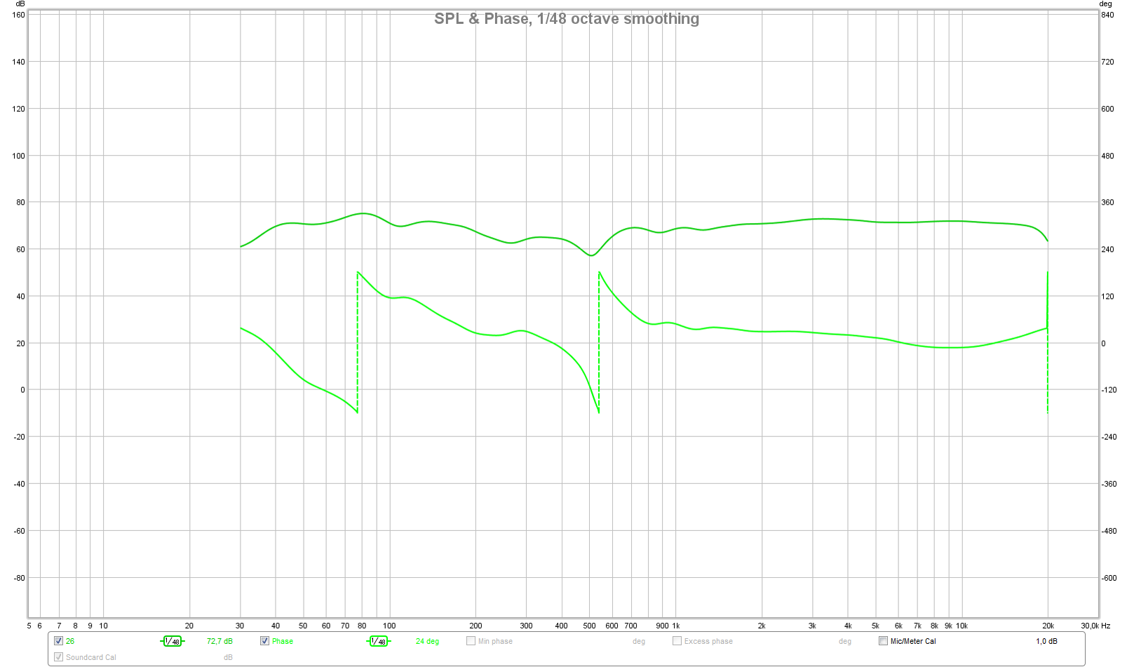

It actually looks pretty good to me, don't fear the dotted line at 80 Hz, it's not a phase wrap, phase just moved past 180 degree and the plot continues at the bottom.

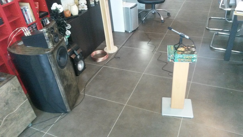

One other suggestion is to move mic closer so that it is less than distance that would allow a floor bounce to happen before your window. I use 0.5m for setting the delays and find that translates well when I listen farther away where reflections do happen.

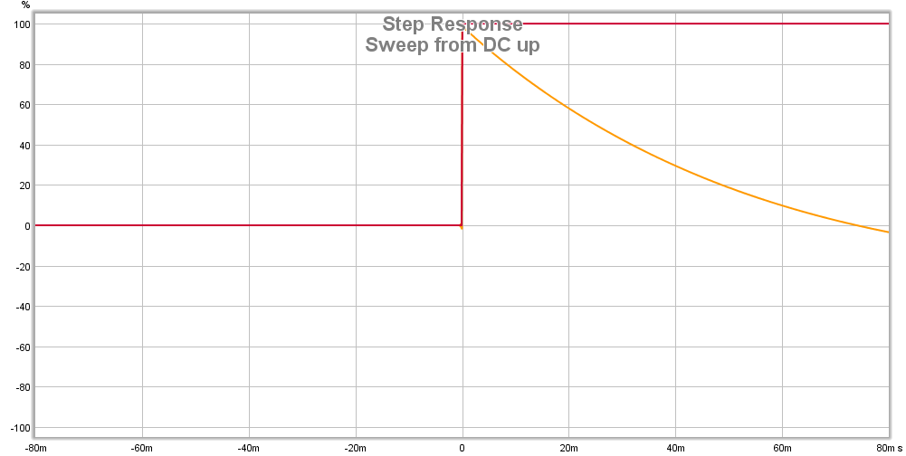

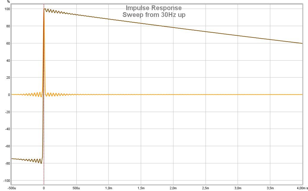

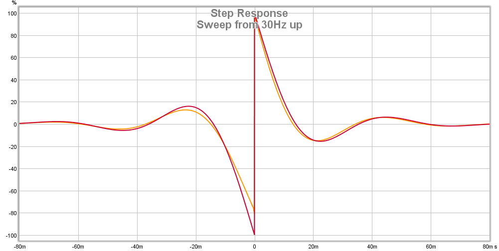

Comment try start of sweep much lower than 30Hz, from DC guess should be fine when XO is turned on.

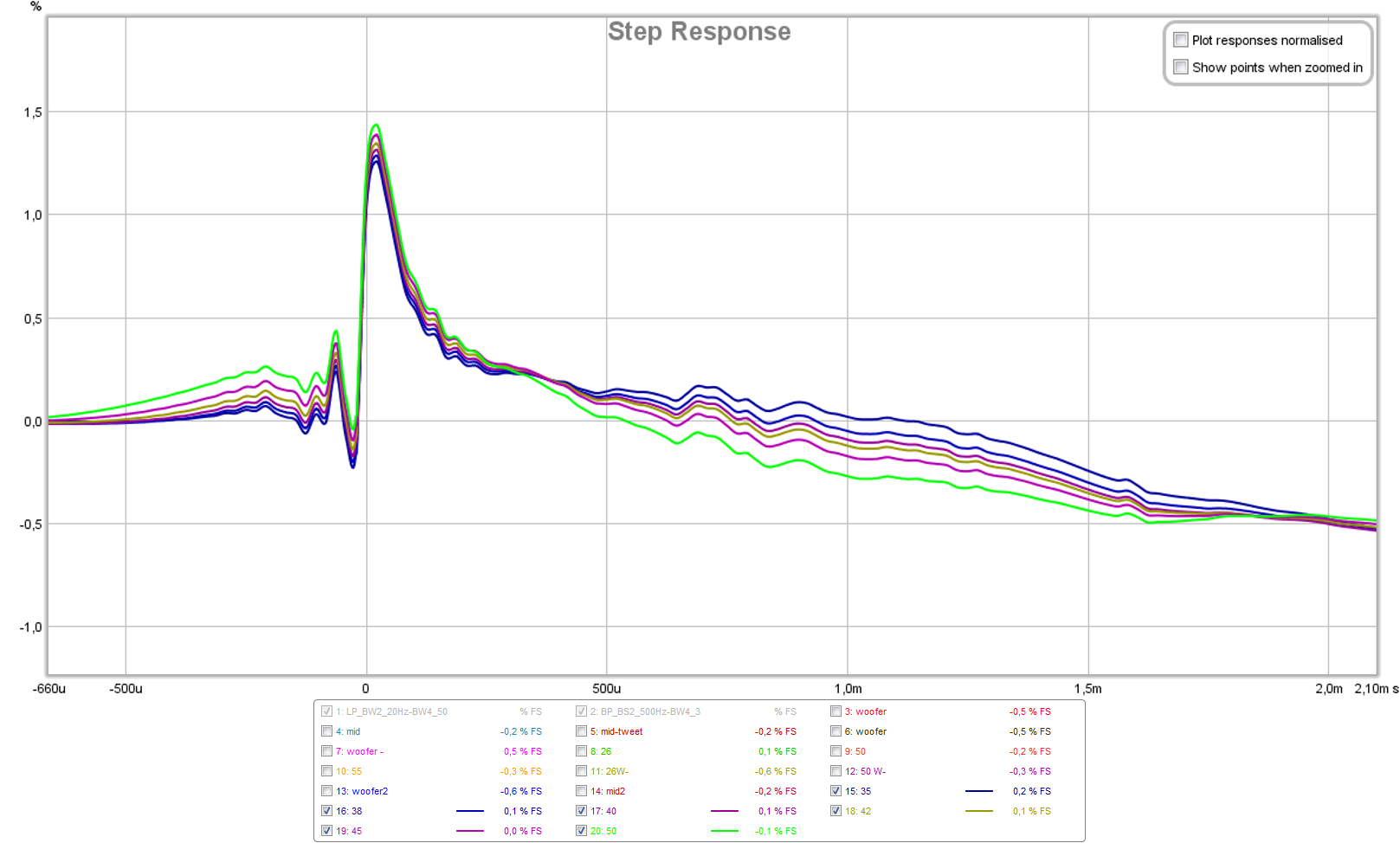

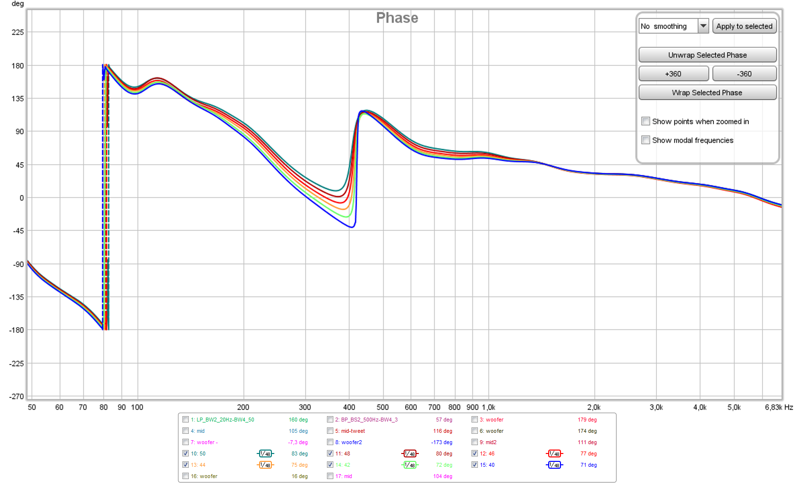

I used 4 sample window this time

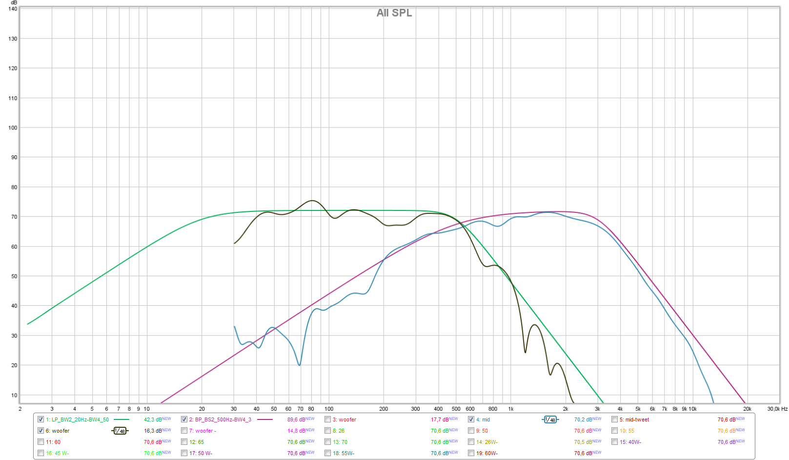

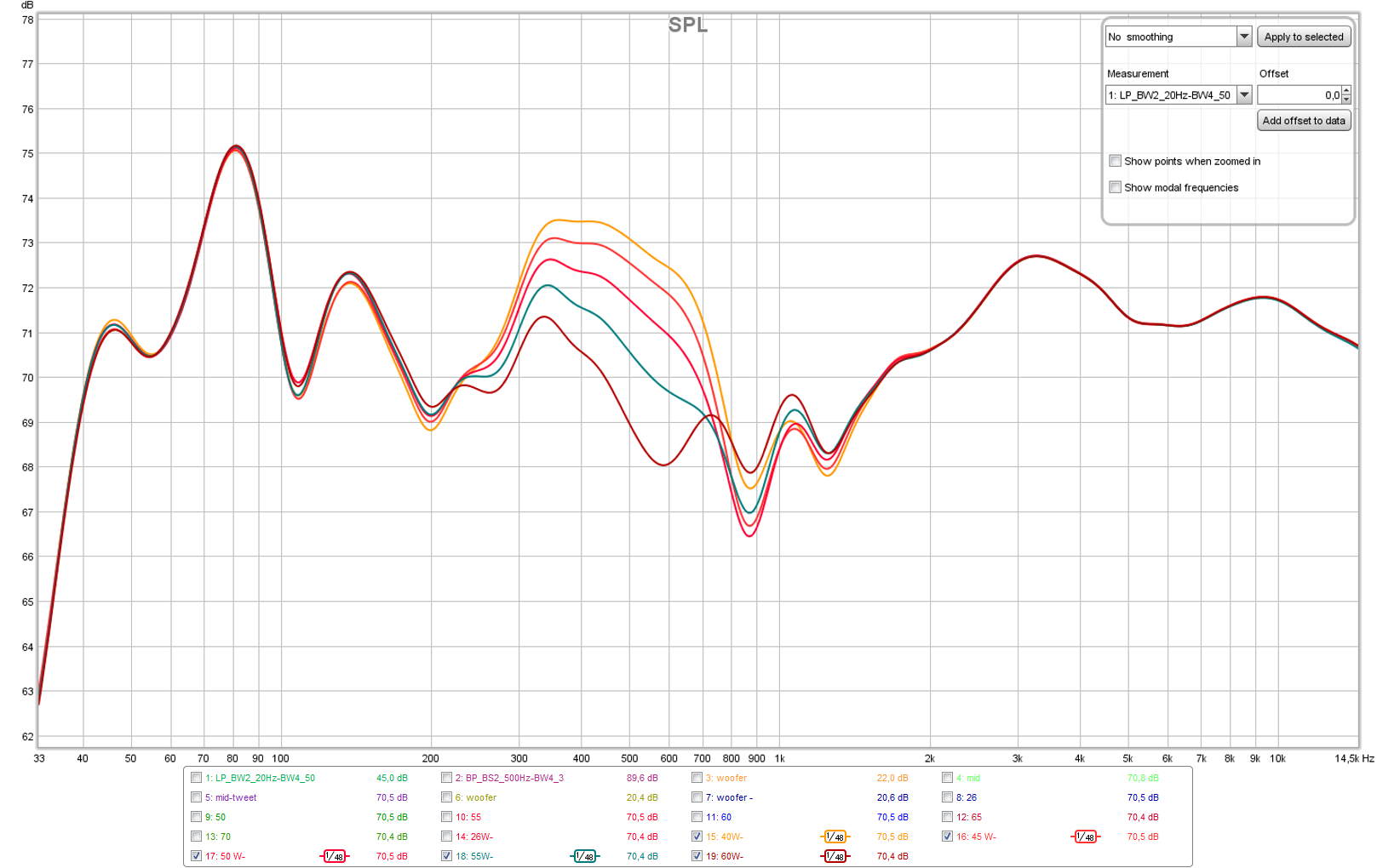

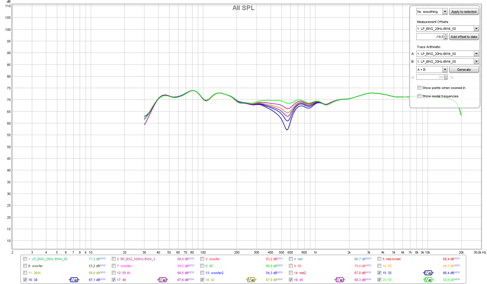

Okay so first better target curves:
Before
After

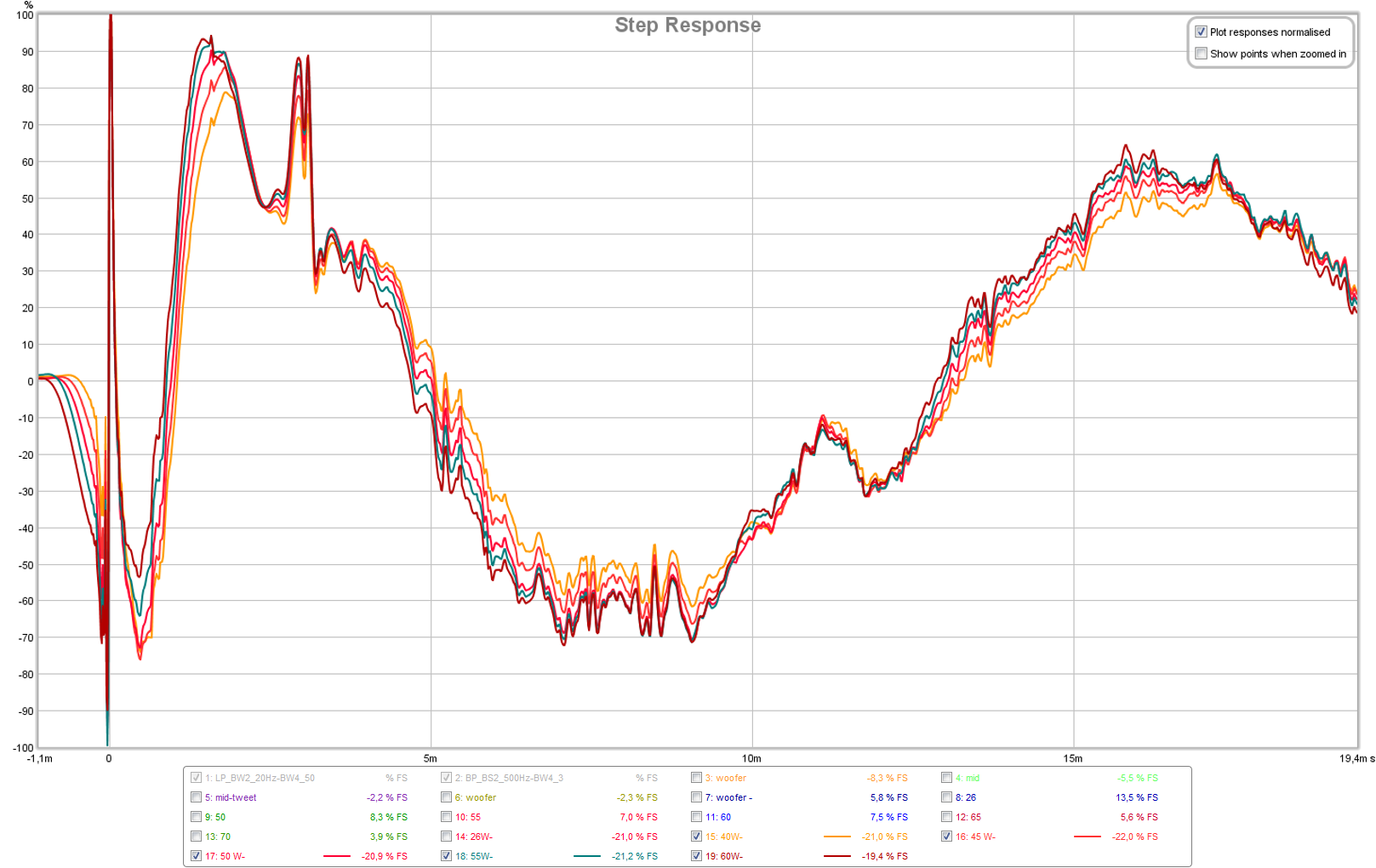

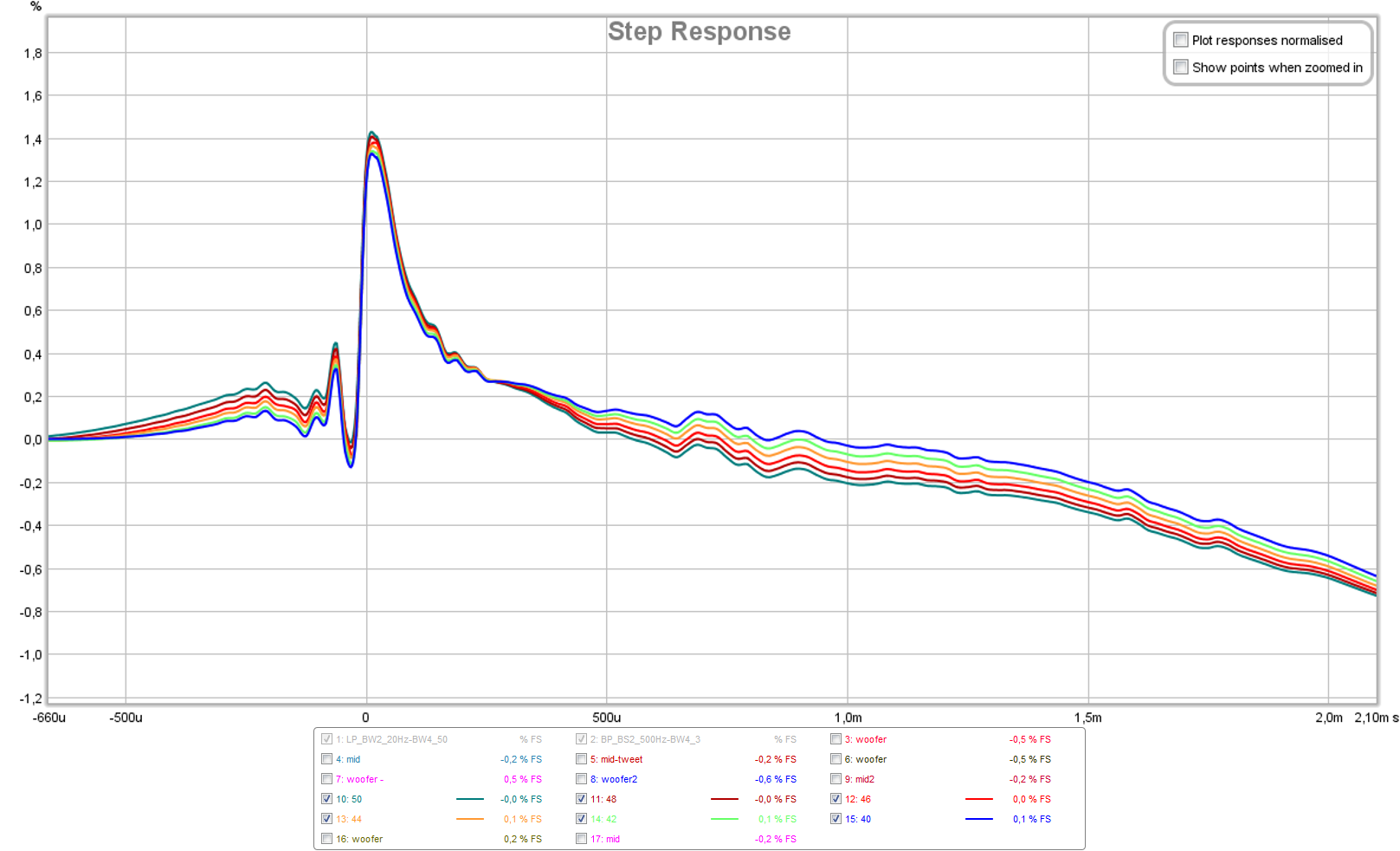

Then I measured delays from 35 samples till 50 samples all still 1 meter on axis tweeter height. (I can do 50cm later)
SPL
Phase
STEP
The 50S (~1ms delay) has nice phase and SPL like predicted in simulation. I'm just wondering why the STEP is off so much.

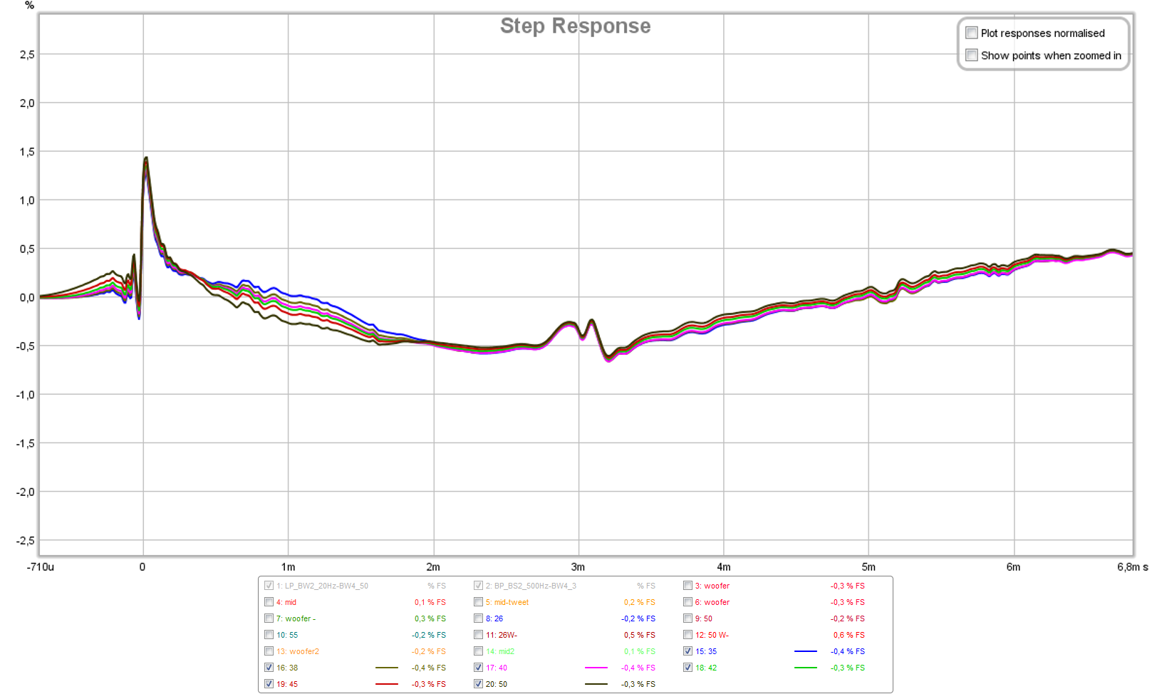

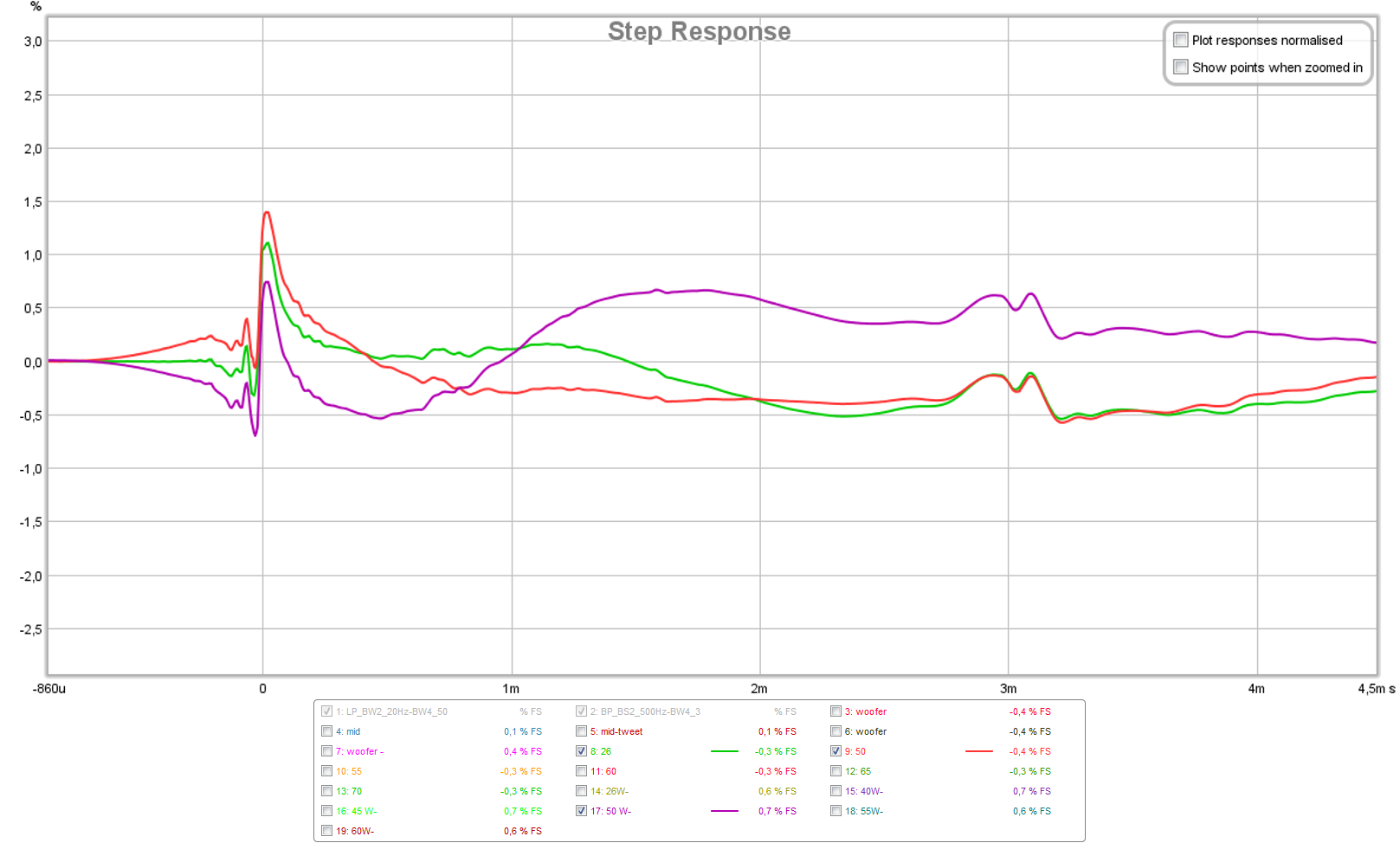

I like the first purple one under the green. The tell tale of a Harsch working is a slightly lower sum response that is a bit lower than plain woofer. The step looks good but I am perplexed why it only goes to 500us. Should be circa 3ms or more.
Also, there is something strange at the leading edge - you have a small sharp rise then it drops and rises again. This may make the sharp attack diffuse and reduxe impact of the Harsch XO. Is that a DSP pre-ringing? I see a slight shoulder rise on the leading edge on mine but no double peak like this.
All of the separate STEP results (woofer, mid, tweeter) show something similar judging this earlier example:

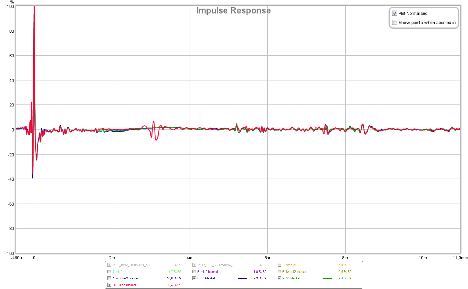

Shouldn't be a DSP thing but something is up. Maybe a regular impulse shows more info?
I think something is happening to the woofer response at 200 Hz preventing it from following the desired shape.
A regular impulse zoomed out to ~10 ms should show it. Somewhere around 5 ms there should be something happening...

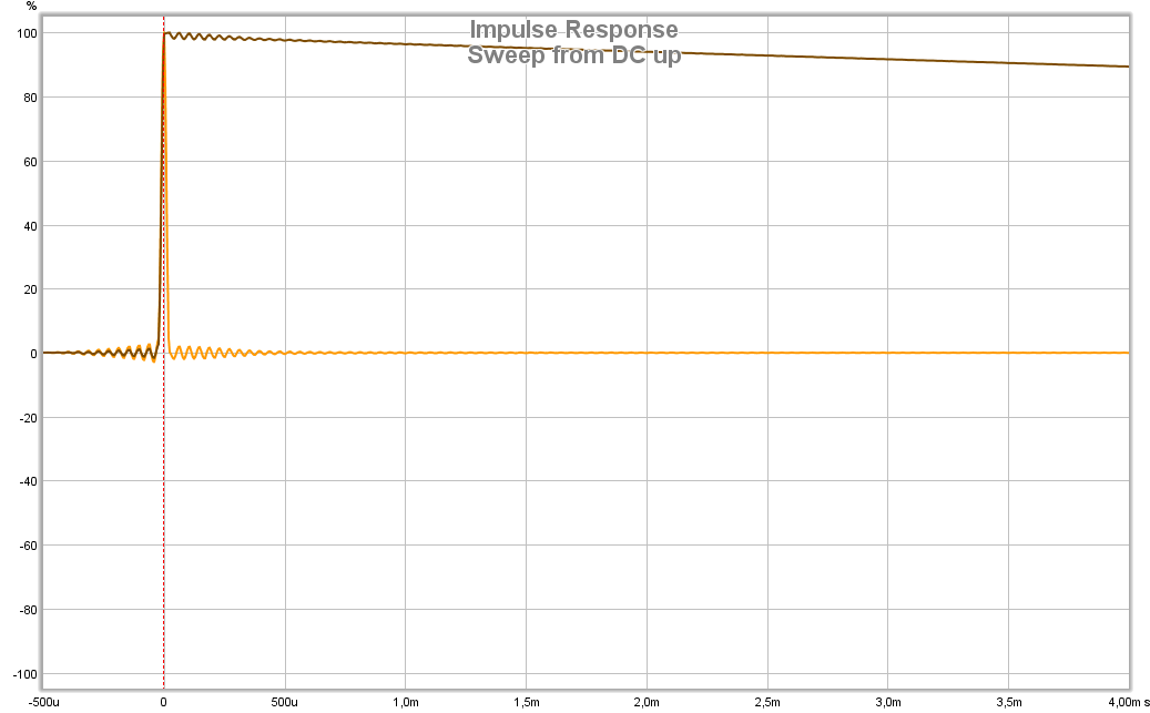

.....I'm just wondering why the STEP is off so much.
Yes and why is step not up to around 100% but instead show less than 1,5%.

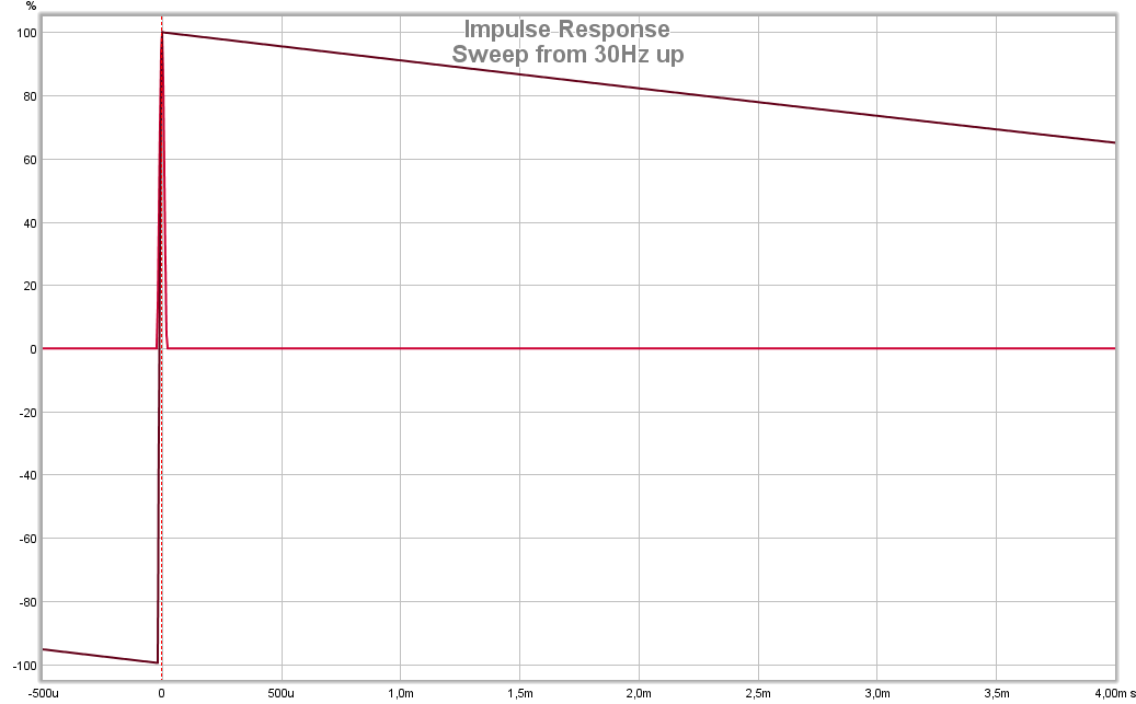

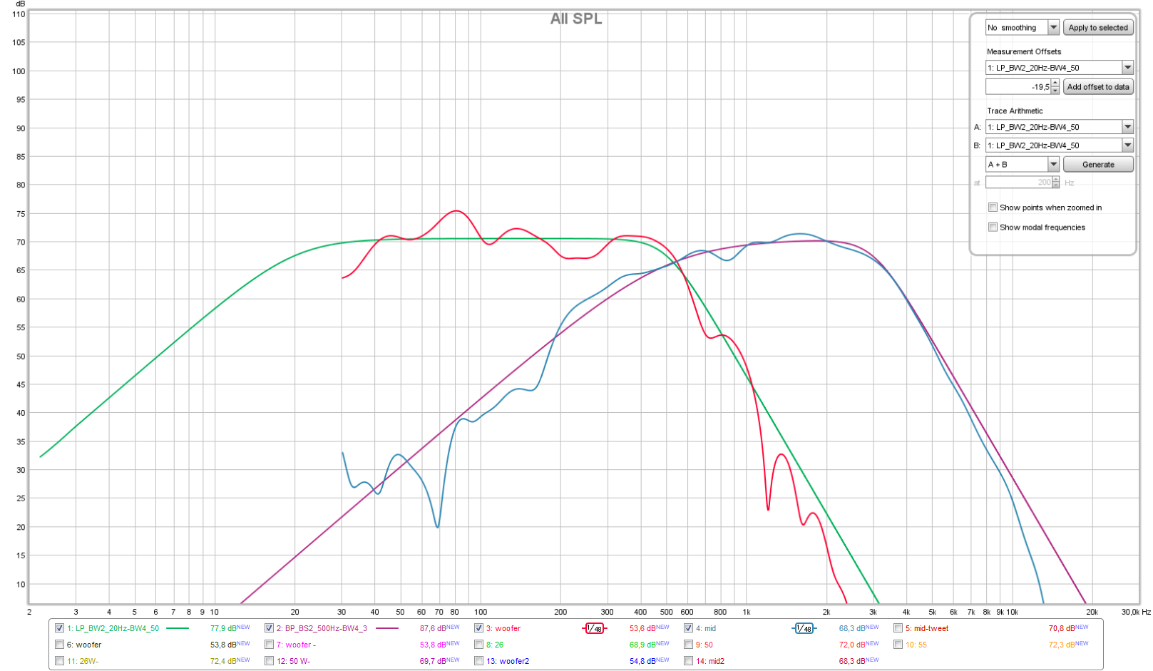

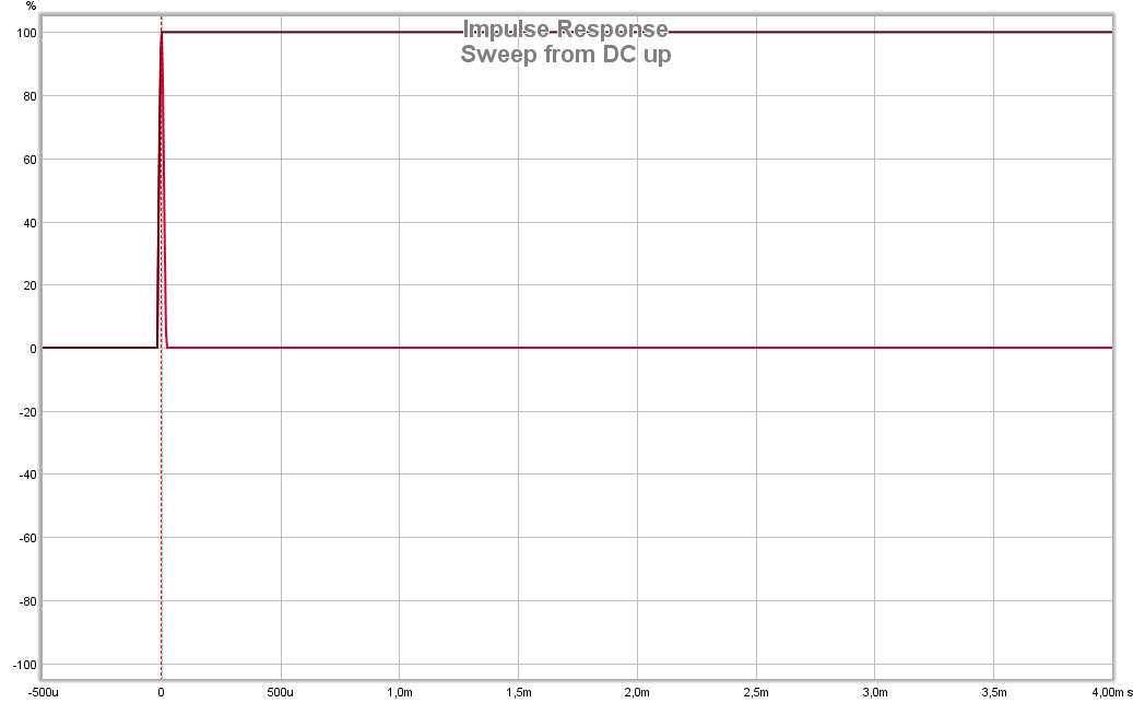

Can you show IR/SR for each of the pass band, by that we can see for sure polarity if it goes up or down for all three. If those are alright i would only sum woofer and mid until IR/SR look close to picture 4 post 171, then do the same for mid and tweeter as in picture 5. By that offset settings should be revealed and then sum all three.

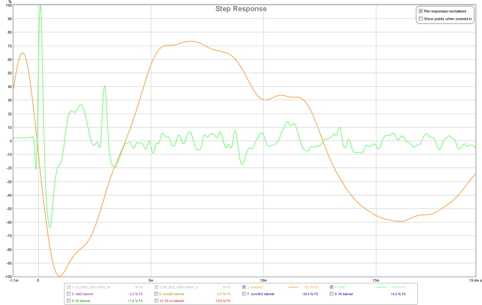

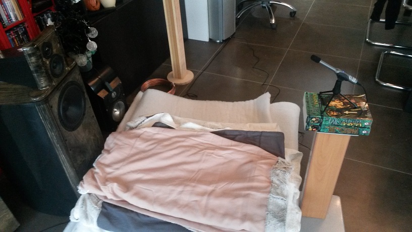

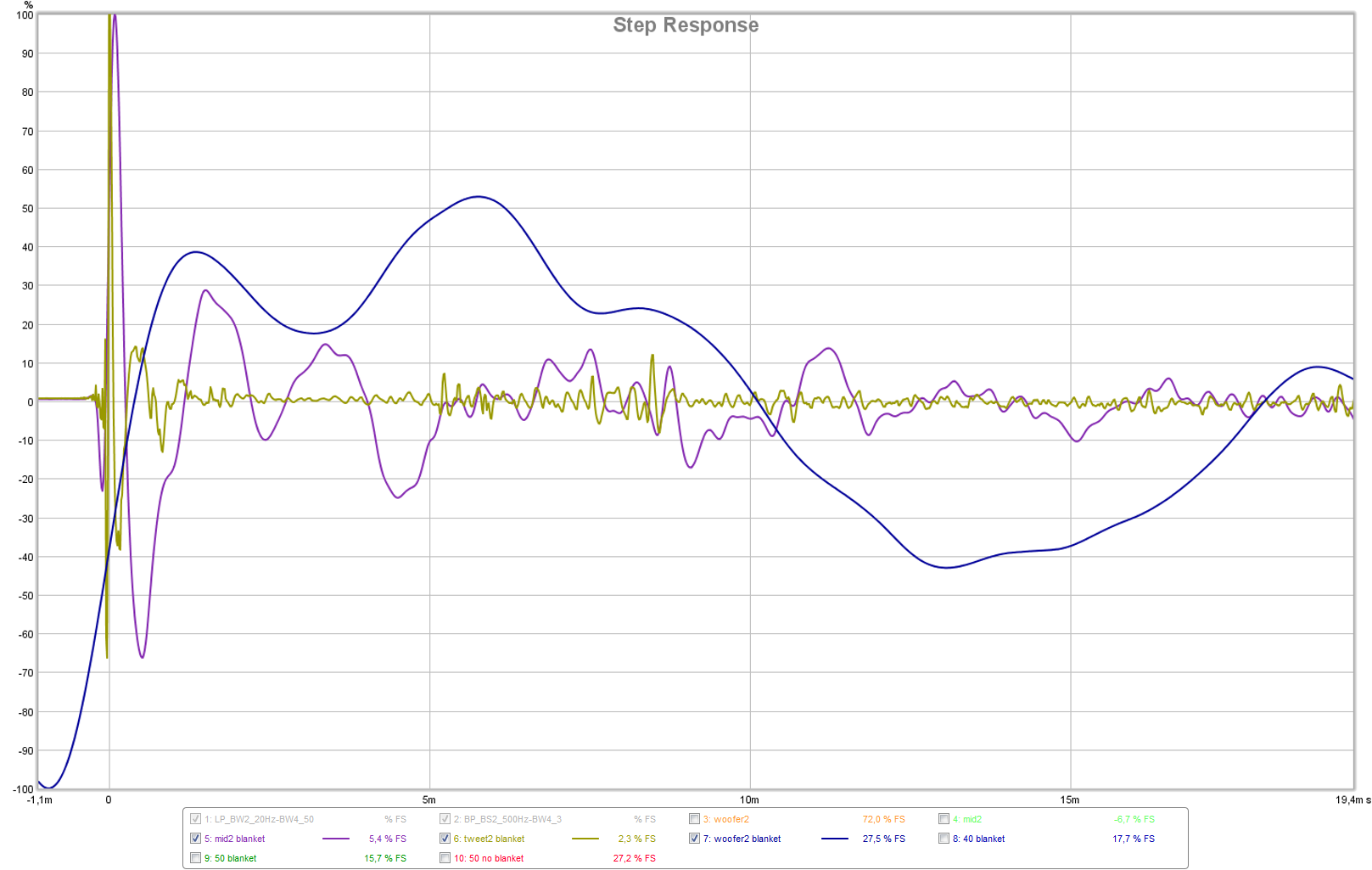

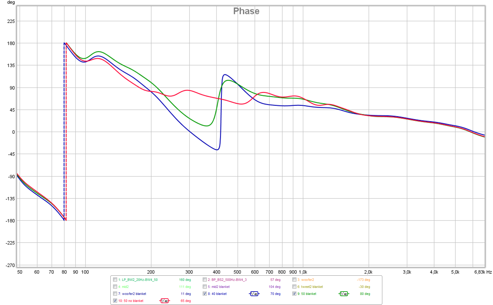

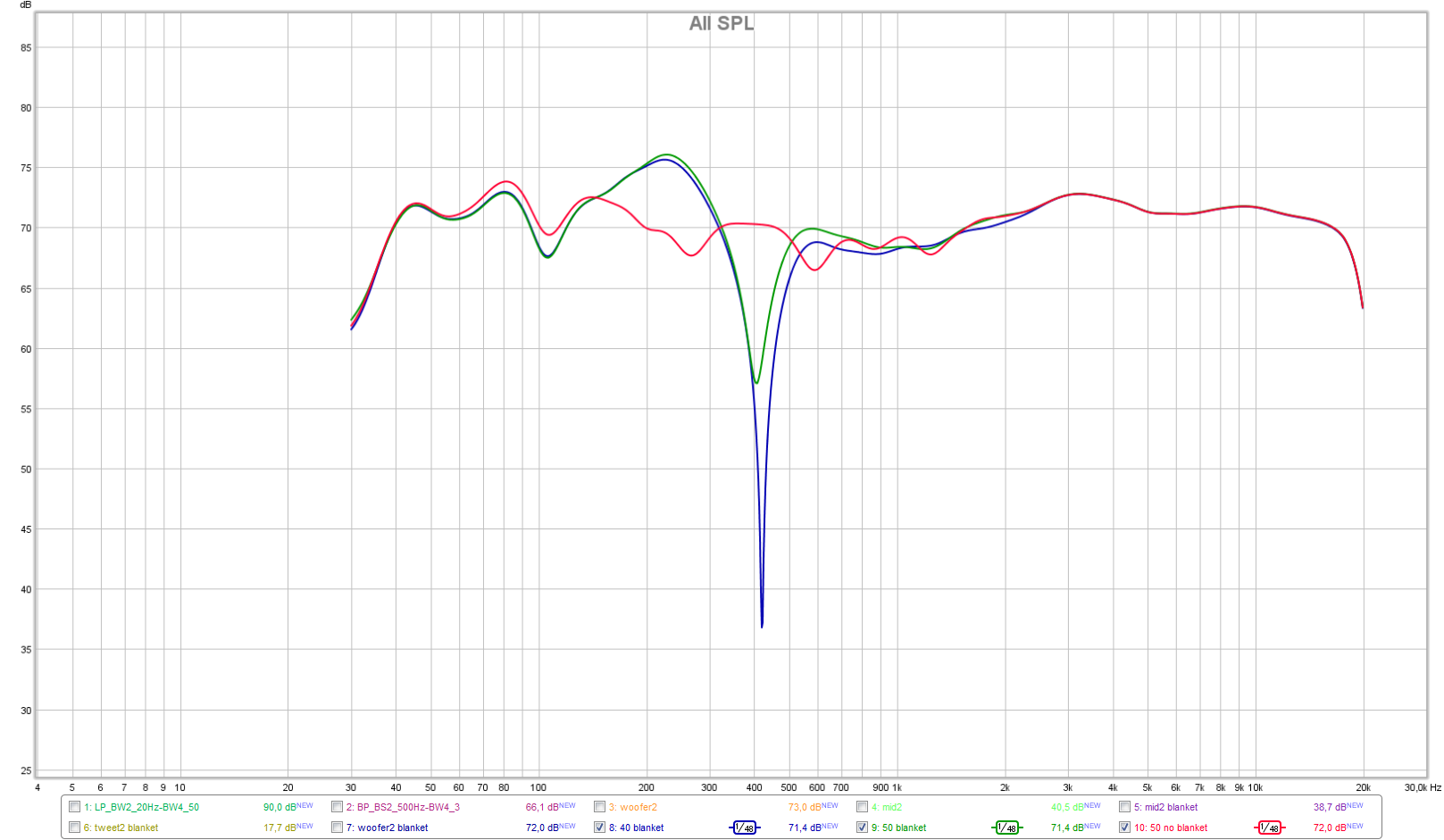

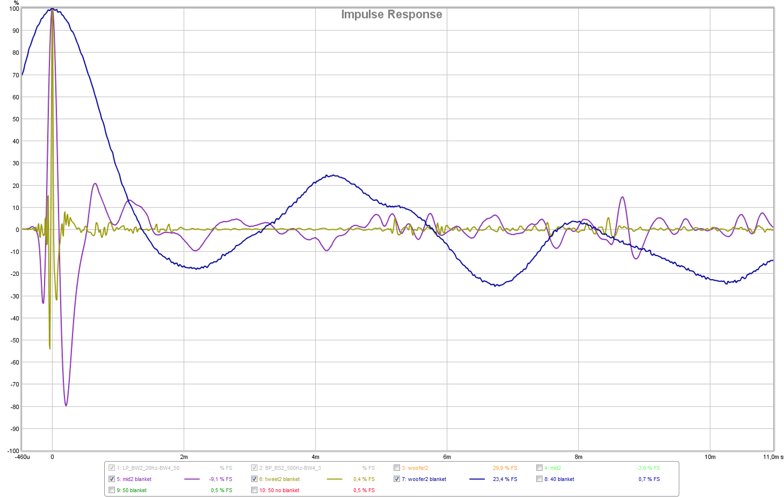

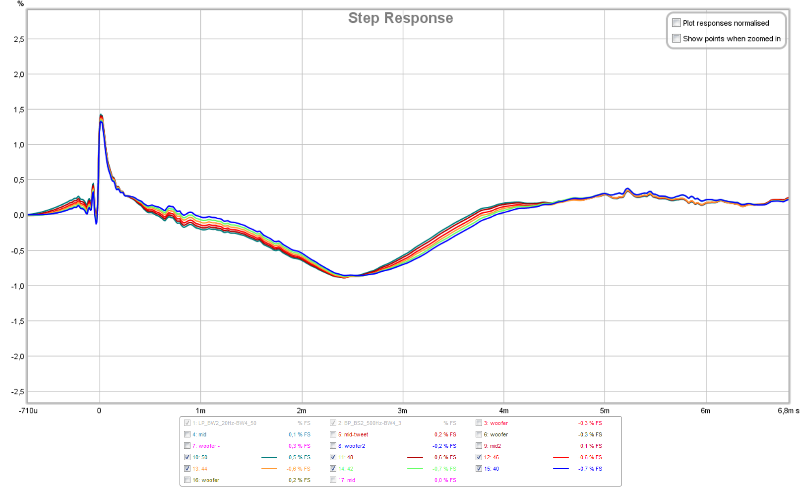

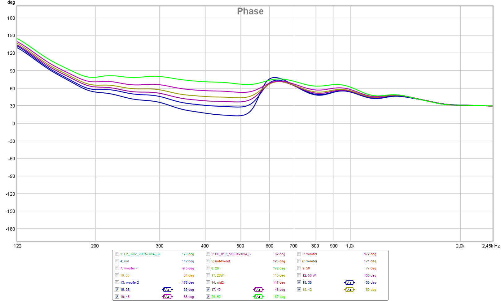

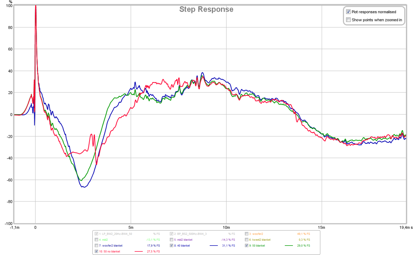

So I added a bunch of blankets and some polyestermat between speaker and mic (it's about 30cm thick) and did some measurements between 40 and 50 sample delay.
SPL
Phase
STEP zoom out from before using the blankets (this is a zoom out of the step in my previous post)
Step with blankets
Step with blankets

Nice to see blankets have an effect. Please show IR and SR on same plot.
It is odd that as you vary delay, I don't see the leading pulse separating in time delay from the bigger tail. This tells me your delay is completely off - you are missing the big woofer pulse altogether. You should see a sharp spike "move" left and right relative to a broad but gentle "hill" that represents the woofer step. I don't see that happening so I assume your woofer pulse is somewhere to the right of the plots. Maybe expand horiz time axis...
Actually, looking at the deep cancellaton null at XO, is that because you flipped polarity to show your XO frequency?
I did not change polarity, I checked, rechecked and remeasured, that is what it is. I'll take the blankets away between 2 measurements to be 100% sure.

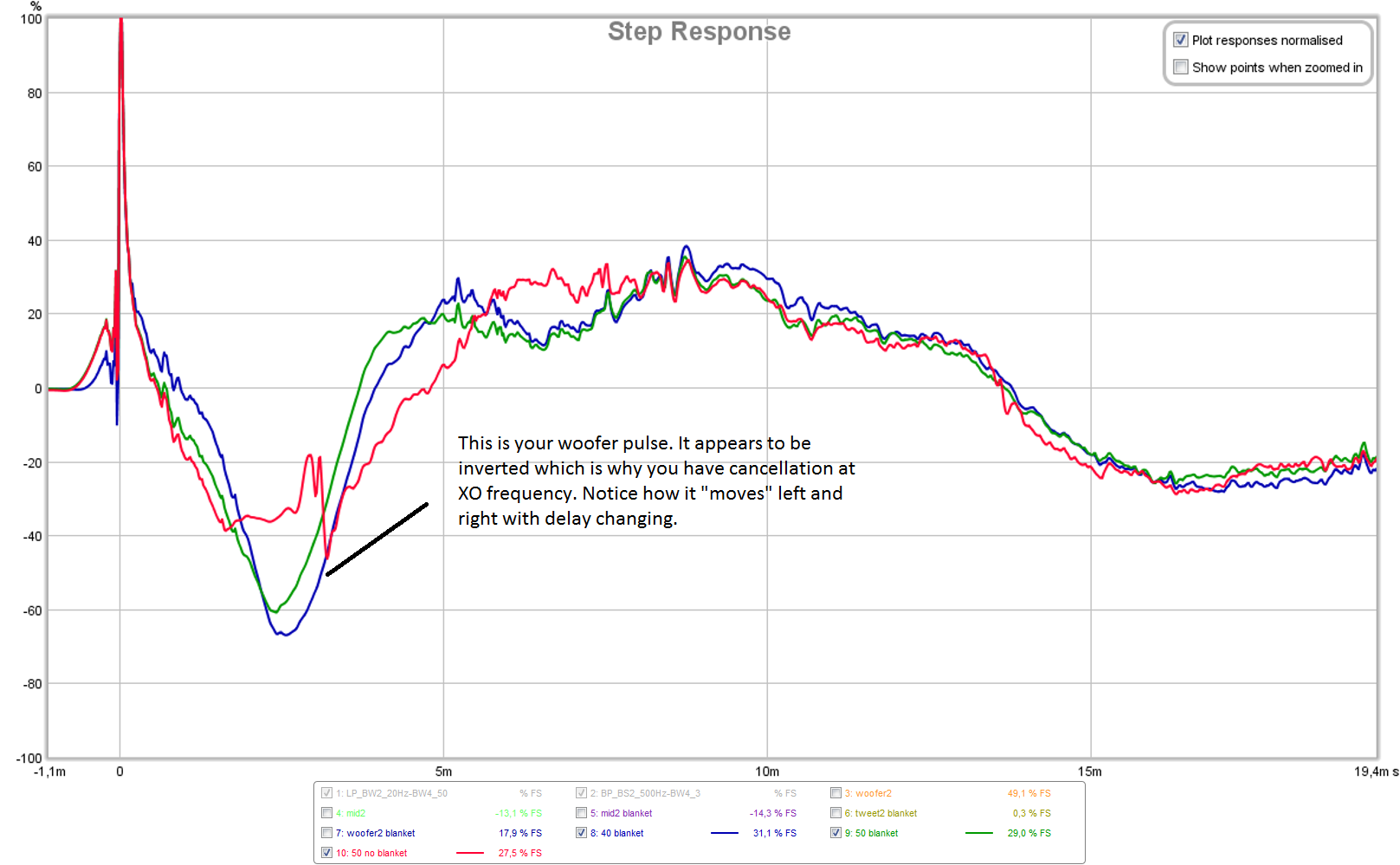

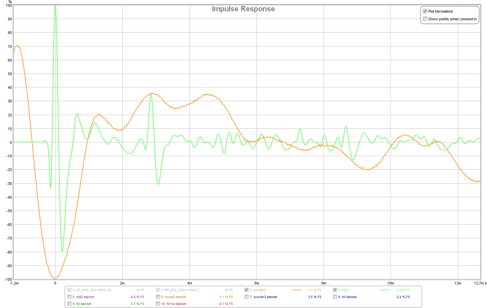

Ahh... it is more clear now. Your woofer is inverted for whatever reason. Flip polarity on woofer so it pushes out with positive going tweeter and mid. Also, add about 2.2ms of delay to your mid and tweet combo and it should line up with woofer leading edge. Start there and adjust delays by little steps to get best response in SR shape. Don't know what it is but there is a significant delay in your woofer response relative to the rest of the system.
Hope that helps.
Hope that helps.
But still every impulse has that pre-pulse present. Warning you the big pulse is coming. I do wonder what's up with that. Is this an USB dac?
So, if I'm understanding everything correctly, my woofer is inverted and I was never able to see this in any measurement because the floor bounce masked it completely? I'm having a hard time grasping this but I will redo the measurements for the woofer inverted with blankets.

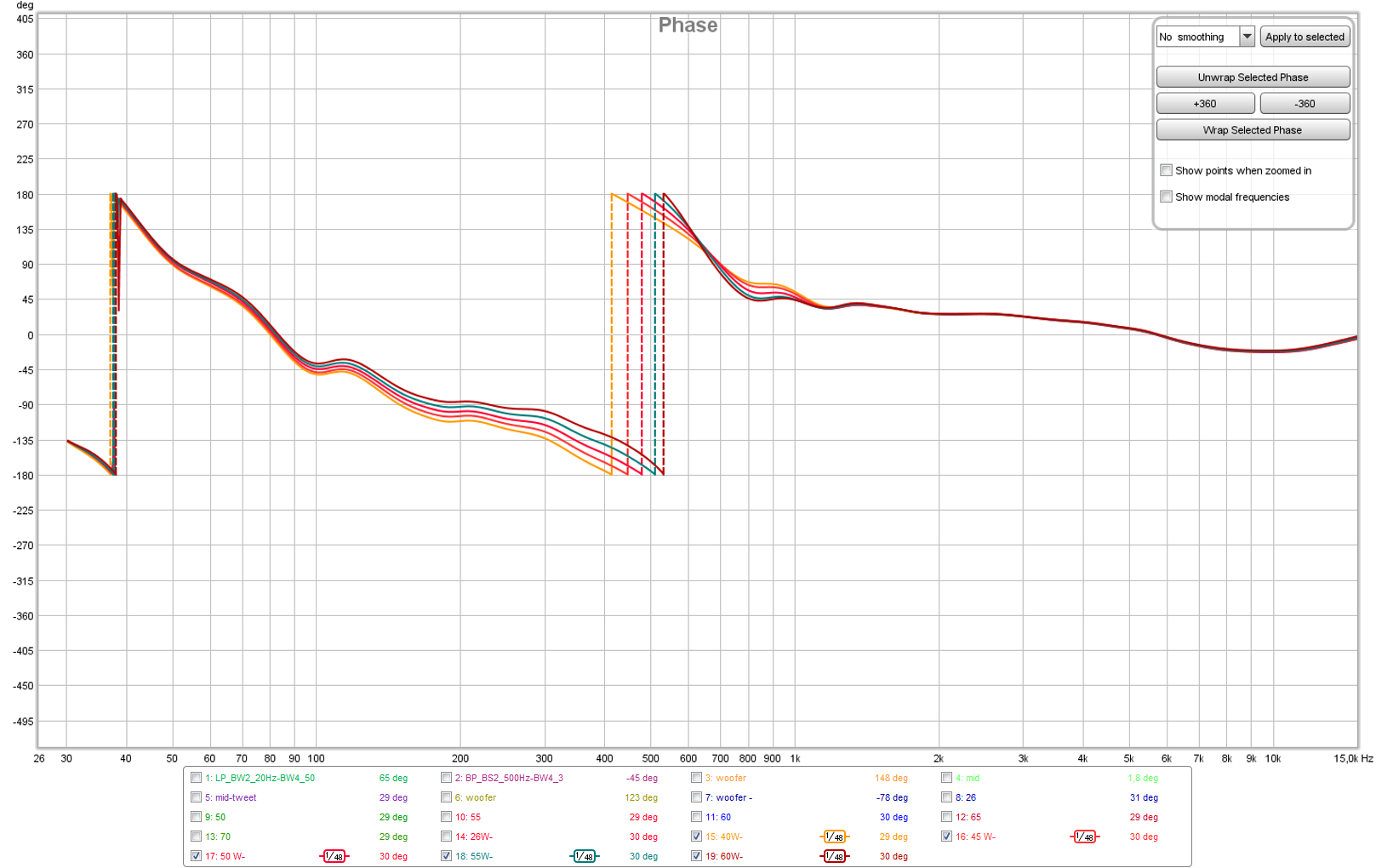

I did do a measurement series with the woofer inverted (without blankets) now with a 4 sample window:
Delays from 40samples to 60 samples but there is always phase-wrap AND the pre-rise goes down instead of up

Yes, your woofer is definitely inverted previously and correct polarity here:
Add the 2.5ms or so of delay to mid and tweeter and you will hear a significant improvement in the snaps of drums or articulation of plucked bass and piano.
Phase wrap is probably floor bounce and will go away when at 0.5m and 5ms gate.
