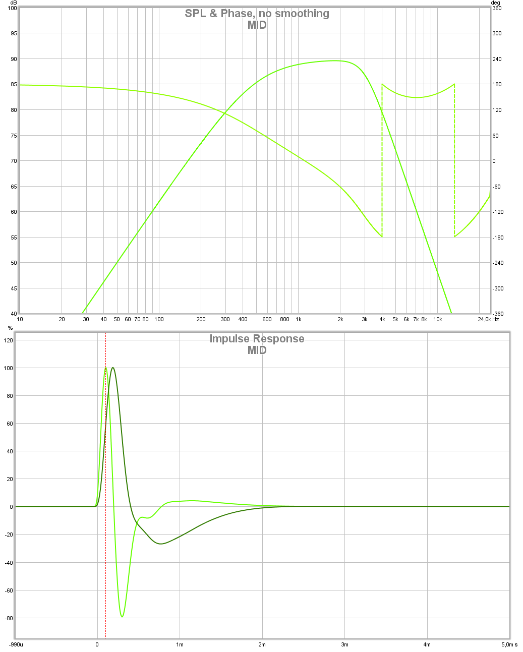

Yes BS2 stop bands for mid was a problem for ripple in area where mid XOed to tweeter, but maybe it will help going up to 4-5kHz area as XO point. Can try this later, also could be fun see how it looks if woofer and tweeter gets BS2 slopes and mid gets BW4 slopes. XSim is great for this because when sweeping offset up and down then on the fly one can see frq response and transient windows change traces and find best compromise, slopes are made in Rephrase exported as IR-wav file then spl offset in REW and exported as frd-files ready to link to driver inside XSim.

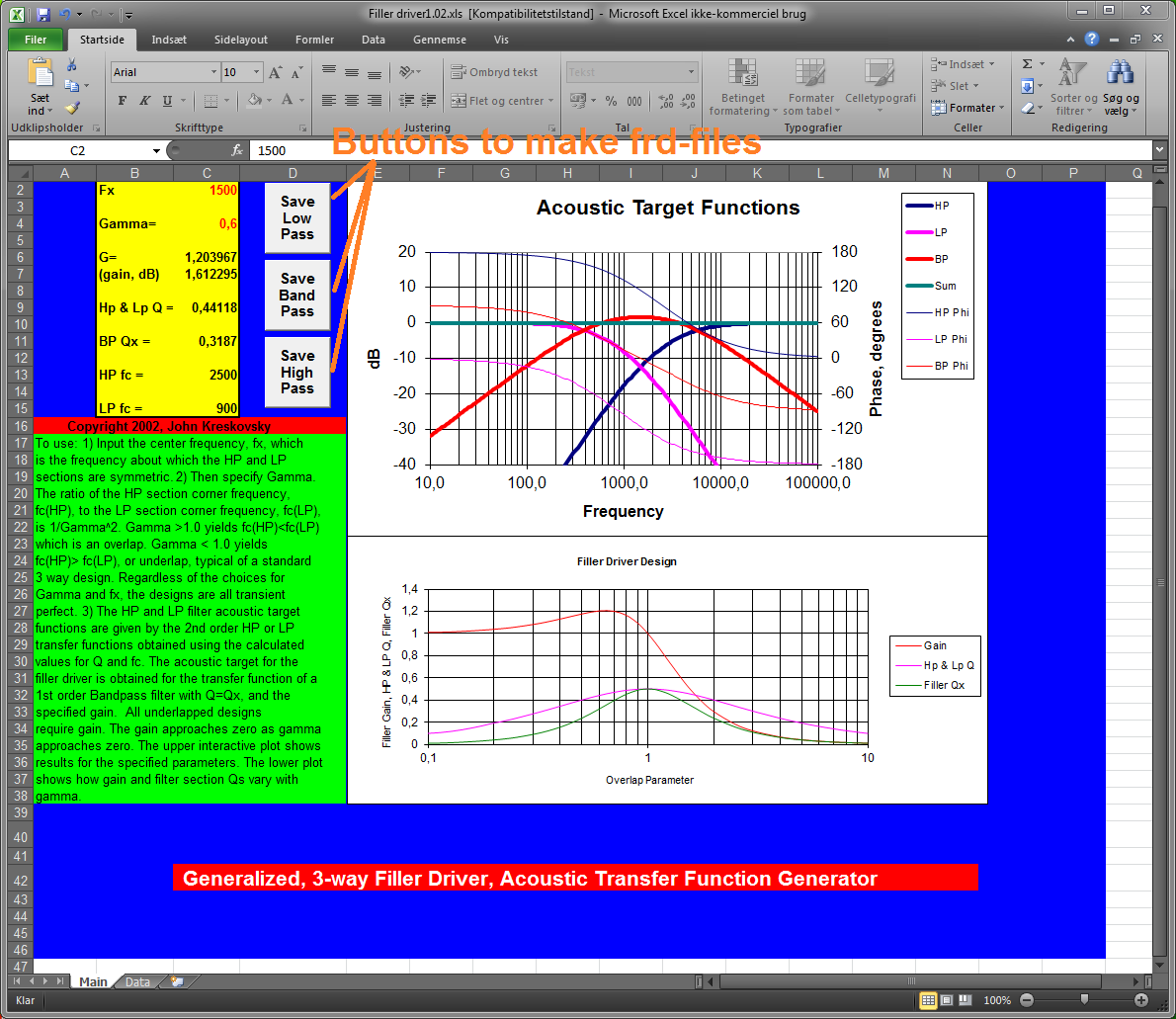

Use Target Function overlay in PCD for Harsch XO
I used Jeff Bagby's PCD to massage the raw FRD data to match the Harsch XO acoustical filter functions. Here is an example with my latest speaker - a tractrix Synergy or Trynergy. This is a hybrid dipole Synergy horn concept that has a nice mix of ambiance and horn directionality. The bass is very impressive going deep while not messing with group delay due to a reflex alignment:

Here is the simulation of the XO function in PCD (the surprsing thing was that it required a BW2 at 500Hz for the LPF and BW1 at 300Hz for HPF):

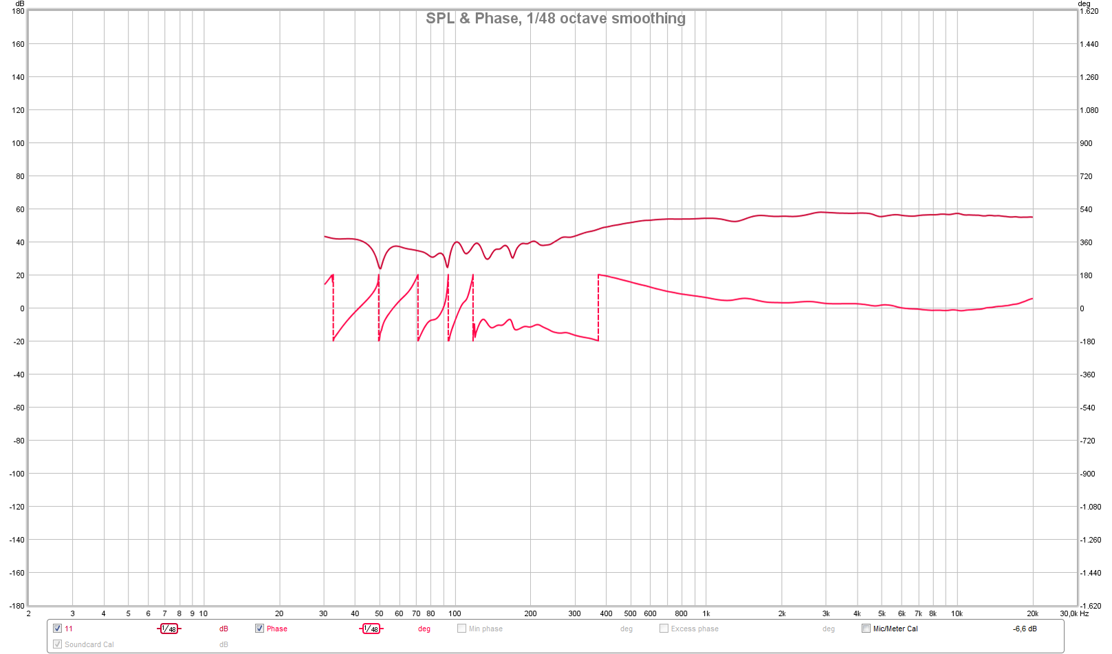

Here is the measured response compared with simulation using PEQ's and electrical XO determined from PCD (no tweaking in real time whatsoever):
This method allowed me to achieve one of the best phase responses to date for this speaker (+/-25 deg from 200Hz to 8kHz):
Here is the measured IR and SR, much better than what I had before:

Whoah, thanks BYRTT. I was going to try the B&O hole filler at a later stage, great to have the target files. I'll try to get the second non-symmetric Harsch going today.
I also caught a mistake in my previous post, the LR2 is 500 electrical but 700 acoustical. Not the other way around.

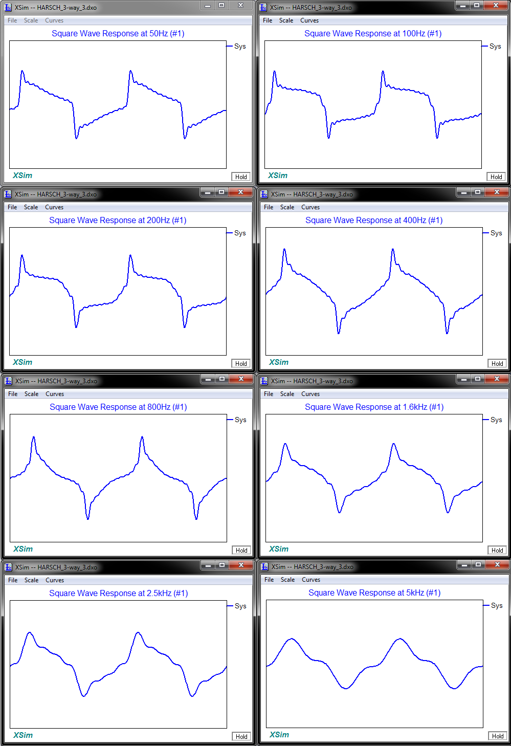

PCD looks perfect but I don't have m$ excell, so pcd is out. I downloaded and tried Xsim but the analogue crossover parts and how to hook them up look quite confusing. I found the highpass and lowpass "blocks" but how to combine 2 2nd order lowpass and with which Q to get a BW4 and translating that info into what I have to enter in the Najda software is an extra step which can introduce errors.

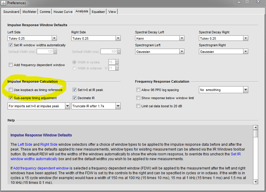

Zonneschimmel if you not on USB microphone but use same soundcard hardware clock for I/O REW can calculate real time of flight between measurement, just don't move microphone position between measurement and its important first EQ/filter LF/MF/HF setion one at a time because when true relative offset is found between sections they must not be EQed selective anymore because that will change their relative timing offset, but system EQ is okay and by that mean EQ that will flow to all three bands at same time doesn't harm and change their relative timing between. See below one of the settings into REW and another is at "Soundcard" tab, use help menu how to create the wire that will help the sync to measure time of flight.
These synthetic visual electric slopes and especially IR/SR plots should could help dial in live system changing settings on the fly into DSP XO.

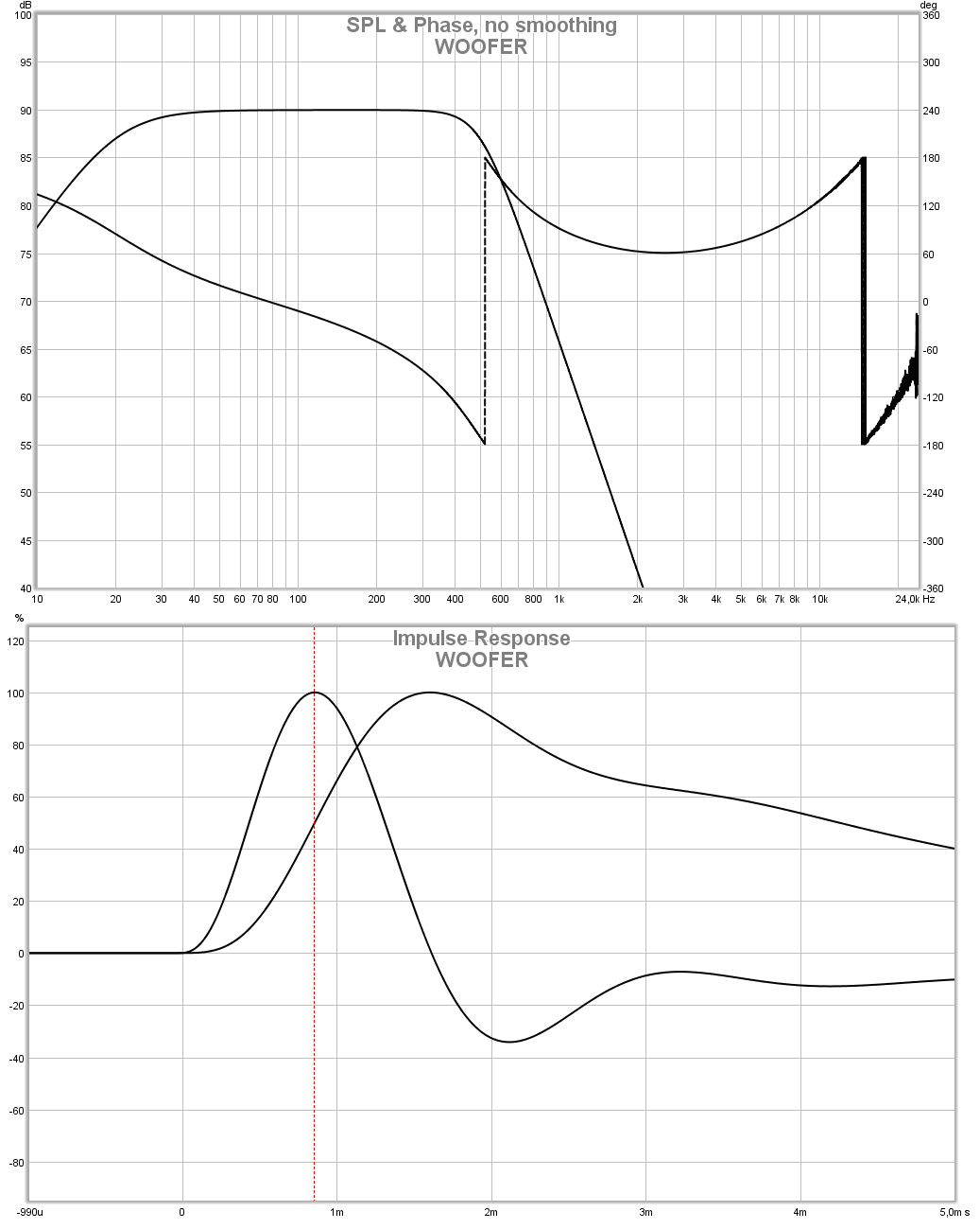

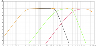

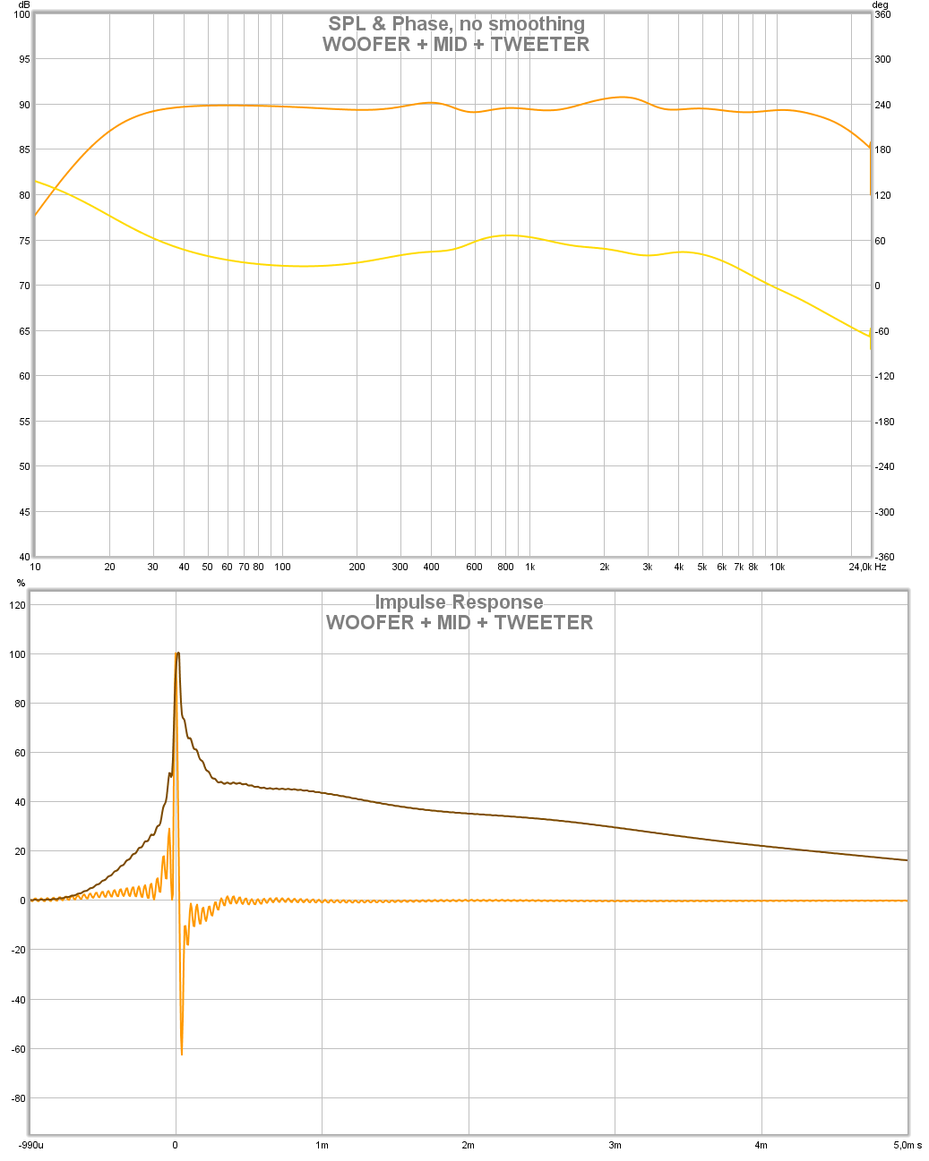

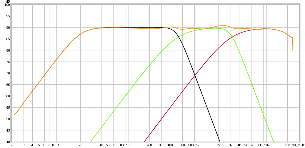

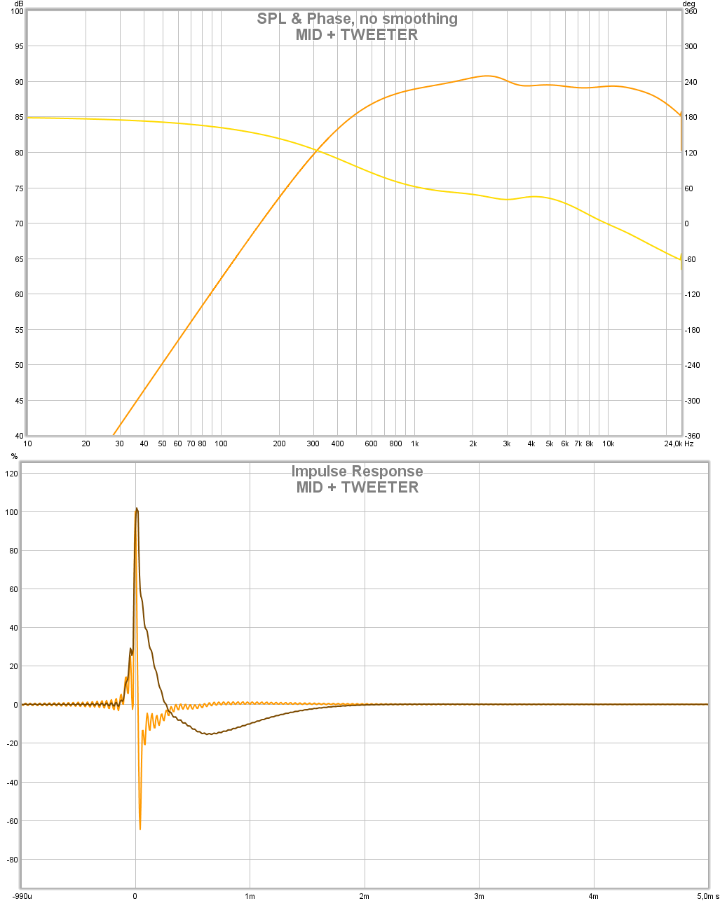

Pictures:
1 Woofer BW2 20Hz - BW4 500Hz
2 Mid BS2 500Hz - BW4 3kHz
3 Tweeter BS2 3kHz - BW2 20kHz

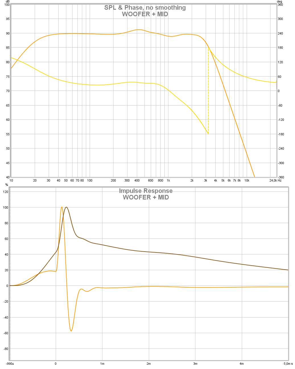

4 Woofer and mid summed (delay for mid 1,0mS)
5 Mid and tweeter summed (delay for tweeter 0,13mS)
6 System and individual slopes
7 Woofer mid tweeter summed (delay for mid 1,0mS and for tweeter 1,13mS, both delay settings relative to woofer)

Wow! Nice work Byrtt - that is indeed really helpful during setup. It's interesting to see that the SR shape can be no better what you have shown here: slight shoulder rise followed by an overshoot peak and the a triangle decay. Just can't get a true right triangle of the same shape as a symmetric 1st order or a B&O hole filler.
My eyes are soon getting 16:10 format if I don't take a break but try more test tomorrow and get back if any works better to get the 3-way as good as two way HARSCH. Was around some fun today that i think you could use for PMC build, did set up a think it was gamma 2,0 hole filler then into REW said A+B to hole filler and tweeter, that created a special slope that also need target curve to be dialed in and think a full ranger could perform it. Why it probably would suit your PMC is because slopes are close to BW1 but when tweeter take filler duty too woofer BW1 can role off little steeper up in octaves where it can have trouble to reach and summing those two weird slopes build upon 3 way or lets say two way with filler : ) they sum with perfect square waves as original Baekgaard hole filler.
Summing hole filler on a plot that reflex on axis is always a pleasure to look at but think HARSCH and other filters with FIR correction have better power response in XO region and less weird lobe. Lately my own FAST had got influenced by Barleywaters advice LR8 and FIR corrected, man it is clean and XO degraded power response running that steep have not much a area width to influence.

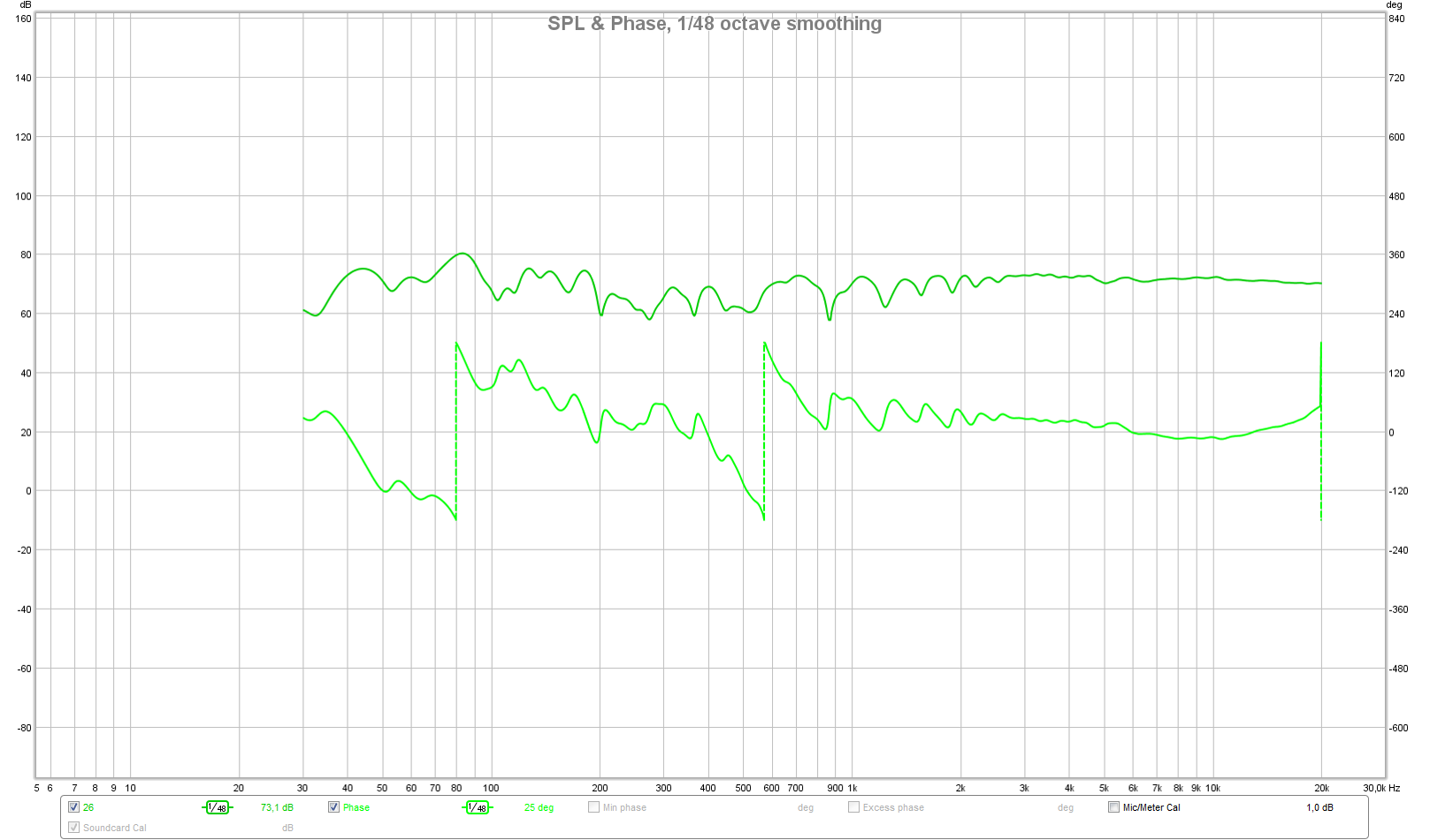

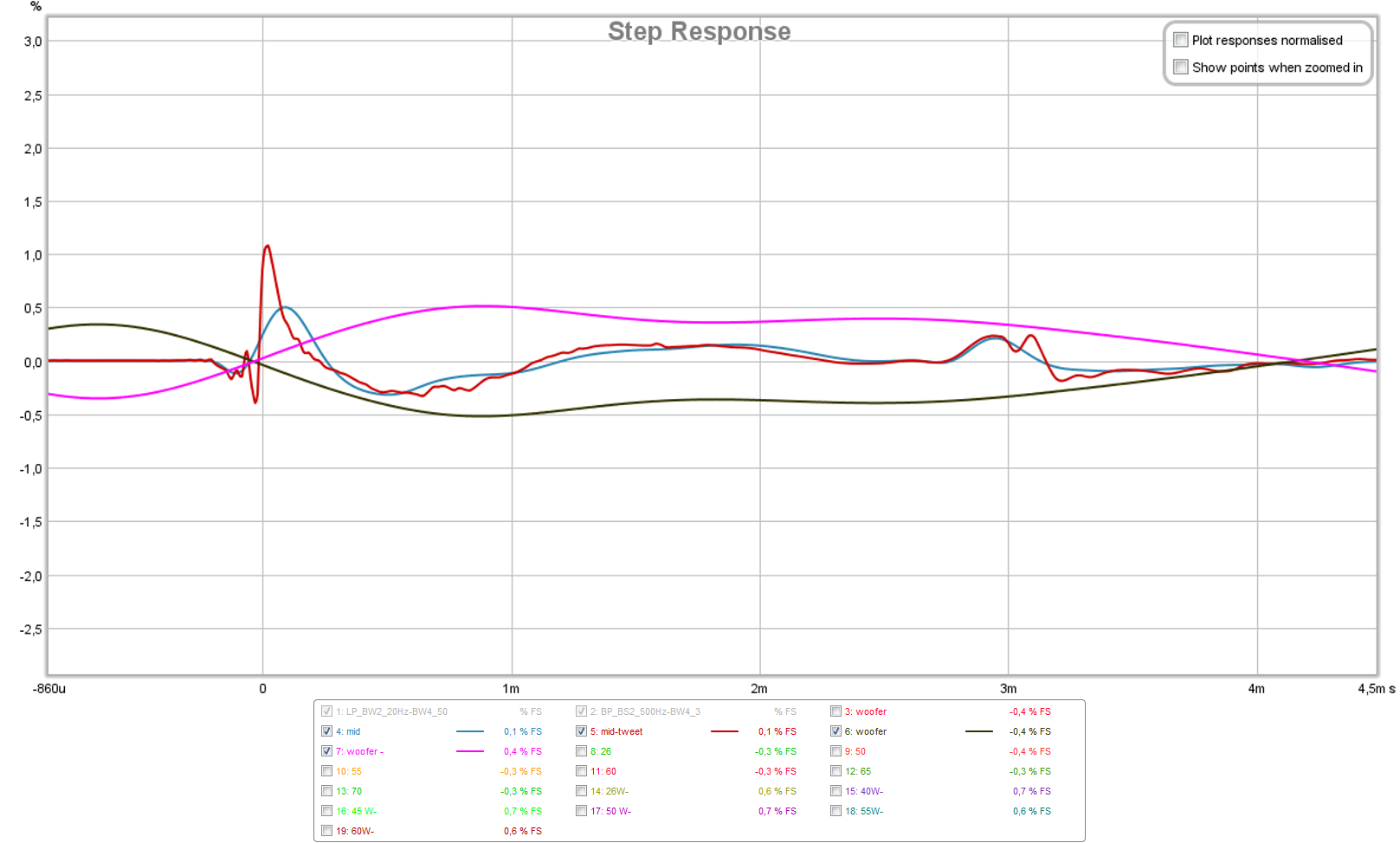

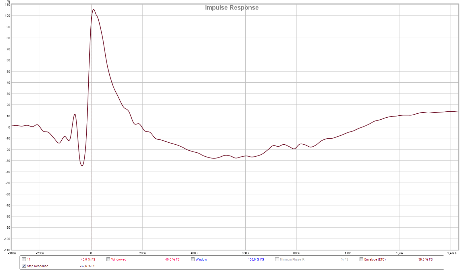

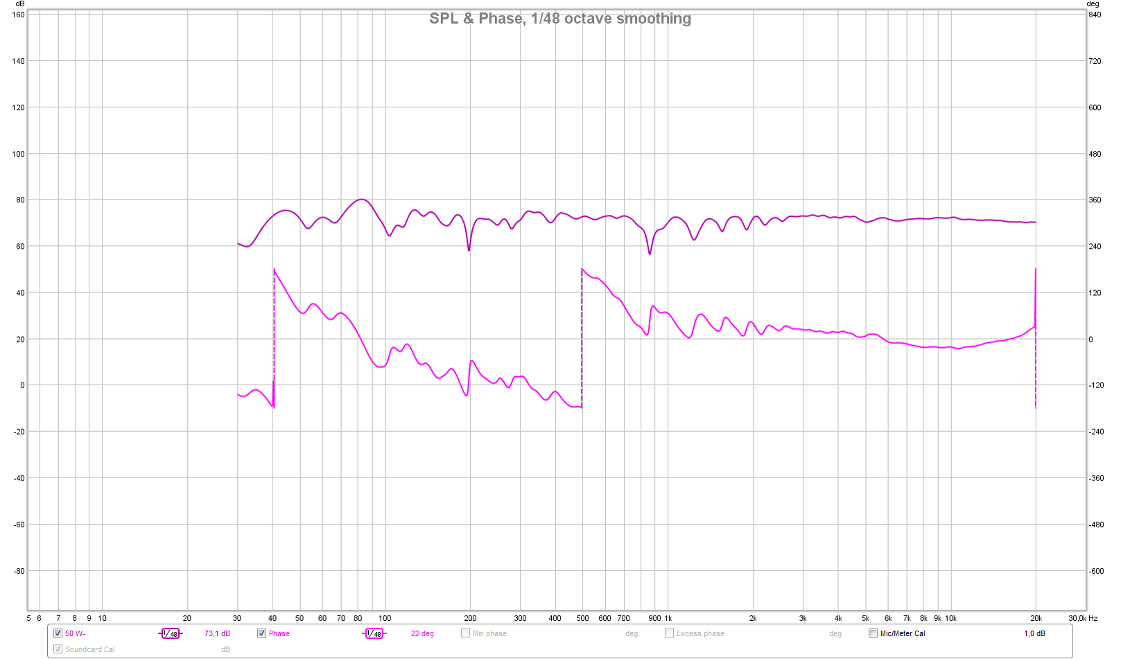

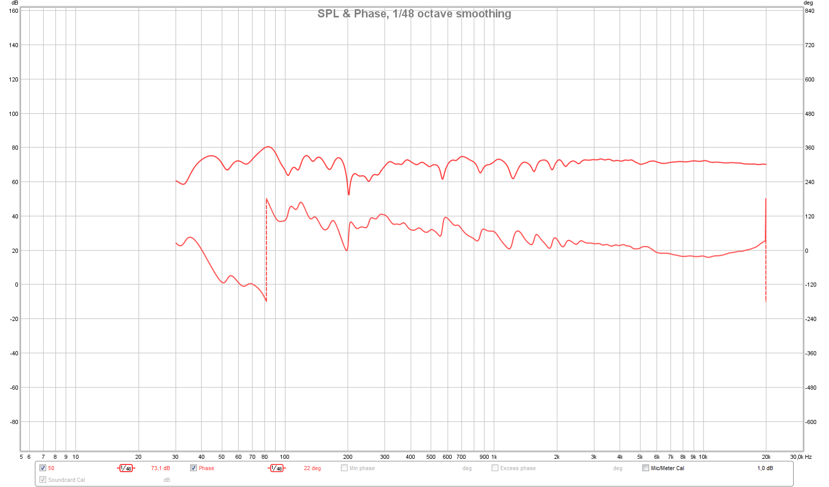

The woofer integration isn't going as smooth as the mid-tweet...
So all following measurements were taken without moving anything. Mic on axis 1m tweeter height. Floor bounce at 3ms looks identical in all measurements.

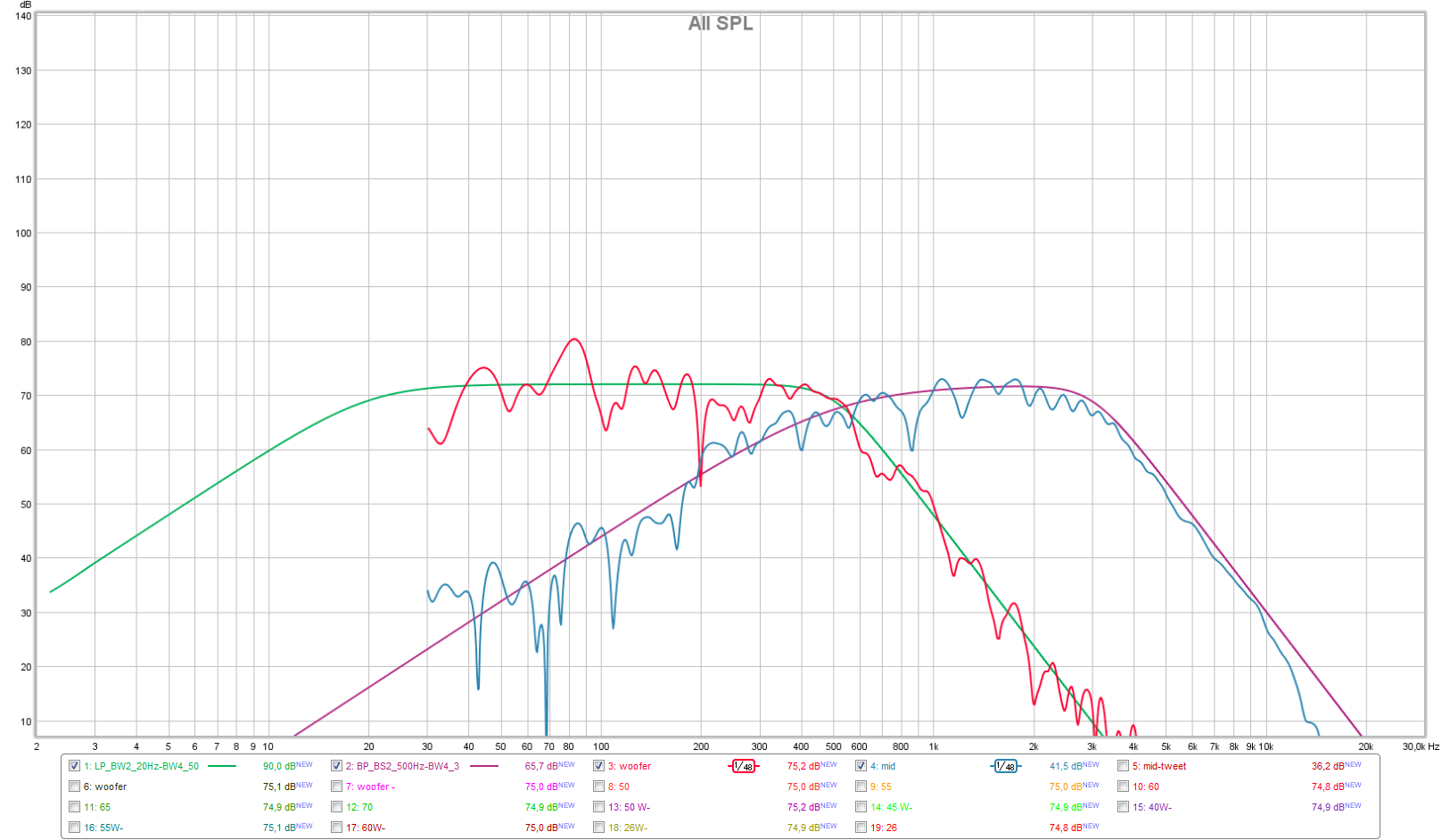

I used LR2 at 350 for mid and BW4 at 470 for woofer and a little bit of PEQ to get to the target curves
Target curves as measured:

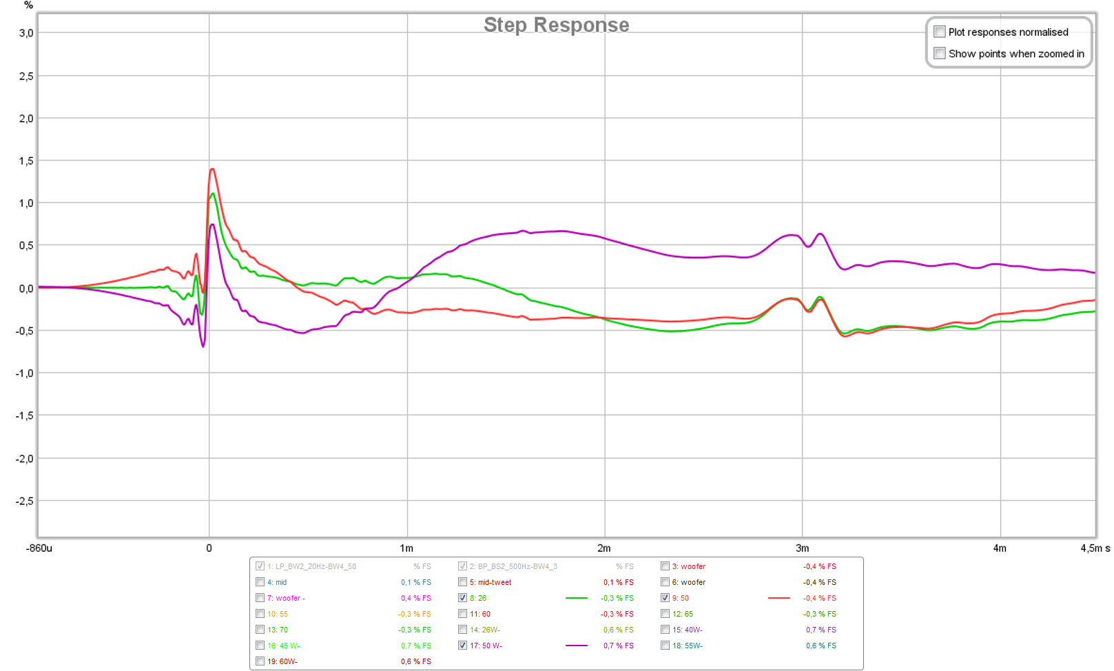

Best step I got so far Woofer positive in Najda 26sample delay (~0.55ms delay) cross with zero at 1.5ms:
Woofer positive 50S delay according to simulations
Woofer negative 50S delay according to simulations
STEP for the above
So the 26s delay setting has the best step but a phase rotation around 500
The 50s delay as simulated has no phase wrap but a crappy STEP
The 50s delay as simulated with woofer polarity reversed has phase wrap and crappy STEP with pre-rise in the wrong direction in comparison to sim
STEP for the above
Zonneschimmel, do you use PEQ's to help shape the response to hit the target BYRTT provided?
If you do, try viewing (and correcting) the frequency response in a frequency dependant window:
Try a 4 cycle or maybe 1/6 Width in Octaves. You'll be much more independent from anomalies that occur later in time and it will prevent over correction. Hope it works!
You can view the resulting phase this way too to see what it does before the room has it's way with it. It won't take out the entire room but every bit helps.
